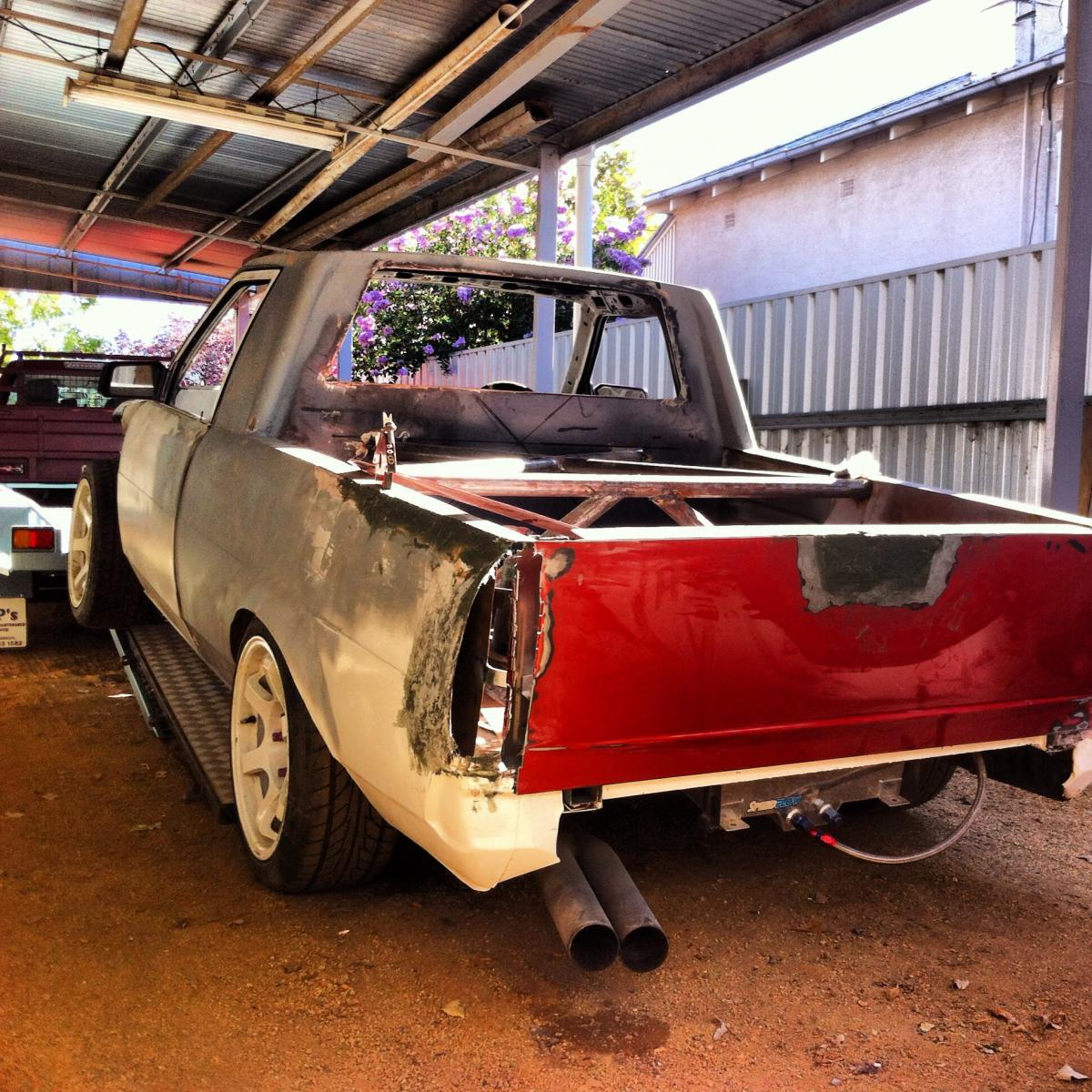

4Agte Ke70 Drift Ute

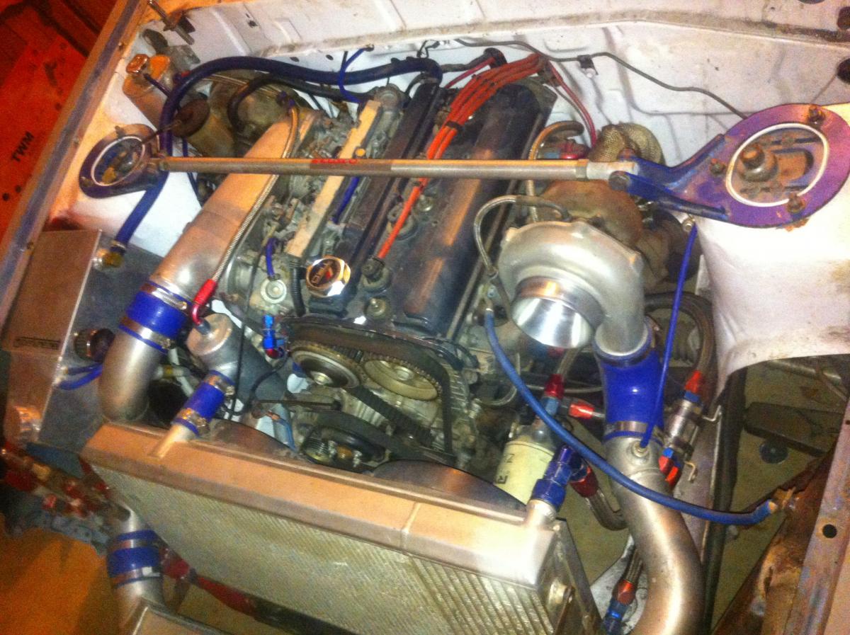

picked this up just the other day .. i dub her 'sway' .. needs a little bit of tlc but will make a sick little slider when i'm done with it ! :cool:
it already has an adjustable panhard, trd shocks in the rear, ae86 struts, strut brace etc .. plans are to not have a single piece of the suspension setup left standard.. will keep pics updated as it comes along.
let me know what you's think.

current pics

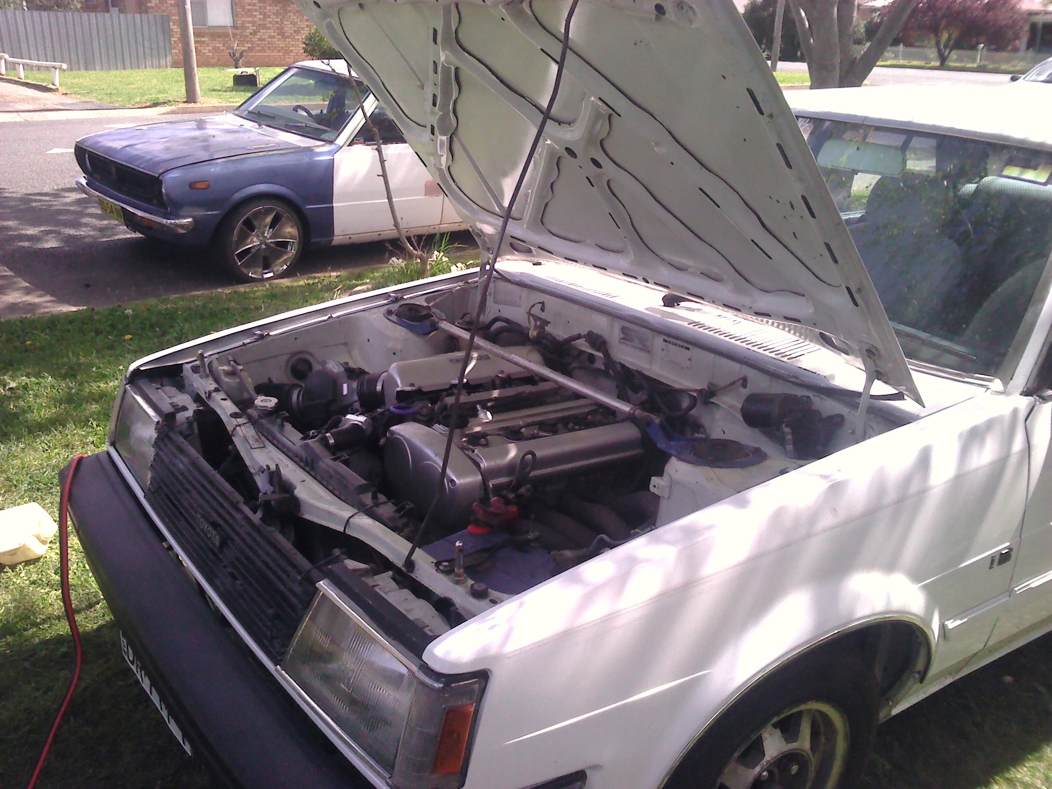

currently strapping one of these in my ke20
can't decide on comp but wicked fit so far

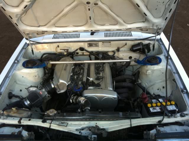

new brake booster in.
when i bought the car i was told that the brakes just needed bleeding, looked at the filler and it was empty, poured some in and it rub straight out the bottom, also ordered a new steering wheel, one of those deep dish suede wheels with the yellow centre mark..

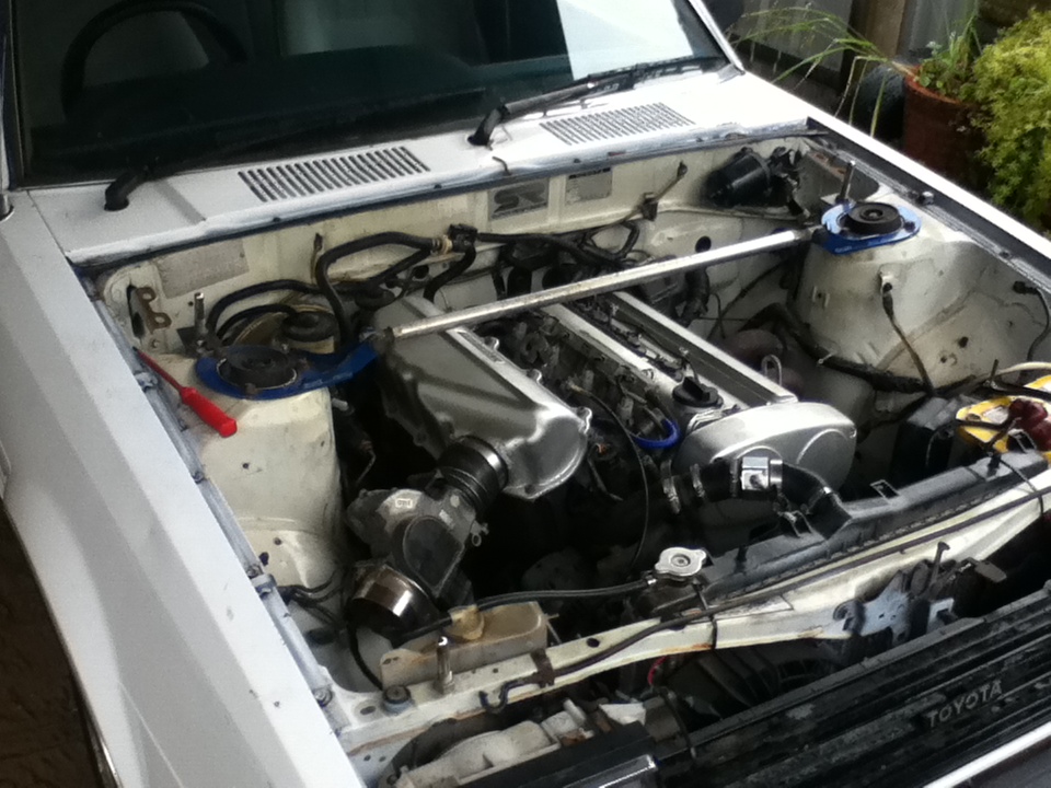

been cleaning up heaps of wiring on the car cause its not the best.

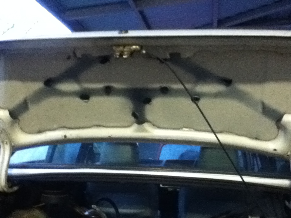

also welded on some fully hectic bonnet pins onto the other two corners of the engine bay so i can take the bonnet right off easily :P

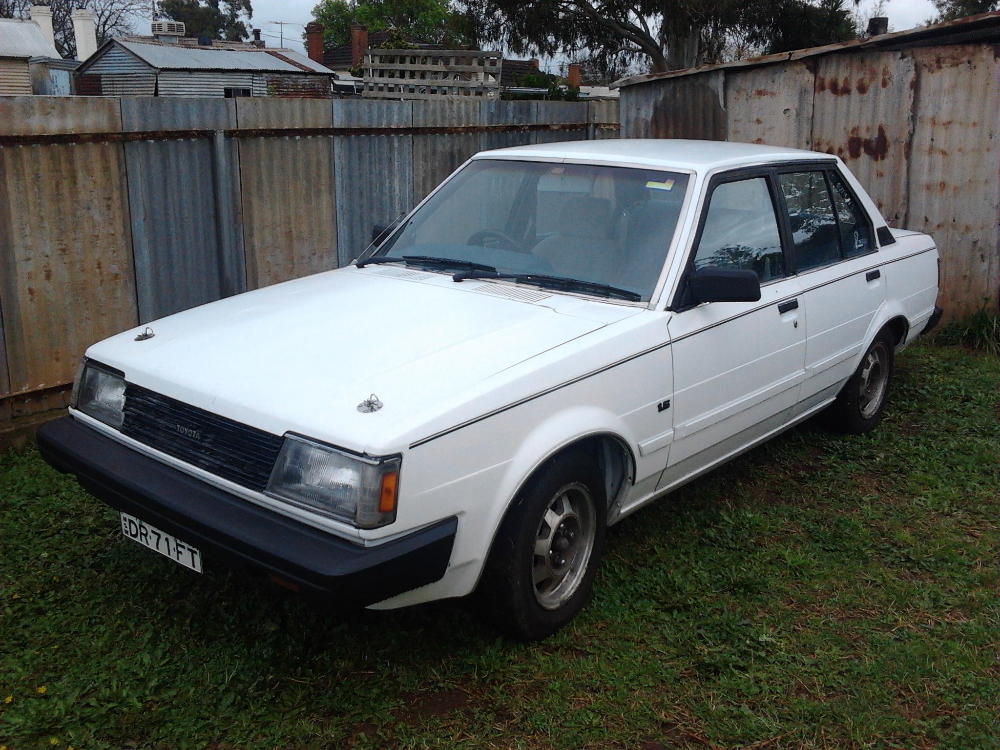

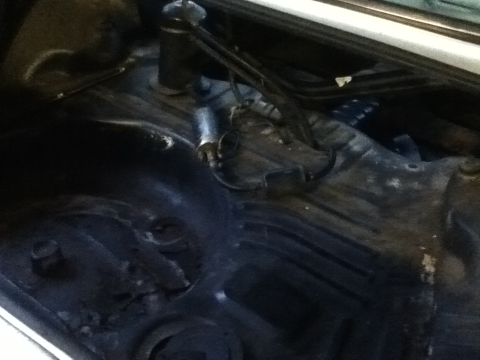

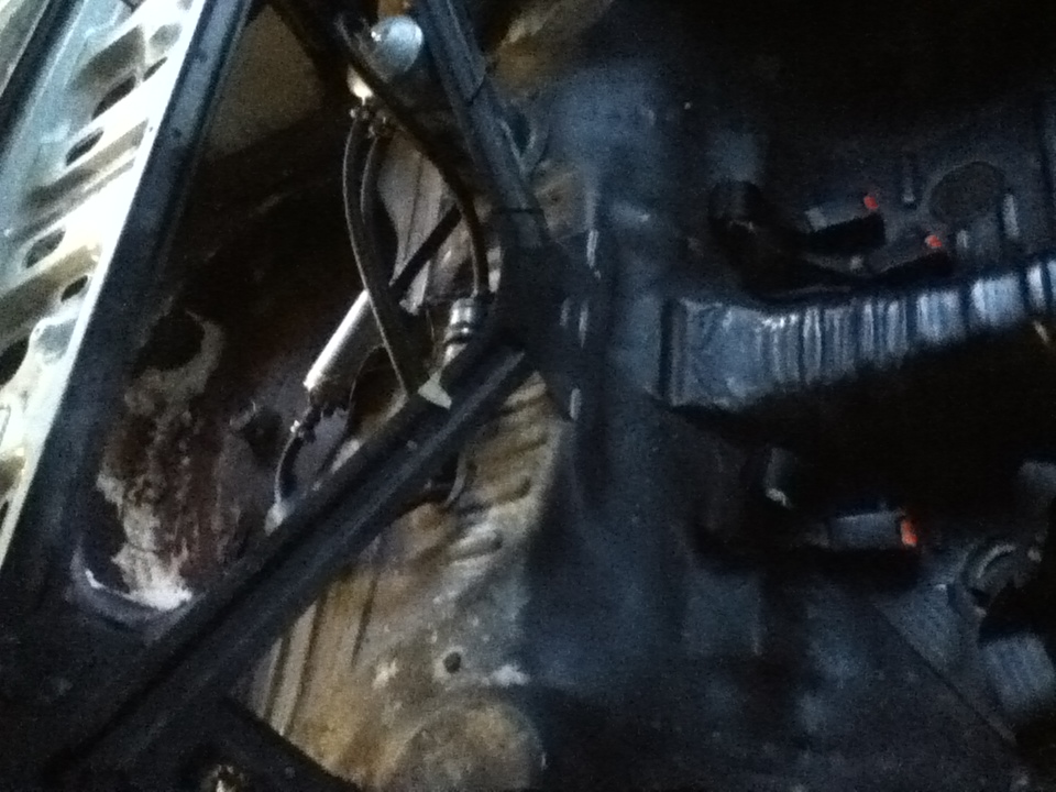

started strippin the rear half of the rolla tonight.. i figure if its going to be a track car than why have all that extra weight ?
found a pretty nice suprise when i lifted the carpet, someone else has already stripped all the sound deadening off and painted the floor flat black, saves me doing it :y:
sorry about the crappy photos i only had an ipod handy
Edited by dbr11k
