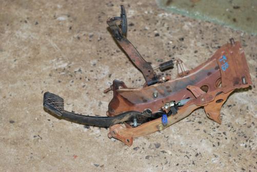

And tomorrow I'm finally getting the T18 pedal box welded up so the steering column lines up properly.

Taking the pedal box out for the 2nd time :bash::
Pedal box out:
Hole for clutch master:
This afternoon I took the T18 pedal box around to where my friend works so we could weld on a new bracket for the steering column to bolt to, but just as we were ready to cut the bracket and weld on the new section the power went out lol. So I left it there and he said he'd do it one day after work, he's such a nice guy!

Today me and my friend decided to finish off the pedal box, here's how that went:
Original steering column mount:
Steering column mount removed:
New steering column mount made:
My friend welding it on:
I don't actually have a pic of the finished product but here's a comparison (though not a very good one) of how it sits in the car:
Original pedal box (you can see the steering column pushed all the way to the right, preventing the steering column cover thingy from fitting on):
Modified pedal box (now the steering column is straight, thus the steering column cover thing fits on):
