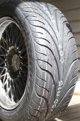

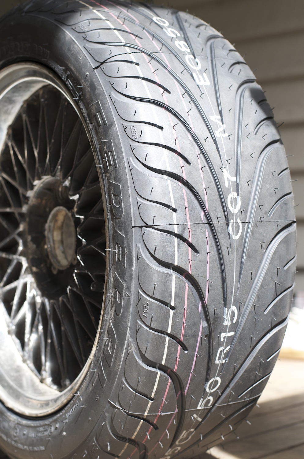

195/50r15 Federal 595 RSRs on 15x7.5 +15 Work Ewing mesh. The tyres smell terribly similar to cow poo, I drove home with them on the back seat of my daily and it was a bad experience.

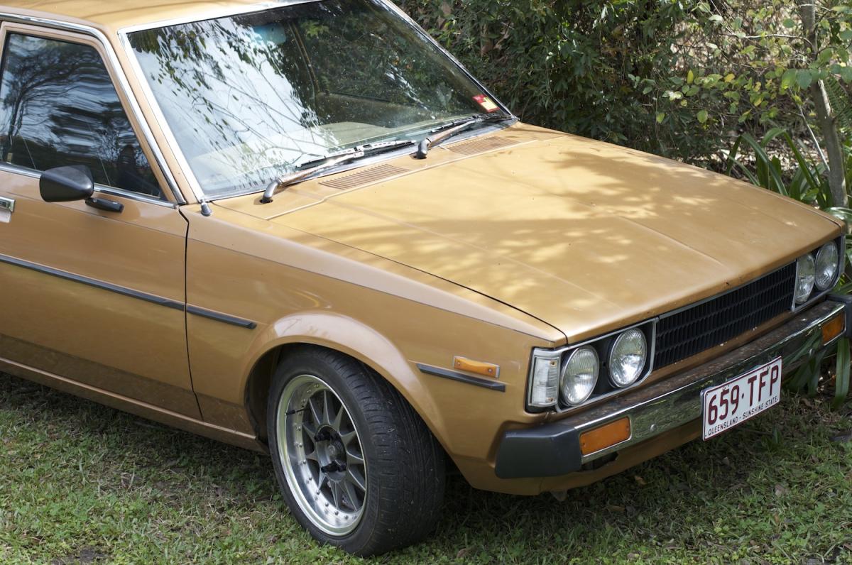

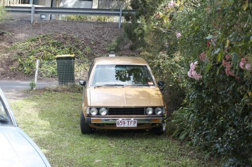

This is the height the car sits with the coilovers in the front, a good height in my opinion. At this height I have good suspension bump and droop on the 5kg/mm springs, I'll calculate roll centres when I can be bothered.

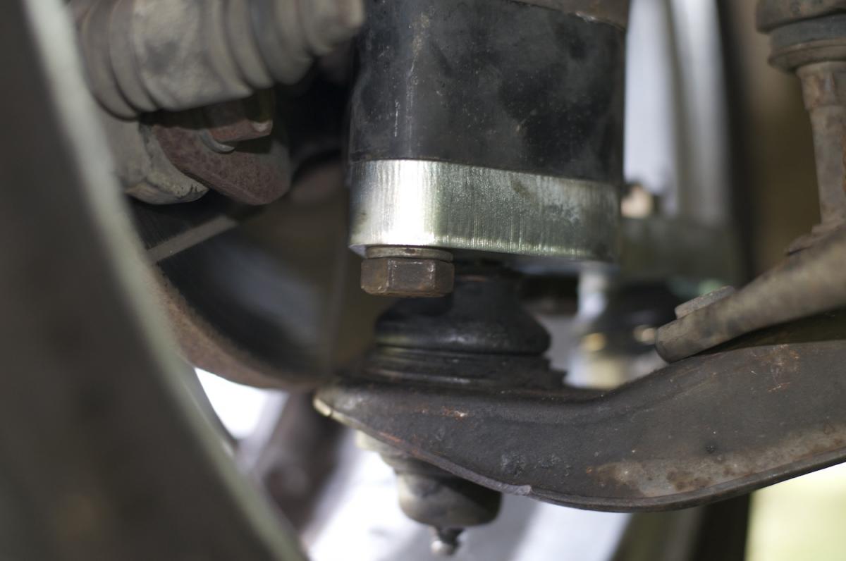

The T3 steering arms and AJPS RCAs. The steering arms are a fair bit thicker and heavier than standard arms, but they need to be because they have an extra hole in them which reduces the cross sectional area and therefore the strength. I'm not sure if I like them, in my opinion the inner tie rod hole is almost unusable because of how heavy the steering becomes, however I have a tiny 330mm steering wheel. I'll try a twincam wheel before I make a conclusion.
And this is the front end, I'm yet to fit the Kamei front spoiler and paint the bumper bar black.

And how do you rate the RSRs?

I dunno there sitting in the garage still haha

What do you think of the RCA adjusters? They look pretty raw, steel or aluminium and did they come with longer bolts? I was going to get a set, but if they are just a piece of aluminium cut cut to shape with some dowels I might have a crack at making my own haha.
The RCAs are good, they're black anodised 6061 alloy and they come with the correct size high tensile bolts.
I've seen RCAs custom made (home job) from low grade alloy, they were pretty banged up because the alloy was soft. If I were making them I'd make them from 6061. Would be way easier to just buy them haha!

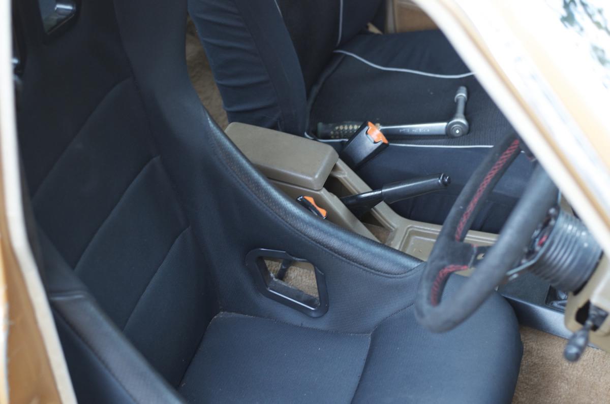

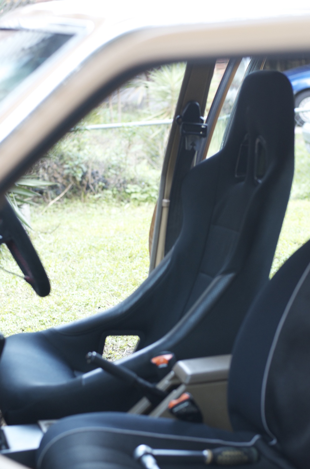

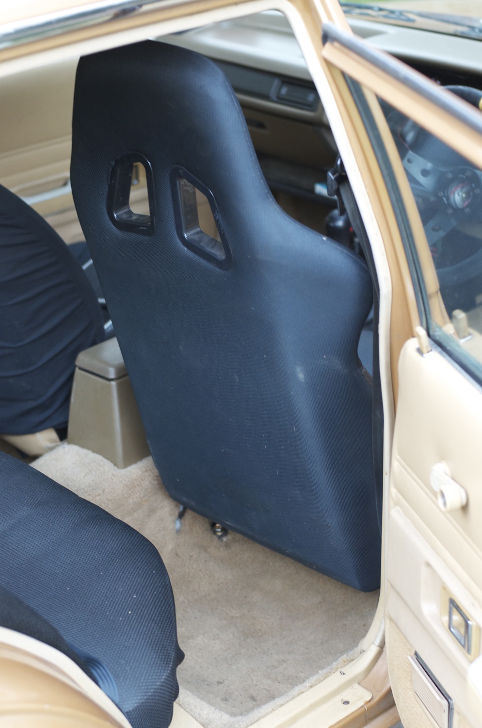

Also installed my fixed back seat this afternoon...
SO. MUCH. BETTER!
I'd never had a proper seat before, the car feels way better to drive. Before I used to think the 5kg/mm front and 4.5kg/mm rear springs were soft, now I realised that it was just the springs in the factory seat that were soft!
Only problem is it's not an ADR approved seat, so I either leave it in and cop a defect notice at any time, or leave it out and just take it to the track on the back seat and install it there, which is what I think I will do.
