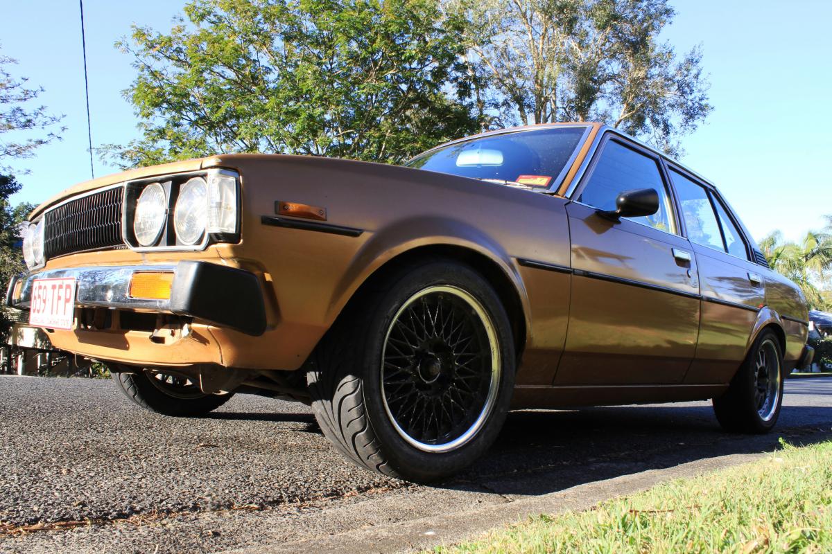

If you guys recall on page 26 of this thread I posted that I bought a pair of these 15x7 +19 Hartge wheels:
Well I somehow managed to purchase the other pair off the guy who owned the set before the guy I bought my pair off. He initially wanted to buy them off me to add to his pair and complete the set, but I refused and then somehow I ended up with a full set! haha so stoked. I'm really digging these wheels :elvis:
