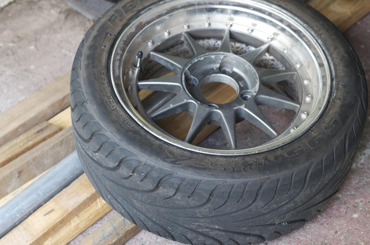

I got the 595 RSRs put onto the Hartges (excellent tyres for the money).
