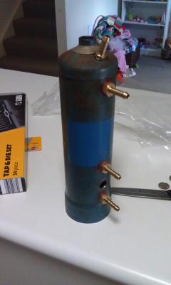

?? I don't know man. I wouldn't know how to make a surge tank. You look you're going well though.
Just had an idea to maybe stick a pressure meter in that last hole.
Won't work as it is only an external fuel feed, if you had it where you were pressurising it then it would.
I think this gives "ghetto" a whole new meaning!Best of luck and I hope it works for you but I would have thought that the side walls of the bottle would be to thin to hold a tapped thread and allow for reasonable tightening of the fittings?

I have done 2 4AGE-KE38 conversions years ago & still have the Manual in the pic below , I bought this to wire the cars up using the Factory ECU's , My one I fitted a Speed Sensor to the Speedo cable & My mates one we didn't , Everything else was Identical , My car pulled harder & definitley had more top end than his , Neither of these 2 wagons had Surge tanks & in both when below 1/2 tank Cornering would cause cutout/missfire too , Definitely needed them ,
I noticed your not running a Oxygen sensor either , this is crucial to get Air/Fuel ratio's correct , Running without these sensors put the car in Get home/limp type Mod , Add the Oxy , Speed sensors & tune it & I think it should go better ,
