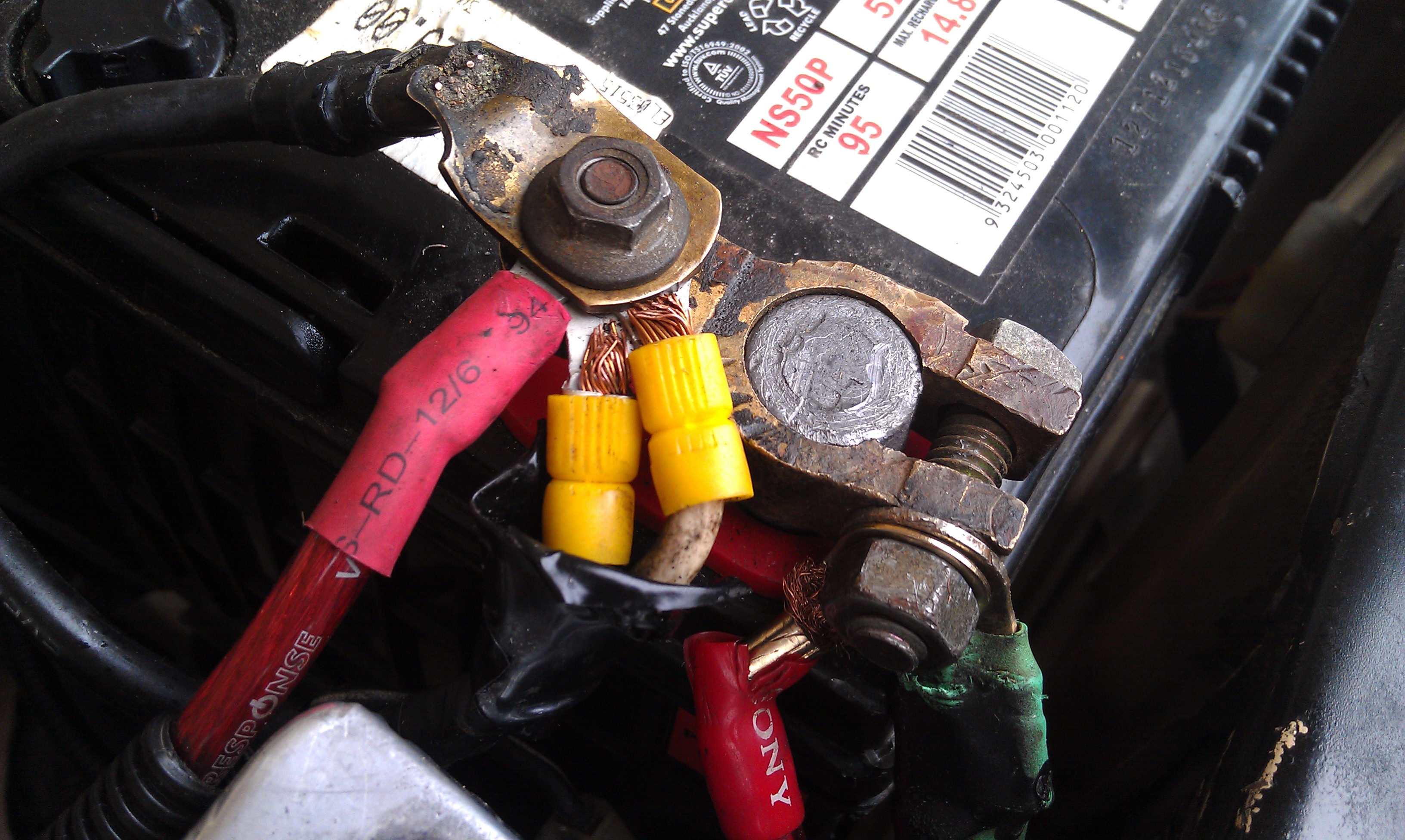

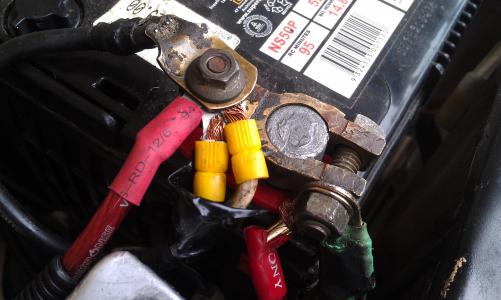

I ended up putting my ecu into his and it did the same thing (FARK) so we swapped his back in, I ended up just doing a diagnostic and ECU reset on his and the problem went away.
Do a reset and see what happens, use number 2 in 'my personal addition' http://www.rollaclub.com/faq/index.php?title=Series:A/Model/AE80/82/4age_Diagnostic_System
To this day I am still stumped as to why mine did the same thing but ran fine in mine, I doubt that resetting the ecu resets the toyota sensors aswell.
I've unplugged the ECU from the loom completely so its sitting in my foot well waiting for me to moltov it
2 different ecu's, one from my car working perfectly but replicated the same thing, just plug it back in and do the negative terminal.
Ok so it seems all she needed was to reset the ECU.

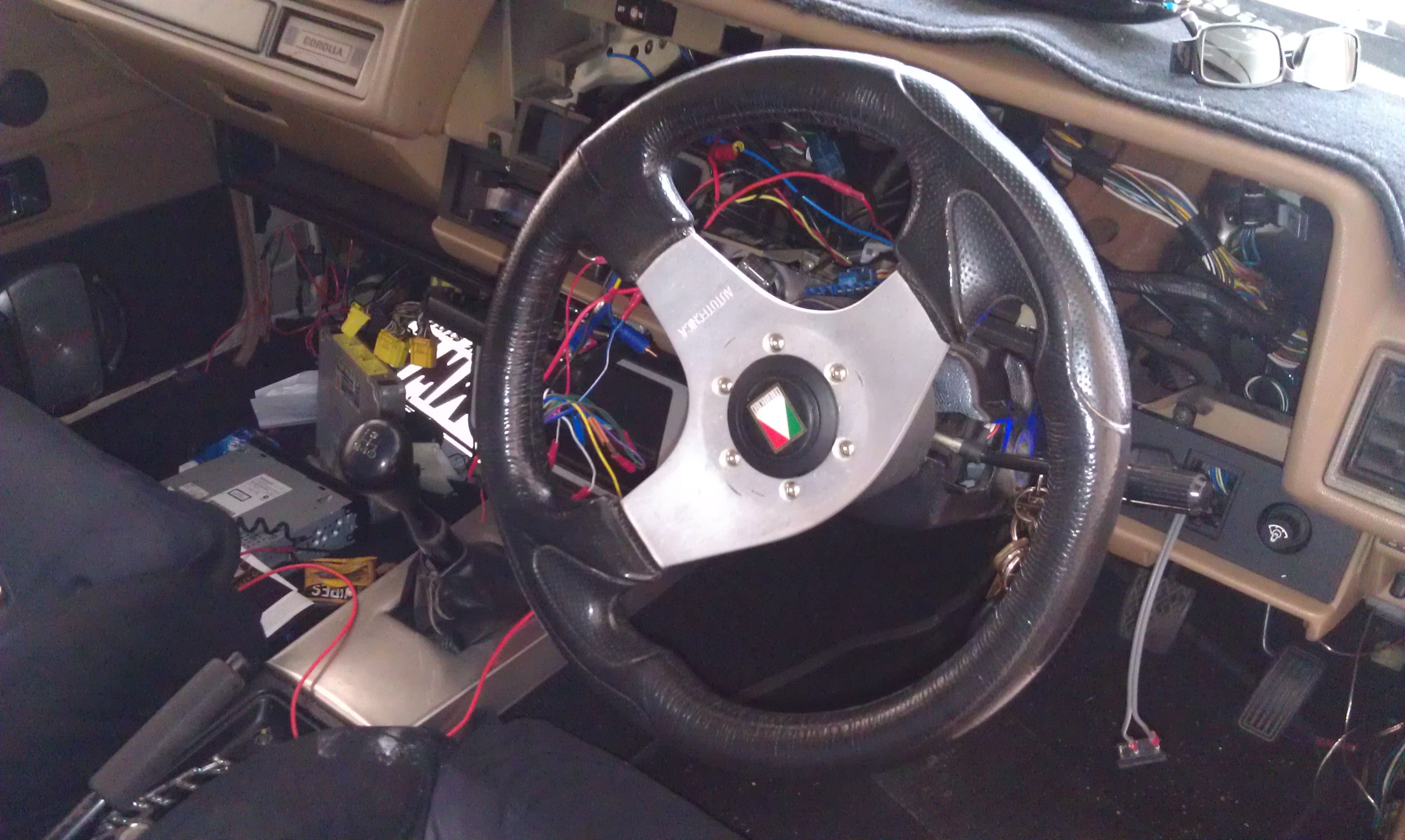

I unplugged it while I redone all the dodgy as wiring.

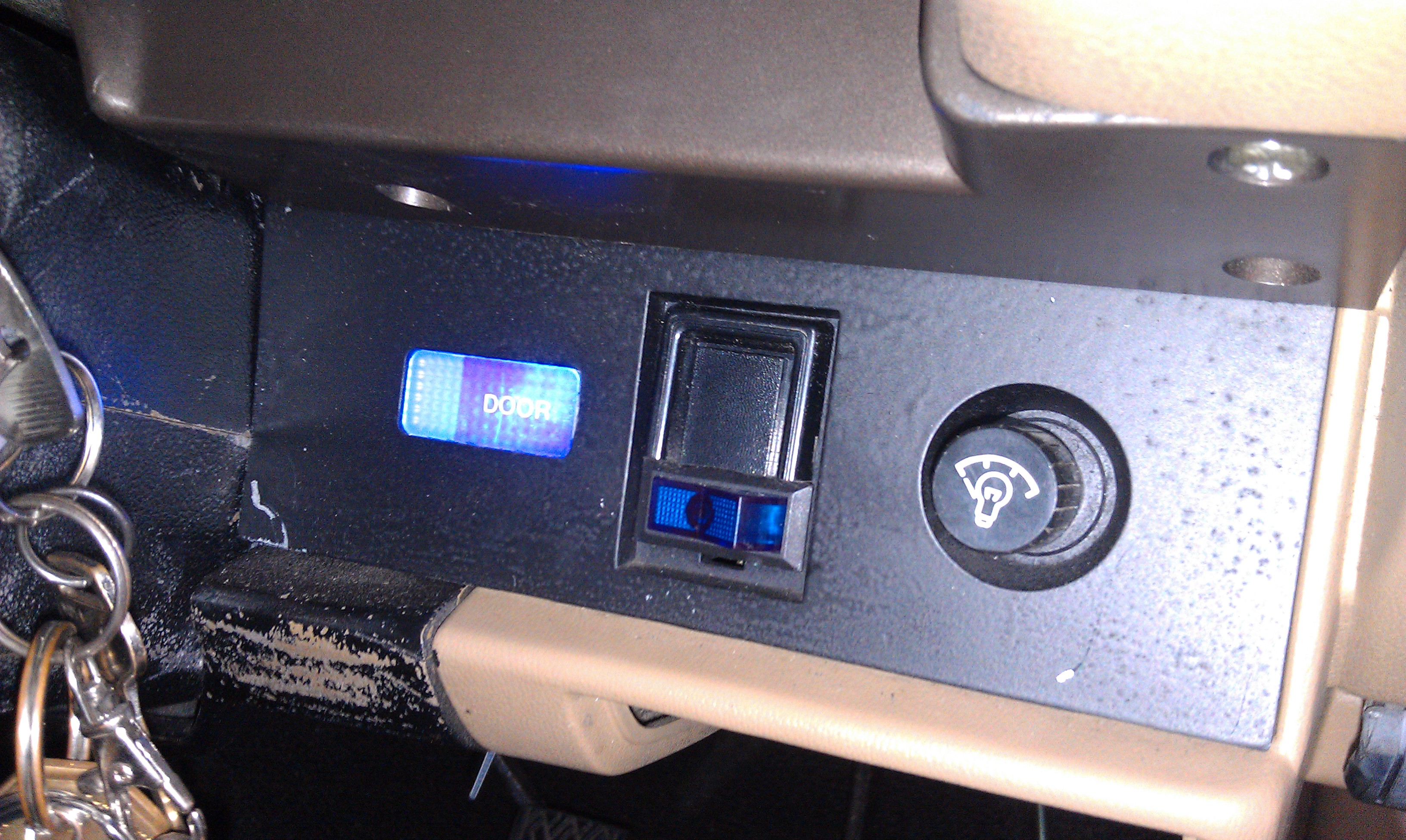

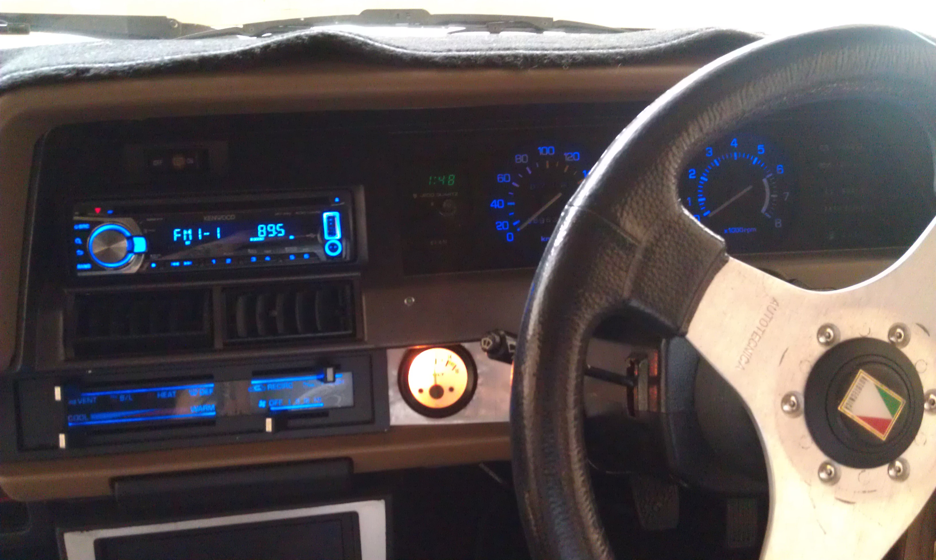

Put my blue LED's in while the dash was out. :cool:
And mounted the thermo switch inside the car.

The switch you wired up the thermos to, was that there from factory? Reason I ask is my AE71 has the exact same button. It has a picture for fog lights, however my car didn't fog lights but had wiring in the front for some...

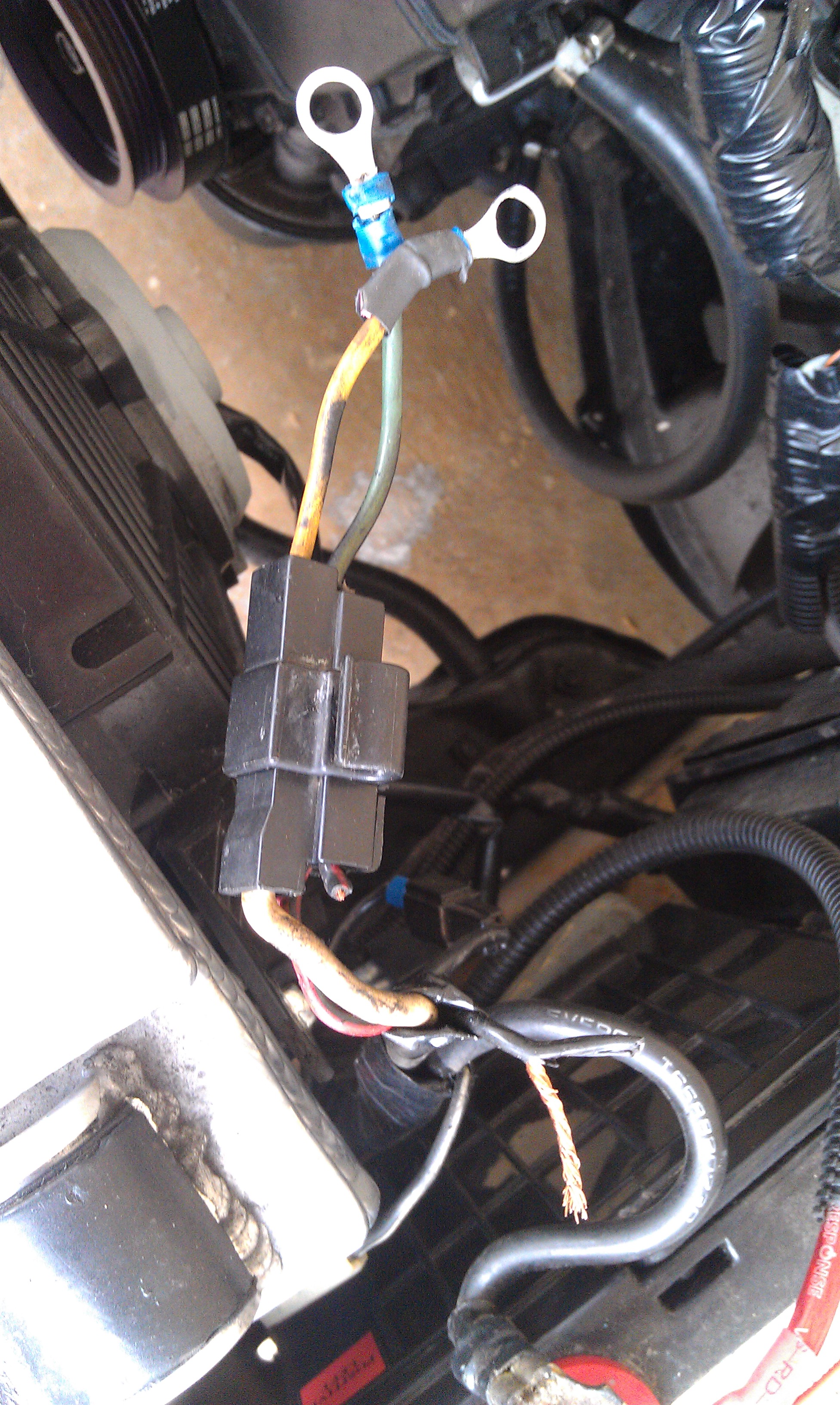

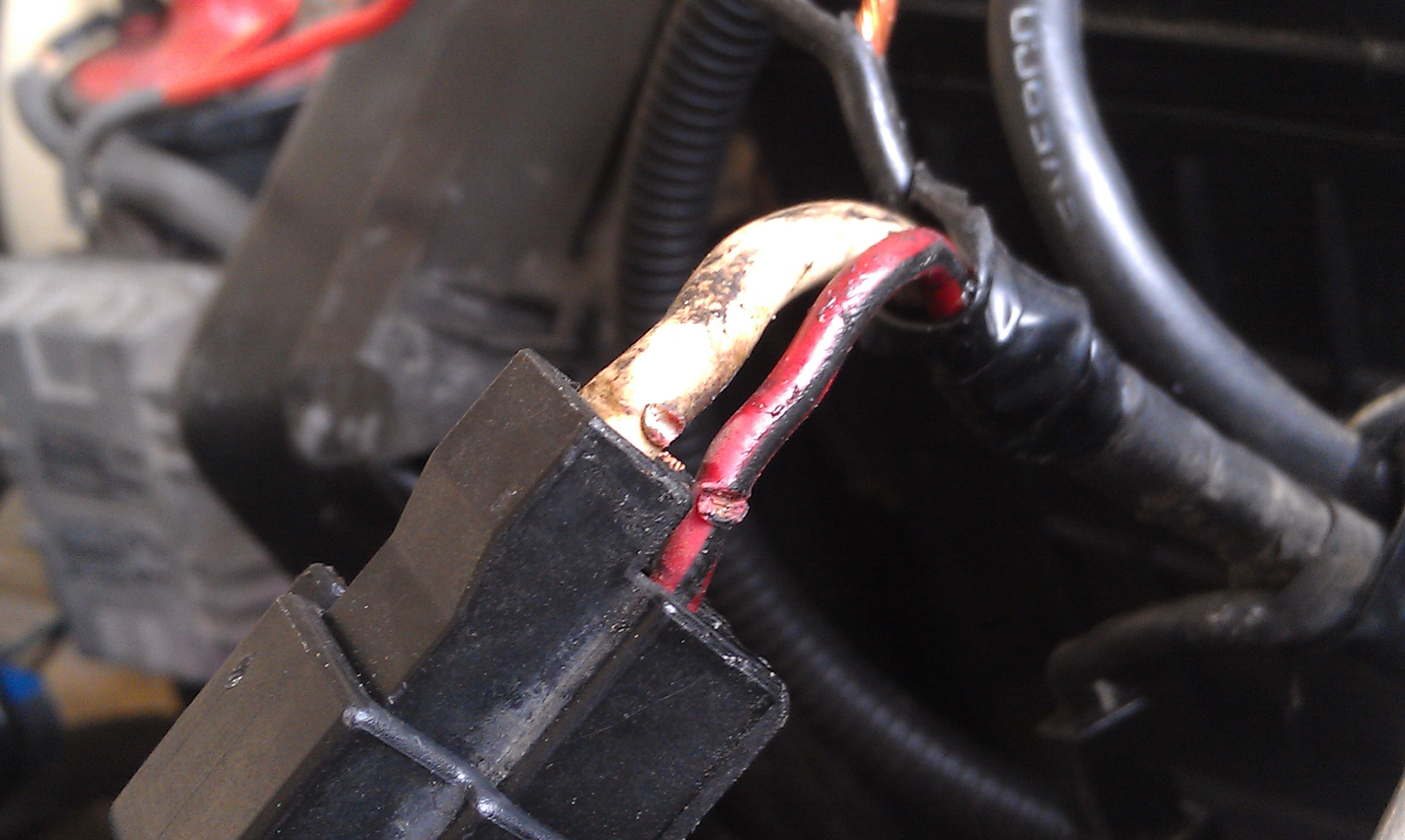

Trev just walked me through it (I'm sober ) so I think we nailed it.
I'd wired it up like an idiot. Powered a wire that shouldnt of been.
Seems good now.
