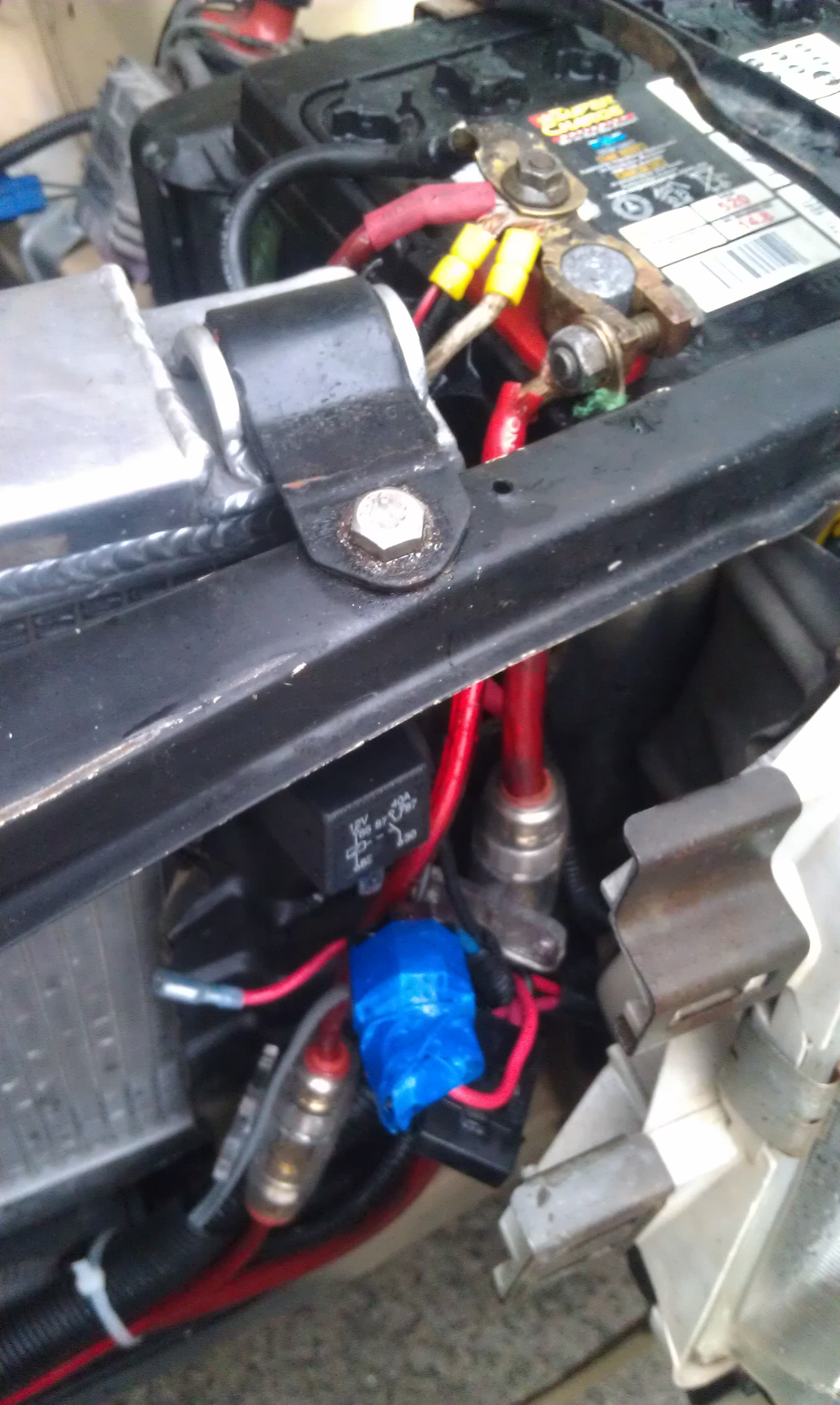

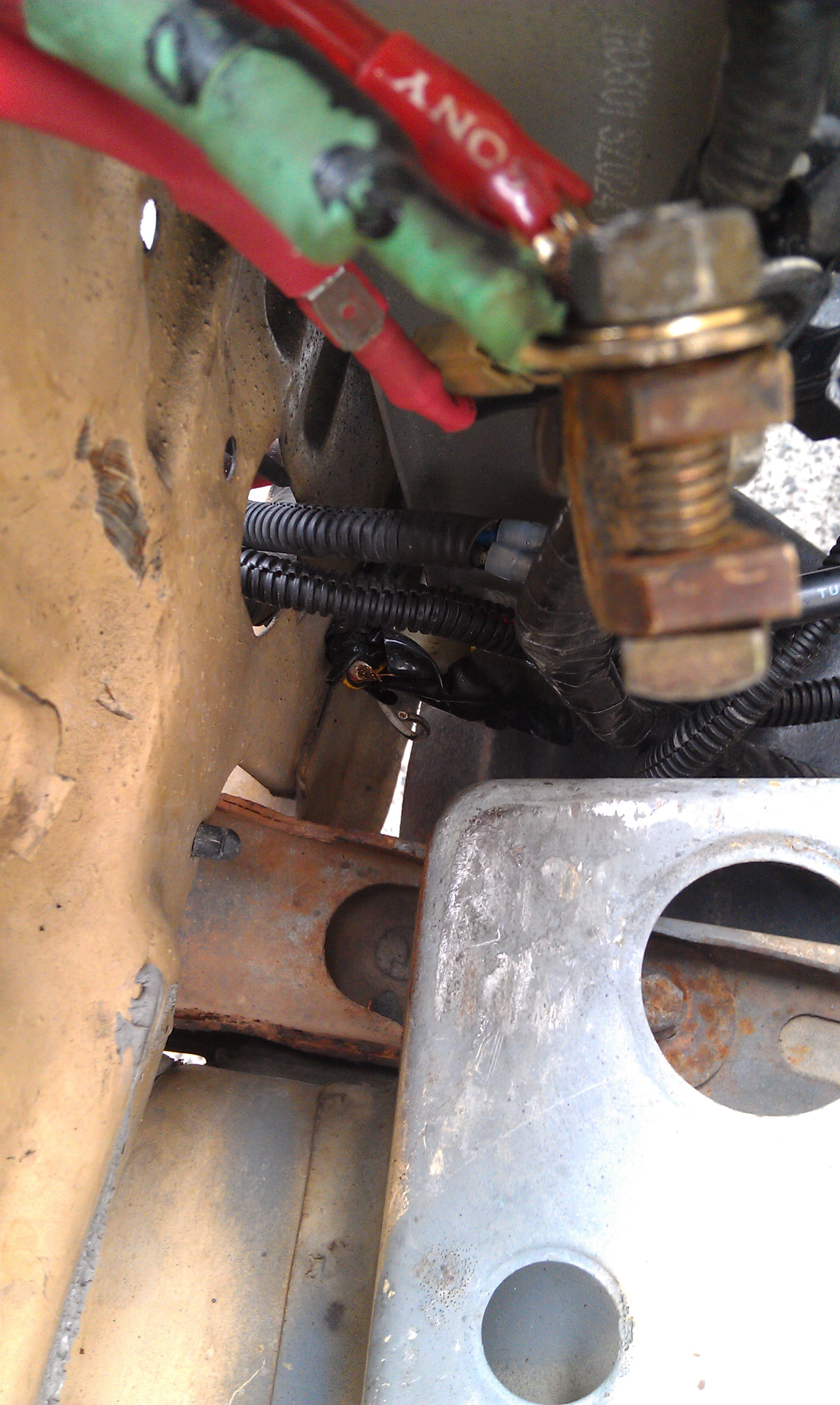

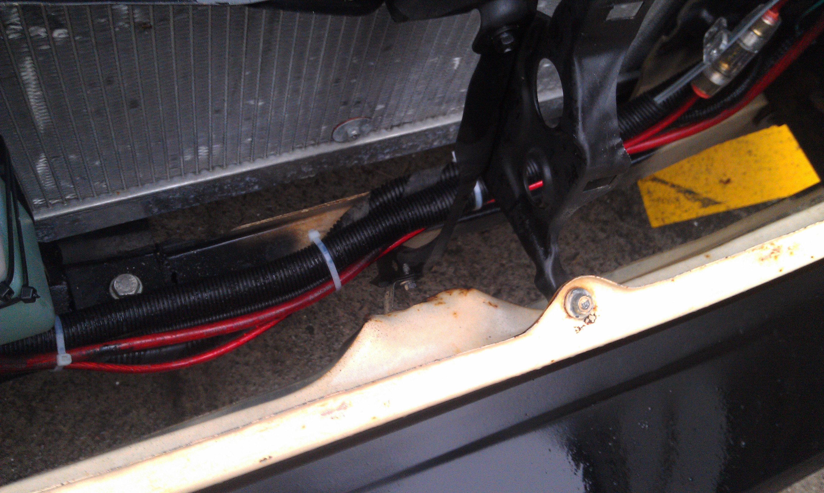

Ok so the alternator wasn't getting power. Traced it back as far as I could but couldn't find the problem. The main charge cable snapped because of some of the shittiest wiring ever. Had to pull the rad out to get to it.
Couldn't find a good 'run' power source for the alt so I've tapped into the main engine fuse next to the steering wheel.

It's amazing all this seemed to happen at once but I think it stemmed from the main alt cable shorting shit out.
The main alt charge cable was about 6different pieces all wired together. Gettouh azz bruz.

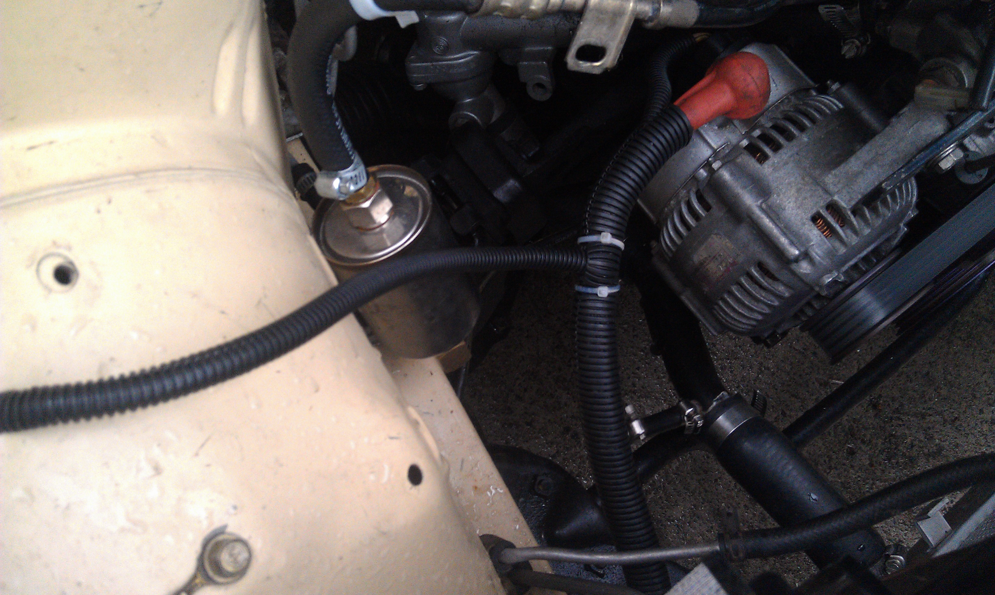

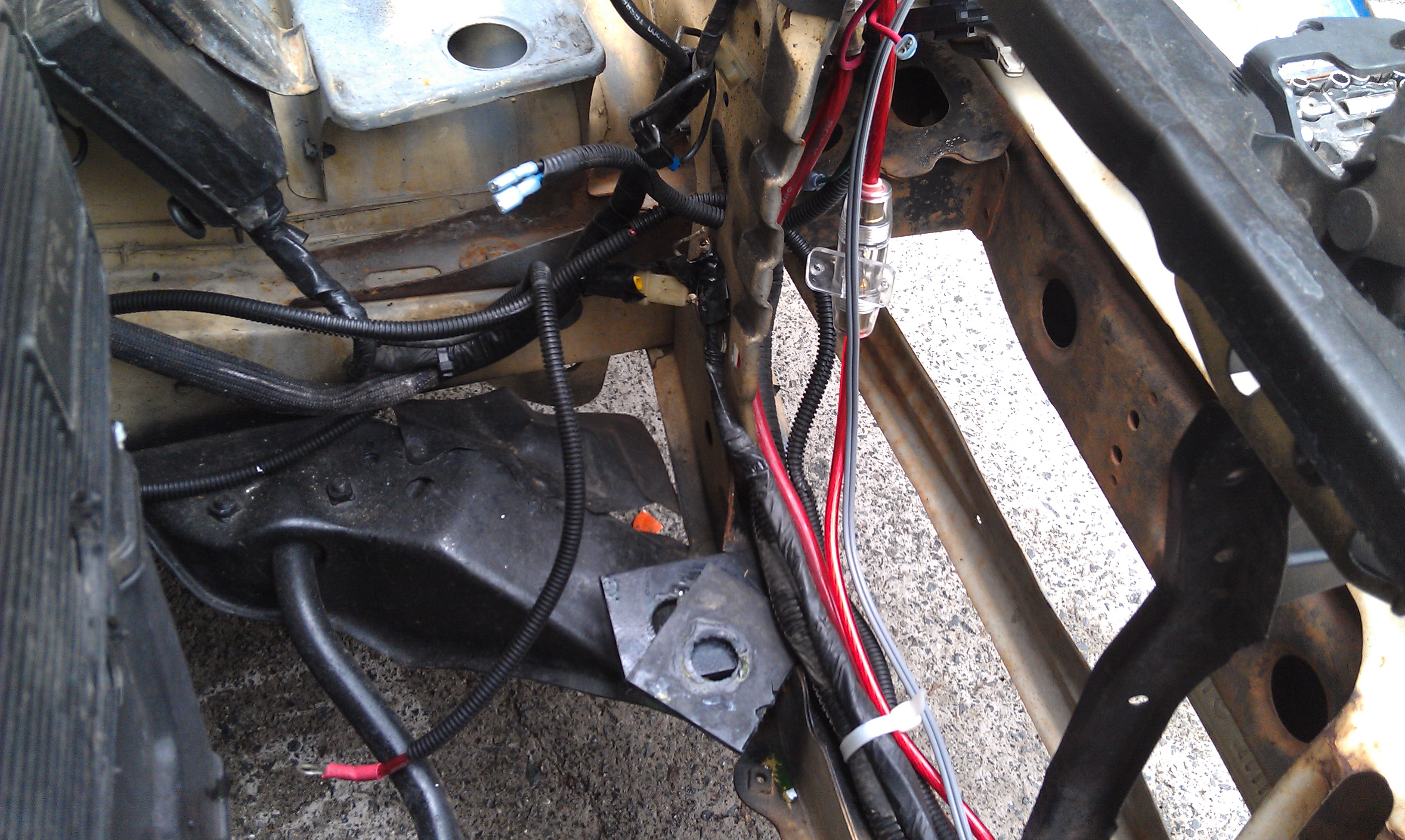

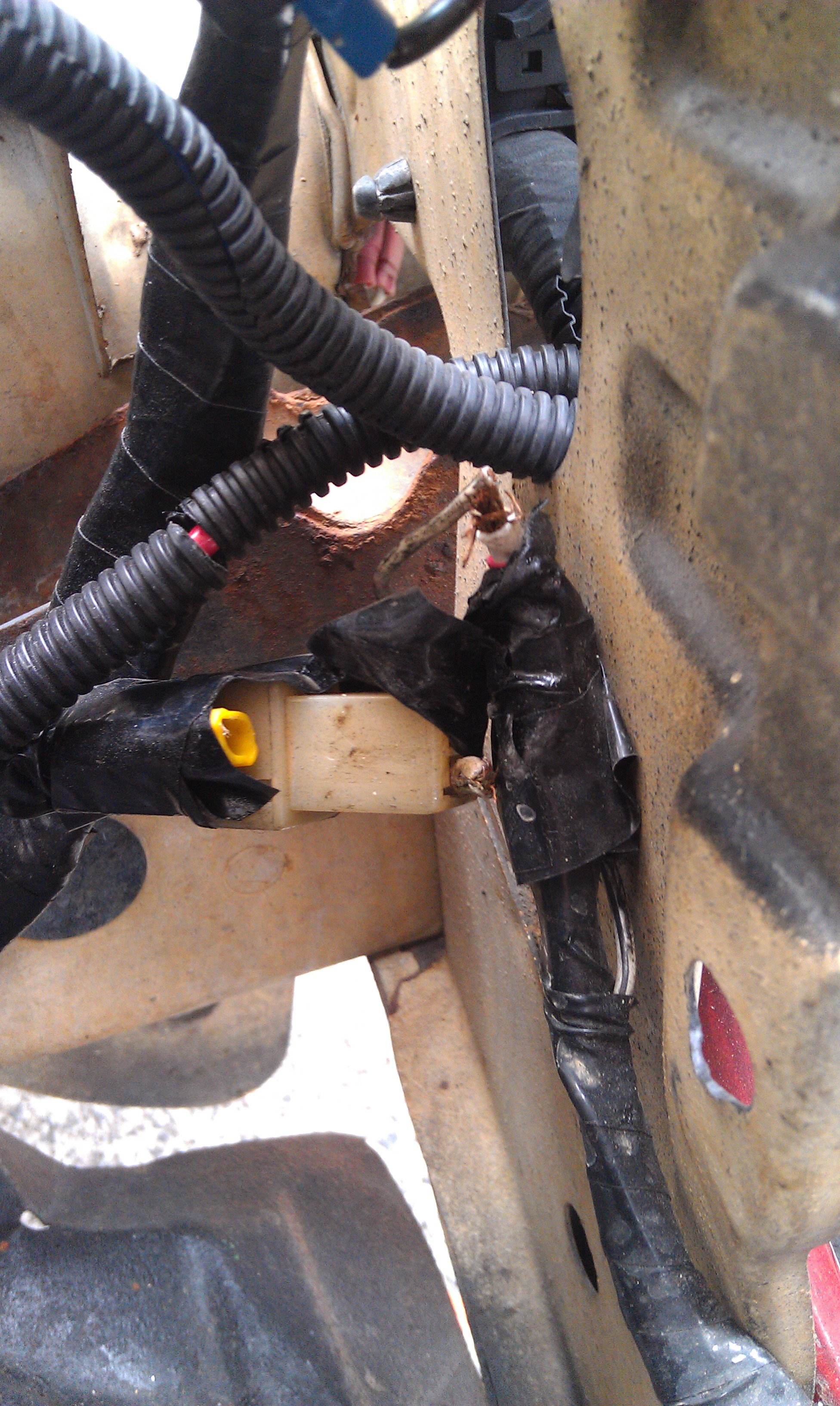

The dodgy wiring was down near the radiator in the worst place.
Had to pull the rad out. Rewire all the dodgy.
This bit was sandwiched between the rad and chassis.
Prettied it up a but.

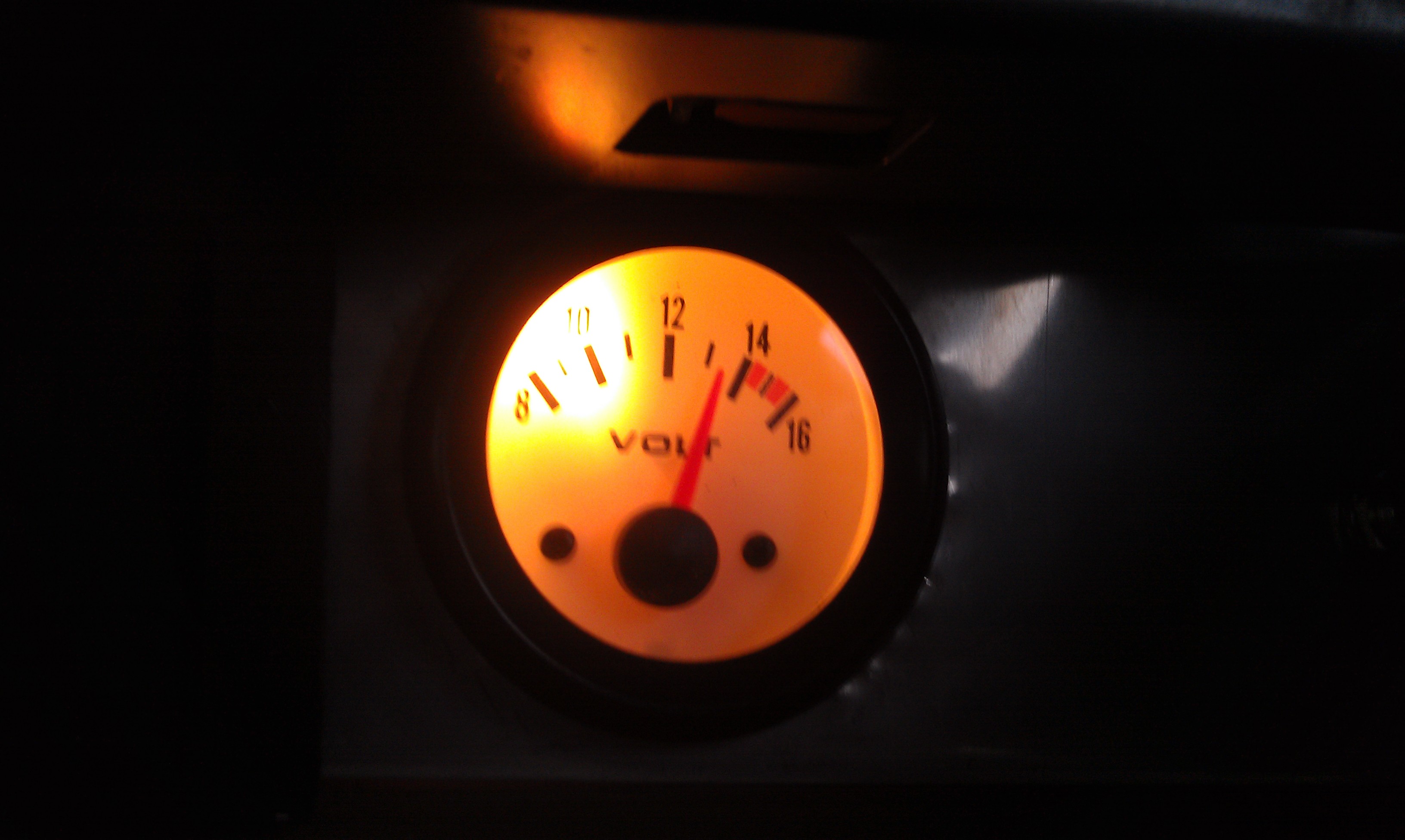

Getting good charge and idling at about a grand.
