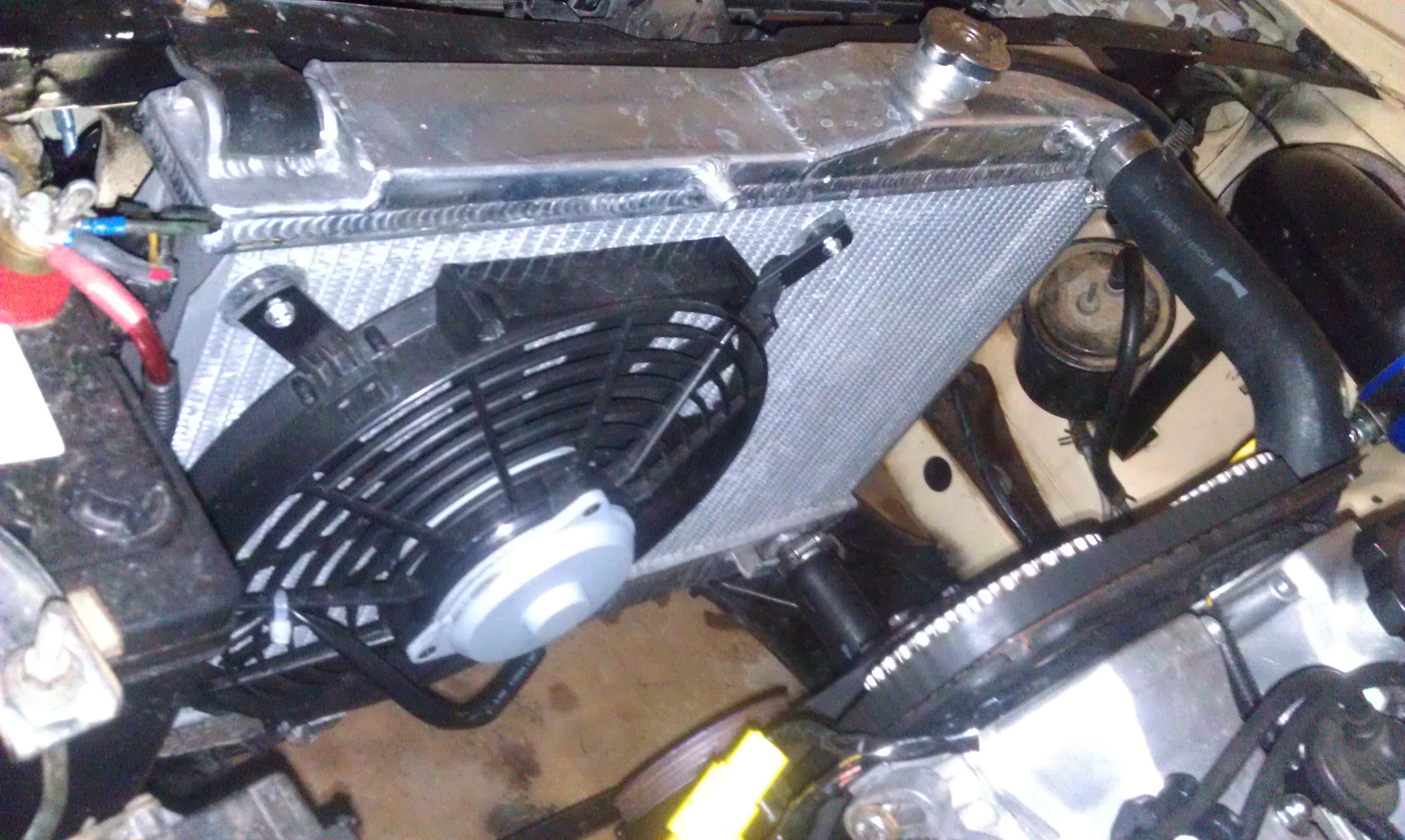

B.L.Z.BUB Posted December 7, 2011 Author Report Share Posted December 7, 2011 (edited) Yeah it worked a treat, I did some reading up and it seems a pretty common problem. My new problem is my idle, I think the radiator is doing too good of a job. Barely registers on the temp gauge (yes its working fine). May need to block some of it off to get some more heat in the engine. Edited December 7, 2011 by blzbub666 Quote Link to comment Share on other sites More sharing options...
RainWarriorDregs Posted December 7, 2011 Report Share Posted December 7, 2011 hey man, good to see you stayed with the rollas. Maybe instead of blocking the radiator up you could try a differently rated thermostat. Maybe a higher temp? Quote Link to comment Share on other sites More sharing options...
B.L.Z.BUB Posted December 7, 2011 Author Report Share Posted December 7, 2011 yeah this is all new to me, its fine driving at low speed but from cruising along the highway to stopping at the lights it stalls out. As soon as there is some heat its fine. Ill have a google about the thermostat and see what I can find. Quote Link to comment Share on other sites More sharing options...
