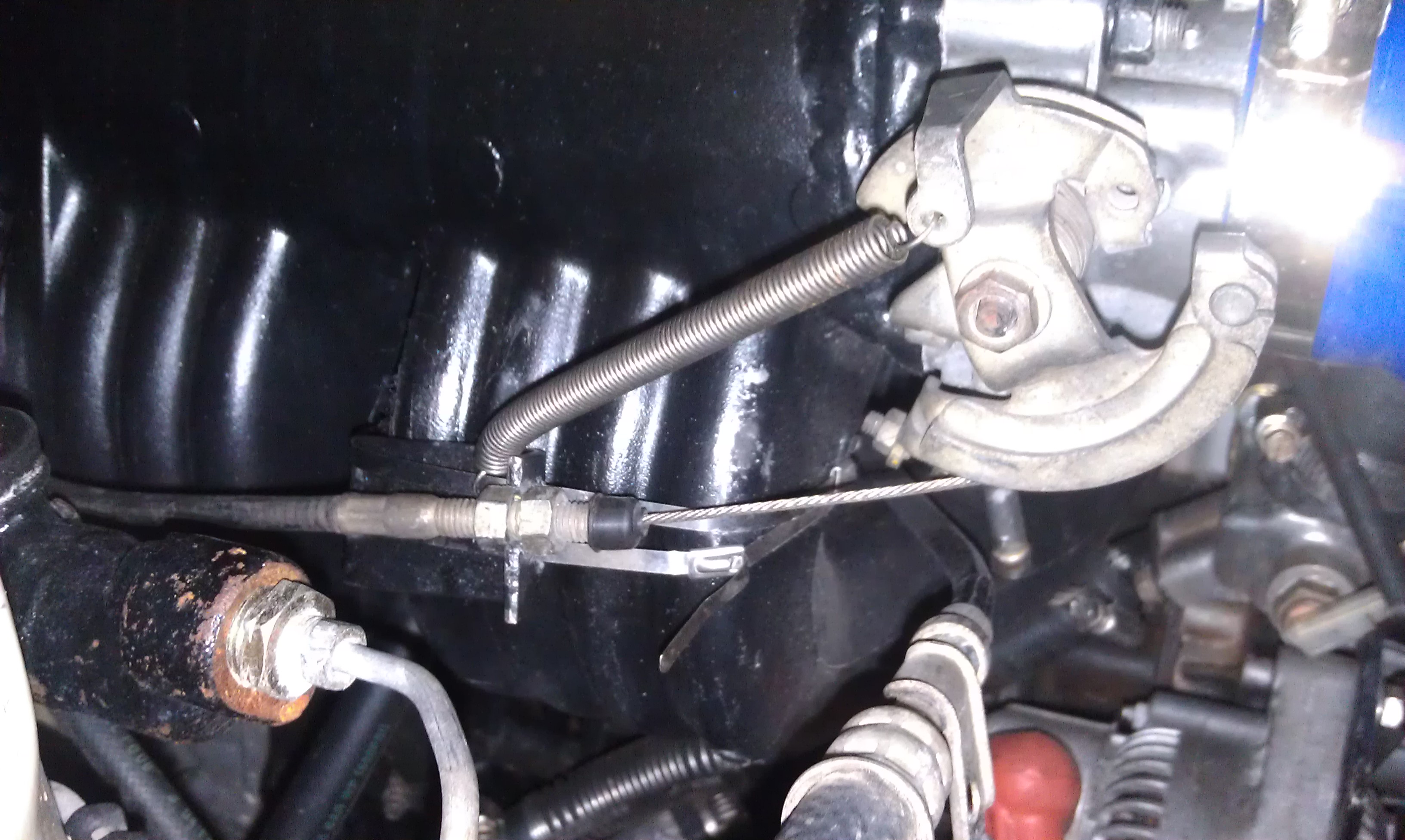

But i got the idle sorted too. It wasnt any map sensors or the "tune" or anything like that just the plain old idle adjustement on the throttle body. Although the lack of an oxygen sensor is likely attributing to his light overfuelling (its not that bad).

As Luke said he adjusted the idle and the tension on the throttle cable. So I have far better response from the gogo pedal and am not constantly stalling out at every set of lights.

The throttle cable mount leaves a lot to be desired, a few metal zip ties. Will need to be sorted asap. I already have a pretty good idea on what I'm going to do.

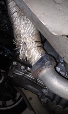

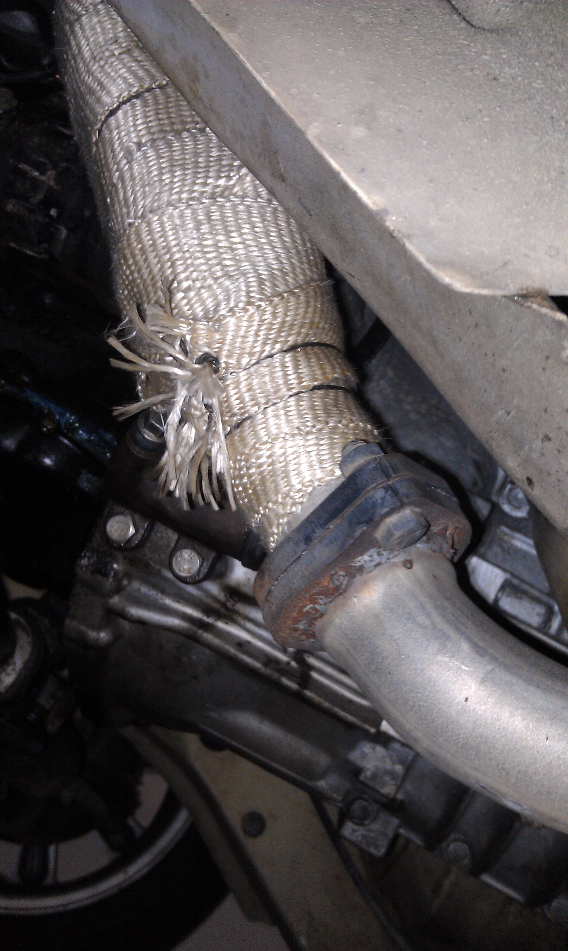

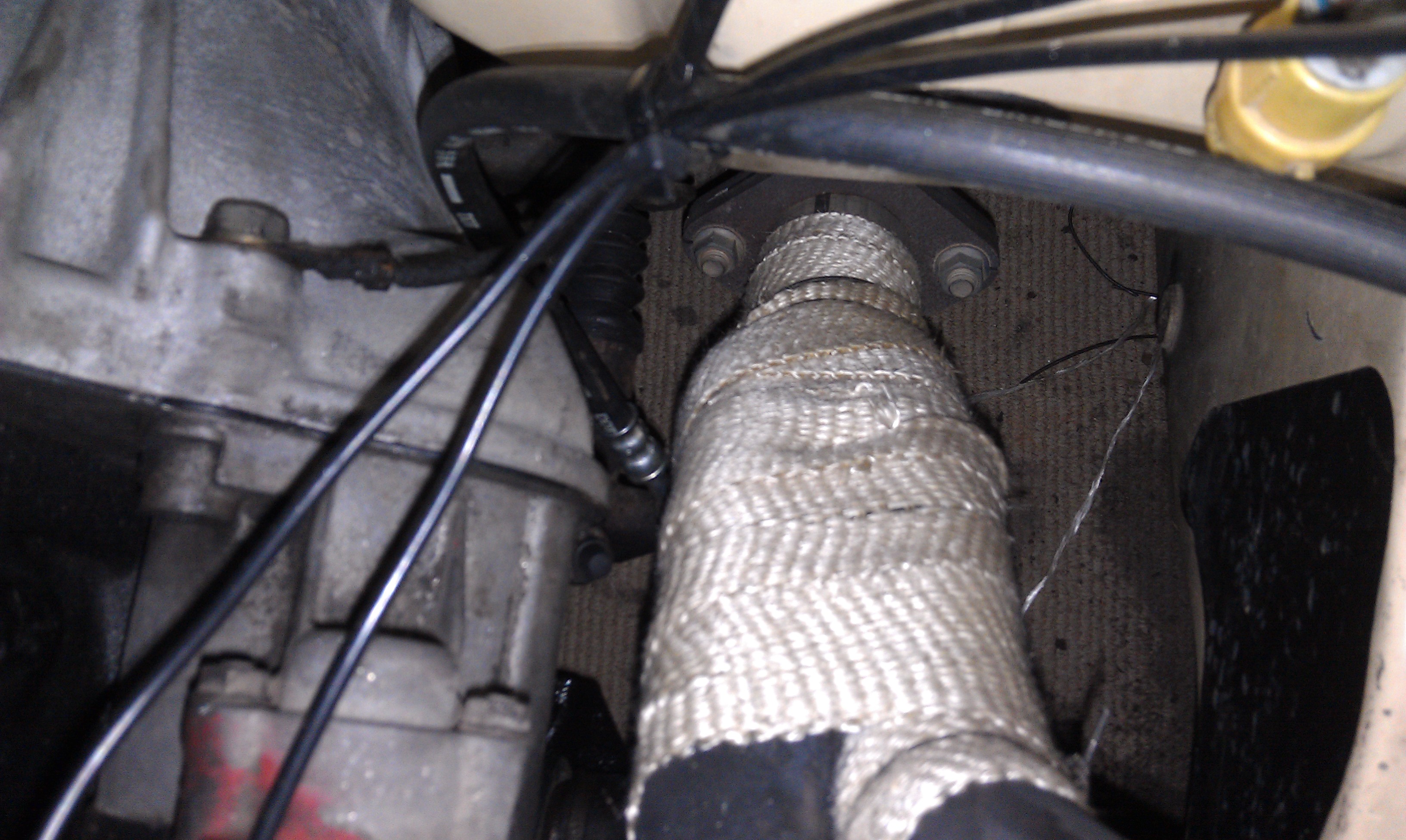

Another possible issue is the proximity of the exhaust to the clutch, may need to be shielded/heat wrapped?

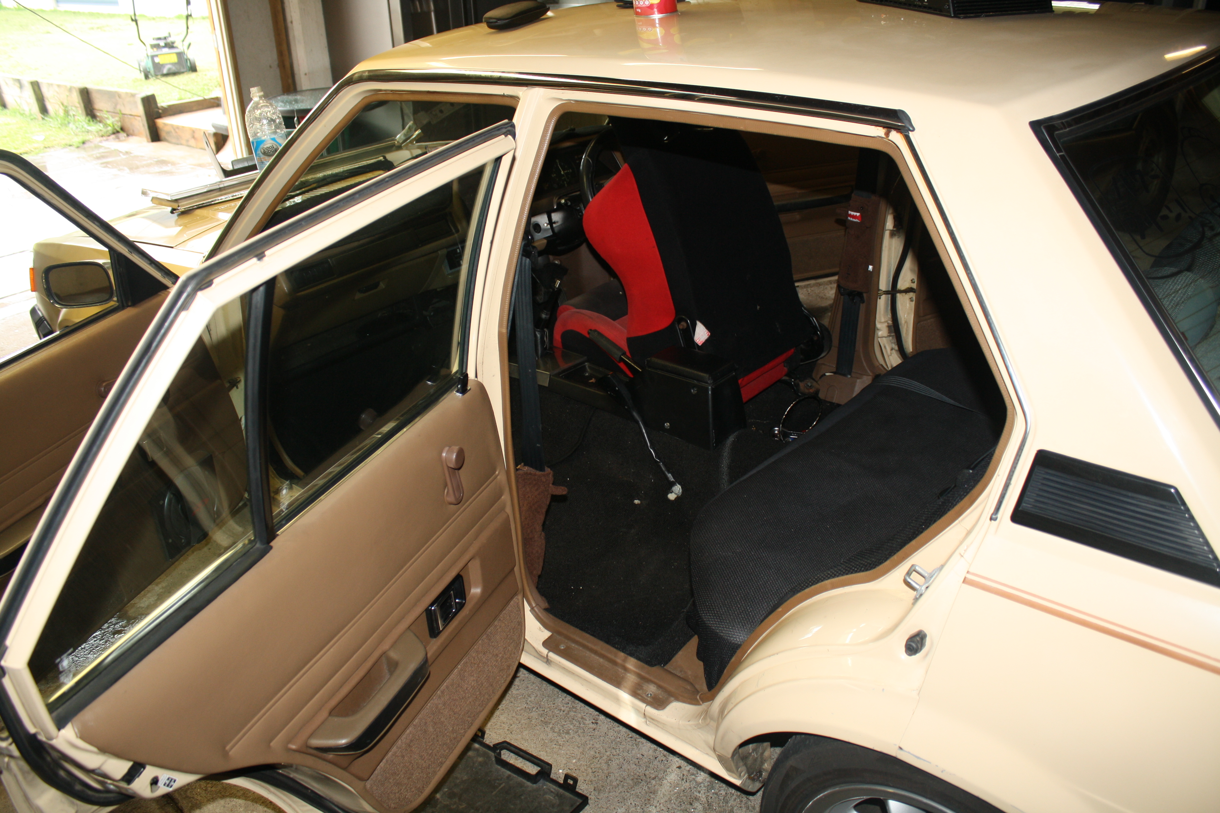

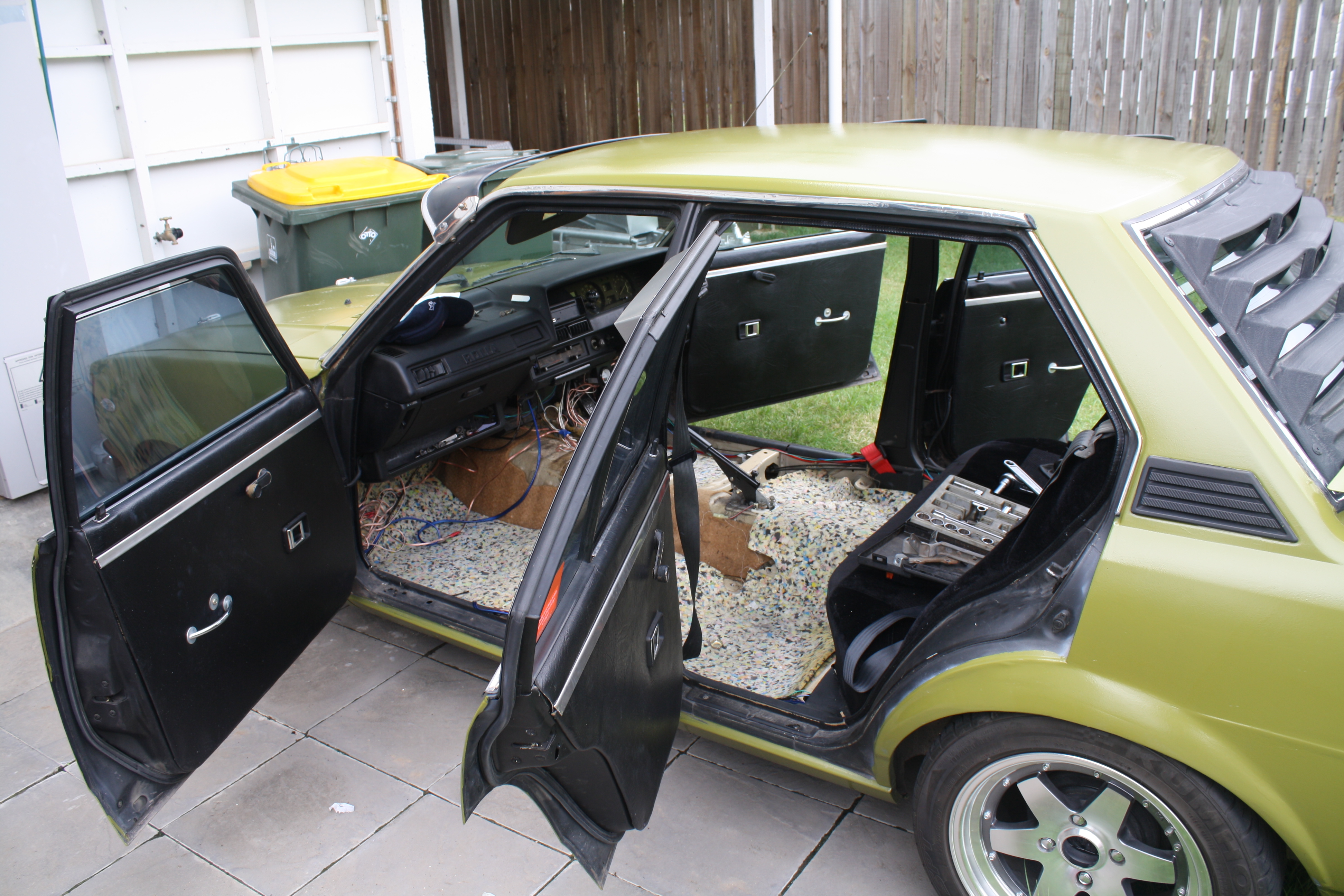

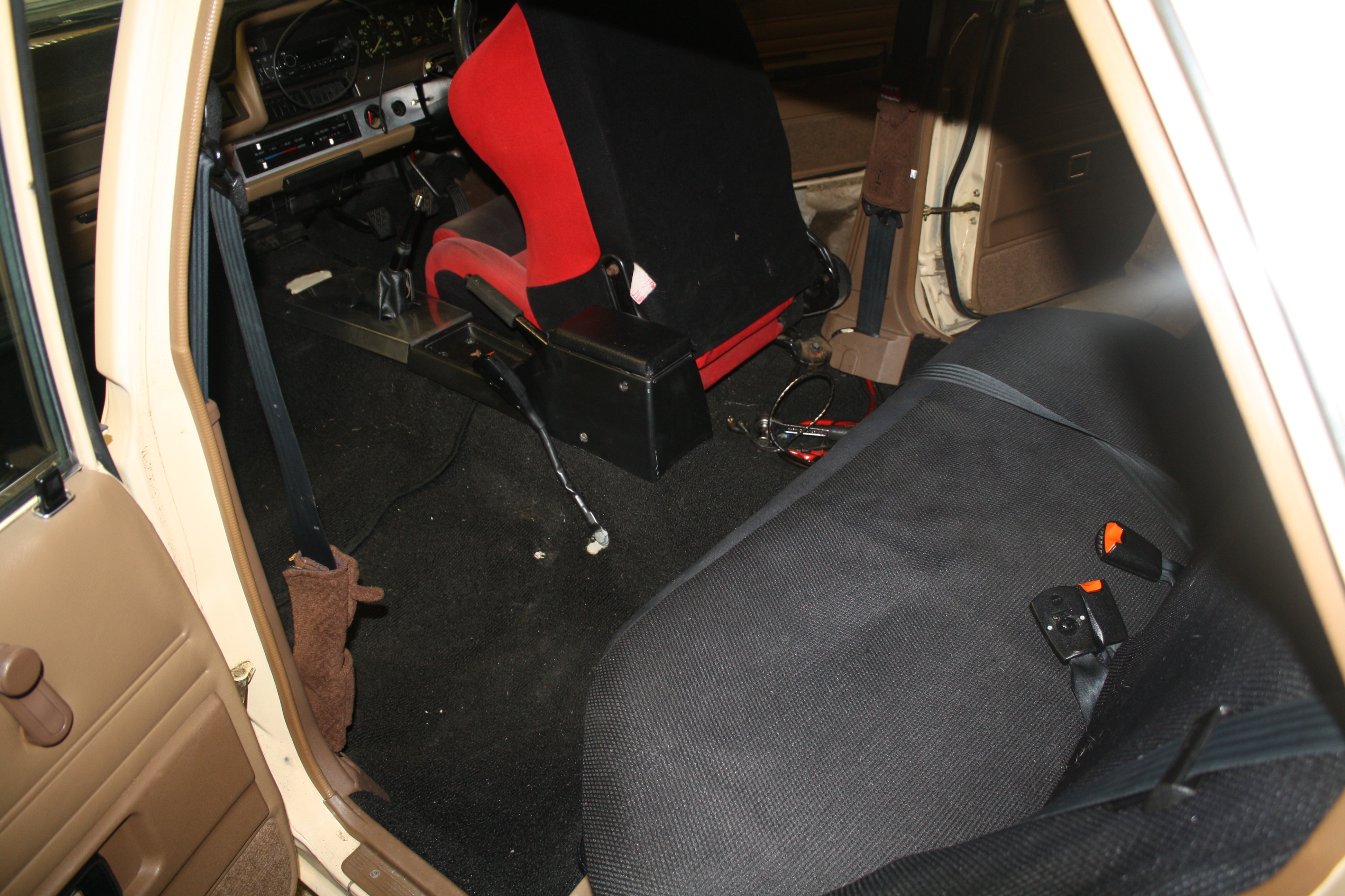

Also the carpet and seats got swapped over along with the steering wheel and center console, so it is now comfortable.

Wanted to get more done but ran out of time.
Looks very good Reed. :y:
Agreed ^ Looks great so far :)

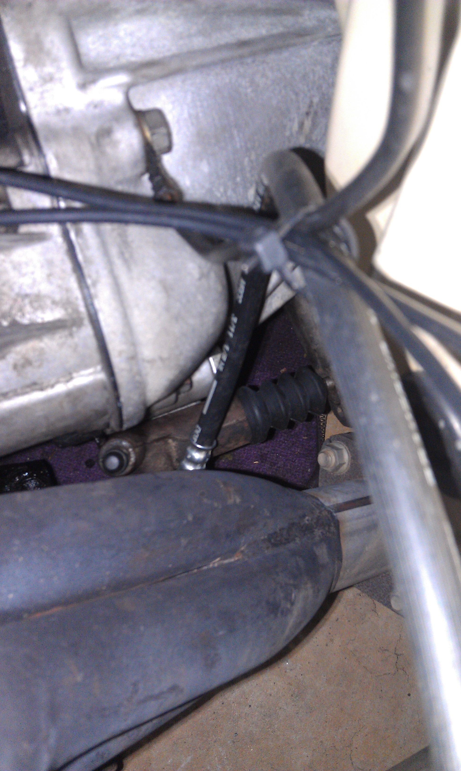

hey mate, here is that photo i mentioned on sunday about the clutch line.
that banjo bolt was like 6 bucks i think, nice and cheap, i can't remember the details of it, better of taking the clutch slave down with you to the hydraulics shop etc.

How much heat comes off the exhaust near the slave cylinder now that it is heat wrapped? Can you touch it?
