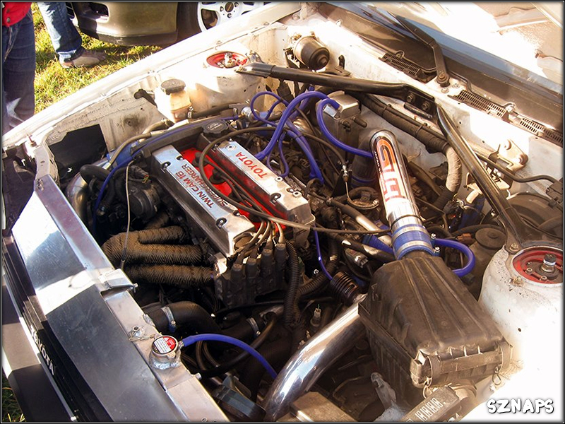

Final engine bay looks:

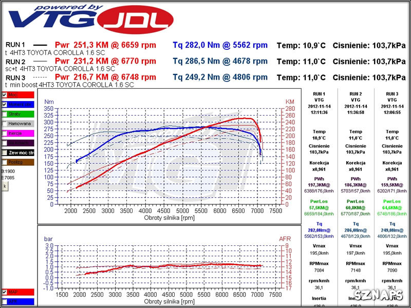

Dyno:
run 3 - Just turbo with piping from supercharger unmounted so turbo sucks air freely. 0,8b so great to compare with old dyno (below) with supercharger on 0,8-0,9b. Actually I think that this turbo is better even at the bottom than the old setup.
run 2 - twincharge - supercharger is disengaged at about 5700. 1,2b.
run 1 - Just turbo with piping from supercharger unmounted so turbo sucks air freely. 1,2b
So twincharger setup like you can see has its limits without the bypass valve - at the top it is visible that turbo cannot suck ebough through supercharger. Next year i will install bypass valve and that will do it. Untill then...:-) It is 20horsies less than just turbo but the characteristic and response when you drive it is totally different story.
just twincharge

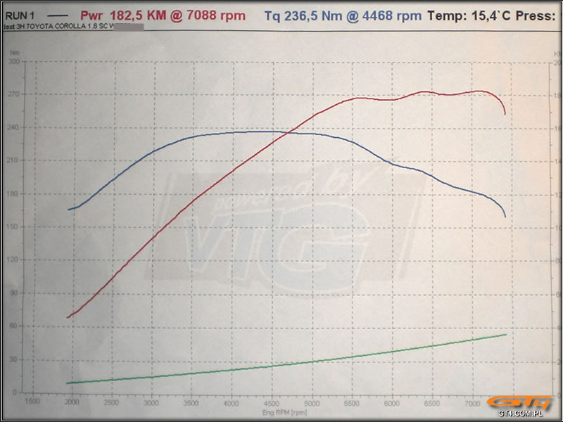

old dyno supercharger 0,8b-0,9b:
