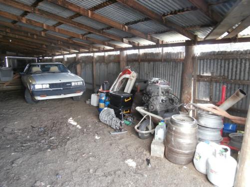

We've expanded into the shearing shed area to start stacking the ever-increasing bits too.. Plenty of room in there, but we also have plenty of old stuff to clear out of the garage when we get time.

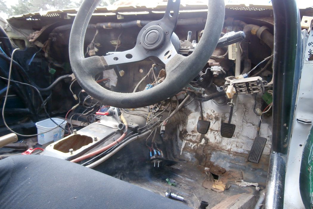

Anyway... Next day the screen pillar was high enough, but more diamond-shaped than we could use, so dash out time. A pile of junk made the car lighter..
...and inside, I found no dash cross-brace at all, its all made of plastic! So I decided it was time to strip the loomb as well and throw out more weight.
Then I could get down to re-shaping the slight diamond shape of the screen surround! The screen has to be within 5mm of the metal underneath it, all around the frame. Also, it needs about 5mm minimum gap all around the edge so it can't be touched by metal when glued in and when the car lands after a jump & twists and bends.
After that I put the jack horizontally across the A-pillars and cut a brace to fit in and hold that shape. Now I had the screen fitting perfectly, and we welded the brace to a tag on each side. Its under a lot of compression, a random bit of steel fence picket I found outside!
I'd taken the precaution of cutting the weld between the cage and the A pillar, and now a sizeable gap had opened up. We will bridge over that later to hold everything in place. You can see how trashed that pillar is by rust and repairs in the past.

I started in on the wiring with The Girl, seeing she had just finished the Uni semester and had a couple of days on the farm. We stripped the plastic off, unwound all the tape and took out whatever wires I didn't think were needed. Sadly, the wiring diagrams in the manual were NOT exactly what was there, so I'll be soldering a couple back up again!
