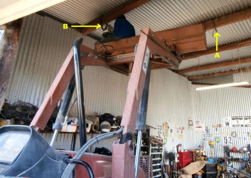

We moved the 3ton hoist from is original beam with 4 turns of #8 wire, (for lifting engines out..) to the next beam, closer to the wall, on a hard steel chain. You don't do this off a ladder, I can't even pick that hoist & chain up...
Then I folded up a little steel bar and bolted a chain to the crushed inner guard, and hooked on the hoist.post-7544-0-94583600-1372592001_thumb.jpg

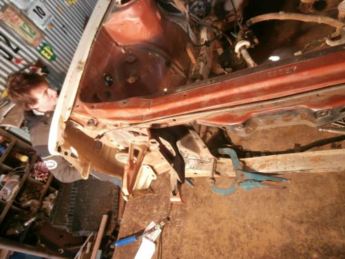

That worked OK, but once the rail was straight it was obvious it needed to have the lower curve lifted and pulled forward. I figured using the tractor and a tree on it, bit it was less work to go and cut a half-nose off the spares car, a lovely straight rustfree RA40 that was born with the disadvantage of a fastback instead of a coupe backpost-7544-0-09665100-1372592129_thumb.jpg
That took a day, then cutting the rallycar to suit took another, but soon I had the driver's side from just behind the turret and right across the front within 2mm.

Now we had a guard to test our new engine bay before we welded it in, and it looked good.
The passenger's headlight bracket spans both bits of chassis and the holes lined up perfectly. I gave the panels a good 20mm of overlap.
The bottom lines up with the top of the chassis rail, so it will be firmly attached.
