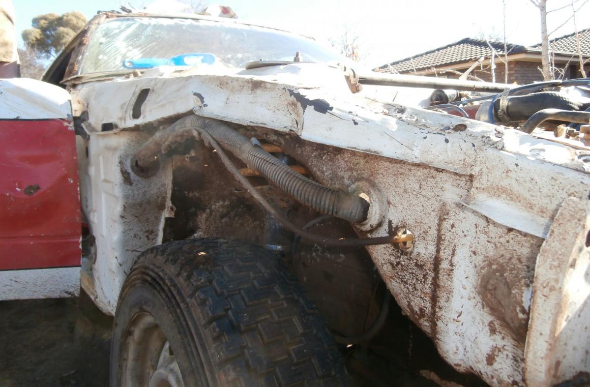

We picked the truck up this morning and stripped a mudguard off to see how bad it is underneath, and made a plan to move forward. Chassis-pull it, or cut it off and fit a new front, or get another shell and build that, or change to a KE70 now instead of being stuck in Celicas...

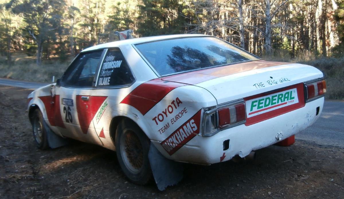

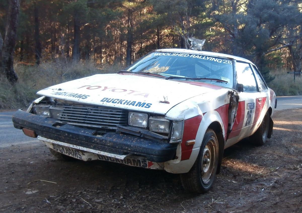

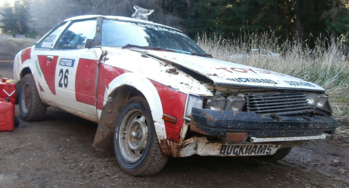

Keith's update was thorough so I'll just give a quick summary of the event:
Hit the first stage cautiously to settle in, car under steered gently with half worn steers on and new drives. Despite a few rookie errors that both me and Ashley (navigator) seem to always have the first two stages, all was good. Beat Leicthy by 6 seconds.
Just settling into stage two and then got a front left puncture 6kms from the end, was pretty annoyed, just kept driving on it. Ash fell off the notes again and we ended up going up the wrong road for a km because someone ran through the tape and didn't put it back up. dodged a head on with the Skyline that had caught us because of our flat tyre. Got to the end and there's dad and Keith, as always the most dedicated service crew I've ever seen, they tour around in The Girl's blue KE70 to meet us at the end of stages even though it means they miss spectating due to it. They helped install the spare, and then we realised we only had 6 rims left. Ash and I drove back to service and got a new drive tyre put on our only spare wheel, so now we were running two new Dunlop drive tyres on the front. Keith and dad went to the wreckers and picked up 4 steelies and then got 2 new steer tyres put on two of them.
So we head out of the service park behind Leichty to hopefully run behind him for the next long 36km stage. we get to the start and we're following Leichty as another Datsun (1600) cuts us off and goes between Leichty and I. there wasn't enough room to drive alongside him to say something and the officials had already given them a leave time before we could do anything.
So sure enough, don't even get half way though the stage and we're stuck behind two old blokes going on a Sunday drive. I tried my horn, flashing lights, practically denting their rear bumper, but they were either completely oblivious or weren't going to move over. I couldn't pull away from them exiting corners as they had equal power, so we were stuck behind them, and I was getting angrier by the km. This isn't the first time this has happened either for those wondering. They didn't move over until 2km until the end! And they didn't even move over properly at that. Either way I didn't see them after the next corner. Turns out these new drive tyres on the front were incredible compared to the half worn steer tyres we had on previously. Chalk and cheese. No more understeer!
We just finish the stage and start heading back to service only to run out of fuel only 3kms after the stage... So once again Keith and dad are back out in the KE70 to save us haha. we eventually get back to service and we throw the new steer tyres on the front as an experiment to see if this whole steer/drive tyre thing was actually worth worrying about.
Get out to stage 4 (stage 1 redone), behind a skyline turbo this time to make sure the same thing didn't happen again. We actually won our class and came 10th outright on this particular stage. :) finally things were starting to go well, it wasn't even a push as such, just nothing went wrong for a change. :)
Now it was time for stage 5, I'd worked out these new steer tyres were indeed even better than those new dunlop drive tyres as they were supposed to be. Ashley had settled in well, car was absolutely perfect, I found myself hitting 5th gear quite a bit, you could say I was having a push. Generally I get warnings, or moments, where you know you need to back off a bit. I didn't get that. We were flying along but still tidy. There were a series of humps that I'd been getting faster over... Basically I didn't slow down enough for the third one, because of the speed I let the car get a tiny bit untidy around a left hander. Probably should had been in second not third gear... but as Ashley says I wasn't listening :P.
The driver's rear quarter hung out just enough to clip something (can't find any marks, I think it was the tyre) a metre or so before the hump. Whatever it hit pushed back causing the navs rear quarter to come out, precisely as we hit the hump, and as we landed the new grippy front left tyre dug in under the car and we did a slow 3/4 roll, with the car stopping in the middle of the road on the driver's side. If I had just backed off a tiny bit, I could have kept it tidy and it wouldn't have happened. Just pushed a tiny bit much at the wrong place.
Turns out that only 200m down from our roll, the fatal roll off the side of the road had already taken place by the 180B Datsun and they were stuck there for 30 mins before anyone found them. You simply couldn't see them from the road.
We're going to see our panel beater on Wednesday, and if that turns out too expensive, I just bought another shell today. So no need to fear, as I promised to Keith, the Woolshed Rally Car will be back precisely how it was at the start of the stage, in time for John's river on the 24th August- 3 months!

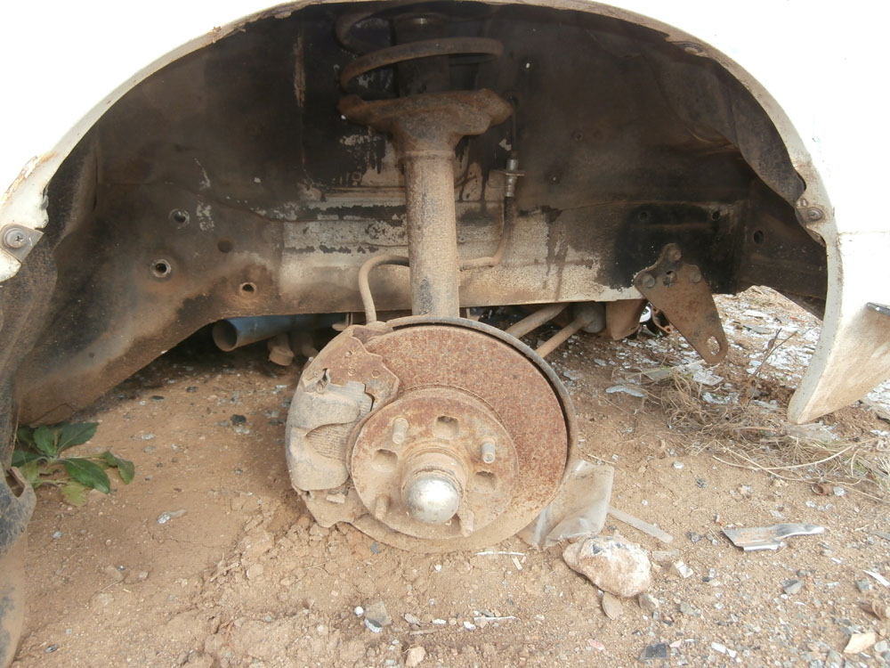

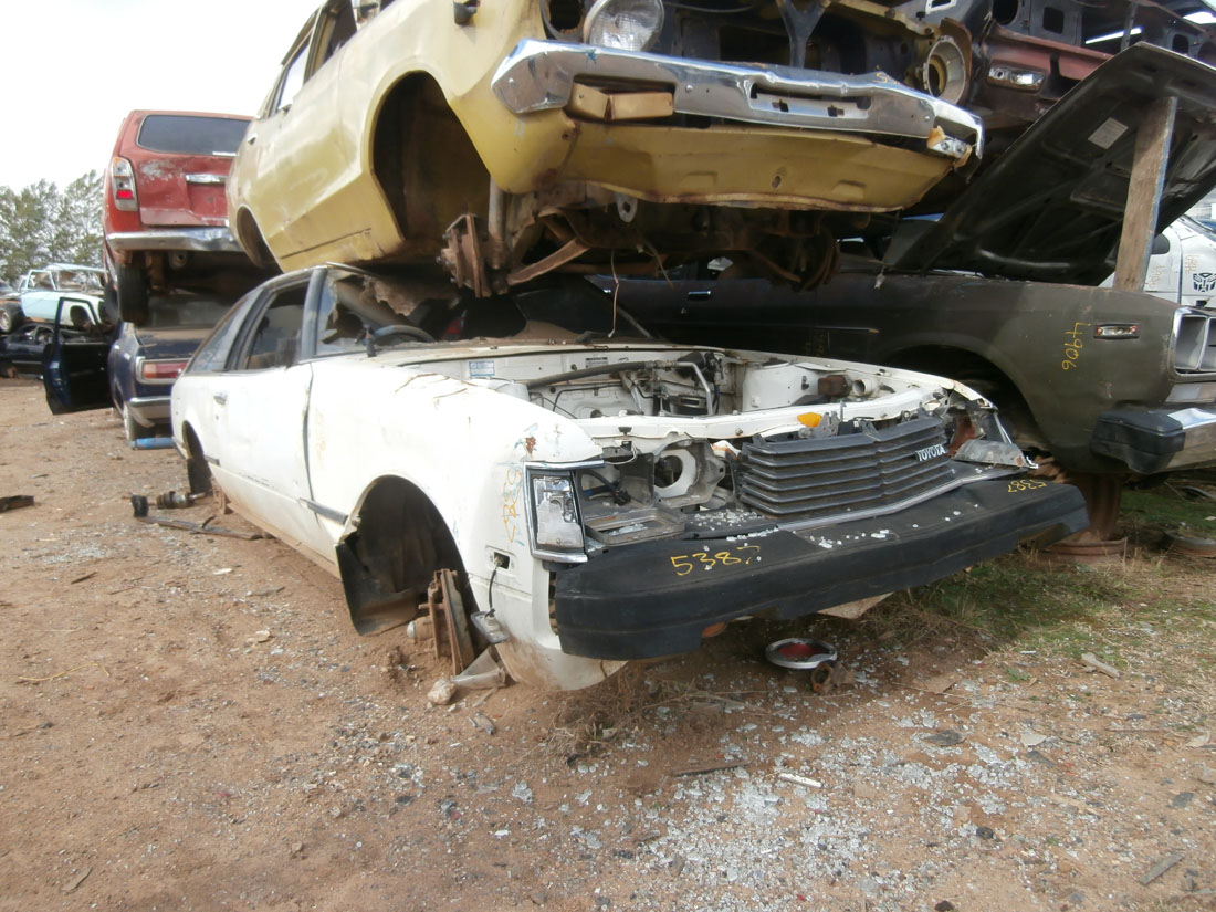

hmmm... Well, its a Celcia and there's no use WASTING it at a wreckers..
It's even white... wow, should we be cutting it up instead? Those panels don't look too bad? Hmm... what occupies your thinking?

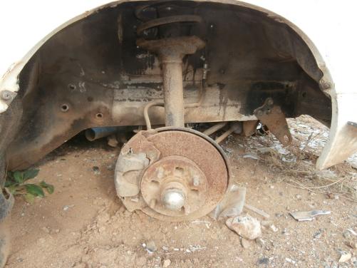

I want to go to orange just to look around your wreckers. Is that a datto behind the celica?
Yeah, old Dattos there, old KEs, old Coronas... Some guys came down for the rally and I met them at the wreckers. They left with a Stanza that had been there for over a year on their trailer.
Those photos are very telling! Jeez that Celcia is a big girl! Look at the second photo, its miles wider than a 1600.

The panelbeater has dropped out, so its all on for the Uni holidays as we do it ourselves.- it will be bloody freezing in that woolshed!
