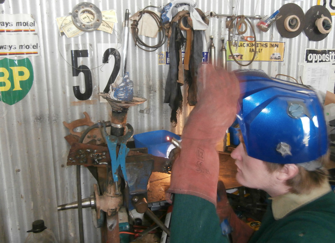

I cracked the whip and we had the spring seats taken off the struts, then we welded them back on 50mm higher
This was done by putting in an old shock and poouring engine oil around it to soak up the heat on the inside of the strut tube. Then Steve put a stack of quick tacks all the way around it so we didn't blow any holes through or distort the inside.
Then we refitted the Bilsteins- the "C" spanner they supply is just not up to the job, so it was woolshed spec again.
