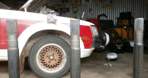

There was a diff oil trail down the back of one rear brake so I stripped that. Yes, the oil was inside too, so we pulled the axle out. Lucky we did that, as the bearing was tight and rough. We stripped out the other and found the bearing worn and loose, so the car got the axles from the spares car.
The one axle has the most amazing pattern within the machining marks, making it look like it has been twisted. They are both worn at the splines such that we could measure the difference in spline width between those and the spares car ones. That's a spares car axle on the right.
