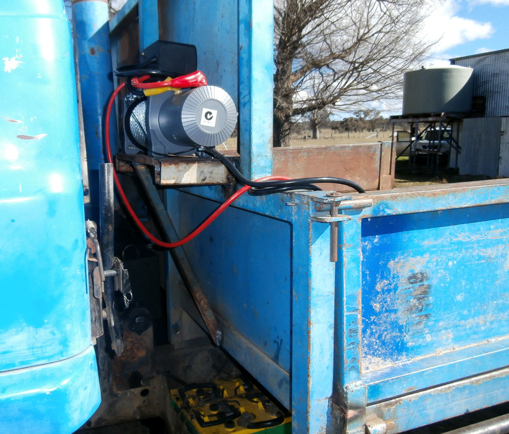

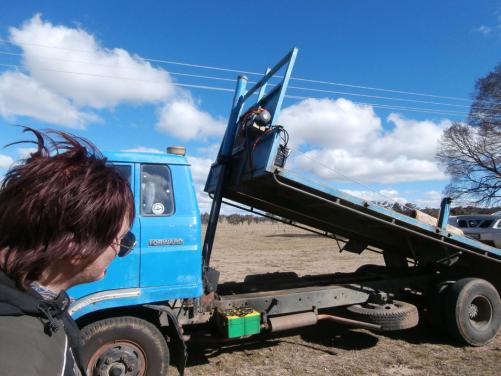

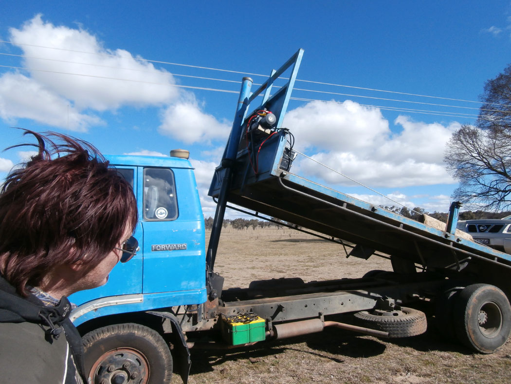

Well! So little achieved..... We mounted up the winch, which went fine-

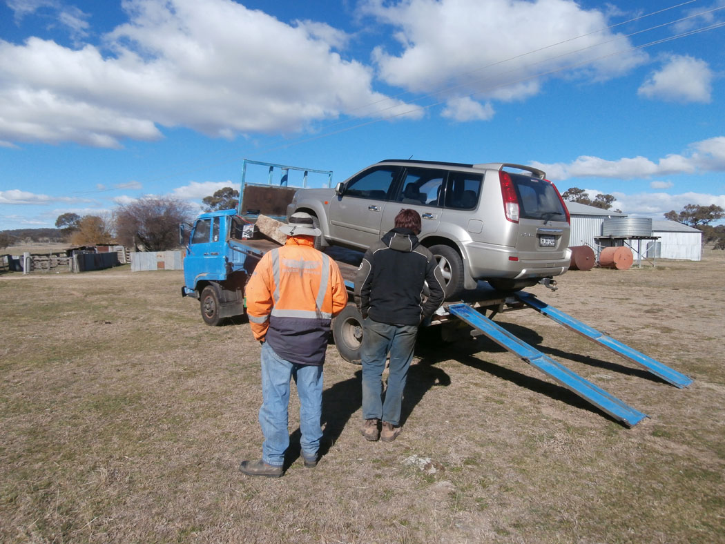

Grabbed an unsuspecting X-trail and hooked it up. We lifted the tray to make sure the wire rope didn't rub on the end of it, and to lower the angle that the ramps sat at. It actually looked very high...
The winch hauled it up without a problem, we dropped the tray a bit as the front wheels went onto the deck. ..and we finally decided that this was the easiest way to get a car loaded!

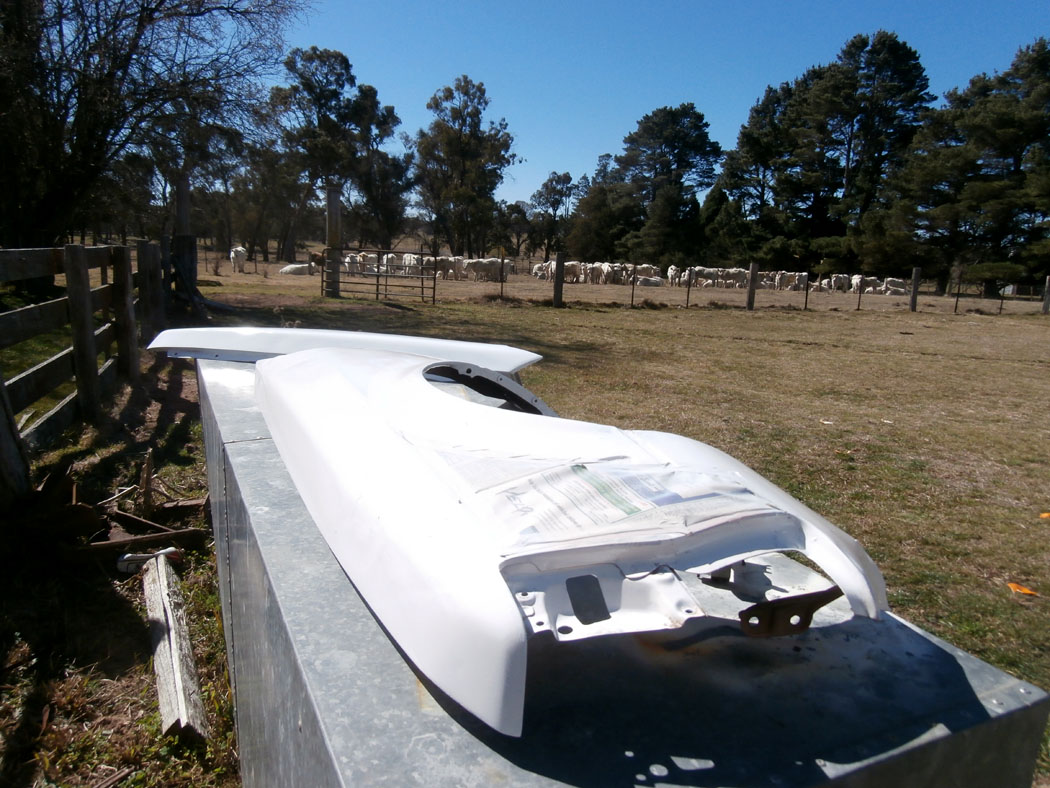

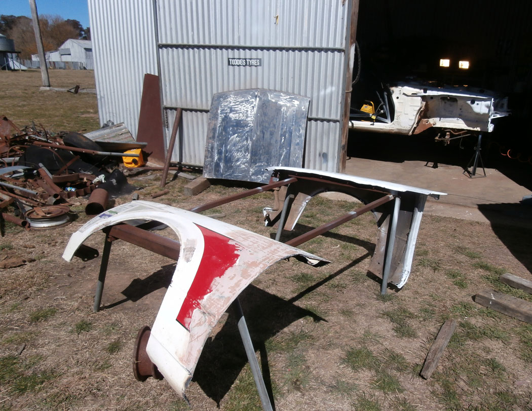

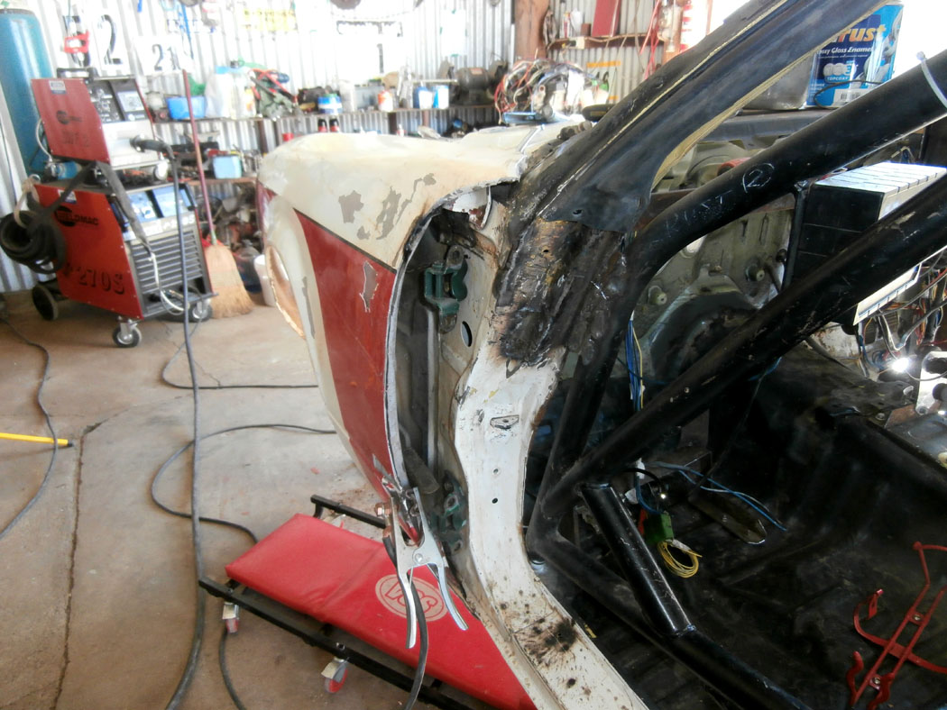

They headed off to rescue the Corona and I headed back into the shed to continue the fight with the nav's door and guard. The door is a 'new' one, the body is a bent one with lots of welding and added metal and the guard has been rolled on... Getting the three of them to fit together took the day,

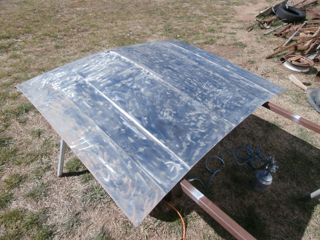

We did manage to strip half the bonnet back to bare metal. The spares car is in excellent nick, so I couldn't understand why the paint was crazed through to the metal. It's about 2mm thick, with a second bronze paint under a thick spray-filler layer.. I finally figured it must have been a hail-damaged car, and the repairs were not too hot so they have crazed the original paint underneath as well. Anyway, it will have to be ripped back on all the top surface of the bonnet and one guard. -tomorrow...

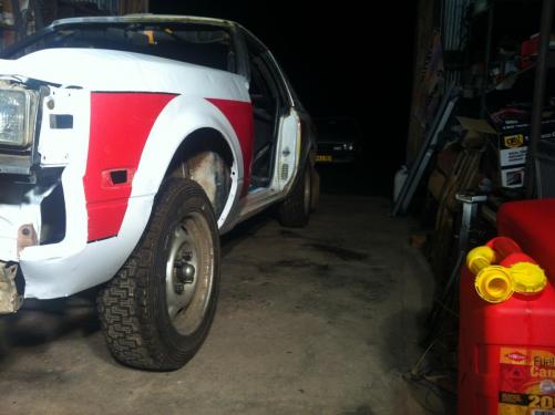

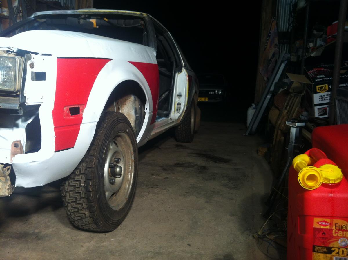

Well. we did finally get paint on today! The bonnet looked great scrubbed back to bare metal with all sort of patterns from the paint remover disc. I would've clear-coated it if we had some..
The guards were just wiped with thinners while Steve went over the chassis, as was the silver door- The rolled-on one looked pretty sad, but it will do.
The inside went a sort-of dirty white, but I'd had enough of black interiors so anything was better!
By mid-afternoon it was all gloss white, and we had picked up an audience who all watched from along the fence.
So, now it can dry overnight, being cheap 3-in-one epoxy enamel. Tomorrow I can get inside the car and Steve can assemble the suspension. We started on the new axle seals but got distracted by the semi-locked diff having a binding spot for half a turn, so first thing tomorrow we should swap an axle out and see if its a bent axle or in the spider gears. The axles look fine, but I don't know how much they need to be bent to bind slightly.

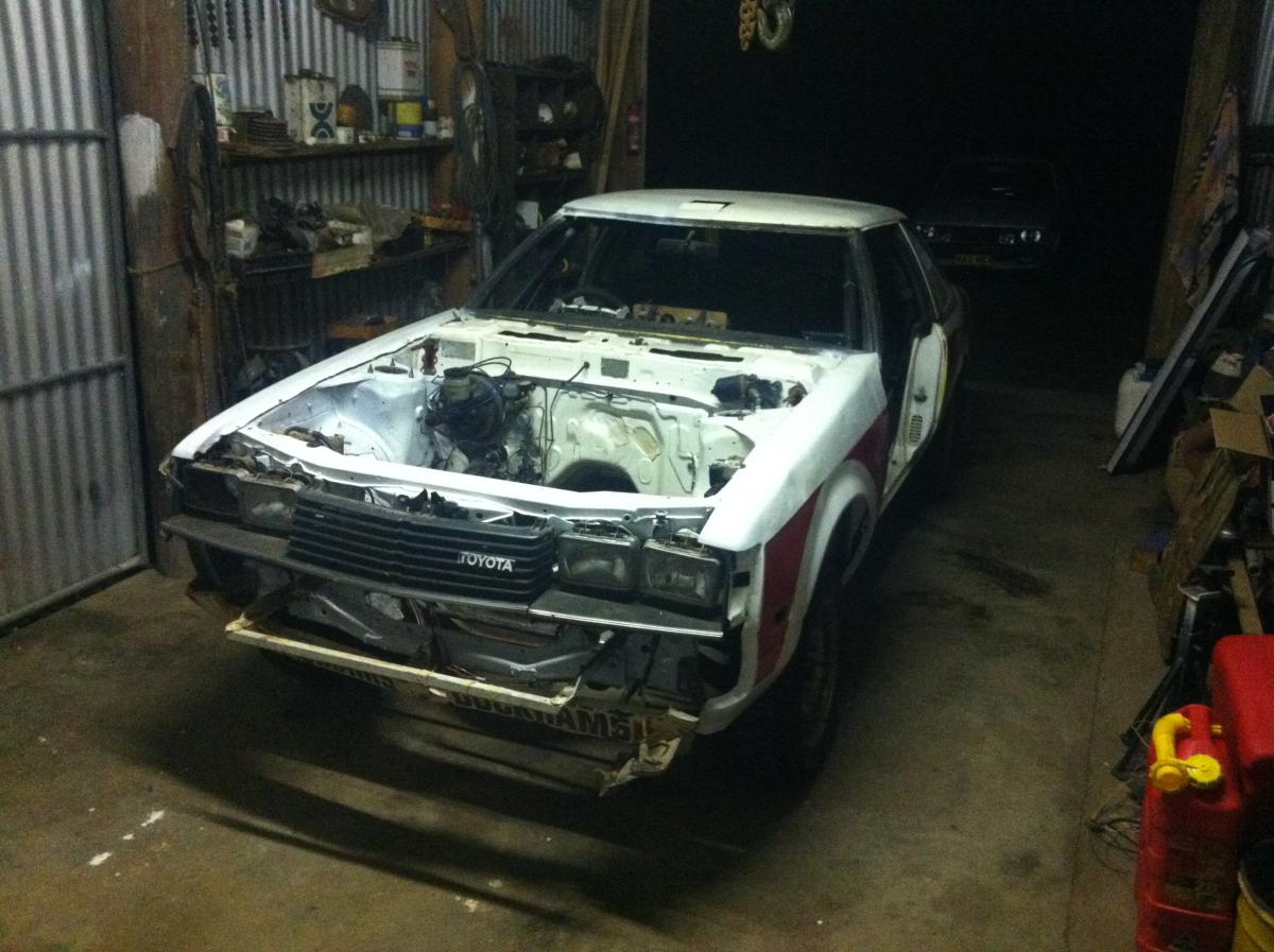

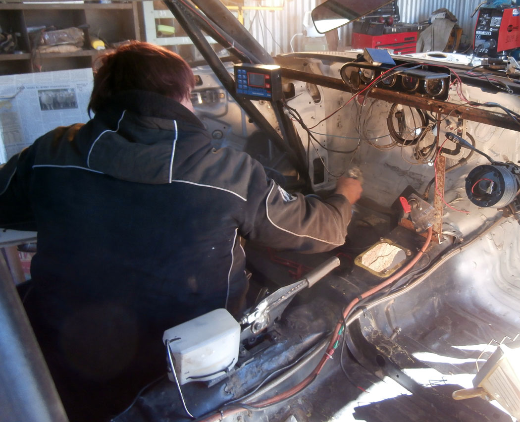

Meh! No chance of finishing it! Today Steve fitted rear suspension and that is all done, axles, brakes, fresh diff oil, new Bilsteins. We assembled the front struts and he fitted those so we have brakes and Terratrip on, while I sorted steering and wiring.
Tomorrow it can go on its wheels and we will drop the motor and box in, so I can start testing the electrics, but its hard to rally a car without doors or front panels!
Cie la vie, it will be all go for Bateman's Bay, which is in a month.

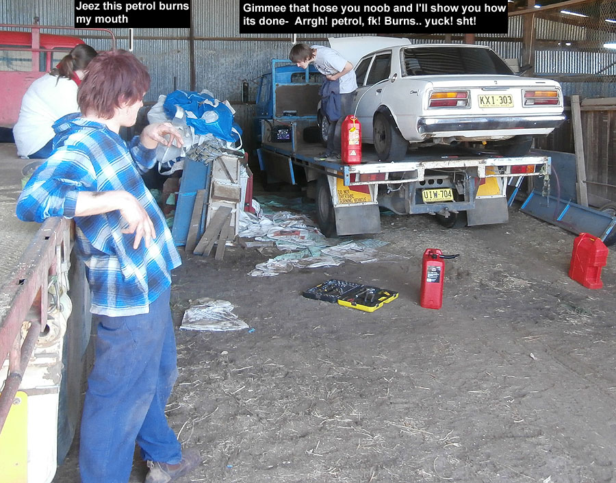

Got a flat tyre in my new KE70 daily a couple of days ago (that I grabbed off a 95 year old lady a couple of weeks ago)... so hunted around the farm sheds until I found another R13 155/80 Corolla wheel haha! Then knocked the rubber drain plugs out all through the boot where water had been trapped and rust starting to come though. BTW absolutely loving driving this 1.3L auto KE70, it's such a driver's car,it's so underpowered that it's hilarious holding it flat everywhere, corners or not :P! We have great plans to make this Woolshed Rallying's next build! :)
Then, with a spare again and all set to head up to the shed, MORE DISTRACTIONS! Dad needed help to pull a calf out of a cow that was having calving difficulties... Farm life huh! So after wrestling with this 500kg cow to stop it choking itself on it's rope noose that we were using to to hold it still, the calf was pulled out alive and they both lived happily ever after! Pretty rewarding stuff :), a couple of hours later and the calf would have been dead! post-10167-0-66669700-1380032772_thumb.jpg post-10167-0-71858900-1380032805_thumb.jpgpost-10167-0-25845900-1380032823_thumb.jpgpost-10167-0-45619200-1380032884_thumb.jpg
Straight after, I managed to drag my mate Matty home for the weekend to help (who often helps work on the rally car and all our other cars with my bro and I- thanks Matty!). We headed up to the shed, stopping at cousin Brian's on the way up there to pick up the rally car's diff. Took some photos of the unusual animals playing around the house! Some Guinea Fowl in the trees and a little Angus potty calf with THAT FACE! Hahahaha! post-10167-0-69554600-1380032898_thumb.jpgpost-10167-0-32206100-1380032914_thumb.jpg
THEN STRAIGHT TO THE WOOLSHED... well so I thought until MORE distractions! Visit the old lady Nell with the Datsun ute on the way up, and she tells us that she left her lights on in it and it had a flat battery...
So off Matty and I head up to it's shed to switch batteries with the Rodeo ute next to it. Throw the bonnet open to find Keith's floorless air cleaner setup- displayed in photos in the above post, MISSING. A carby with no air filter! MY RALLY SOCK WAS GONE! Then I have a look over the bay... and then down to the exhaust manifold... to find MY RALLY SOCK SITTING ON THE EXHAUST! I pick it up to find it's been HALF MELTED by the exhaust! KEITH!!!!
So we switch the batteries while i have a bit of a think about the air filter situation...
Then head back to the house to update Nell and ask for some old stocking and some scissors. It's time to get Woolshed!
