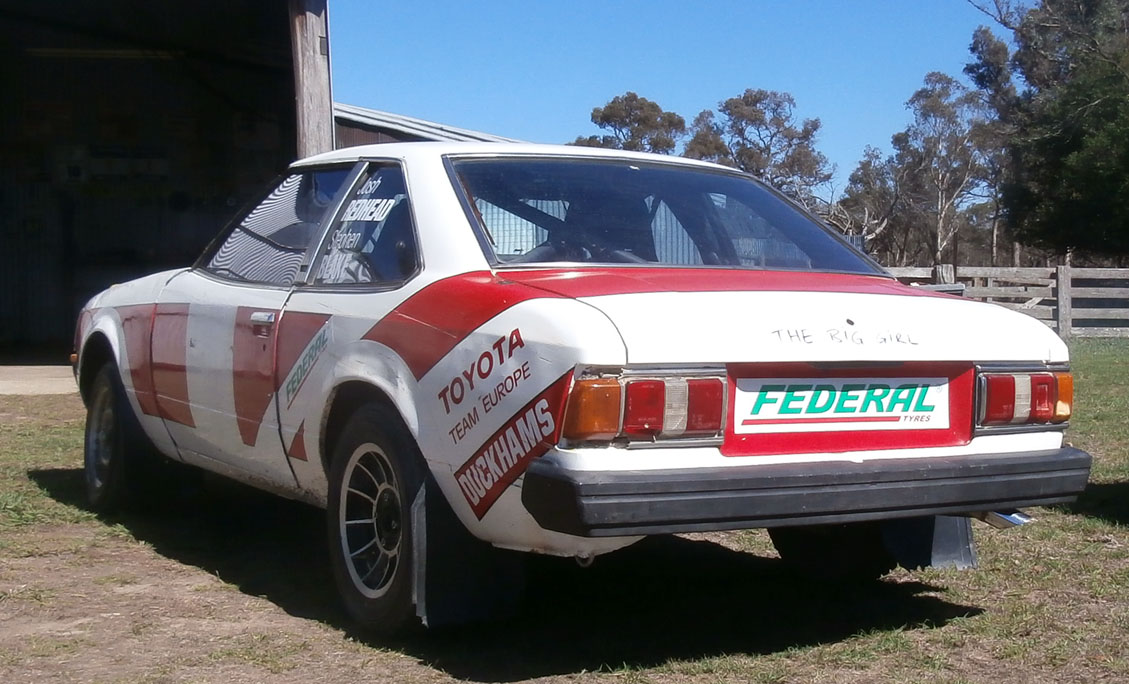

We cut the wheel well out of the boot to get the exhaust higher up and put a panel in the floor under the spare wheel mount.
The fat arse on The Big Girl had always annoyed me, it was made worse by the constant pounding of stones pushing it out.
With a brilliant stroke of genius we grabbed a rear bumper off one of the KE70 collection outside and hit it with a grinder. We cut the plastic away to get it tucked closer to the body, and chopped the steel frame out to lighten it. We had to make a couple of steel wedges to keep it vertical and just bolted it on with two 6mm bolts, to hell with mounts. The cars are the same width!
Chopping off the the bottom of the rear panel got rid of the stone target and it will be quite un-noticeable.
We discovered a bit of 2.5" chrome tailpipe, probably off Steve's dad's RX3 from the 1980s, so that went on too. We had to replace some of the pipe that had been crushed by the diff, and swung it over to the driver's side.
