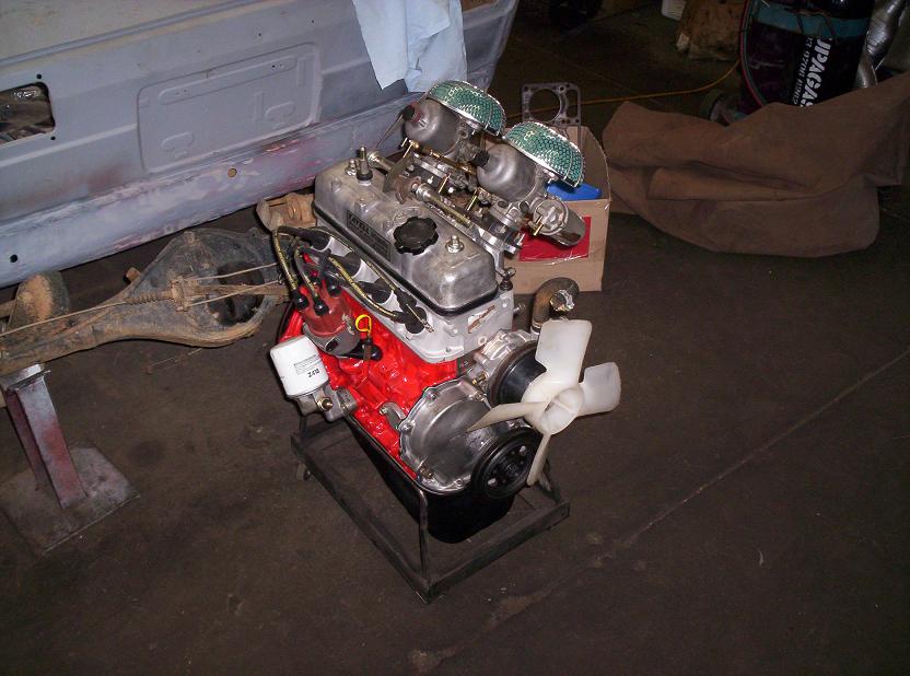

Our 7k

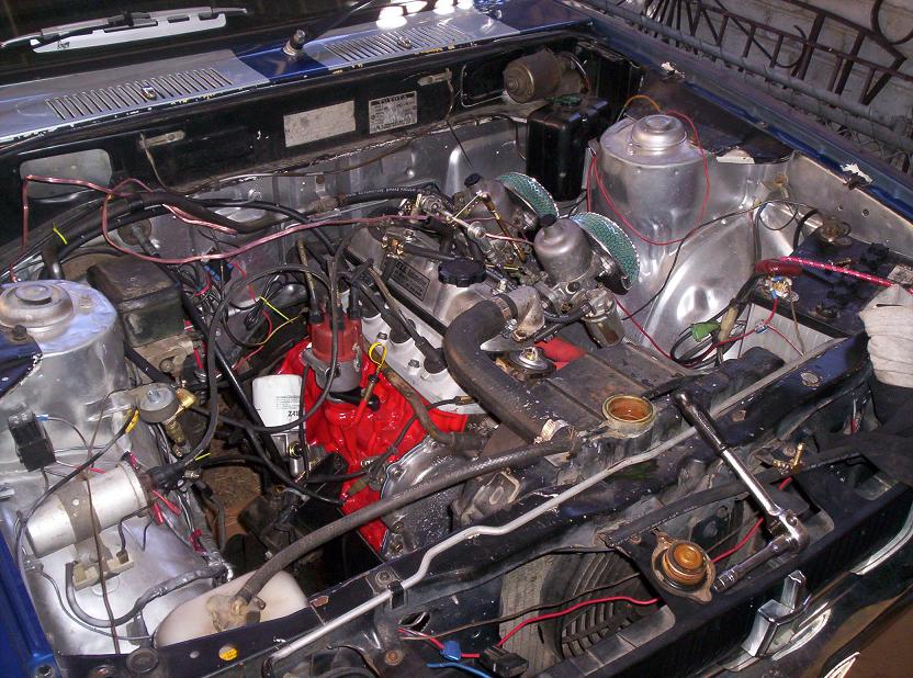

Did the sump on this motor need modifying
  • 2 months later...
It's running a 3k sump, seems to be the standard thing to do with the 7ks.
Yeah, my dad measured the angle and made up the extensions to make the bowls vertical.

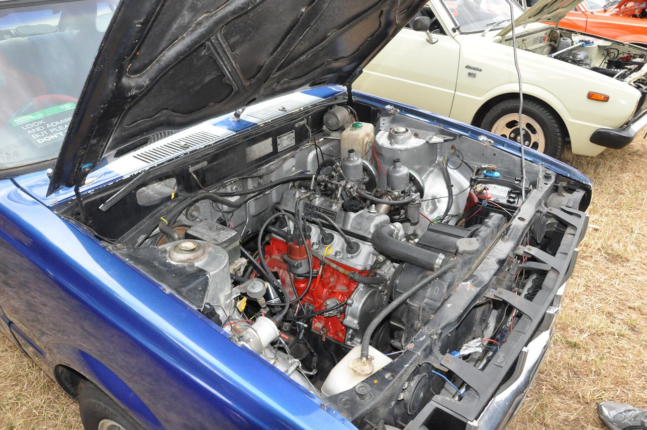

Here are two pictures of it before (you can see the angle)
And other picture after
Unfortunately I don't have any better pics at the moment of the engine bay after the extensions were added. You can see them a little in the picture.
