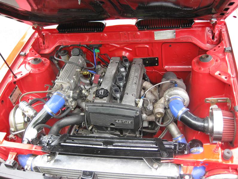

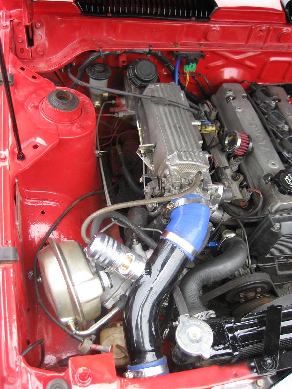

Heres the list of the parts replaced/fitted to the car
-New clutch slave cylinder
-New turbo XS blow off valve
-Various Hoses
-3" 21 Spline Tail shaft
-Braided brake lines
-Clutch master cylinder over hauled
-Various Hose clamps
-VH44 Brake booster & brackets
-Various wiring switches, connectors etc
-New Air filter
-New exhaust, intercooler piping
-New hand brake cable (EXPENSIVE)
-New Accelerator cable

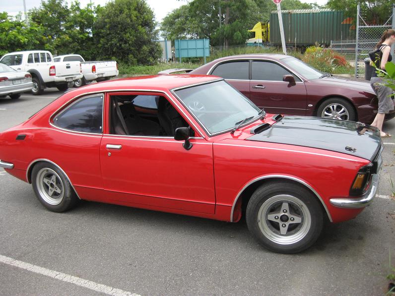

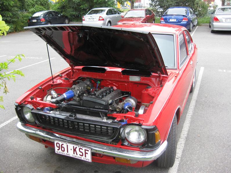

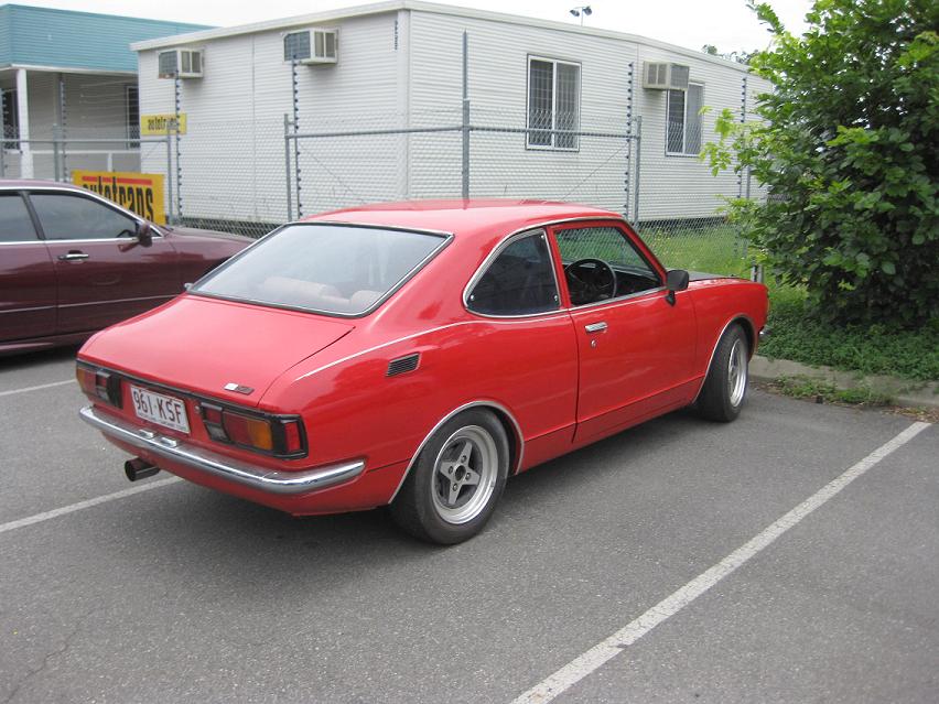

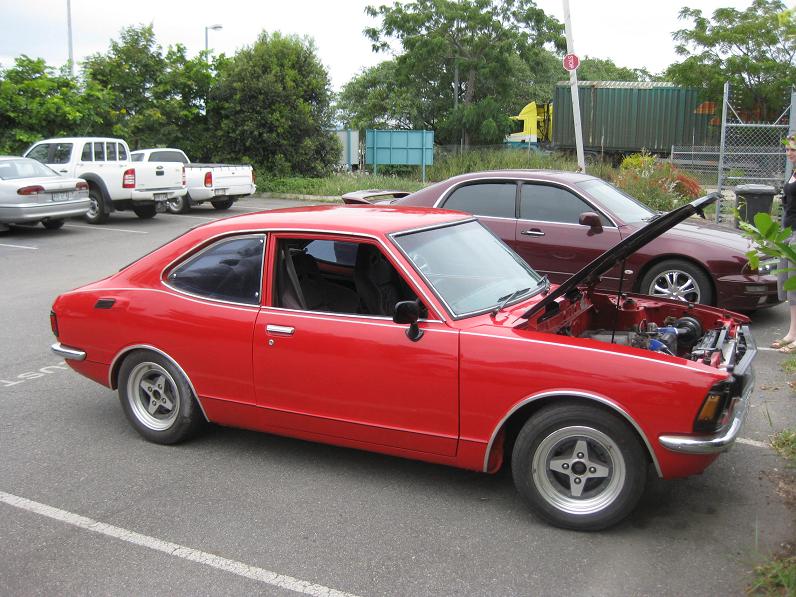

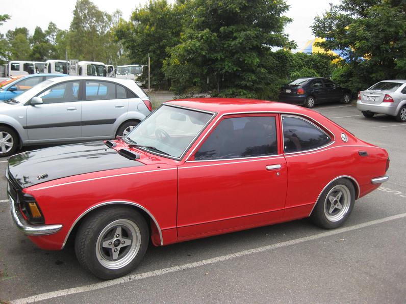

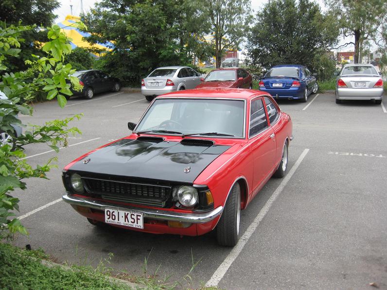

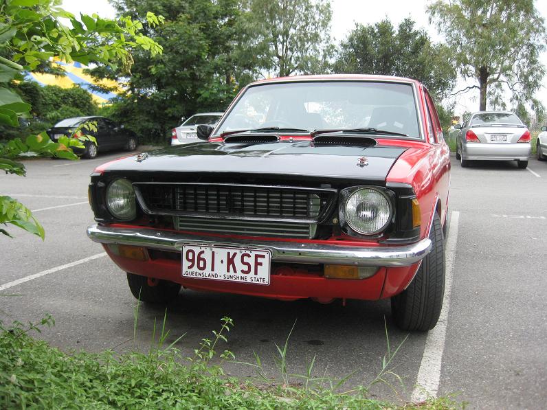

I also took some picks of the car in the car park of the car transport place.
So car will be in adelaide by next week i hope and then i'll be sorting out the speedo, tacho and tune. Can't afford diff for a while so i'll just be waiting for it to snap ;)
