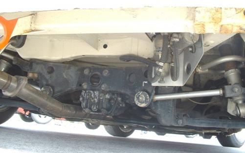

.T. Posted March 30, 2014 Author Report Share Posted March 30, 2014 Not much time to work on car project over the weekend, but did get around to setting up the subframe. Jig, set to -100mm (100mm narrower) looks like a mess of wood & a few bolts without the subframe in there! & now with the narrowed subframe in there... Its all tacked together now. Have to remove it from the jig to fully weld the underside of the front x-member, then have to fit the mounts for the top (traction rod mount) arms - will be reinforcing them too as this is apparently a problem area on these subframes. Not sure if I should go to the point of reducing anti-squat on the frame or not.... ie http://www.aus300zx.com/forum/showthread.php?t=253088 Will prob just leave it as it is, so I can move onto the next stage of the project - fitting the subframe. Can always come back & play with the geometry later. Quote Link to comment Share on other sites More sharing options...

.T. Posted March 31, 2014 Author Report Share Posted March 31, 2014 will be a bit of work thats for sure! but no big deal. hmm $nz1000 for a machined 1/2" plate - that's really expensive!! basically quite similar to what I planned on making - but $1000??!! who are they kidding! maybe I'll need to see how much my proposed adaptor will cost - i'm sure for ~$400 there would be a market for it? subframe now fully welded & traction rod mount modified to fit in original postion (yet to be welded on) comes out of the frame & goes back in, so it didn't distort during welding. Quote Link to comment Share on other sites More sharing options...
.T. Posted April 2, 2014 Author Report Share Posted April 2, 2014 subframe now finished now looks quite different to the other frame - short & squat. (& yes I know the other frame is a hicas frame! - the two rear arm mounts are slightly different on the hicas frame - anyone got a standard s13 subframe they don't want?) undercoated it last night. not sure if i should paint it up or not, because I know for sure if i do, i'll want to modify something on it later. now to look at removing all the diff/ fuel tank etc from the '25......should not take too long considering how little is under there! Quote Link to comment Share on other sites More sharing options...
