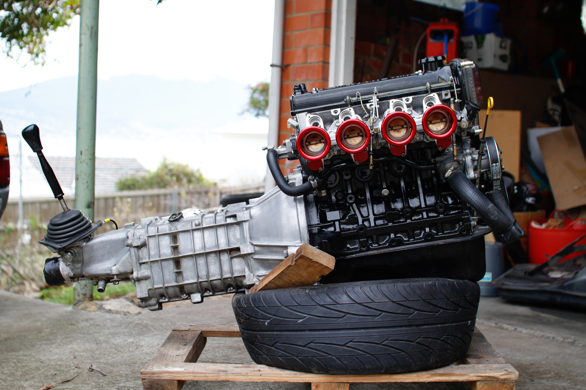

  • So bit of an update, and I've changed the direction in which the build is going. I decided to go down the 4age route to give it a bit more go and allow for turbo upgrades down the track. Adding up the
  • Genreal encouragement post. Look to be doing good work dude, can't wait for more updates.
  • Mounted the linkage to the underside of the throttle bodies, need to trim the mounts down and make a bracket for the accelerator cable, but they seem to work fine. Also need to see if I can mount the

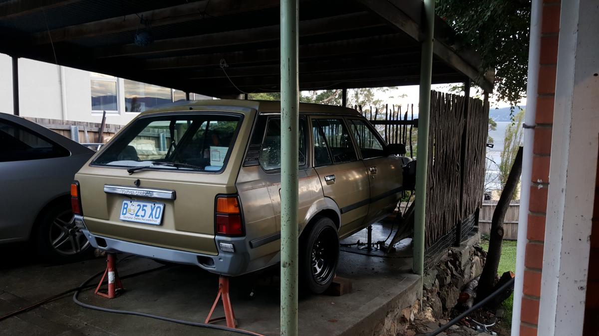

Got the jack last week, used it installing new discs and pads in my uncle's forester, bloody loved it. So glad I have one now.

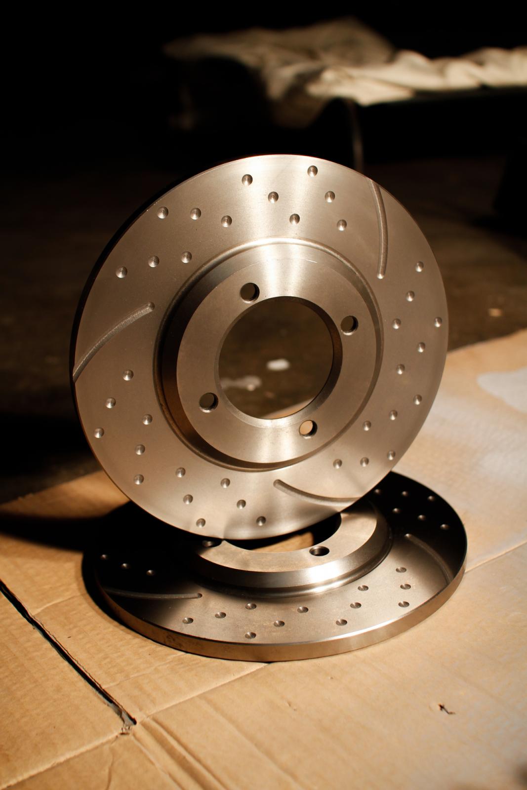

Also got my rotors last week too, pretty happy with them and should look nice on the coilovers. Need to tidy up the rear drums and sort out if anything needs replacing there too.

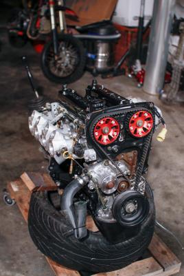

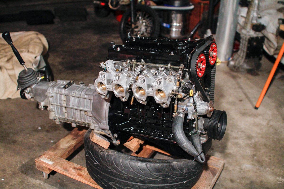

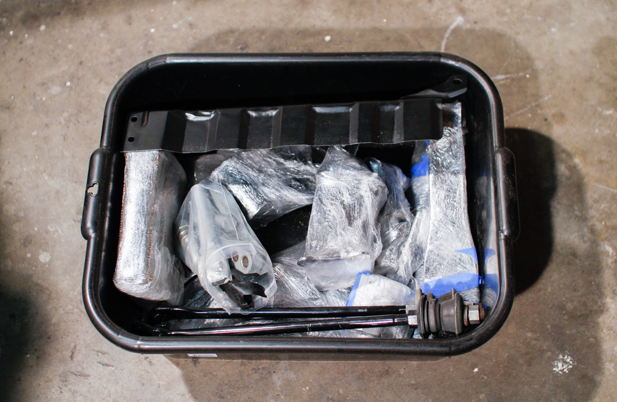

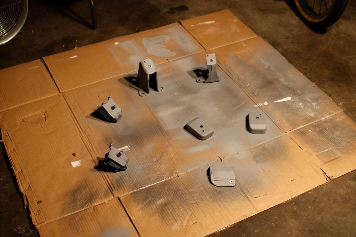

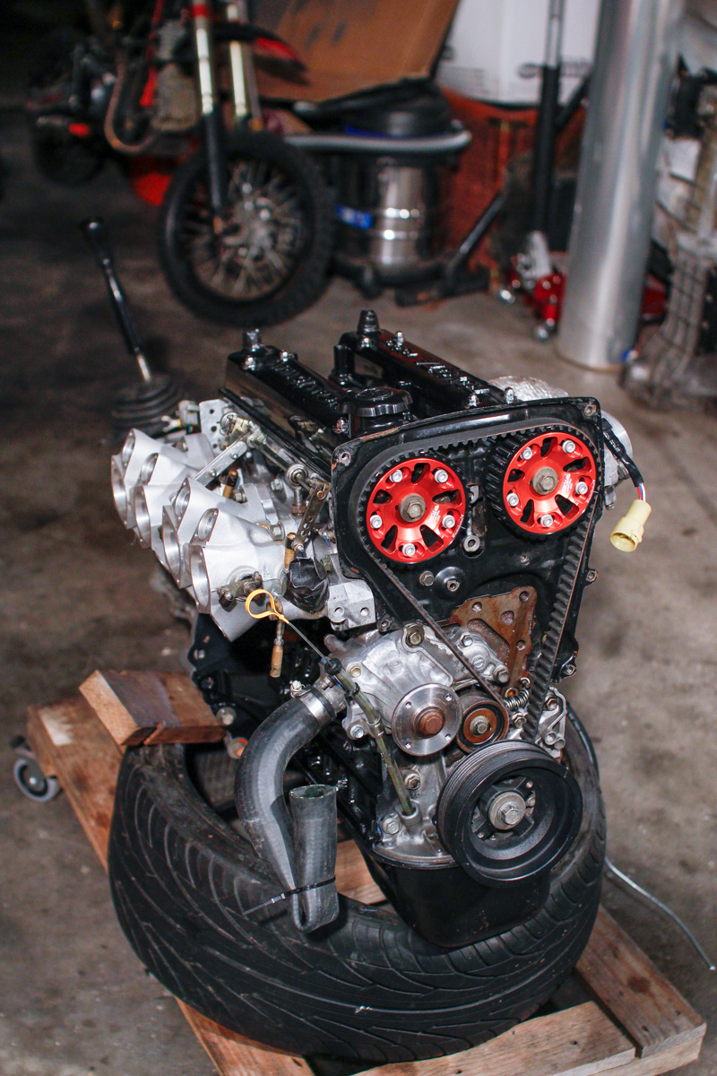

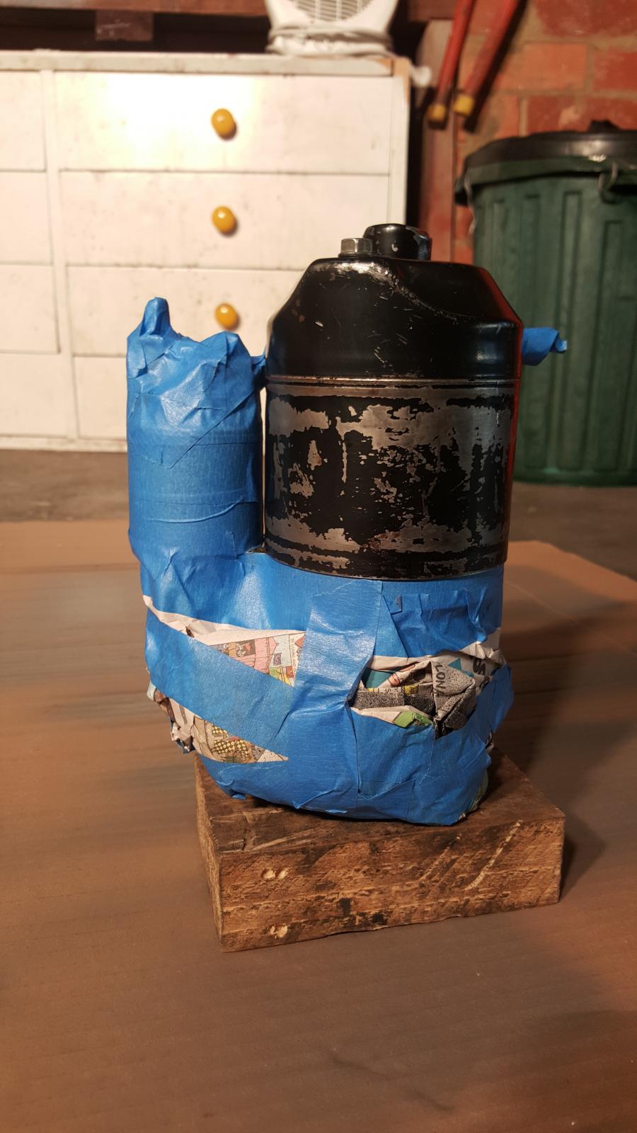

Just been cleaning things up and painting them ready to install. Painted the block in dupli-color high temp gloss black too, was bugging me being a bit scrappy. I've now got a tub full of parts incl engine mounts, lca's, alt mount etc that have been painted in high temp and wrapped in glad wrap, seems to never end. Got a few more little bits and pieces to go too, just keep finding more and more.
post-15622-0-63188500-1434542857_thumb.jpgpost-15622-0-70787600-1434542878_thumb.jpgpost-15622-0-89123800-1434542866_thumb.jpgpost-15622-0-07723100-1434542873_thumb.jpgpost-15622-0-12134000-1434542884_thumb.jpg
Also got a set of these and matching injector retaining and blanking plates. Going for a grey/black/red theme, hopefully It'll all turn out. Thinking a thin red pin on the tyres too, we'll see.
Ollie.

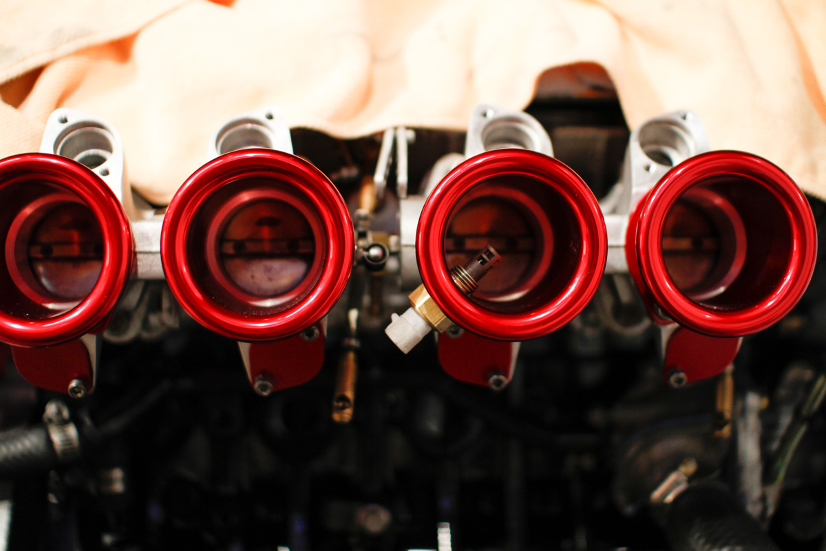

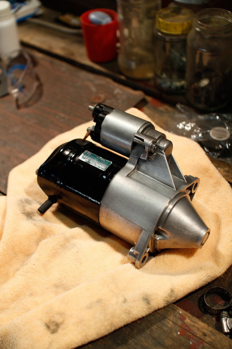

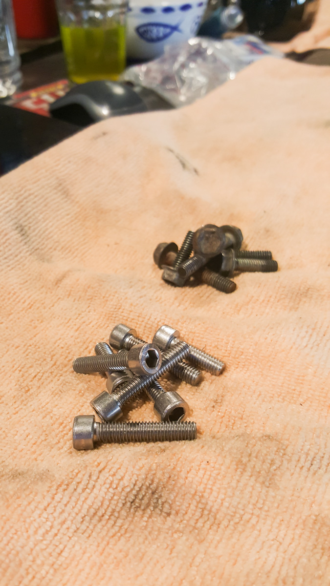

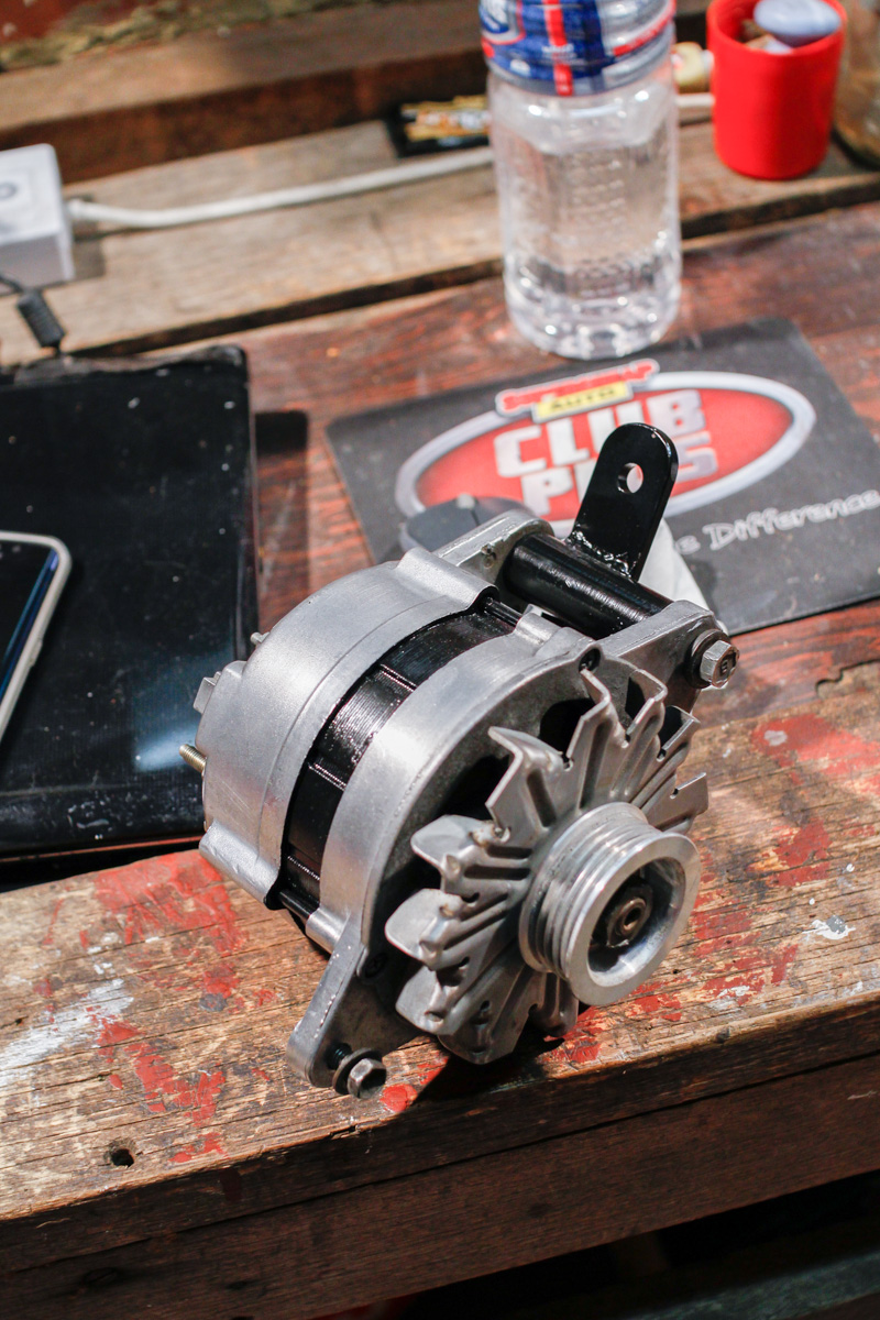

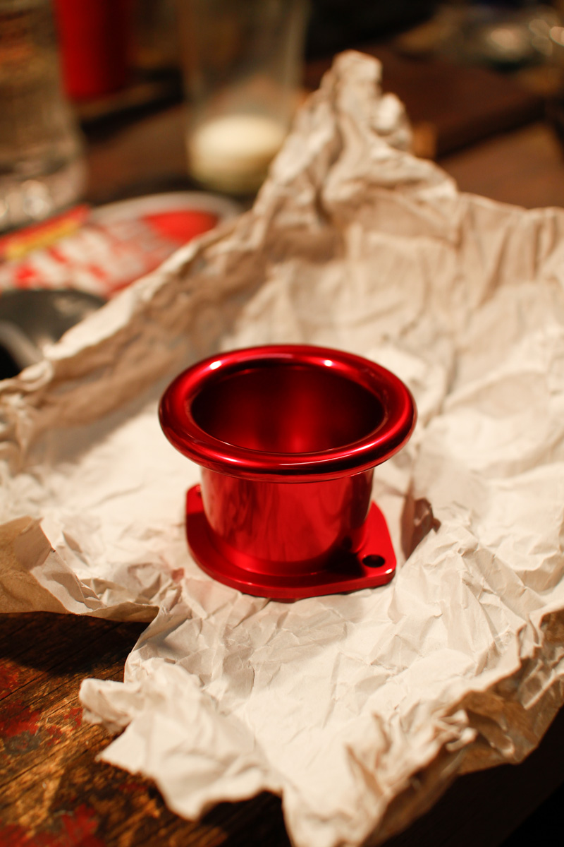

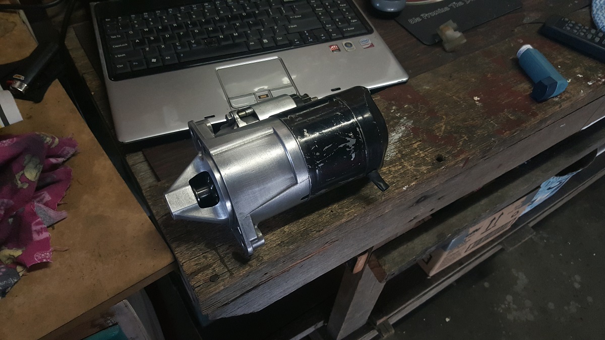

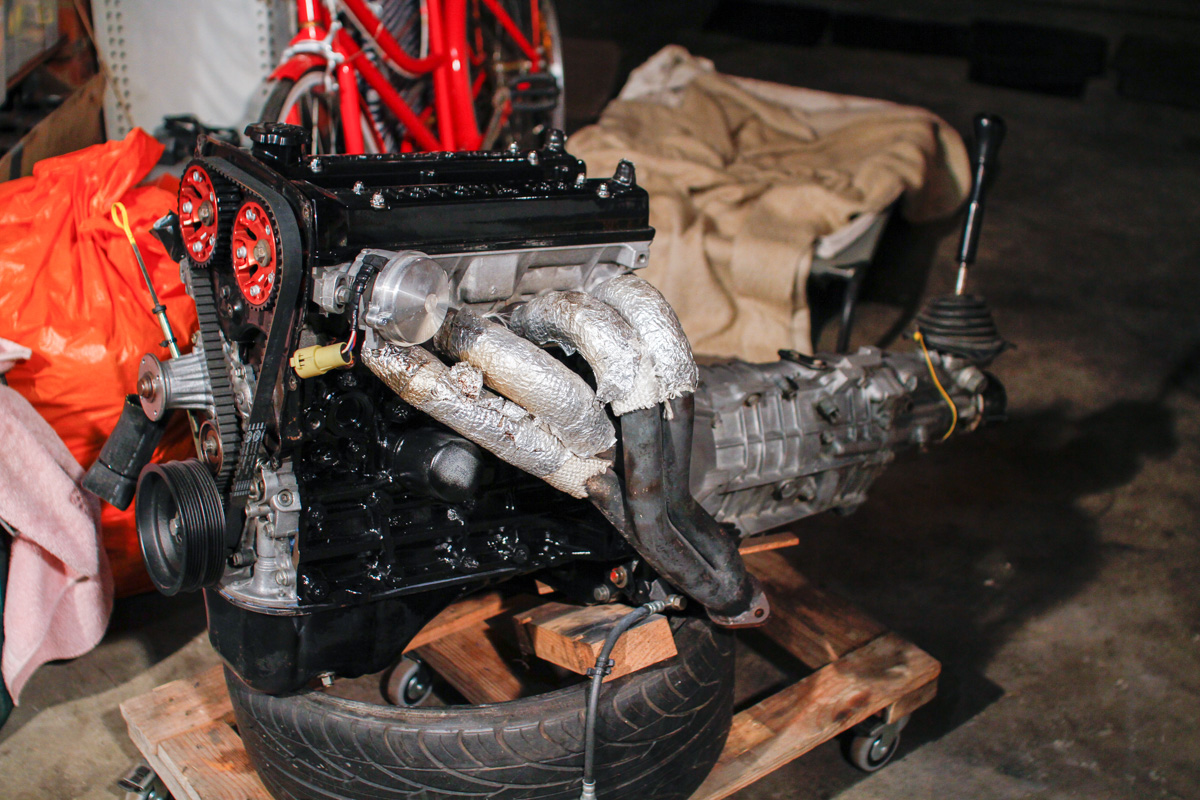

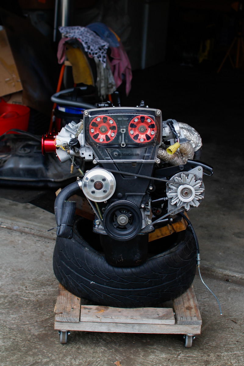

Cleaned a few more things and started bolting things together. Installed the trumpets/ram tubes/air horns/whatever, starter and the alternator. Thinking about getting the alt mount from sam-q as its an all around nicer, cleaner unit. $168 so might have to wait a little but you never know. Also got some nicer new allen bolts to replace the mismatched and dirty standard ones for the timing cover and installed that too, trying to pay attention to the details.

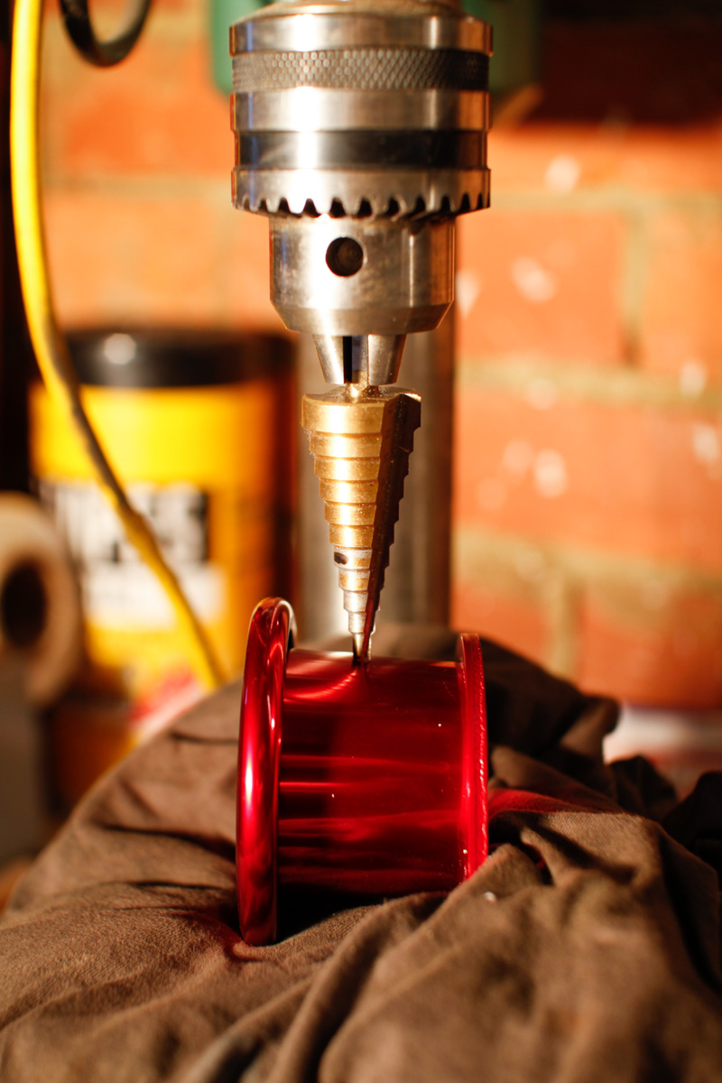

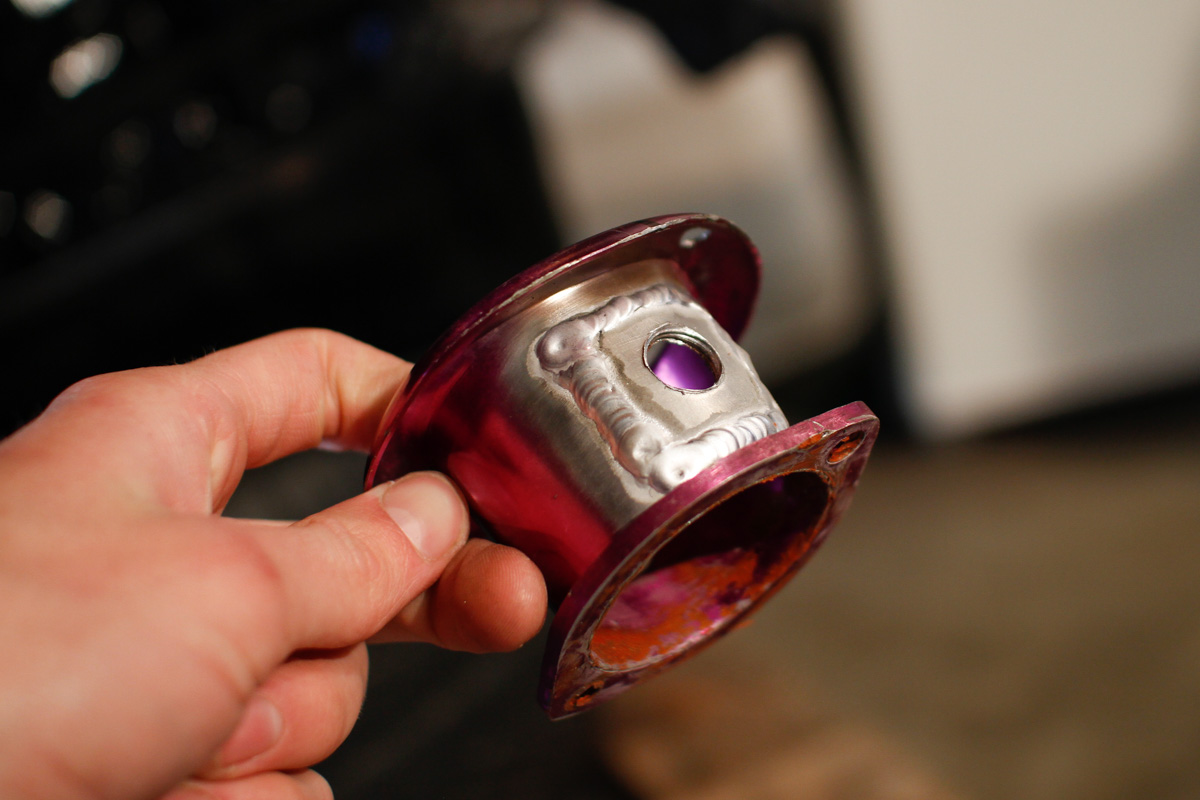

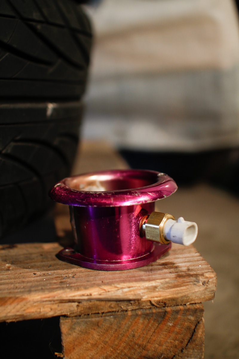

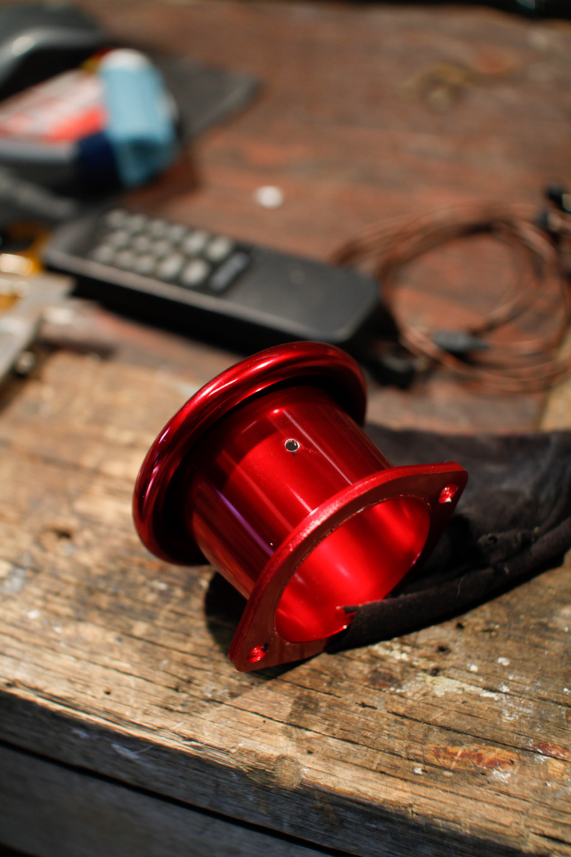

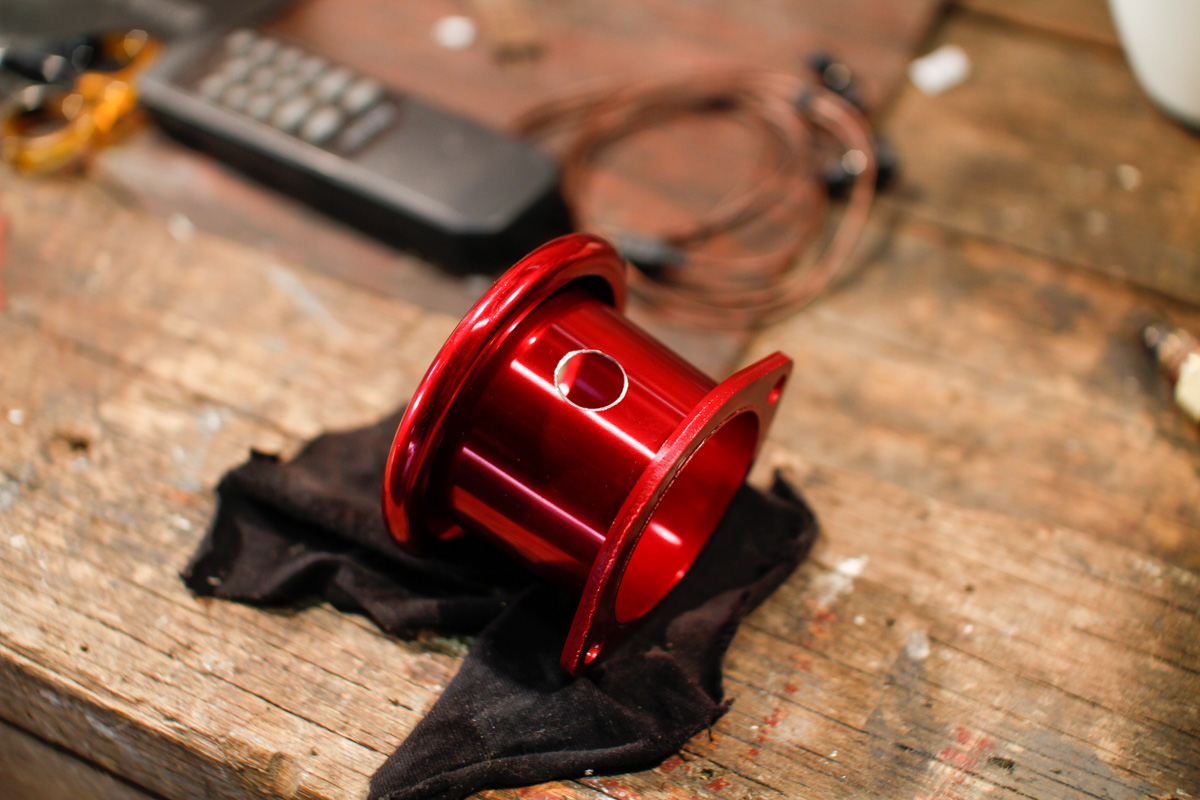

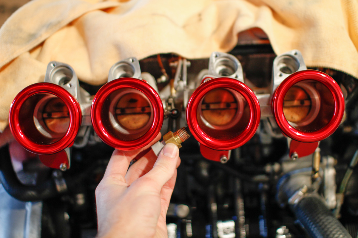

One thing that was bugging me was how to secure the air temp sensor in place, previous owner had tigged a metal plate and tapped a thread, but I wasn't so much a fan of that.
Original plan was to clamp it either side of the trumpet with two slim nuts, but had no luck tracing any down. Decided to try just bore a hole and let it tap itself a thread in one of the old purple ones, and worked a charm. Was solid enough, especially once I sealed it all up. So I went ahead and just eyeballed where I wanted it to go and marked it on the new red trumpet, punched, drilled a pilot hole then used a step drill to take it out to 12mm.
post-15622-0-09506500-1435144539_thumb.jpgpost-15622-0-97796600-1435144547_thumb.jpgpost-15622-0-48467000-1435144551_thumb.jpgpost-15622-0-60056000-1435144554_thumb.jpgpost-15622-0-95669600-1435144558_thumb.jpg

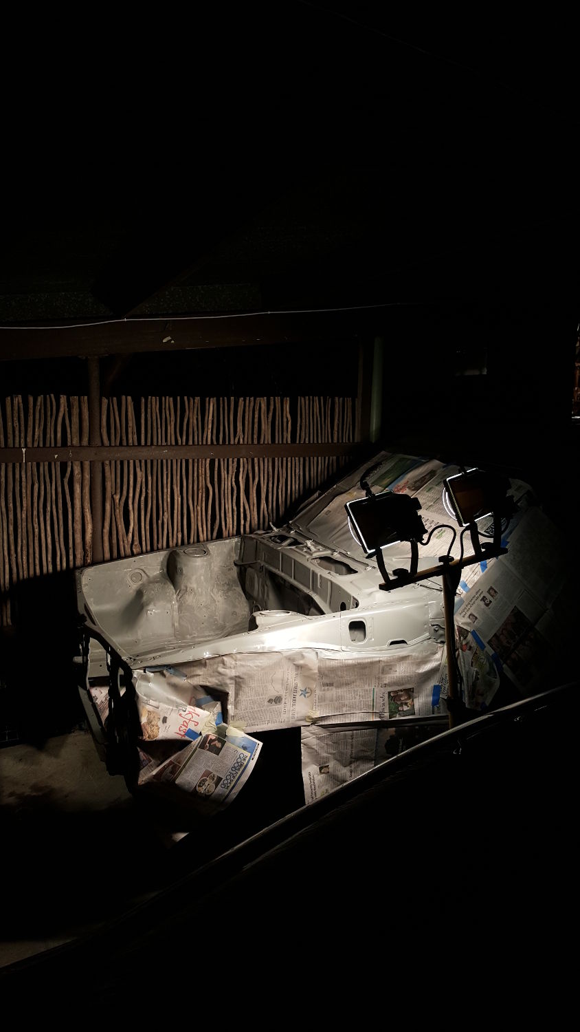

So the plan is to have the engine bay sprayed tomorrow, hopefully the weather holds out and can finally get it done. Also bought two 10" thermofans the other day, and I'm getting a shroud for those made up by a mate at the moment. Could and maybe should have gotten a shroud + two fans to suit my rad for $168 off ebay, but it is nice to support local. Won't end up being too much more anyway.
Struggling to make up my mind how I want the interior too, originally wanted a contrasting colour to the grey, but now I'm leaning towards something darker.
Anyone have any input on a torque wrench? are supercheap/bunnings/kingchrome ones fine or is it worth spending more? I do want something that'll last, but don't need to go overboard with it.
Finally got the engine bay sprayed yesterday...buut theres still a bit of over spray in the tight spots, and some parts were missed on the rear of the radiator panel with primer still showing. Bit of a setback but I'll give those spots a wet sand with 1500, then have another crack painting it myself.

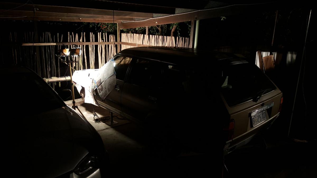

Trying to make some progress where I can, in 10 degrees, the wind and the rain.

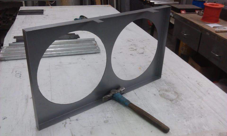

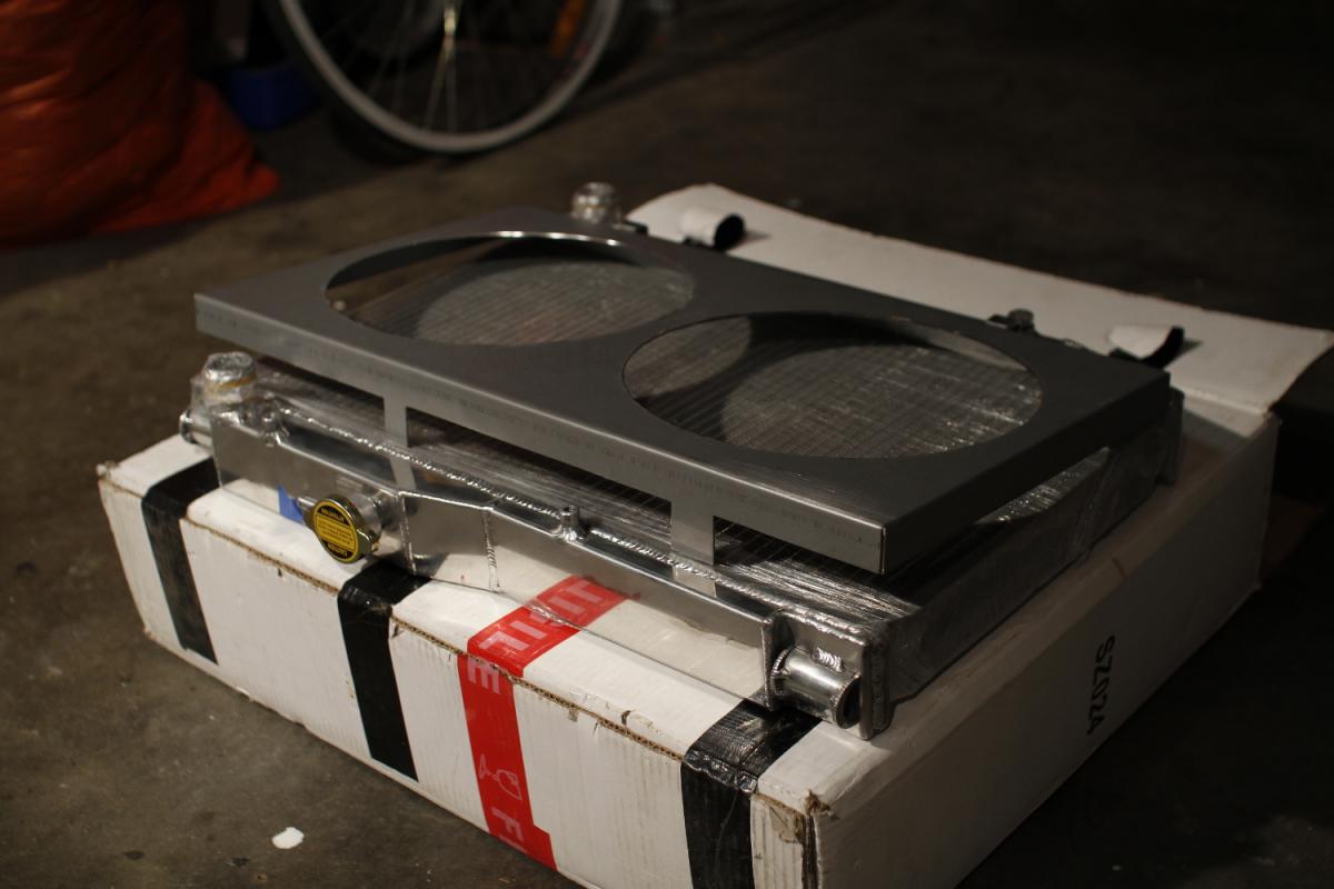

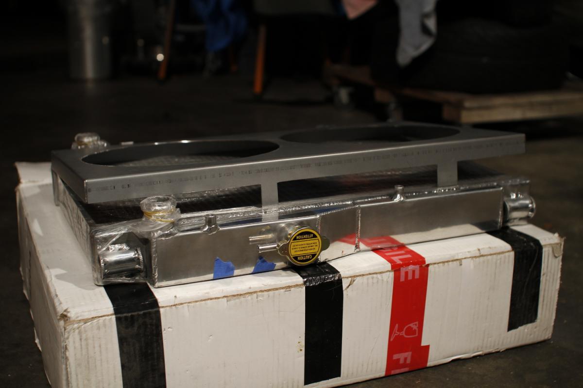

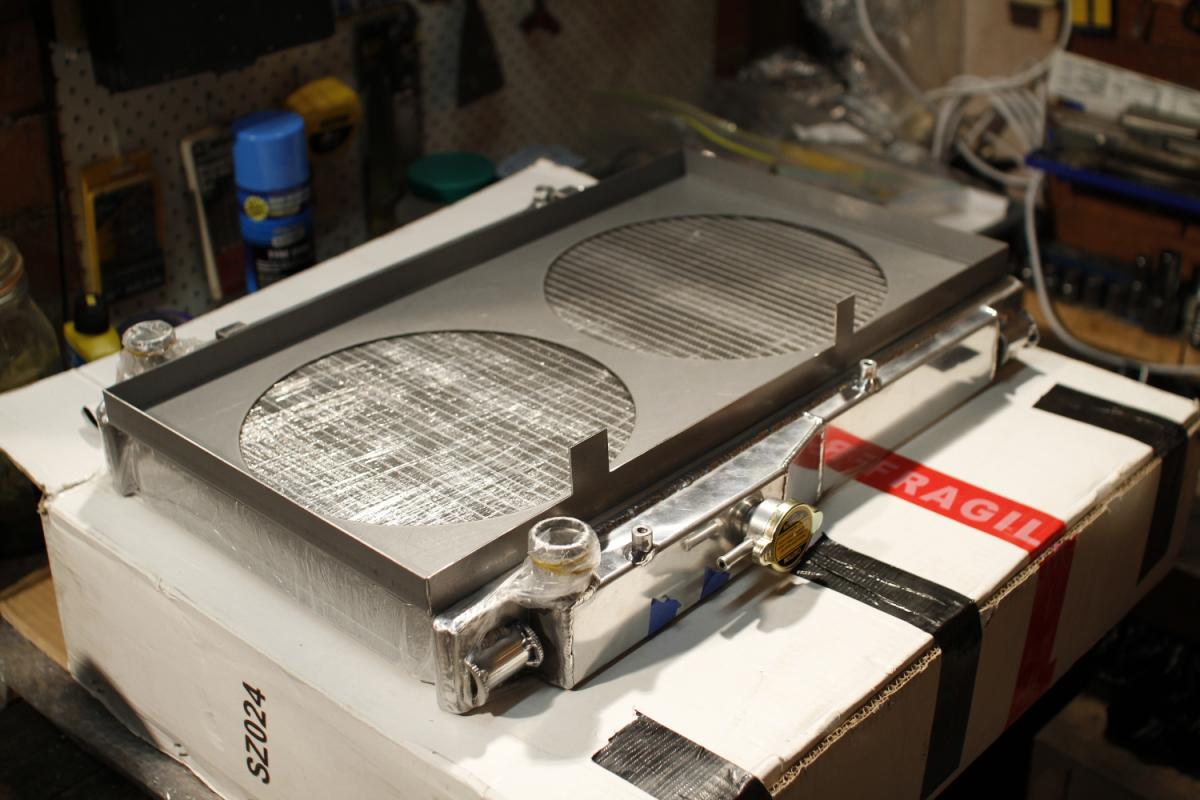

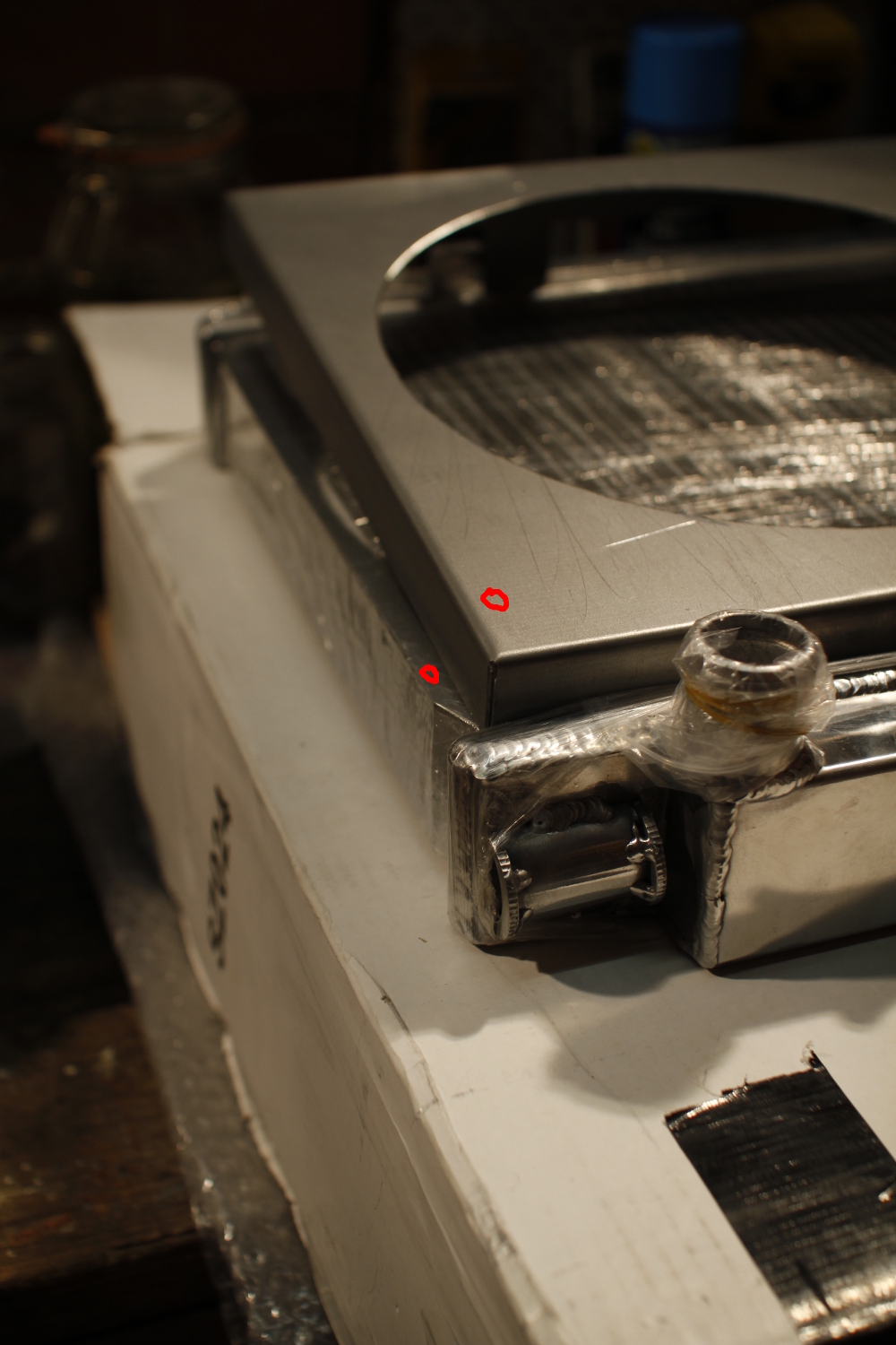

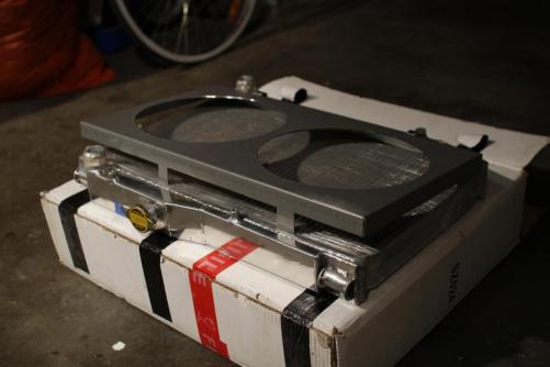

Got this update on the radiator shroud, turns out I forgot to tell my mate I wanted aluminium or stainless, got mild steal instead. So won't be exactly what I want, I'll probably paint it black or something. Little disappointed as I wanted it to match the rad, and as I could have gotten one delivered for cheaper including two fans, but ahh well. I'll probably end up getting an aluminium one at some point anyway.
Picked up the radiator shroud, and its wrong. Looks as though the drawing was right, but it has all been bent the opposite way, as the top tabs don't line up..
But flip it around and they're all sweet..
So I was rather annoyed as it ended up costing more, and didn't even fit. But I've got an idea.. going to cut the tabs off, and just drill and bolt through the corners of the shroud and and the lip on the edge of the rad. Can fit a 5 or 6mm bolt so should be plenty. Hoping it will all turn out clean and simple.
