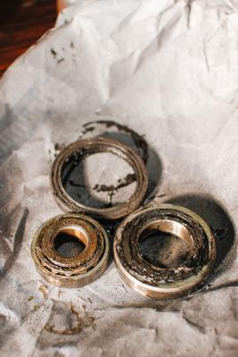

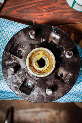

I also replaced the front wheel bearings, and plan to do the rear. They looked as if they'd be fine with clean and regrease but I'd rather just know they were new. I hit the seal and bearing races out with a hammer and screwdriver, scooped all the old grease out and wiped it clean with solvent. I lightly greased the new races and hit them in with a socket. Again, a press is preferable, but I couldn't be bothered. We'll see how it goes. Packed the new bearing with grease and shoved a decent amount inside the hub. Replaced the rear seal, greased the stub axle and slid the hub onto the coilovers, awaiting new discs and grease caps to finish it off, and the front setup will be complete, ready to be installed.
