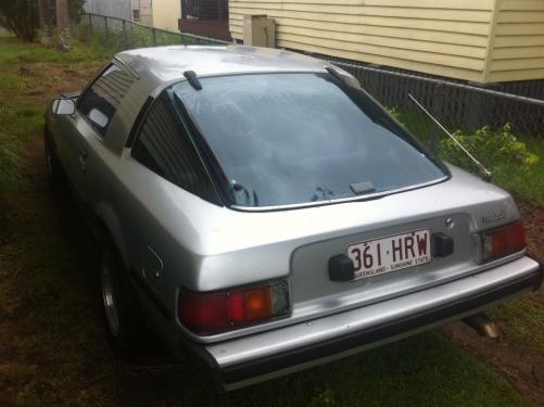

I've painted an RX7 in silver acrylic before and I wasn't happy with the result. It looked fine - like a maintained example of a 30 year old car. But not a freshly painted one. A friend bought the RX7 off me and painted it again in silver acrylic and got the same result. Actually I reckon my job was better.
Spray painters I've spoken to have suggested that silver is the hardest colour to get right - and that my other problem was painting in acrylic. I lol'd out loud. Unfortunately my budget won't allow a professional 2 pak job.

The RX7 only had 2 or 3 clear coats. It probably wasn't too bad in hindsight. This is the day I sold it. Phuck it was a hose beast.

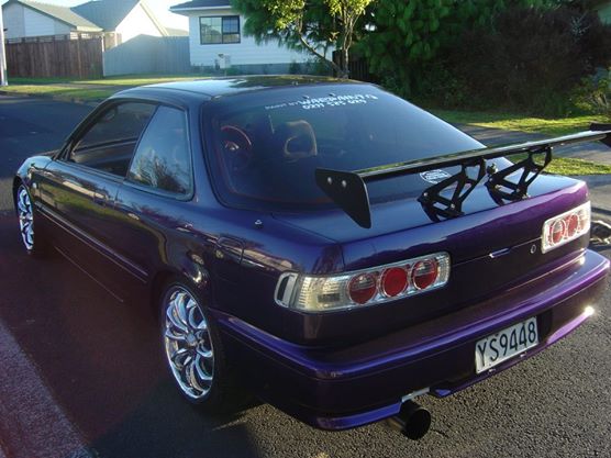

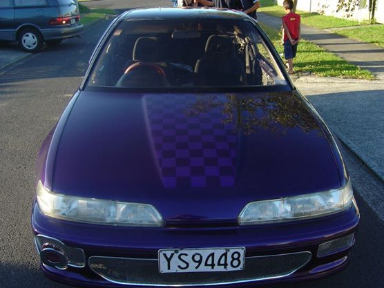

Wow nice one! That's puts the old acrylic vs 2 pack argument to rest.
Dare say he's monster flake fairlane would have looked mental with a polish.
When I get him to redo the paint on the 11(damn right you are!) it will be acrylic. I'd throw even more clear at the bay. My datto wasn't clear coated in the bay when prev owner did it and geez it stains easily.

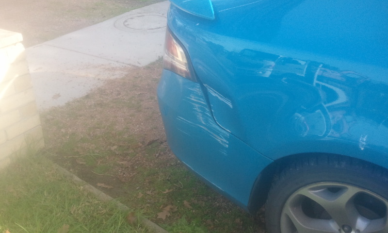

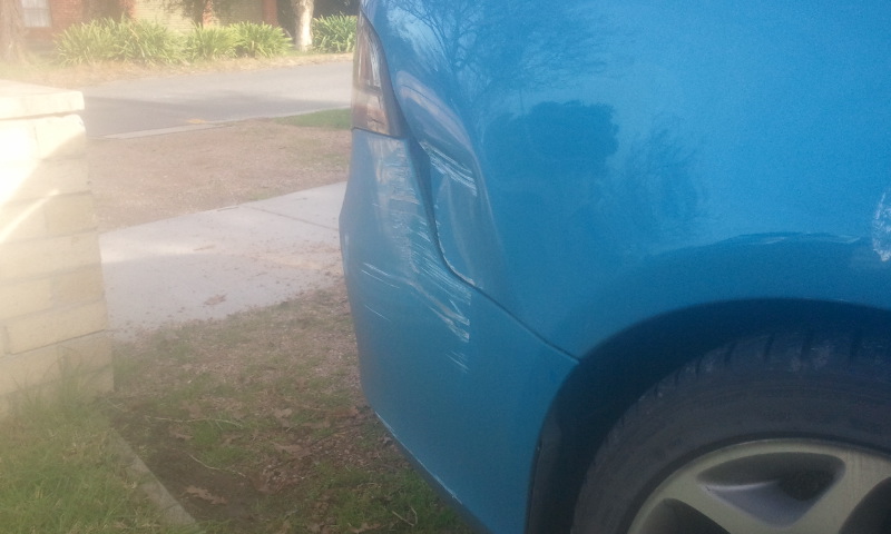

Ohh this oughta be good!, The better half had a bit of a moment and reversed her xr6t into the brick fence!!!! Substantial
damage was caused including folding over the rear 1/4 panel and putting a large crease behind the wheel arch, and some
really deep gouges in the rear bar cover, NOT GOOD!! The excess on her insurance is $780 and may cause her to loose her perfect rating so....
it looks like I'm on the job :thumbsup: All good kiddies, guess what ill be using? not really tryin to be clever,
just proving a point ill make a thread for you all, have a look if your interested.....
