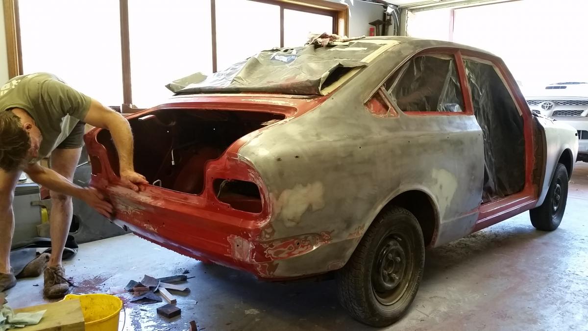

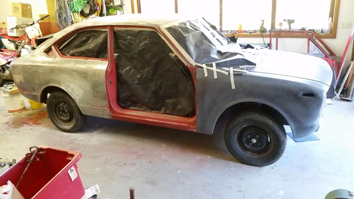

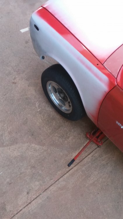

Had a good day working on it with my dad;
post-19257-0-63954000-1484949510_thumb.jpgpost-19257-0-20702300-1484949425_thumb.jpgpost-19257-0-80391400-1484949358_thumb.jpgpost-19257-0-34217200-1484949283_thumb.jpg

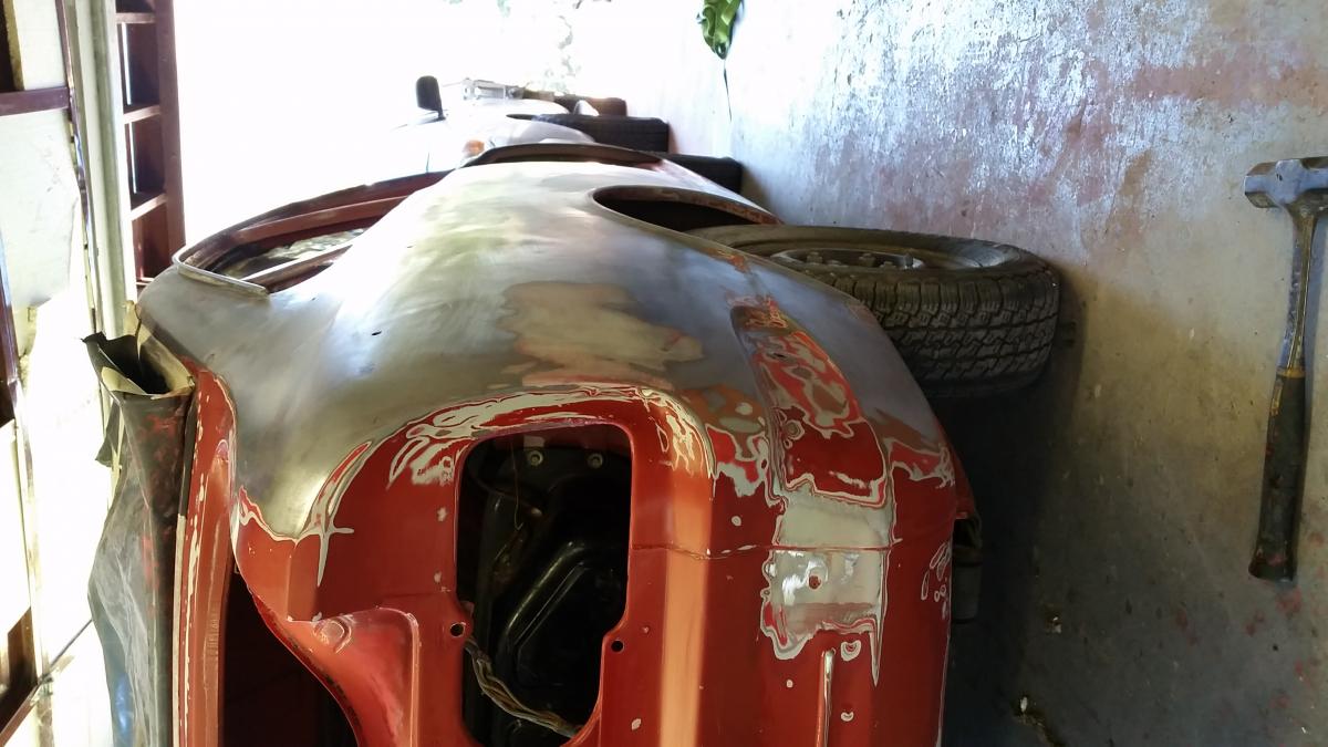

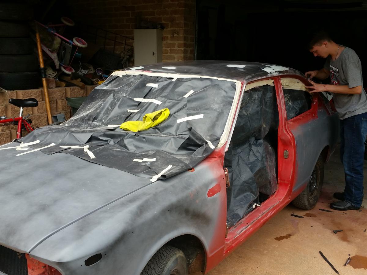

Looking pretty good from here. Much of the bodywork is done, with only a few bits and pieces remaining.

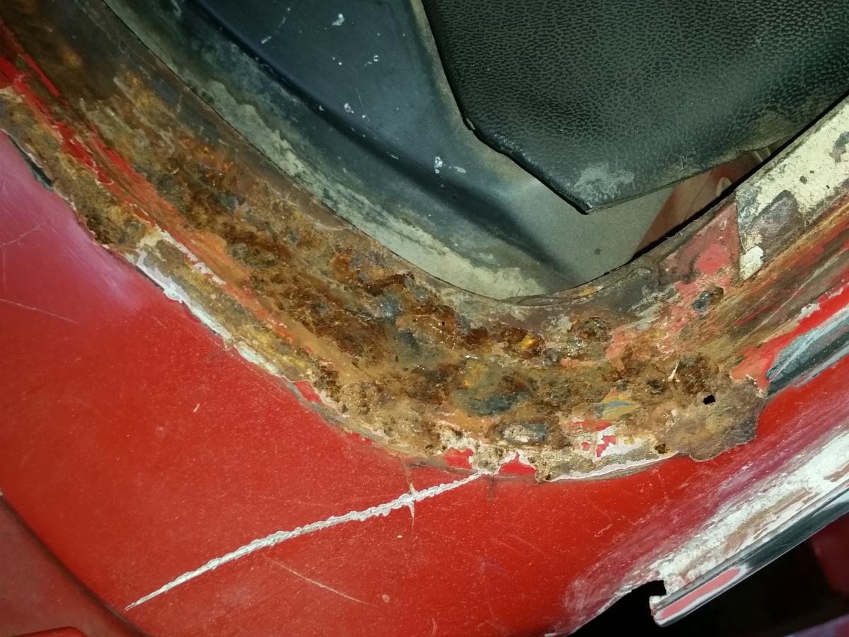

We did know that there was a little bit of rust on the front left corner of the windshield, but we didn't know to what extent.
Unfortunately, even after our cleaning up, this is a shop job. We can't do it :/

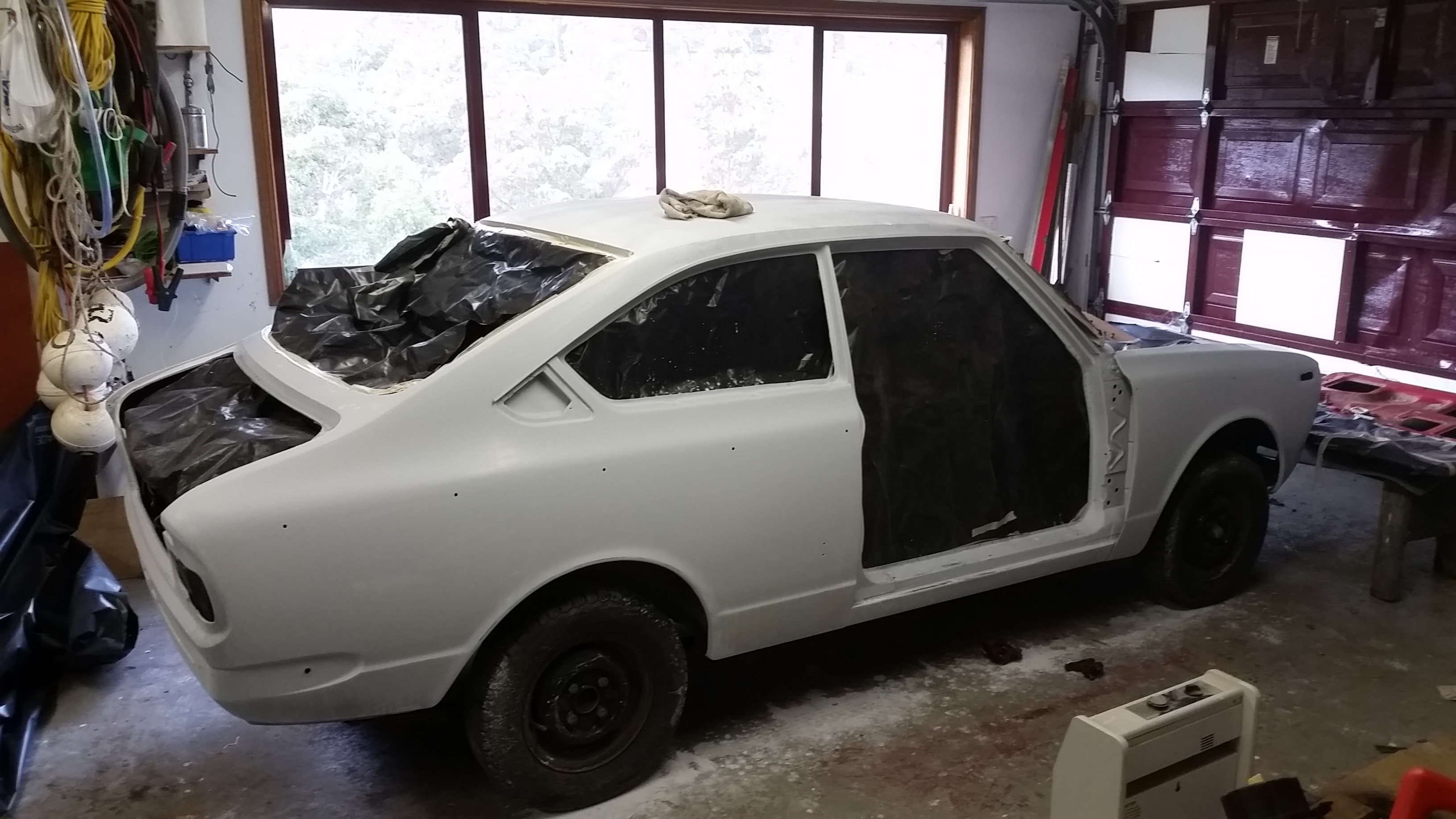

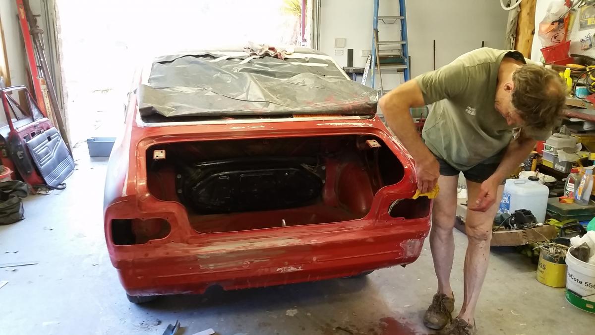

Hello all, about due for an update i reckon!!

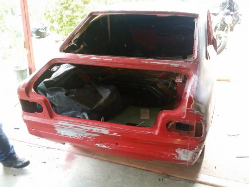

We got the car back from Havnadip with the rust repaired and body ready to go! Had the boys there really help us out and to them we owe thanks!
With the car being beautiful and straight, we were ready for paint!
So over the weeks trailing the car's return, we slowly readied her for the first glimpse of that beautiful Helios red.
Lots and lots of prepwork. Masking, sanding, etc etc.. lots of time and effort. Both of which are a bit hard to find considering I'm now in Grade 11 as a student!! (Money, too!)
One way or another, with the helpof spectrum paints, the boys from Havnadip, our mates from KTM hobart and a handful of others, she now has a glimpse of what is to be!
The insides of the doors, boot and bonnet are now red! Next on the plate is putting them back on, then preparing the whole body for the final spray!!!
Very exciting progress!

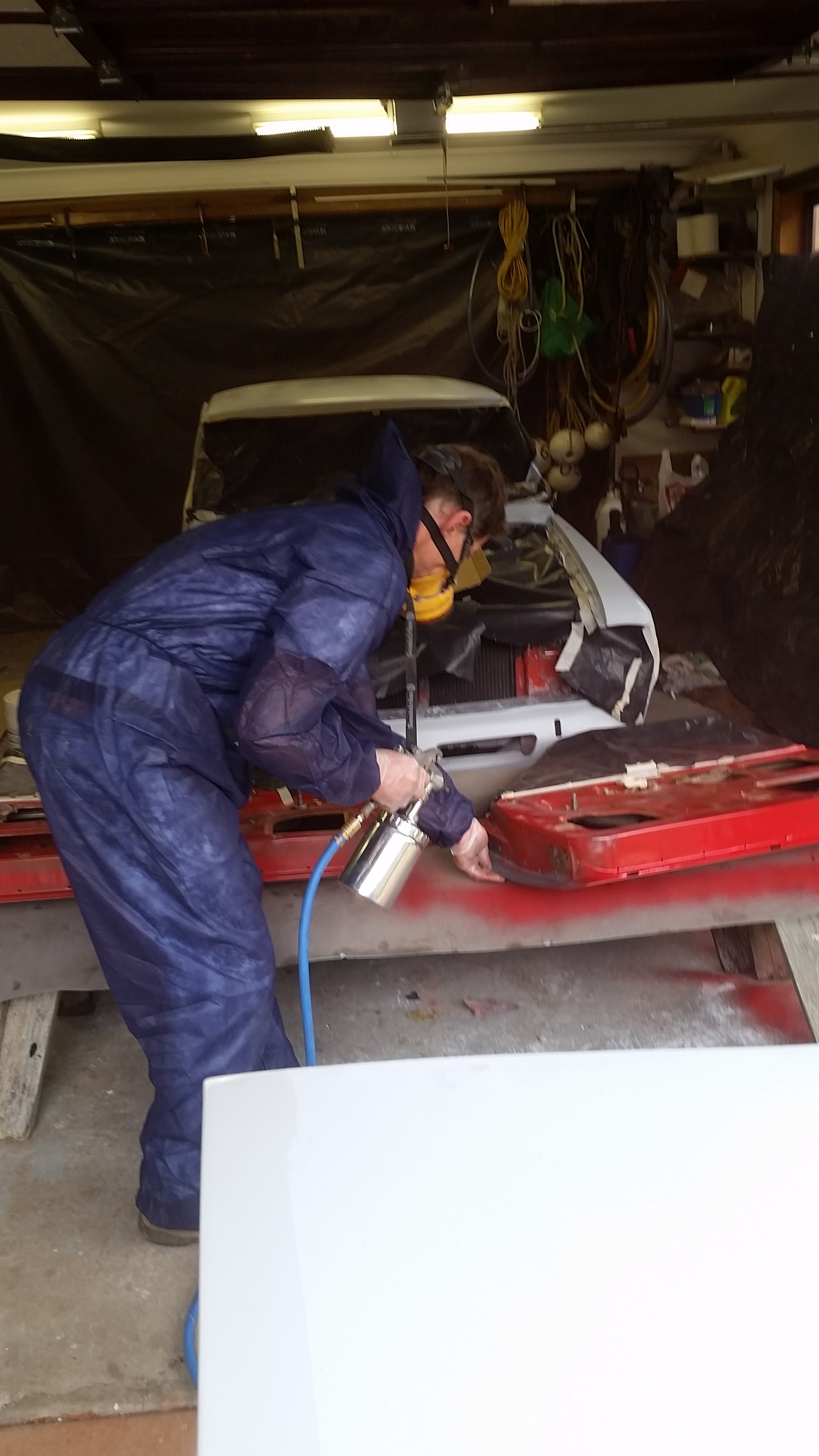

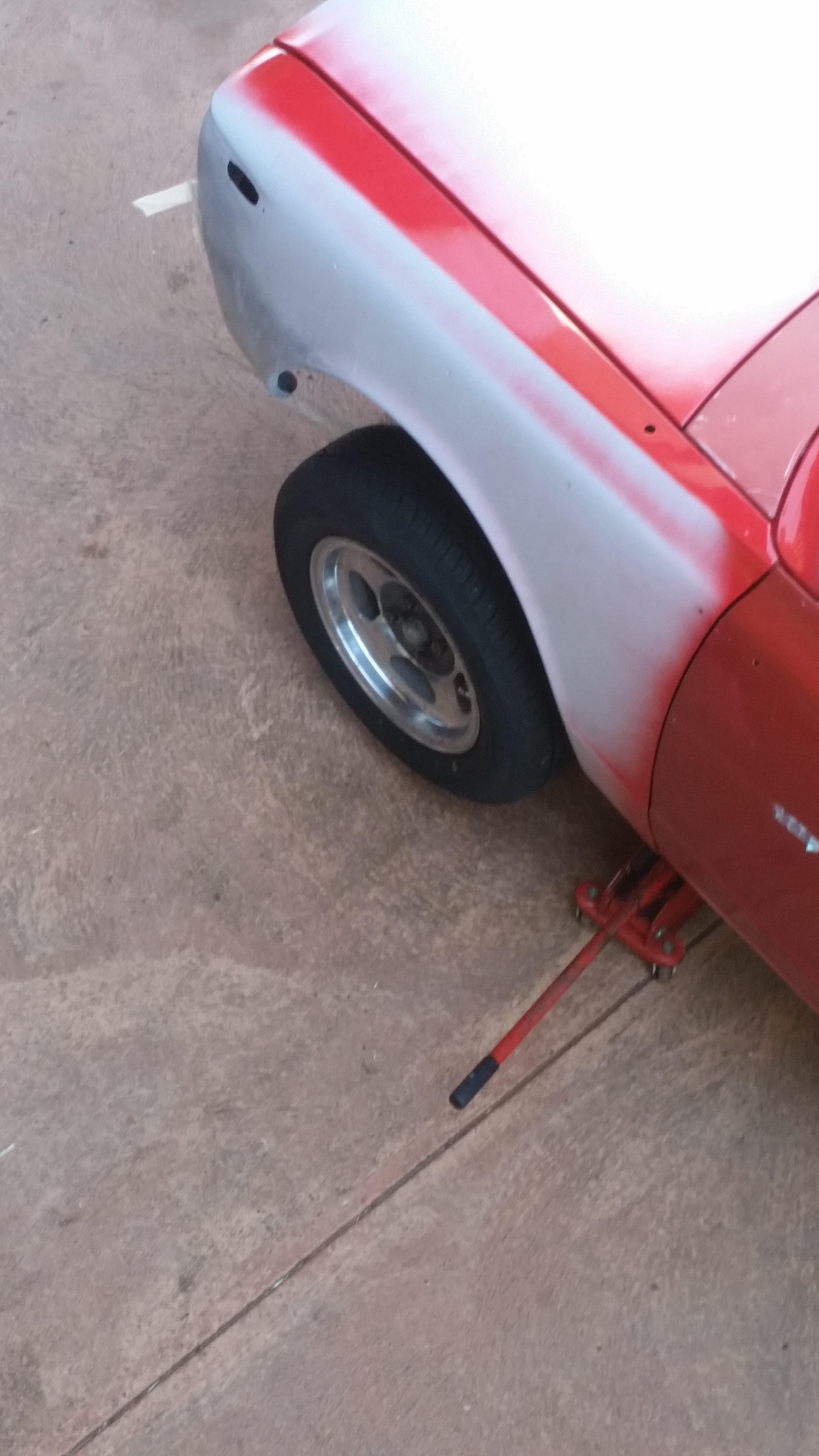

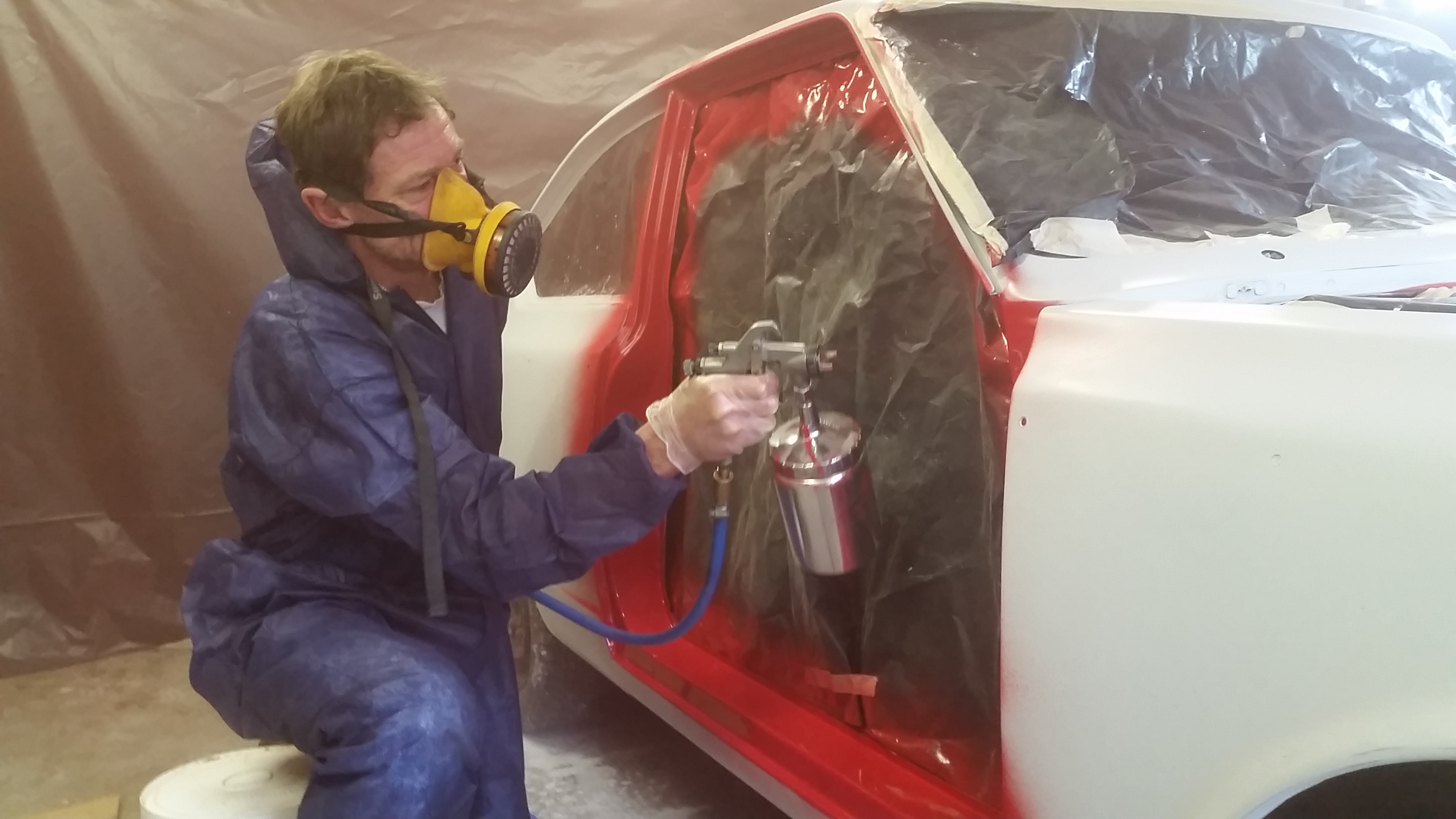

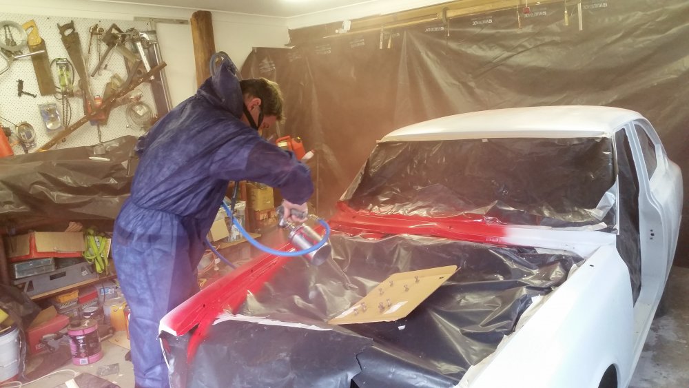

and massive props to my dad, who has done a fantastic job spraying the sprinter. Especially considering how long it has been since he last did it!20170527_094644.thumb.jpg.7681d52ef36eca6cece4aa97f8598cc8.jpg20170527_094655.thumb.jpg.73a0b79006c12b55b47be13f2f8b2135.jpg20170527_094711.thumb.jpg.2359f9237971d582ed4cd8784b510dd2.jpg20170527_115918.thumb.jpg.5229b1de372ba8dedfc79e2a47990f42.jpg20170527_120411.thumb.jpg.c64d5e73da53cfc03af59f7f3cbf76dc.jpg20170527_121145.thumb.jpg.f27d3bcd6f70483f6d27750b831dfad6.jpg20170527_121303.thumb.jpg.2e427990e8b2a8e883df76ddc4a6ef42.jpg

Did you spray in 2pack? What brand paint did you go with at Spectrum paints? I went there the other day and they suggested to go with De Beer.
Hey mate, yeah we went with 2pack and also used De Beer. Colour came up really nice off the gun. :)
On 6/1/2017 at 11:53 AM, ke70dave said:
How did you go painting 2pak at home? do you have to bake it in the sun?
Ive only ever sprayed thinners based acrylic, always been a bit scared of 2 pak...
Seemed to go pretty easy mate, we were advised to have a small heater in the garage to take the chill out of the air (as to not effect the paint) and mix the paint using a bit more hardener so that it dries faster. After a short while it was dry. It's been in the garage for over a week now and I am soon putting the doors etc back on as they are now completely dry. :)

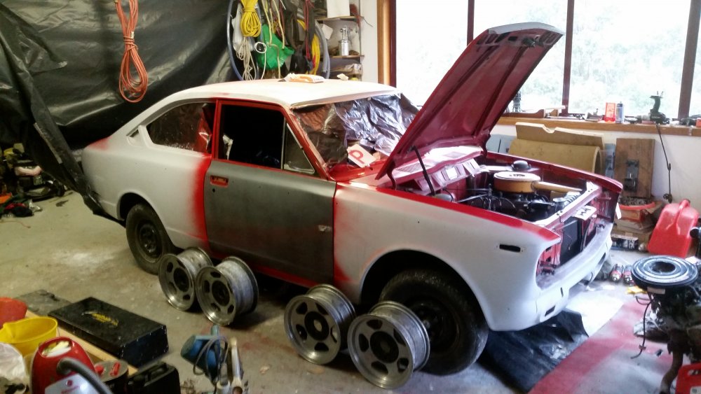

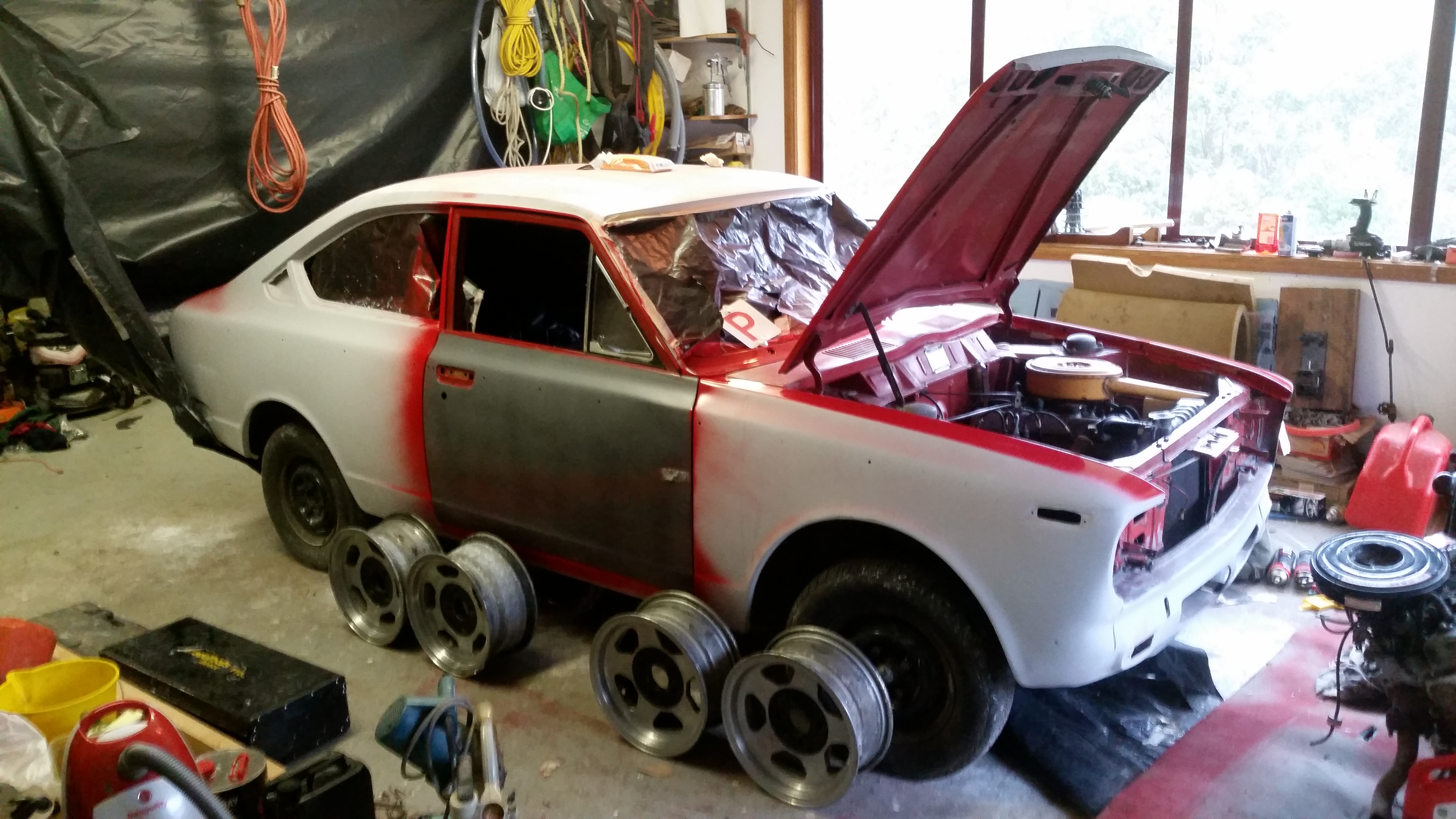

The doors are now back on and hung (kind of) properly, I've discovered that my widened steelies are a little bit expensive to bother with, and have my door seals on.
I also bought an entire spare 4K-C engine with a 4 speed box for 150 bucks!
And just yesterday; I bought a great looking set of mags. 150 bucks, no tyres but being 13 inch they are easy and cheap to come by.
I also "decided" to leave the roadbikes alone for a while.
(I got caught speeding and am suspended ;p )
That said, I've sold my bike and have paid off my dad what I owed for the bodywork, and have a little bit of cash to poke the Sprinter with. Looking forward to seeing it painted.
I hate to put dates on this build because they don't get met, but I'm thinking at this stage, by my eighteenth birthday (January 23rd) we should see it painted and almost ready (if not entirely) for rego.
Here's hoping!!!
So today; i went and got a few bitsand pieces to get the car going again.
New oil, plugs, fanbelt, and my new -supposedly working- alternator.
My wiring is shoddy but I will have someone who's a little neater have the car cleaned up.

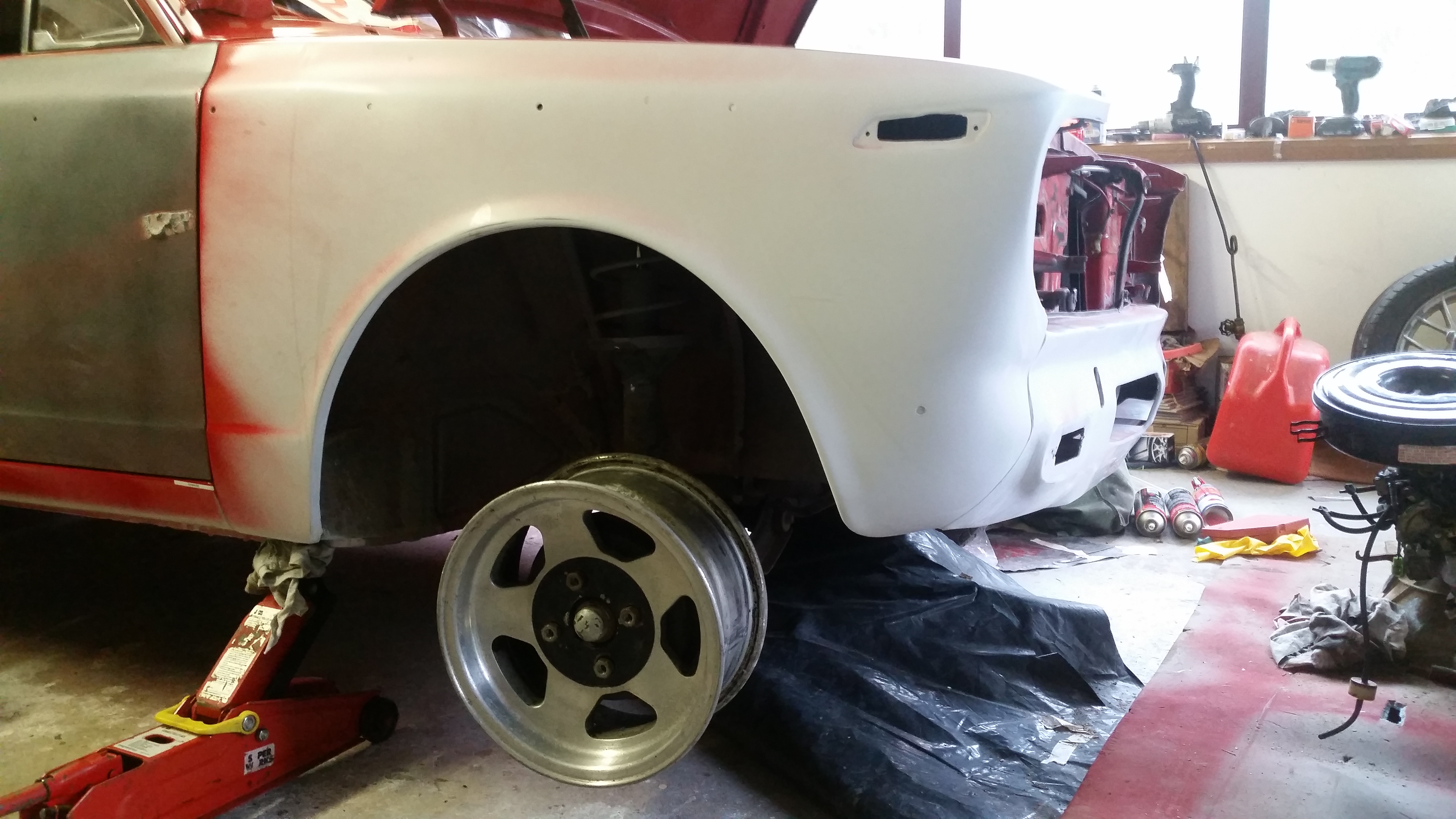

Also! Some new regarding my new fantastic and gorgeous wheels!
...they don't fit.
They're 4X108 not 4X110!! :,/ so that means i put a fresh set of rubber on them for no reason... great.
Real shame too. I love how they look on her. Have considered a few various options including redrilling, changing hubs etc etc.. but have decided I may as well jsut flog them off and see if I can get my money back. Give me a ring if you want them. (0458-677-210) haha

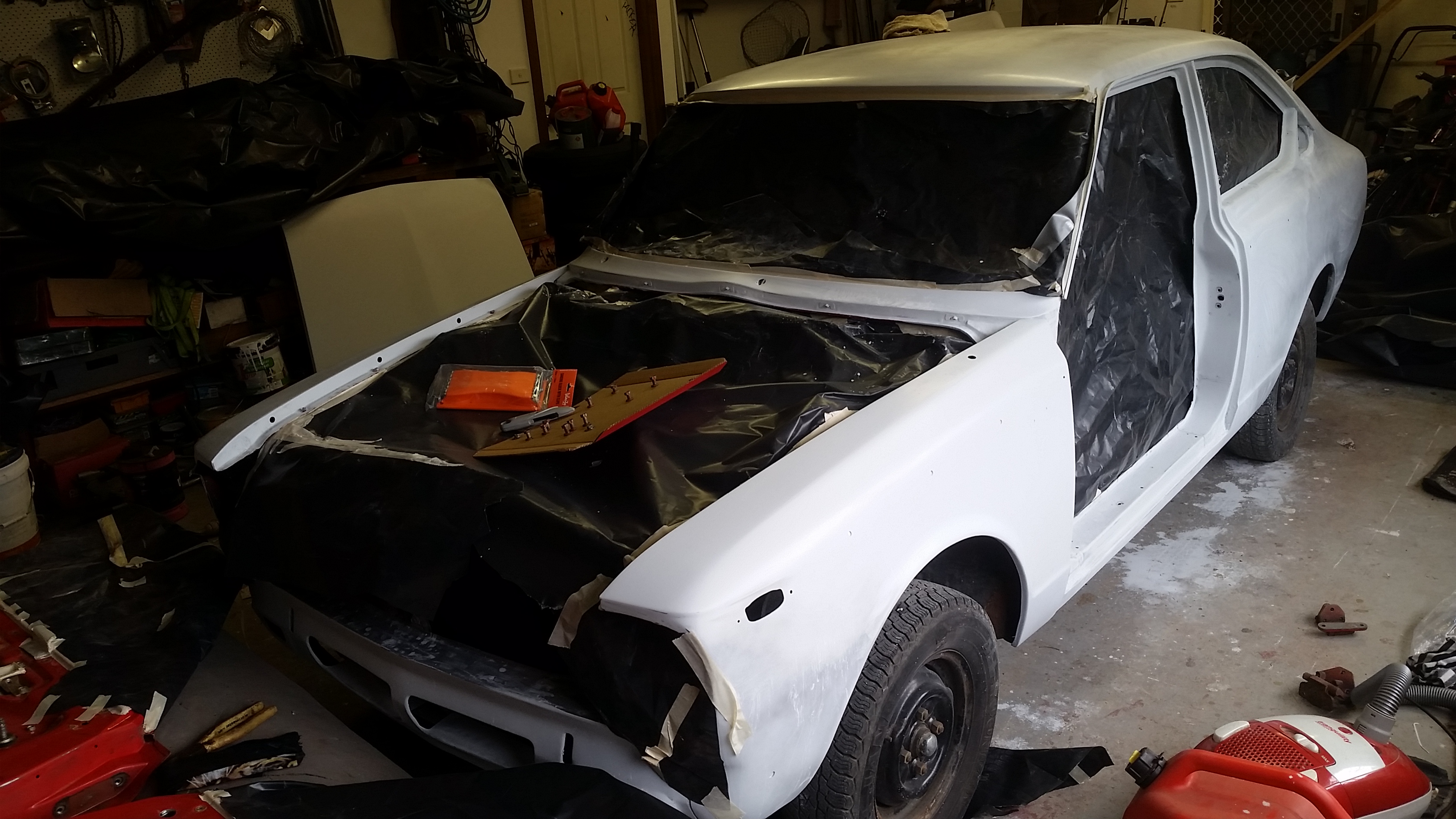

Next thing on the to-do list is fix the remaining body imperfections on the roof and passenger door. From there, we can prep the body and get things going for one of the most exciting parts of this build...the paint!20171004_173753.thumb.jpg.772bd52149352f837120b0843dd028ea.jpg20171004_174353.thumb.jpg.daaea4bb5fc9a8eaca603280f77308b0.jpg

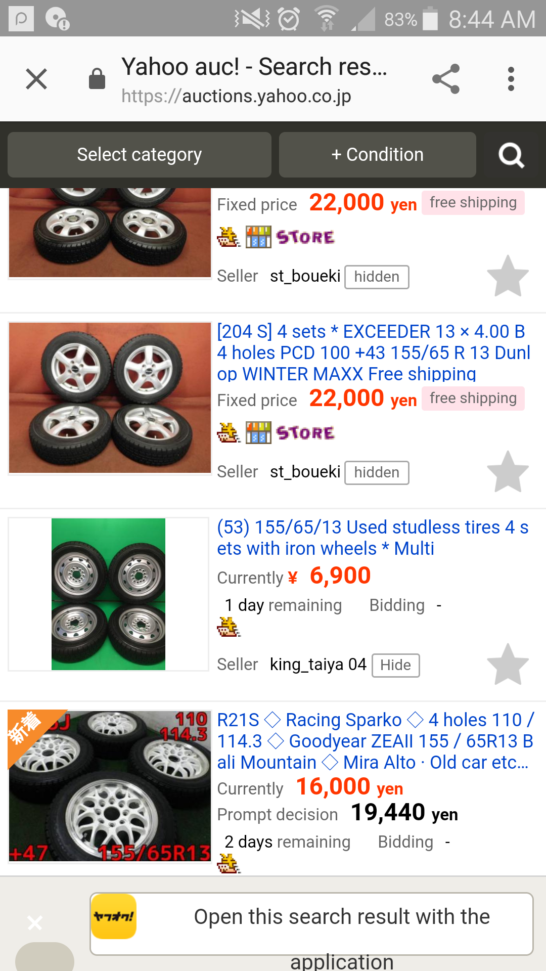

Looks great Harry.  Just move the wheels on, it's not worth the hassle, and I'm sure you will find something you like even better that fits.
Yahoo Japan is a really good place to buy wheels in the size you need at very reasonable prices.  You would be surprised how cheap, especially if you are prepared to be a little patient and wait for the right wheels at the right price.
  • Upvote 1
Wow, you're absolutely right. They're quite cheap, but, surely postage is what bites you on the bottom?
-thank goodness I found the english option-
Looks like a cool setup though. Bound to run into something cool. Cheers Parrot!
Use one of the importers and container shipping can be pretty cheap. Be patient, there may be nothing decent or cheap for a while, then bang, there they are.
Also be careful with your sizing/offset.
I have some nice Enkies in 13's, and two sets of Weds Albinos in 14's. None more than about $350 - 400 landed. Obviously cheaper without tyres fitted.
A good importer will ask questions for you.
  • Upvote 1
Yes and no on the wheel importing. I've found them cheaper in Aus than from Japan latelty.. I bought a set of 13x6.5 techno trv for my sprinter the other day, sale price was around $290aud, shipping within japan, brokerage fee and shipping to aus by *sea* was another $390
  • Upvote 1
Oh geez, loads of fun. I guess if I can get something super cool for cheap it'd be worth it but I think I'll have to do a lot of filtering through all the awful ones!
Yup. Welcome to yahoo Japan!  There are clearly some sellers who work on large volumes and bargains can be had for those who are patient. Generally a wider range in sizes you need that what you will find here. There was a guy with some nice 110's in Tassie on one of the Corolla/Toyota pages but he was trying to swap for 114.3 rather than sell. Could always see if he will sell
