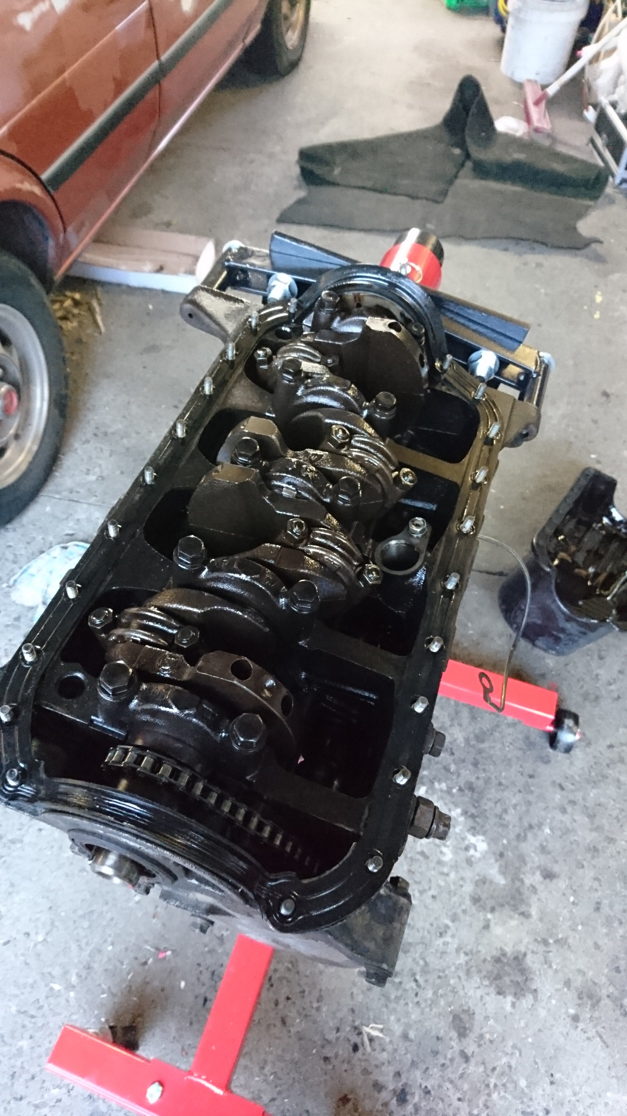

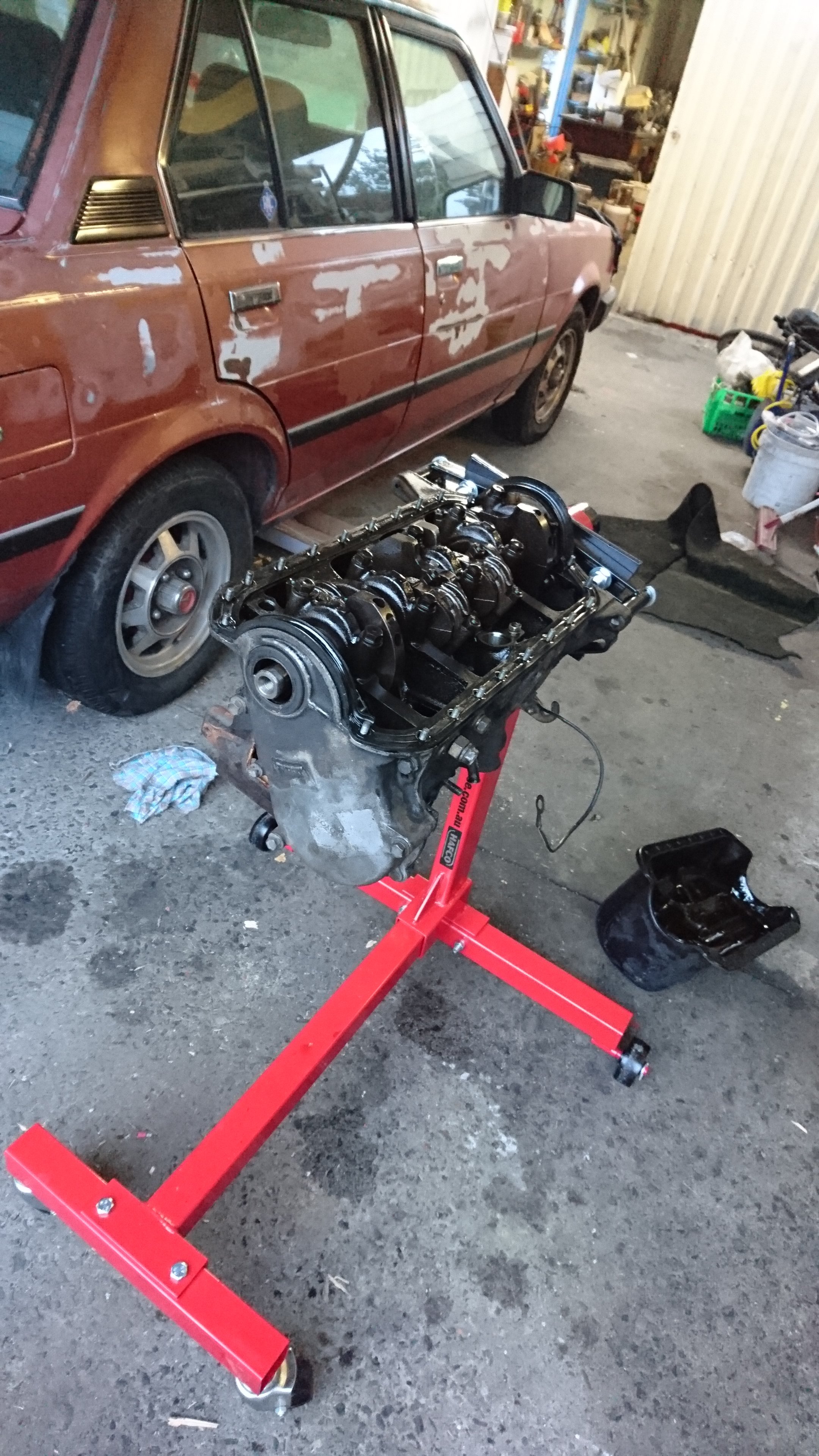

I'm aware of using washers on the engine stand...doesn't help if I don't have enough, but I have it on now, after uni tomorrow I can strip the rest down and hopefully have a chance to call romac

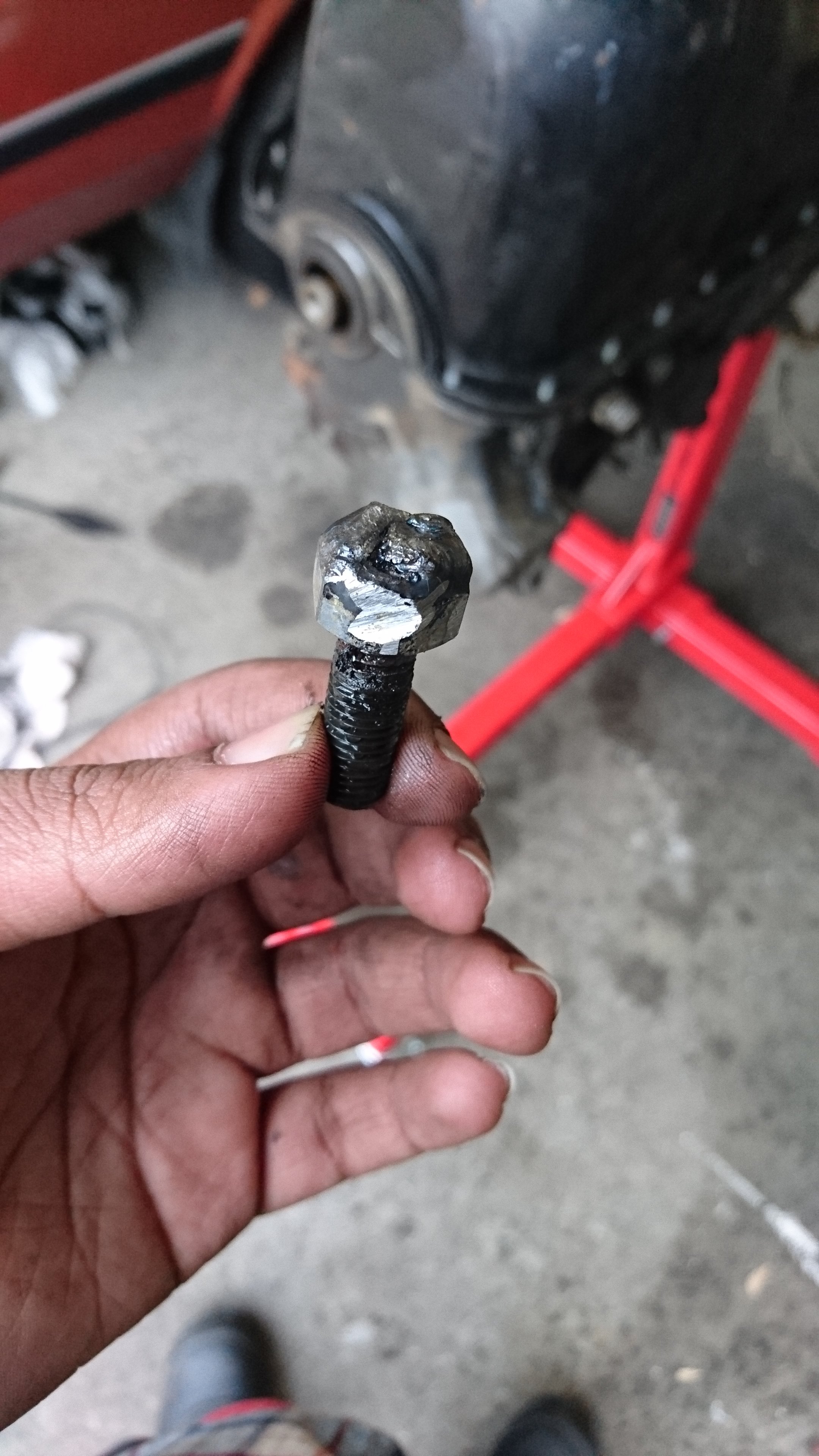

Unfortuantely no real progress besides taking it apart and getting rid of the busted head stud...arc welder plus noob bogger weld = win...I'm far more better with acetylene welding and tig welding...need to learn to mig weld better and god awful at an arc welder
Hopefully I can get in touch with @7000rpm for some bits and pieces, mainly nuts which hold sump (motor only had 6 on it) what I get for getting a motor on a pallet, and oil pump and oil filter assembly (both of which were missing), Flywheel, Backing plate (between engine block and flywheel), and I need to get an electronic dizzy
