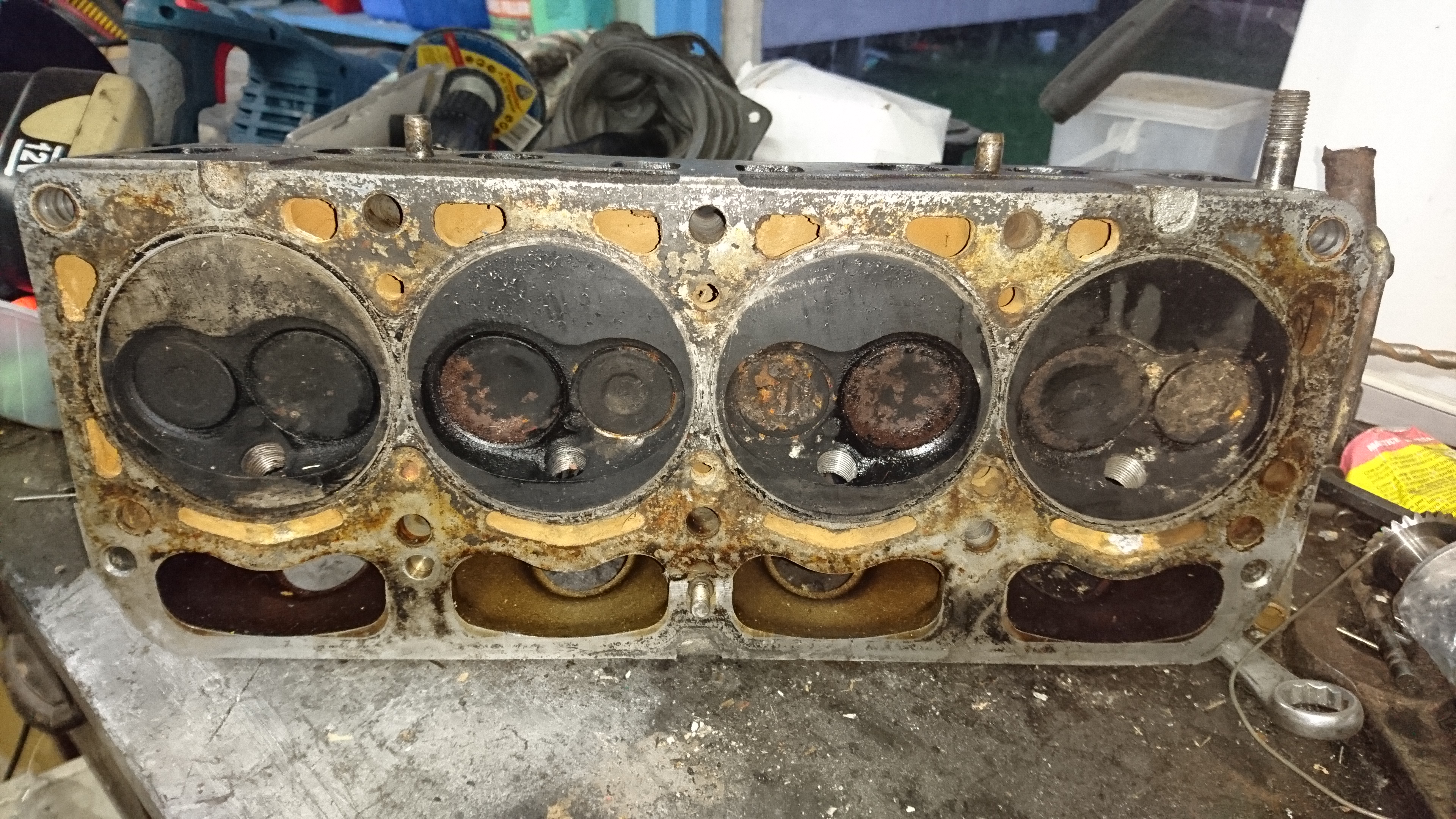

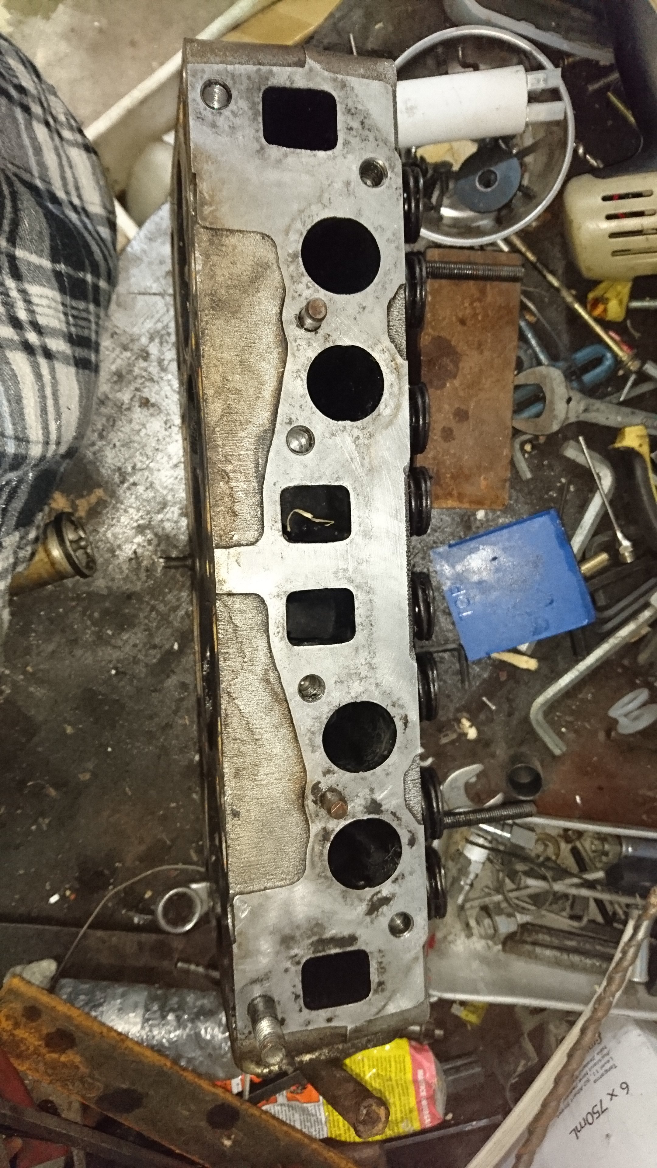

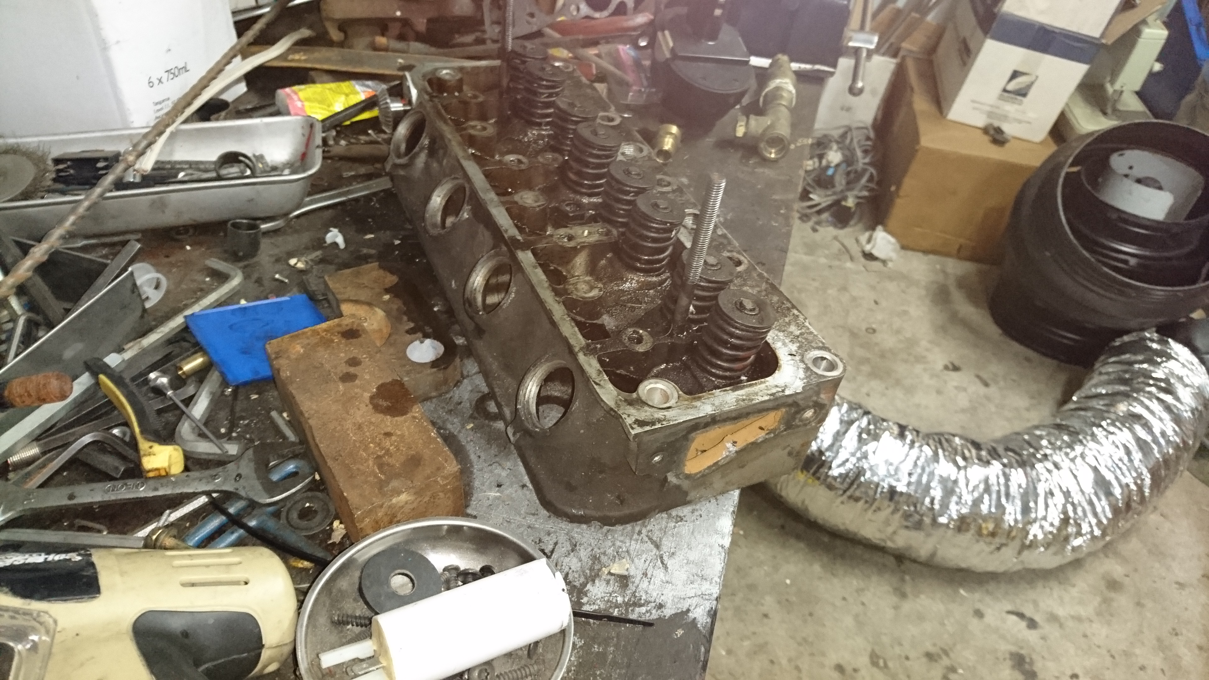

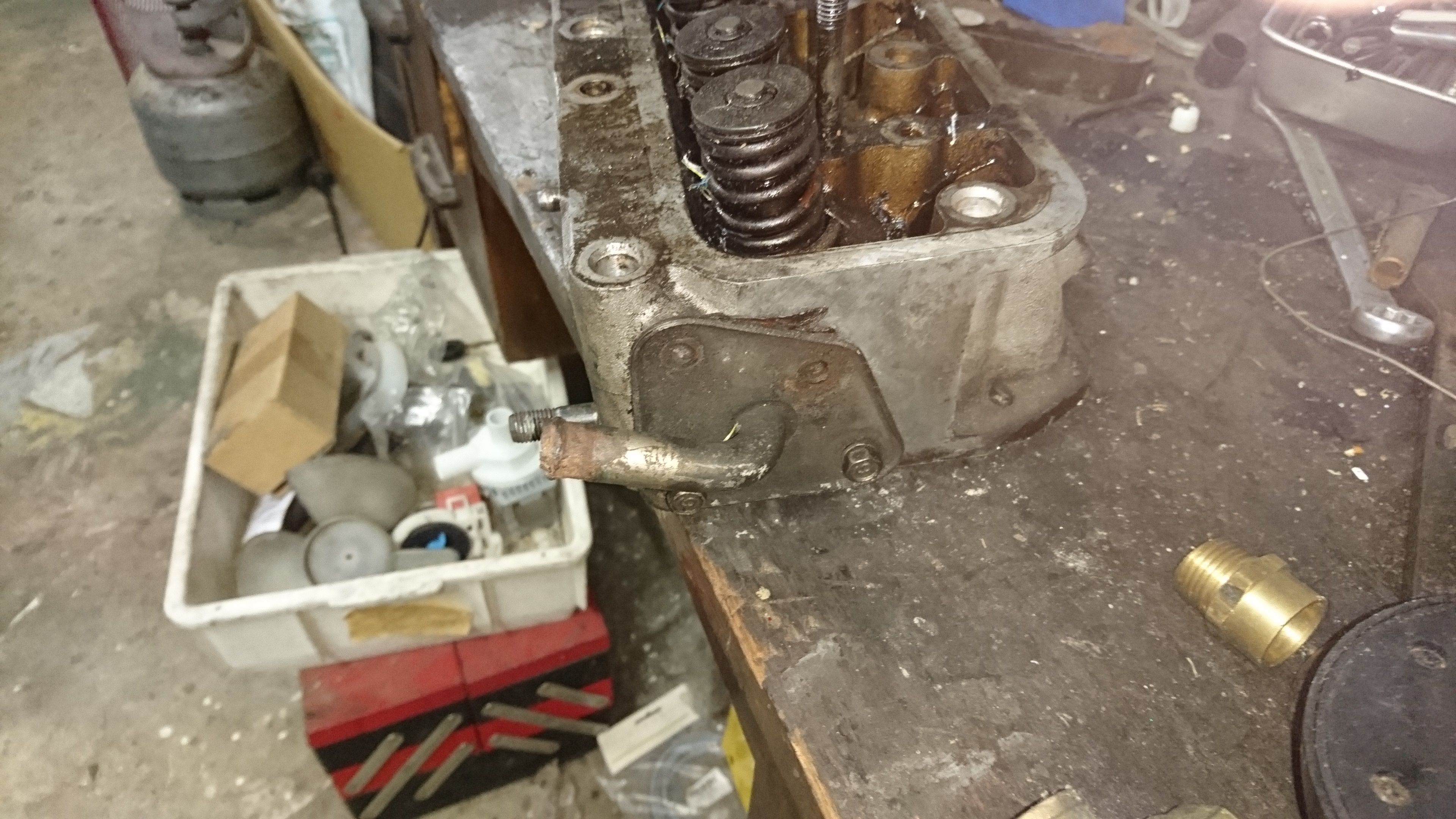

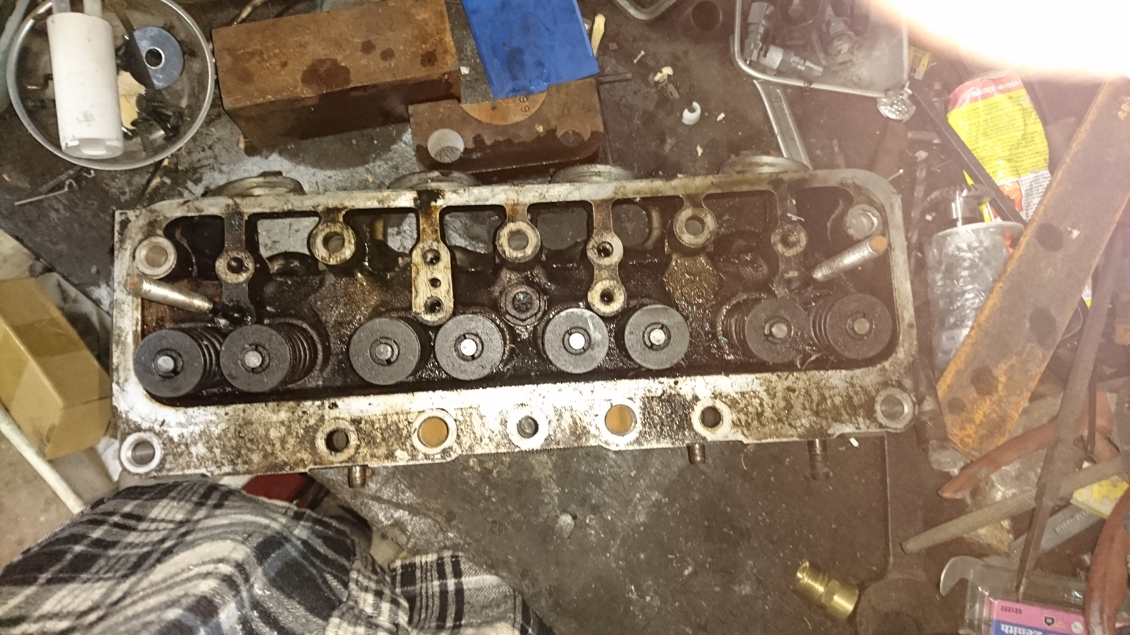

Hey guys quick update, I'll put some pics of the head how it is at the moment (haven't sent it off yet since discussing all the work with peter from head2head clayton, and also FERAL 4K...he has offered to help with the head and i'd be stupid not to accept...still wish I had the money to buy FERAL 4K)

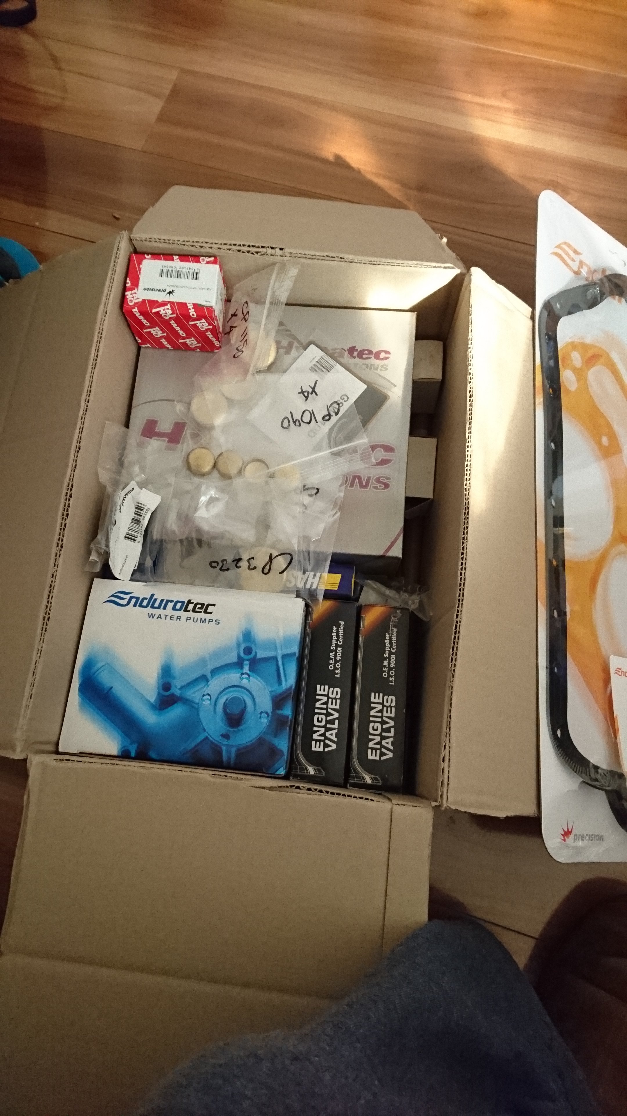

Had some parts come along, I'll post some pics in later post

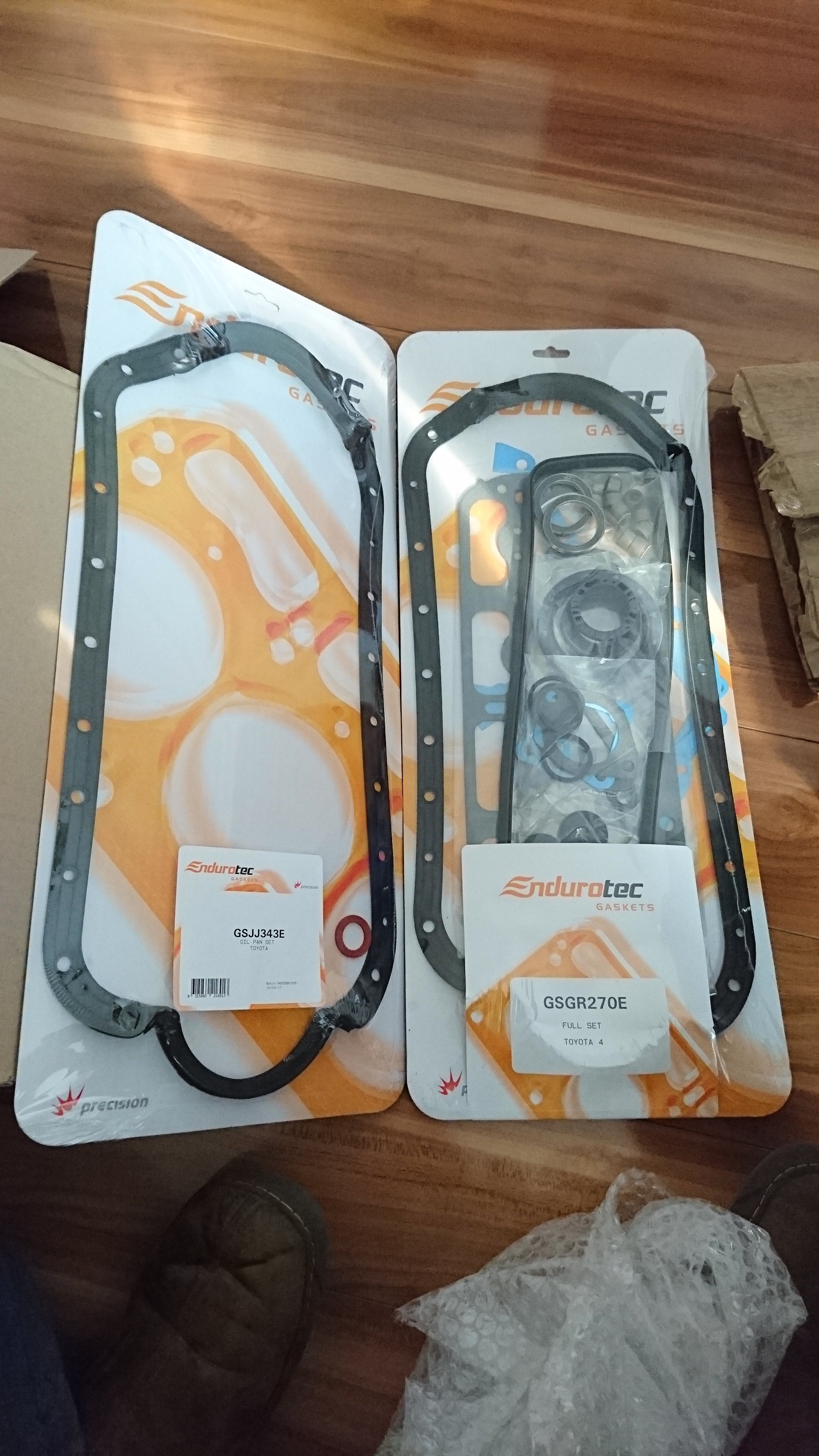

Still looking for Genuine 5k head gasket
Edited by KaboomJohn111

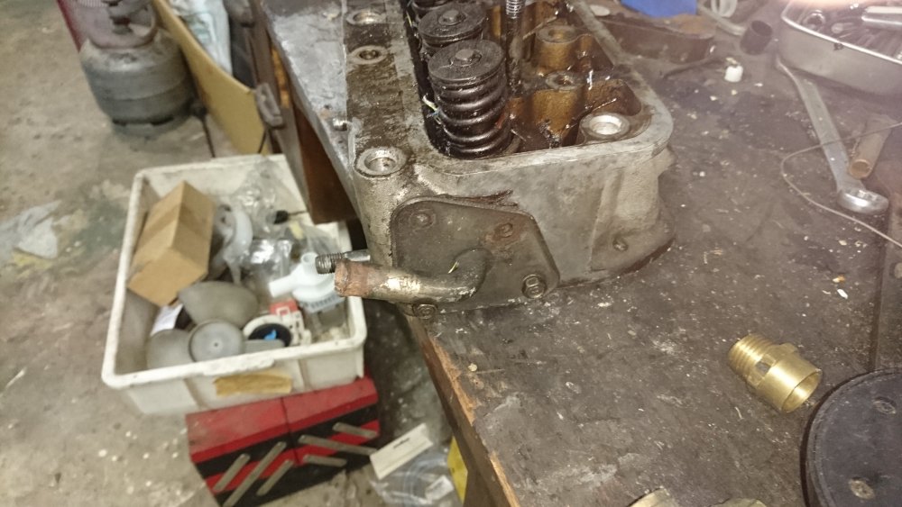

going to replace this heater return for a plate (since my 4k doesn't have a line there so plating it should be fine...maybe TIG the bastard)

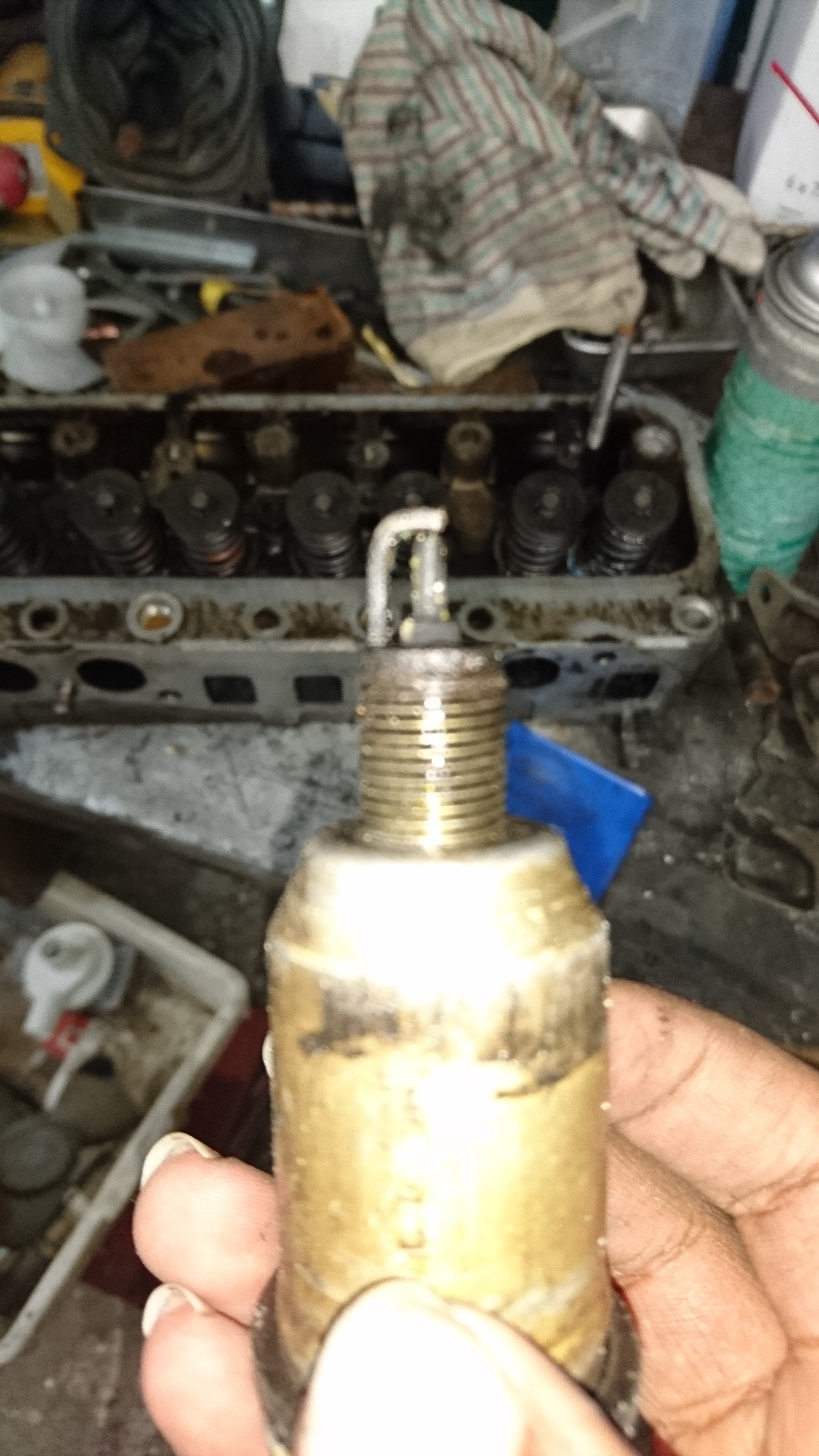

Admittedly...first time seeing a long reach plug on a k-motor...I know they are out there, just never encountered it. something interesting though to find and didn't expect it.

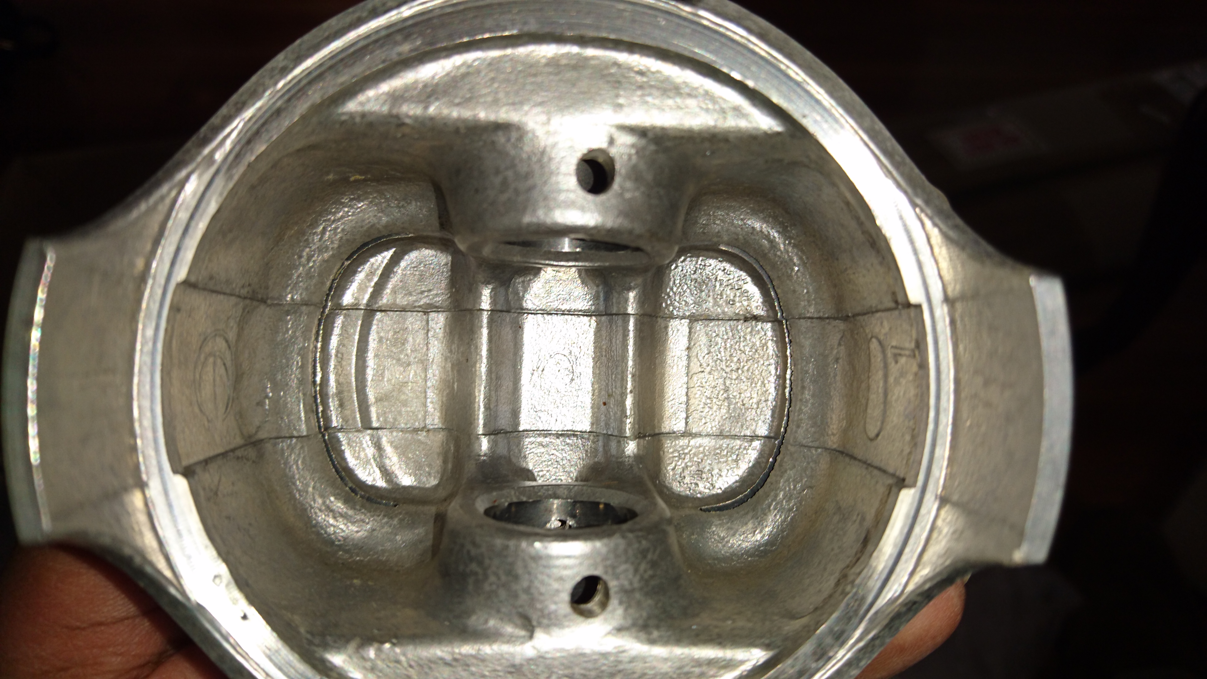

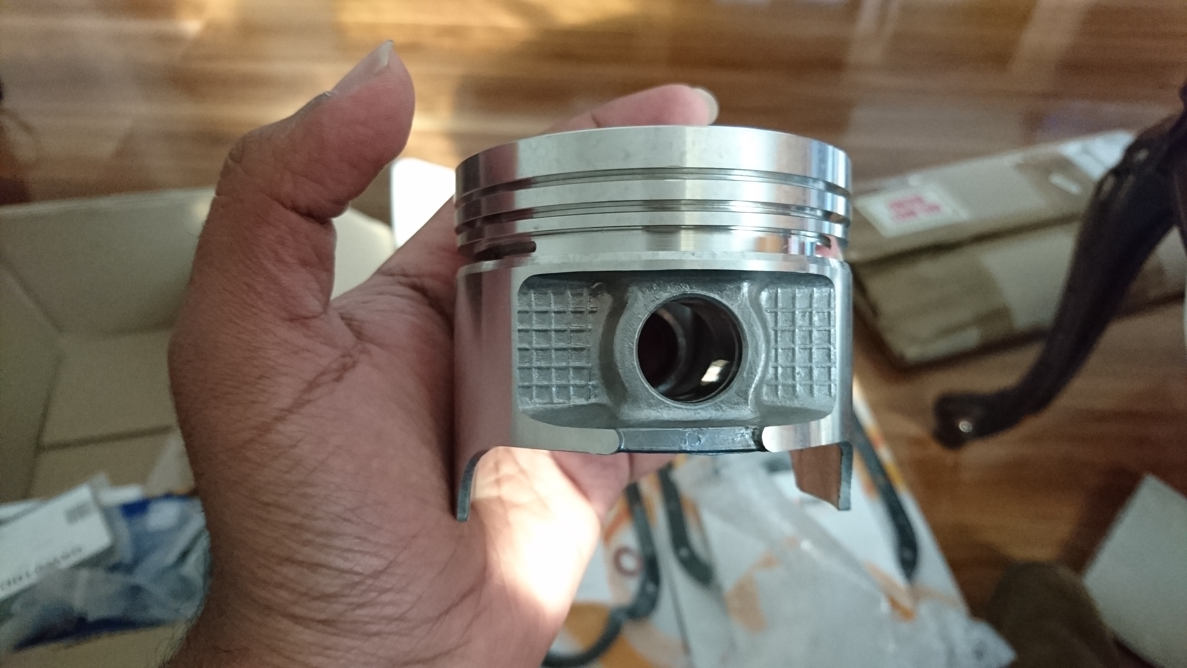

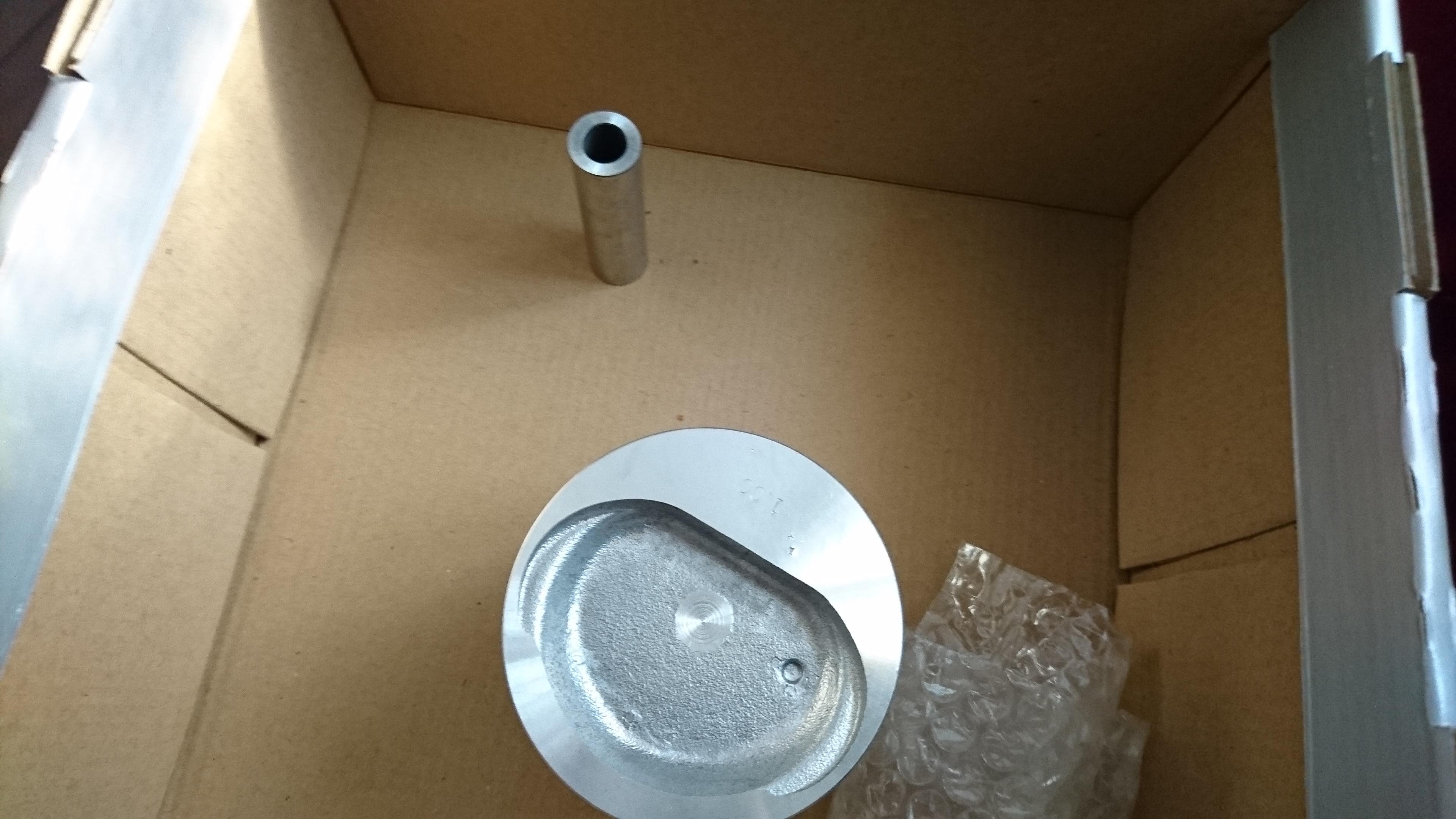

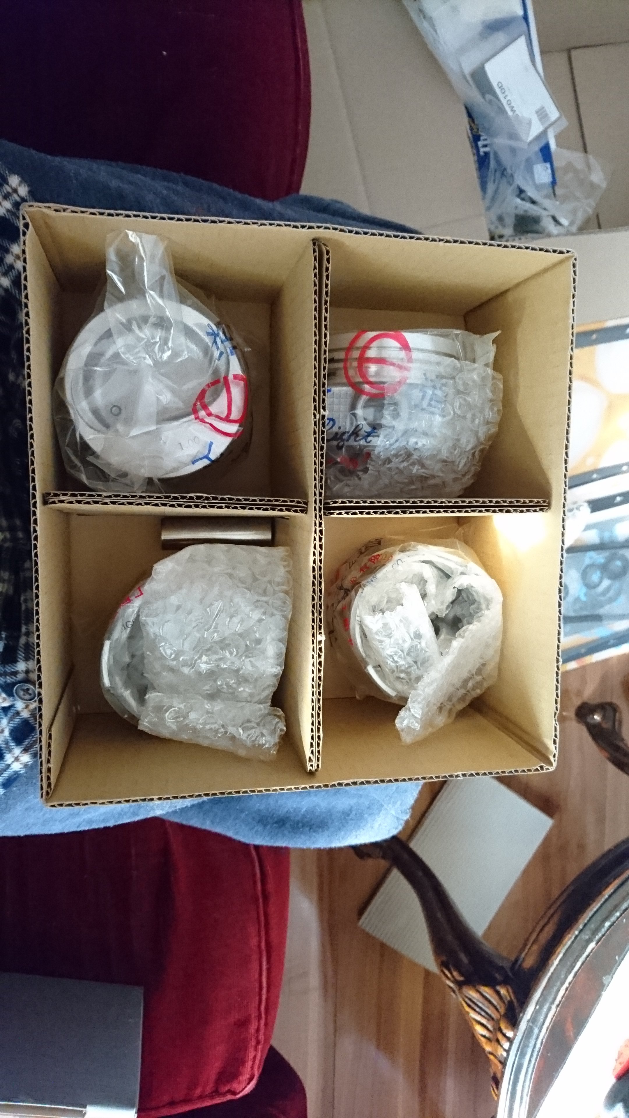

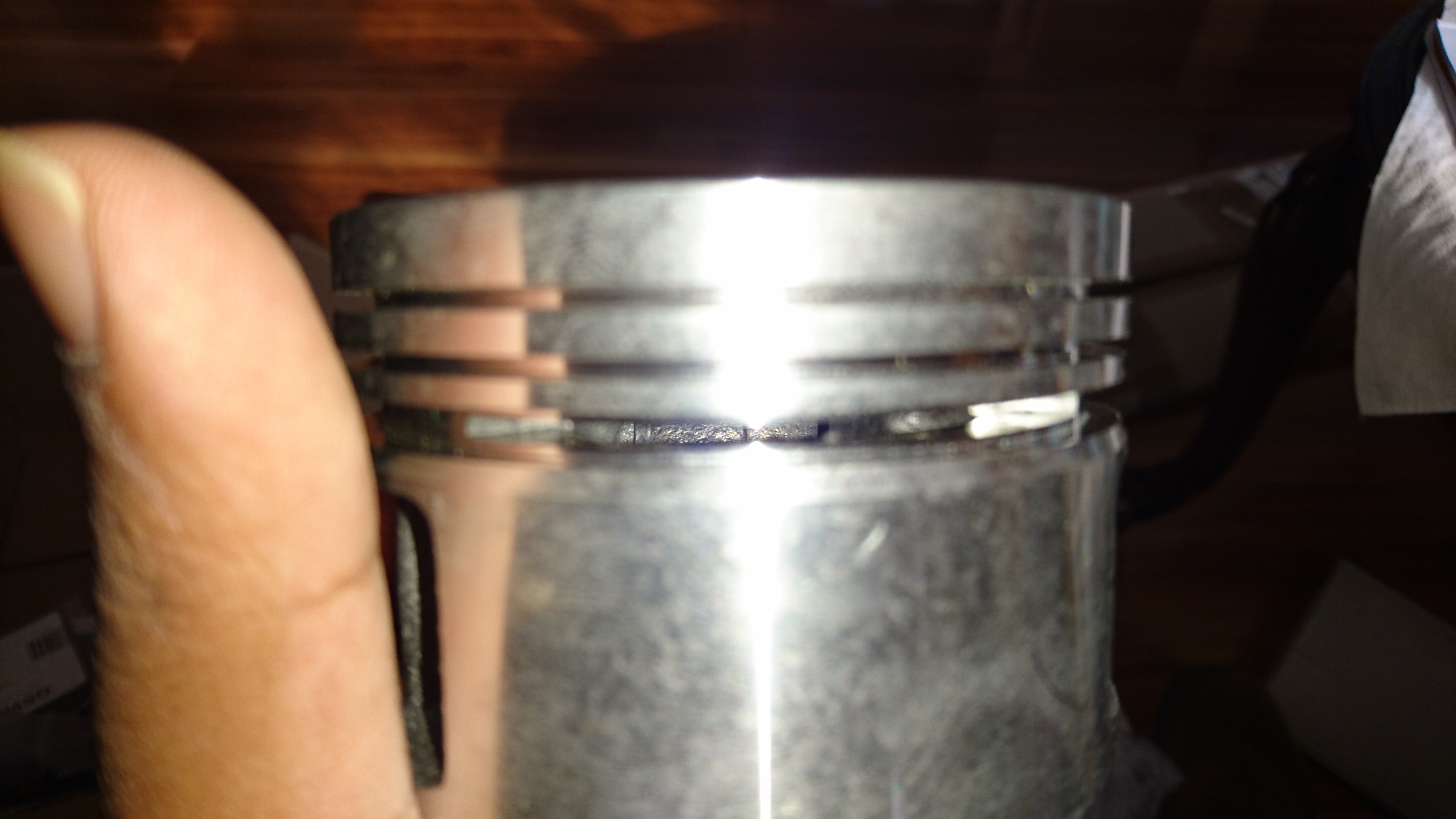

I haven't heard of others using Hypatec pistons, so maybe a first to see if they work well...In my opinion they should be fine, also found out that they are apparently hypereutectic
