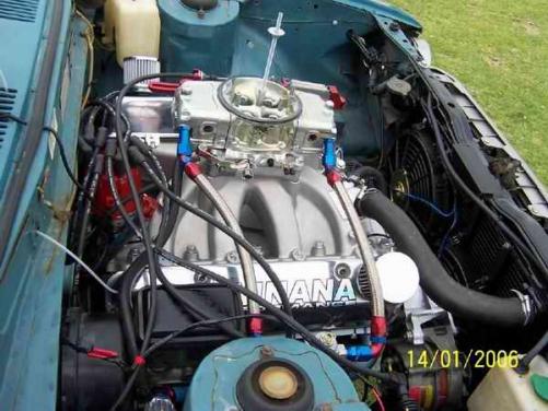

hey guys,started a new project..ke 20 with gen 3 v8.. just in middle of fitting engine and havnt thought of what gearbox to use.has to be strong!!!! also after two turbos,rated bout 200+hp each...any help would be great!

That must be a bloody tight fit, they barely fit in commos. How the f@$k are you going to fit the turbos? :lock_folder:
why not use a commo 5 speed?
honestly id love to see pictures of that fitting. not saying its not possible, just alot of work involved. good luck :lock_folder: post some pics when you can.

hey guys...ive decided to use either 2 speed powerglide or turbo 350....and its for the drags,but I'm thinking street car looking as much as possible...going to keep it untubbed,just going to fit biggest tyre possible!!! and as for turbos,ive found a guy that going to suppy them,hes let me borrow two already to make manifolds.........and the turbos will be mounted above the heads and above bonnet line....as for paint,its going to be matt black...get some pics to you all once ive mounted turbos....oh and thanks for the encouragement guys,I'm commited to do this project to prove a few people anything is possible...
What kind of turbos??? Rememeber youve essentially got a pair of almost 3 litre 4cyls. The SR20 (2L 4cyl) runs up to a 320hp turbo in standard form. R34 GTRs (2.6L 6cyl) Run twin ~300hp turbos off 3cyls each. Youve got 4 cyls per turbo and even more volume. You either need 4 cheap turbos and go quads or fork out for some diecently sized turbos.
