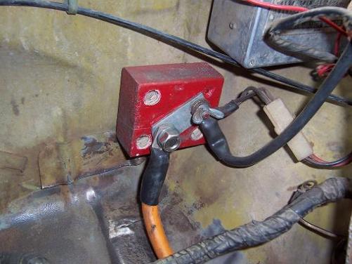

Thanks for the picture, i ended up buying a junction box.
Cheers, Rob

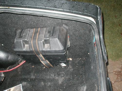

Buy a sealed battey and then you don't need to worry about it, Dunno what will happen if you don't vent it.
Hi,
If the battery isn't vented A it makes gas and well will make pressure and possibly blow the sealed container it is in up.
Also Battery's make Hydrogen :) This is highly flammable so if you want to turn your car intot eh hindenburg put a non sealed battery in a box it will build up one small spark and good by corolla.
So it is purely to vent the flammable gases coming off it.
Cameron
