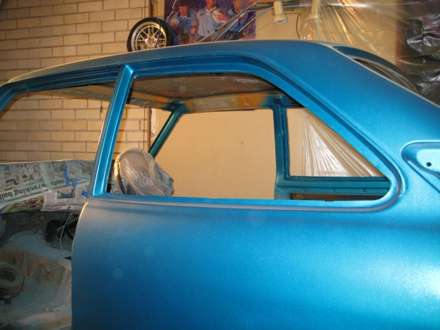

After i sprayed the car in high fill i sanded it back and filled any low spots.
Then i sprayed the colour:

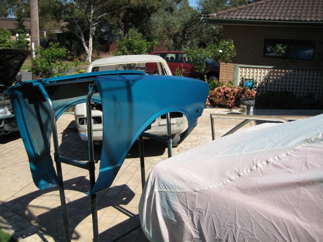

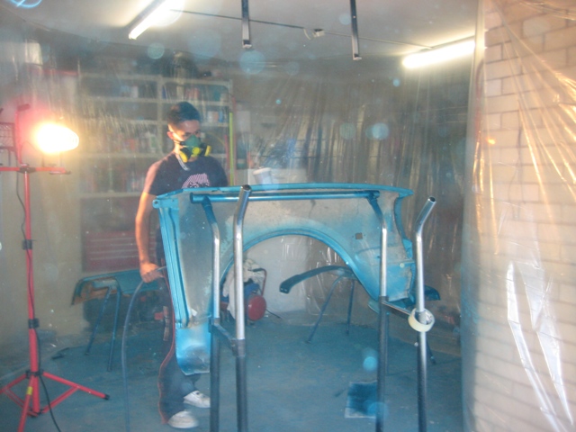

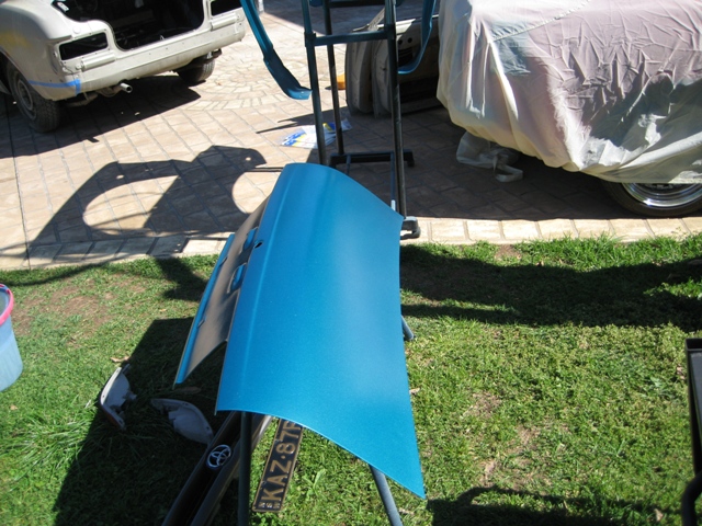

First i sprayed the panels:
This is what they came up like after 3 coats of colour and 7 coats of clear:

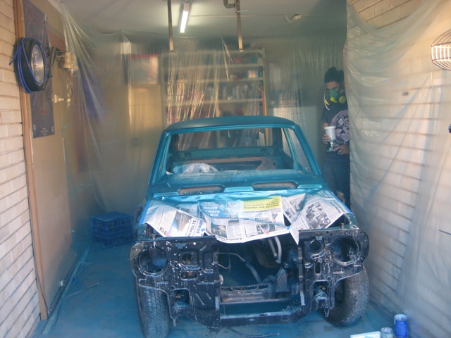

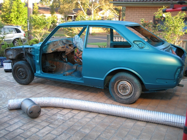

Then it was time to spray the body:
This is how it came up with no clear on it yet:
And with the clear:
After this i let the car sit for a while and decided that i wasn't really happy with how the clear came up....got too much overspray in the paint, so i rubbed the clear coat smooth and applied another 5 coats of clear and it came up heaps better.
More pics to come!!
