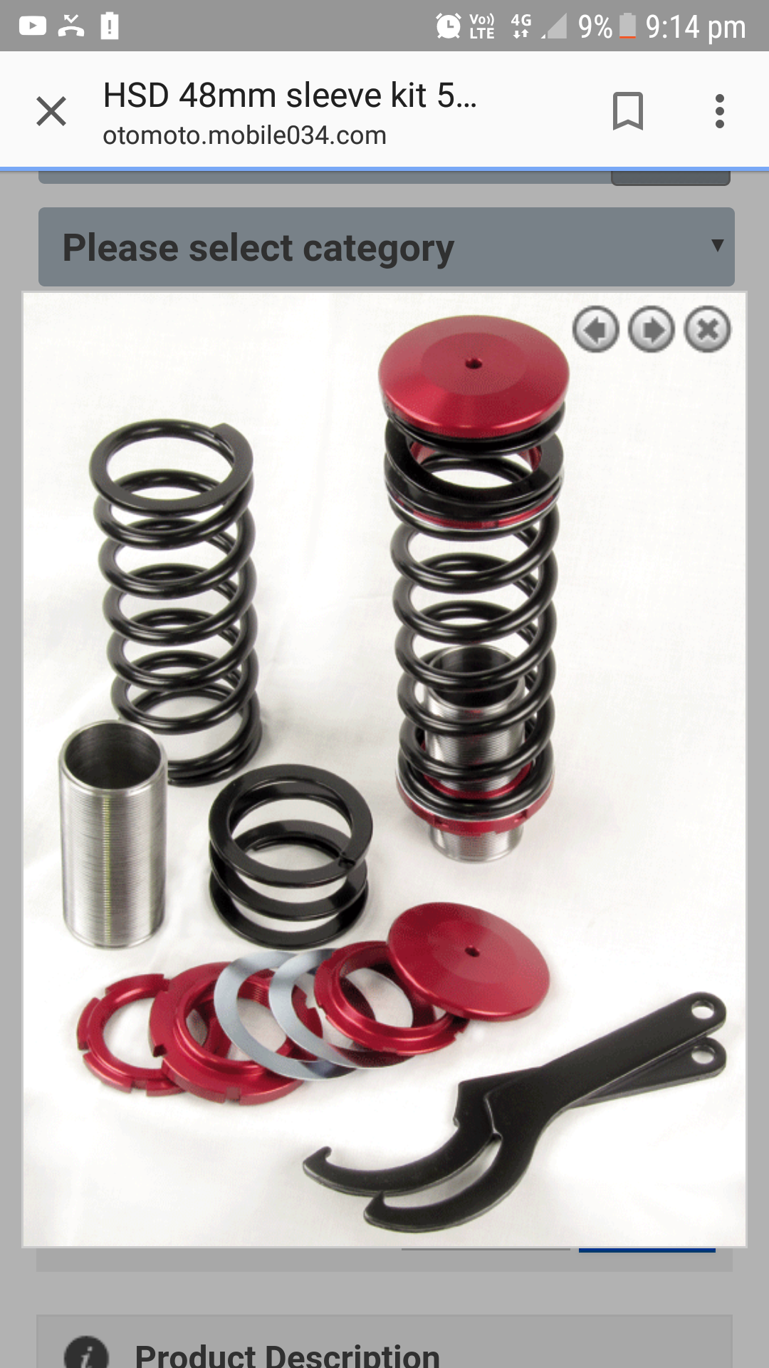

So these are on the way. HSD sleeve and spring kit with 4kg springs.  Otomoto are such a pleasure to deal with and so far I'd highly recommend them.Screenshot_20171212-211408.thumb.png.38bb7bb39b82f8bdb046f1a41f5b4ae1.png

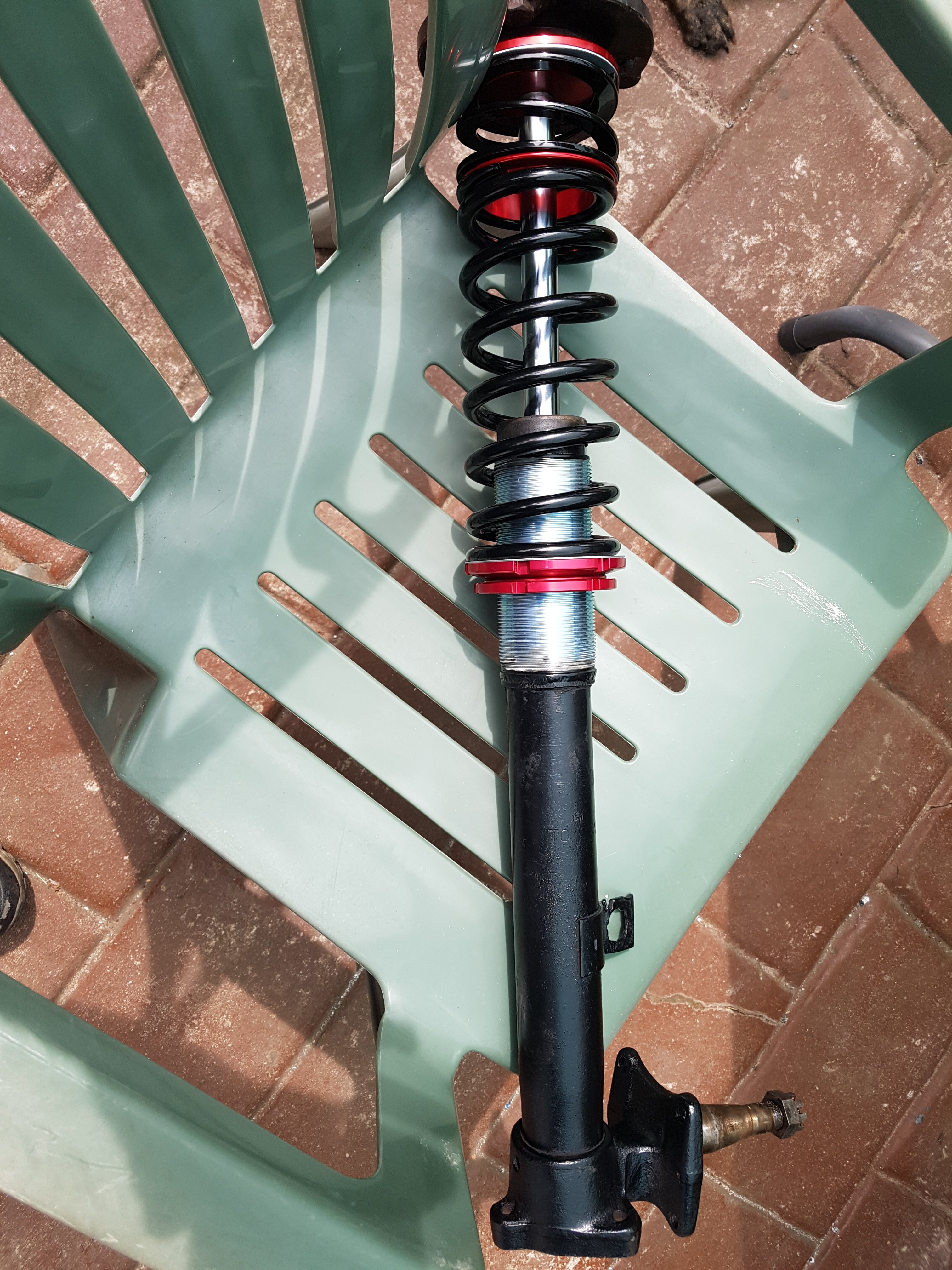

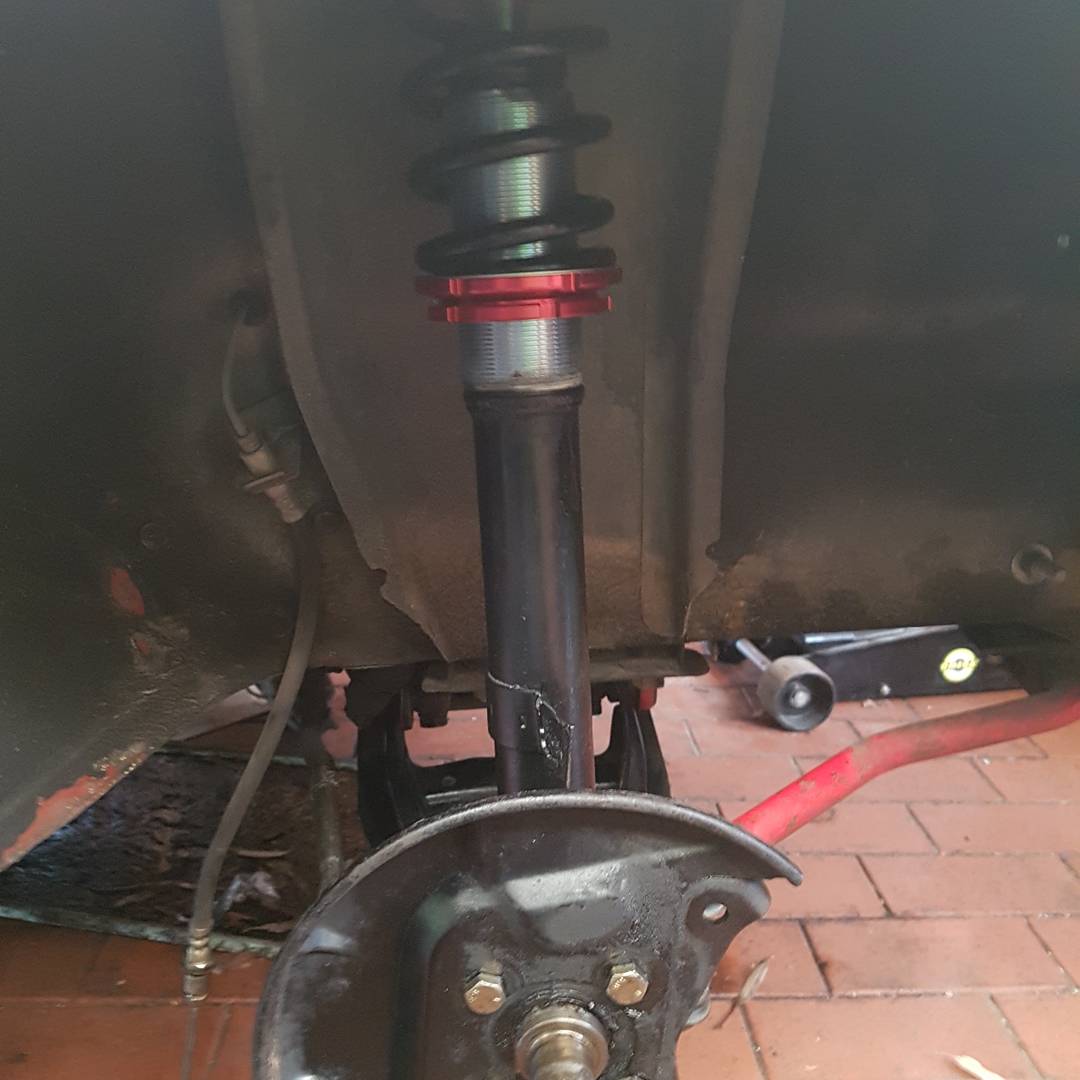

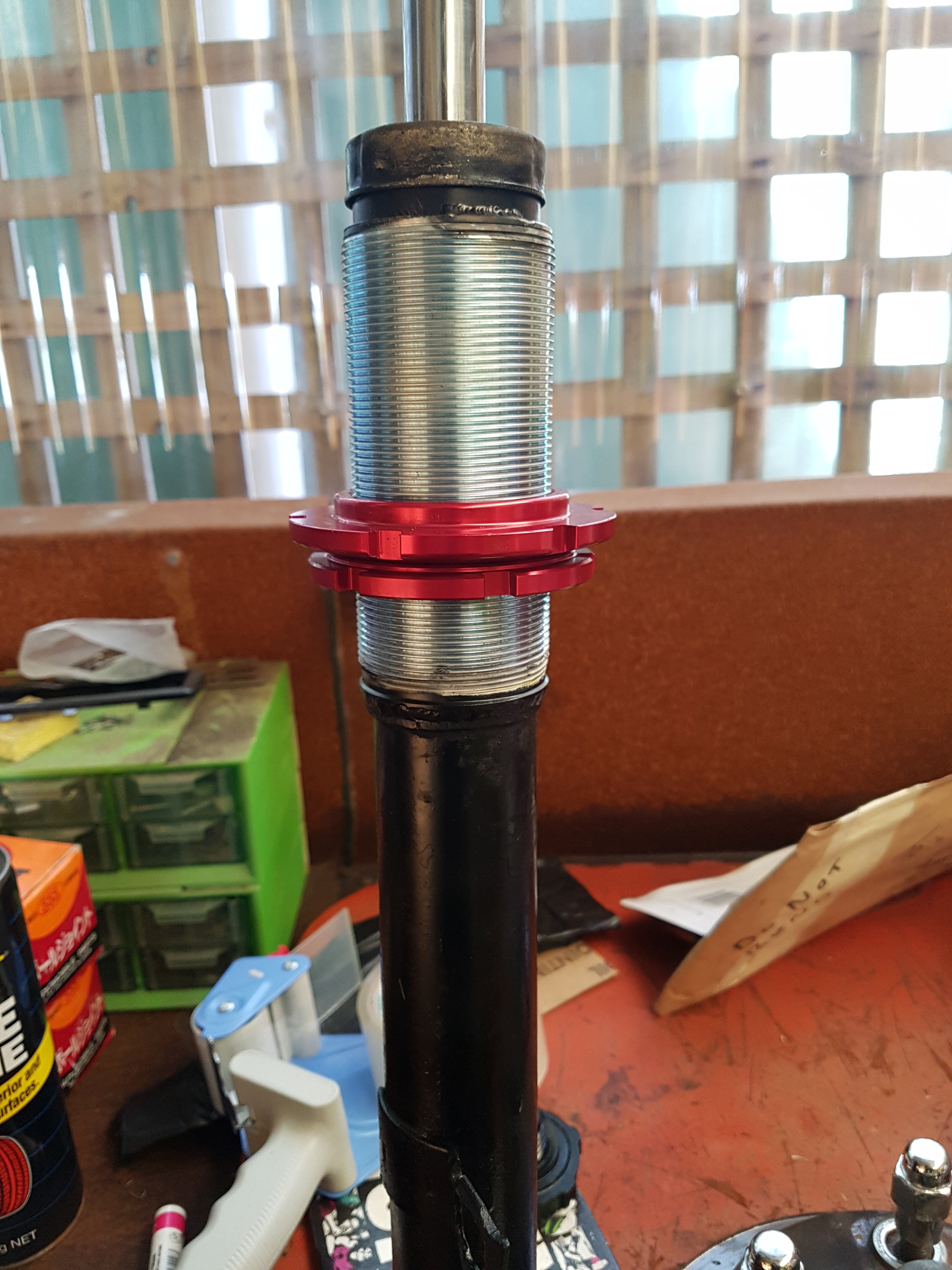

20180111_155023.thumb.jpg.7f4a076c495c1eac4b1b6744d9e9d7fe.jpg20180111_124913.thumb.jpg.e0341ef1a65d7642b9dbb634c005c84f.jpg
I've got some custom ones basically the same, however. I haven't got the brake line clamp thing on the strut, how well does it sit down that low? because my thread for the coils goes quite a way down
If you look at the earlier photos on this page(mainly the one on the green chair) you'll see it runs two coils with one being a feather weight one that sits in bind at ride height but extends with droop. Helps keep it all captive.
Oh and with those brake tabs I will need to cut them off the front and I'll re-weld it on the rear of the strut. It is just me being pedantic is all, the brake lines will need to be remade otherwise.
And the sway bar mount hits way earier now, only got about a turn and a half of lock at most.
