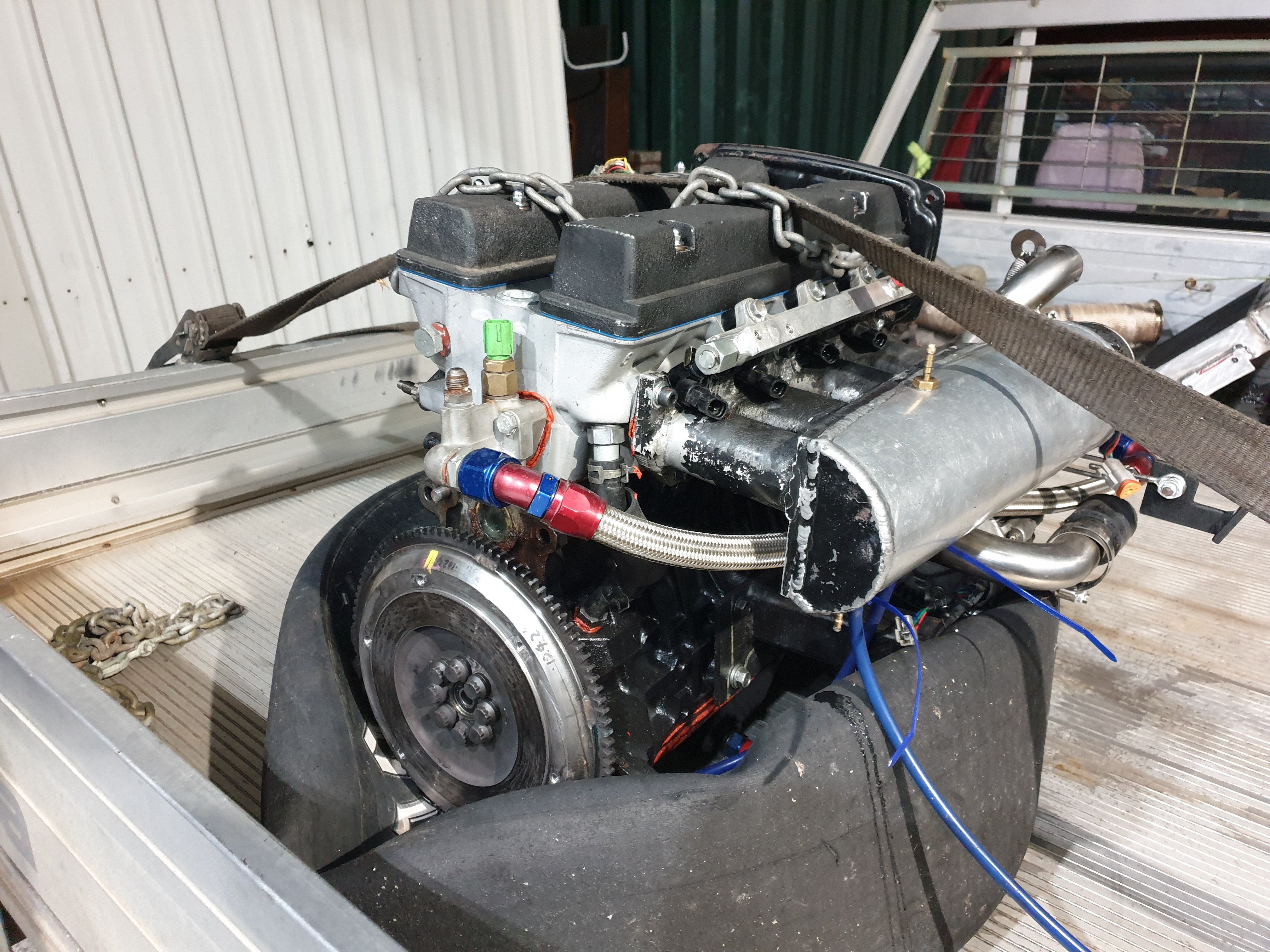

You're not wrong. Won't be grabbing it till mid March, but I'm 80% sure the deal is done so. IT'S A 4agte! Setup made 360rwkw last time it was dyno'd.
Engine specs are:
Semi-grout filled 7rib block.
Mrp billet crank.
Spool conrods.
Sps 9.4:1 std bore custom pistons.
Mrp 7/16 head studs.
312° Kent camshafts.
Ported bigport head.
Garrett gtx30.
Microtech Ltx10(won't be staying long)
Got some W5x bits for it already as I'm not getting a gearbox for it, but seriously considering a built Ford C series 3 speed. Probably won't have it in and running till late this year but really all I need fuel system, radiator and intecooler(the old ones which I'm getting are from a ke70) and a clutch and I'm golden.

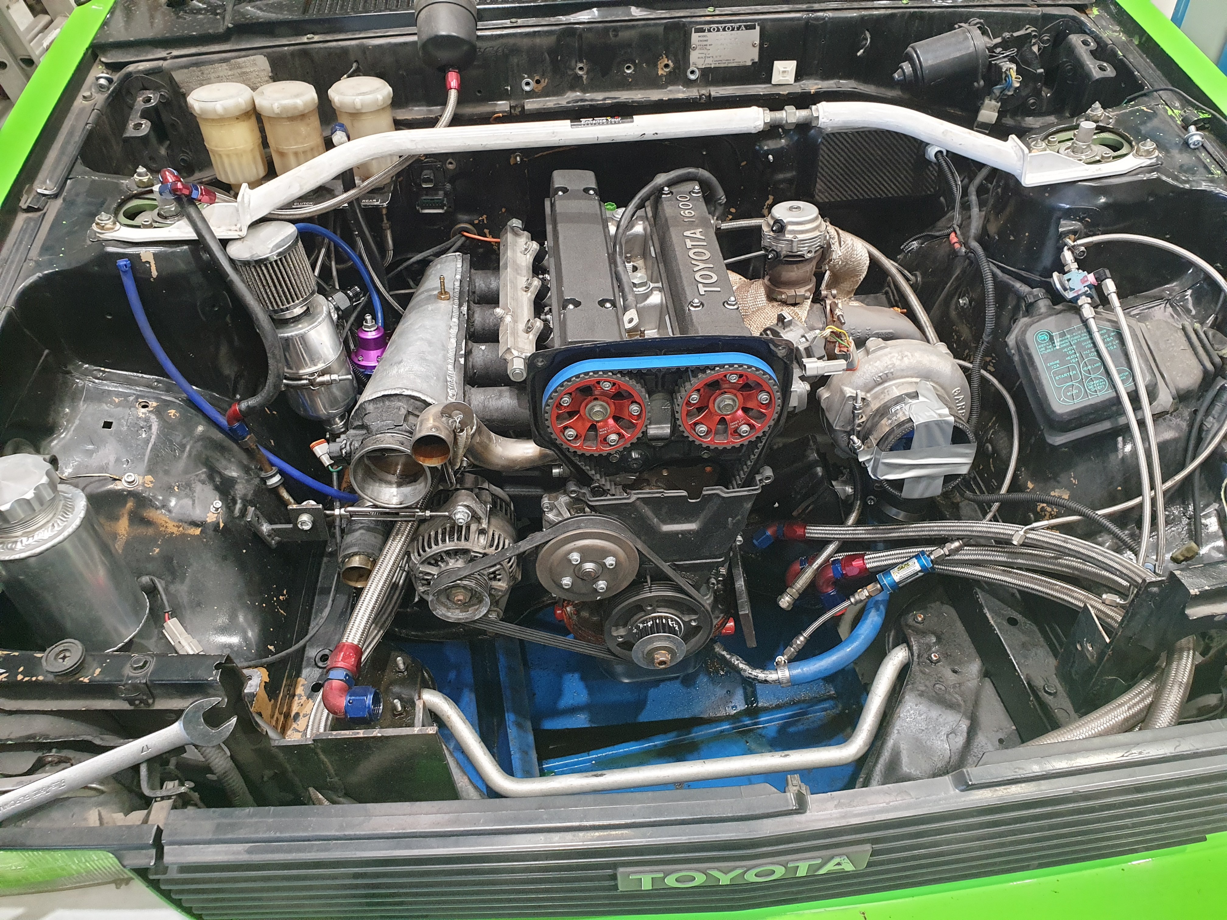

I've got the 5k In pieces atm, will be freshening it up, with a B/P head, tomei cromo pushrods etc. and offering it for sale with a k50 and new HD clutch soon. You interested?
20200316_182520.thumb.jpg.b29209dbdb670b94a5b95d50a00ae0af.jpg20200316_205751.thumb.jpg.0028a4b4745f5f363feffa976775742f.jpg
keen eyes will notice no oil filler cap, it was a dry sump engine and I'll be changing it back to a wet sump.

Awesome, changing to wet sump for simplicity?
My motor is pretty solid (touchwood), but I will be upgrading gearbox at some point.
