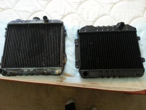

  6. The reco'd radiator that some of you may have seem on ebay for some time. its not perfect, but a hell of alot better than my current one. I will get a custom alloy one made up in time but for now this is OK. The last photo is the ACCU electronic distributor conversion to a standard 3k ke20 late model point dizzy. it fits perfectly where the points and condenser used to live. The wiring grommet also fitted the external condenser hole perfectly. Only problem with this conversion? rotor wont fit on top! Low king springs (30mm) for front arrived also, in the next few months I will be taking the back end off, rebuilding then the front ends off, rebuilding and finally the engine in and wiring etc.

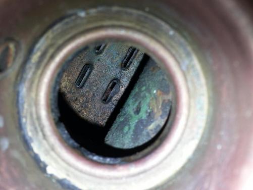

  7. I went with the accu version. And from what I can tell is uses a magnet to deliver the pulse, much like a hall effect sensor. My only issue is that the rotor no longer fits on over this sensor, may have to chop the bottom off it Edit: Its probably easier to describe with a photo!

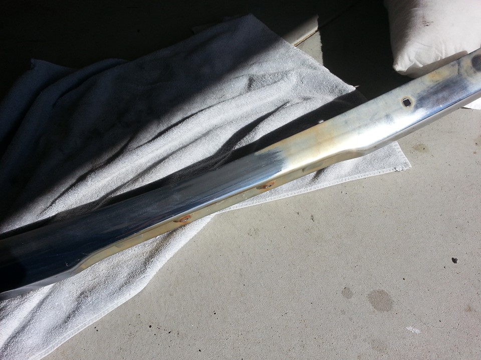

  20. Ok, so I've had basically no money at all until now, but I've done a couple of small things. - Swapped the hydo clutch setup out for a standard ke20 cable clutch pedal box - Swapped the mph gauge out for a kph one - Done a heap of research and organising, to work out exactly what I need for rego and beyond. - Cleaned up a front bar I purchased for $20 off a farm wreck, photos below of before and after thank you autosol! Basically its getting its brake system completely replaced, except the rigid lines, New shocks all round, front springs, new bushes and rubbers all round, new bearings, seals and oil in diff and gearbox, new mounts, wheel bearings and ball joints new uni's in the tailshaft, extractors and 1 3/4" exhaust new carpet, Hyundai excel seats with some seat covers and a basic running 3k/4k. After this I will run that engine untill the 4k on the stand is fully rebuilt, and then a simple swap over. I will also be doing a KE70 front and ke55 rear brake upgrade, and some new 14x6 wheels and tyres to suit. The interior will be getting new front windscreen seal and new dash (have to take the windscreen out to fit), centre console and stereo fitment, and new boot lining. Oh and probably a t50 short shifter kit fitted. I will also be cleaning up the rear bumper, and repainting the rear chrome vents, and add the original badge back onto the boot.
