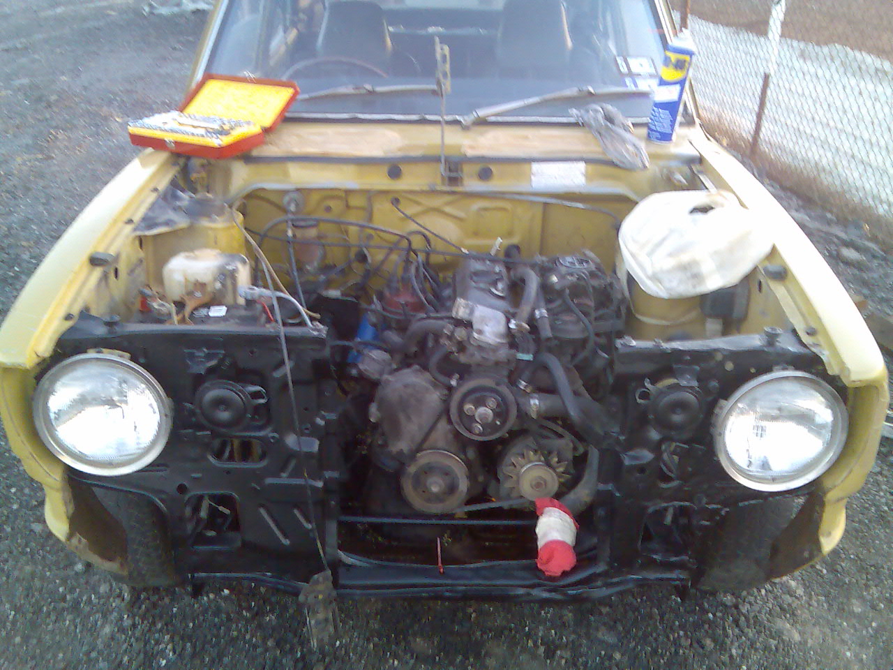

  1. Hey guys Ok well spent most of the morning swapping the manifold and carbs over. Chucked the 4k carb/manifold off and replaced it with the old 3K carb/manifold. Now the exhaust bolts up and no emission crap anywhere so I'm loving it. Should of really done most of this stuff before we put the engine in but it didn’t occur to me (first time). I went down to u-pull-it and got the hoses that I need and hooked them all up and now no water leaks!!!! Chucked on a ramflo air filter and small air filter breather pod and it looks shmick. Well the only thing I need engine wise is a throttle and chock bracket that fits onto the top of the rocker cover. I had one but I lost it when I took the old engine out!! So will have to get that off a KE70 at u-pull-it (forgot to get it today) Have sourced some callipers so hopefully be able to get it onto the road ASAP!!! Pics tomorrow guys :hmm: Cheers Tally

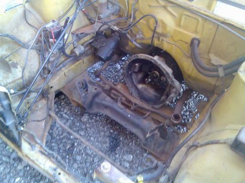

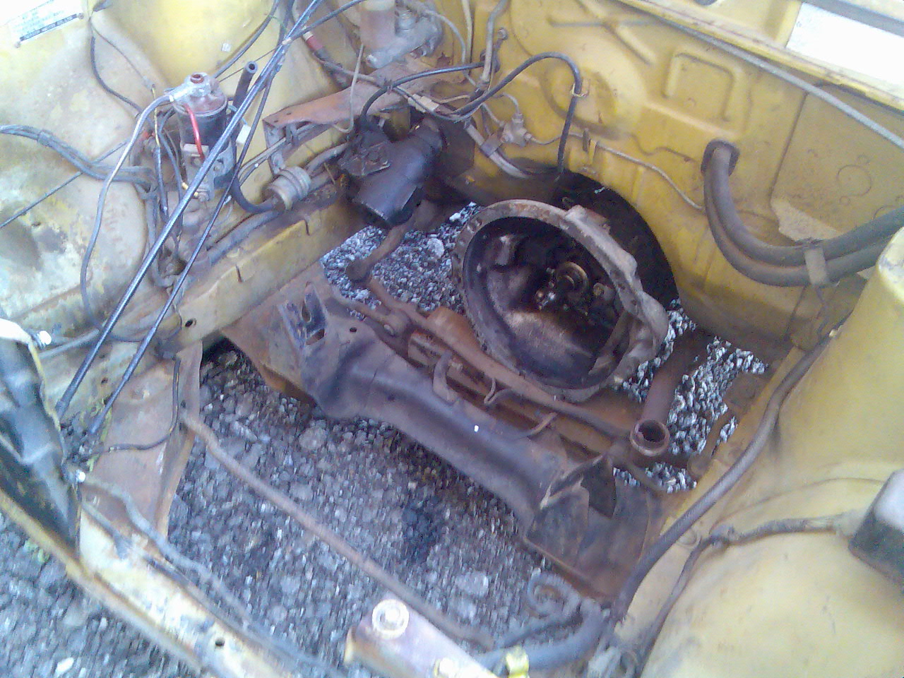

  6. and the engines in!!!! was a bitch to get in, but we eventually got in lined up with the gearbox and it slid in well. didnt have a engine crane so just used the bobcat, bit overkill but its all good. also as its a KE70 engine there is all these hoses around the carby and this big hose that runs around the head which I took off already. What can and can I not take off as I think half of it is really un-necessary? Hopefully get it running soon, just need to figure out how I'm going to connect the accelorator cable to the carby, buy a thermo fan and do something about an exahust.... arghhh... when you think your just about finished you still have stuff to do... Cheers Tally

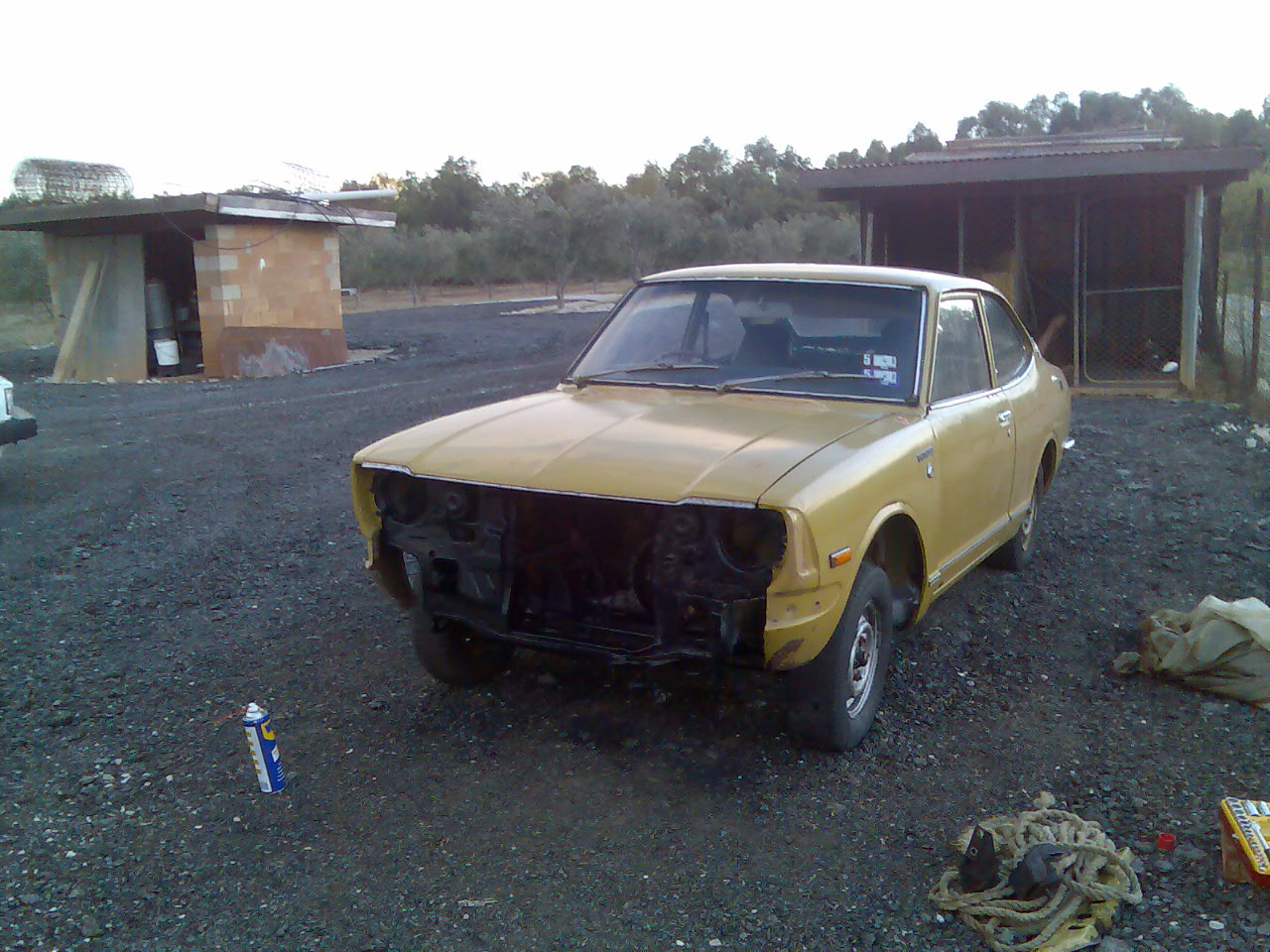

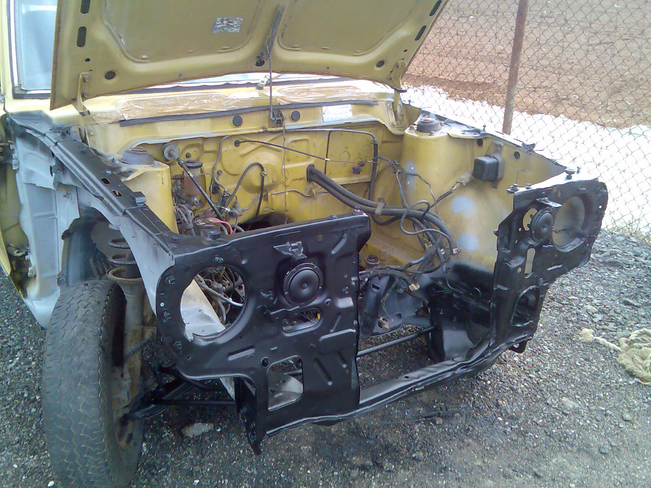

  9. Front panel is painted :) Finished getting all the rust off. Cleaned front panel and steering componets from all grease and dirt, primed it and painted it matt black. Didnt paint the entire engine bay as I just wanna get it on the road asap :) Started putting the panels back on aswell. Looks mean az!!! Looks pretty good now. Engine should be in sometime this week hopefully :) can't wait, gonna be fun az.

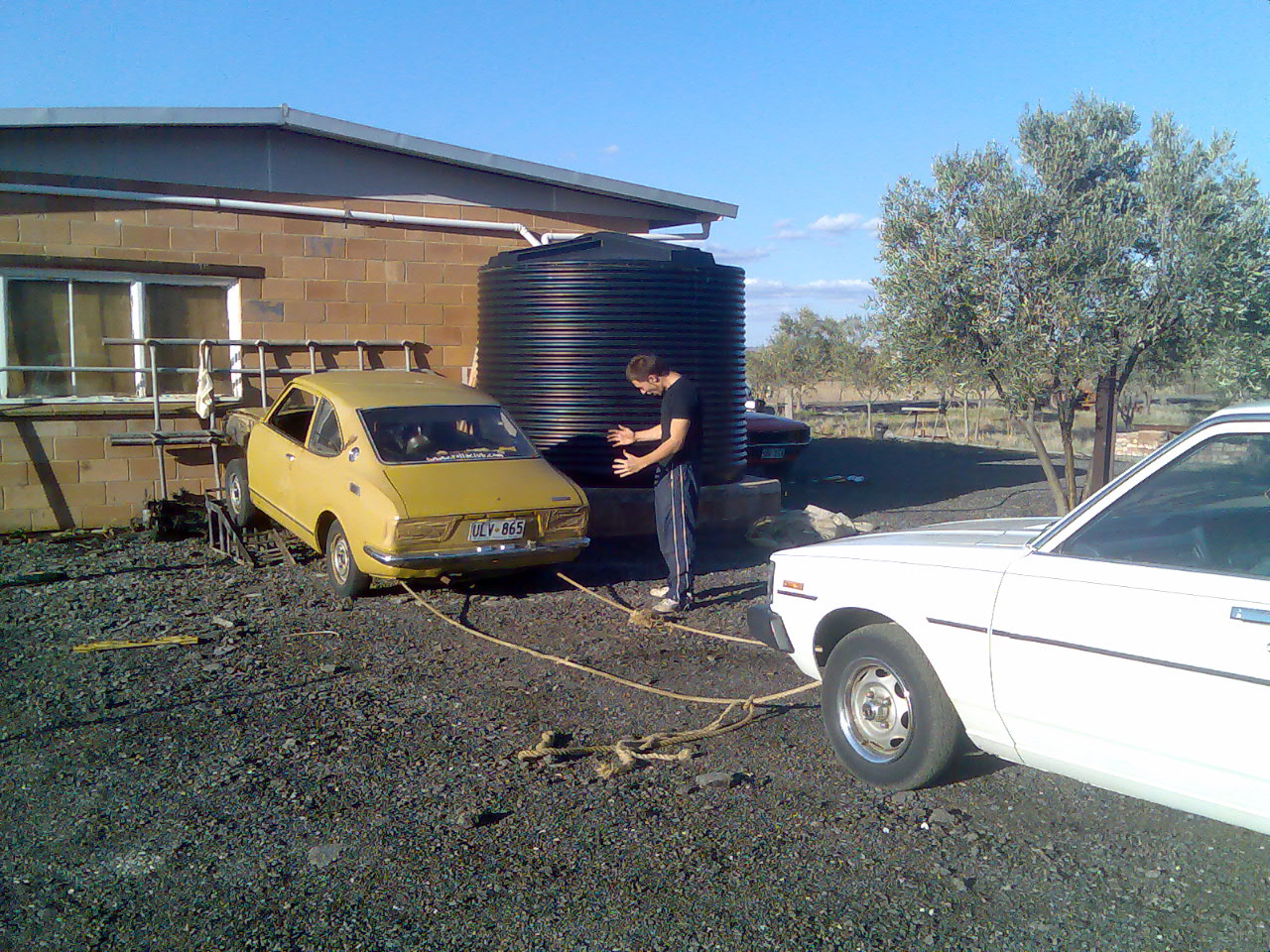

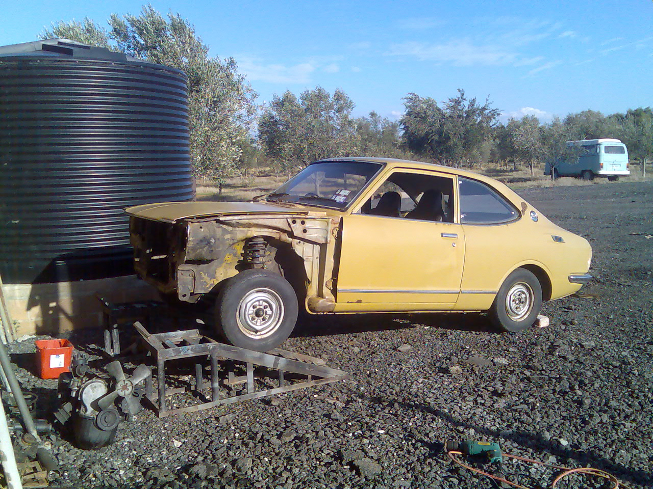

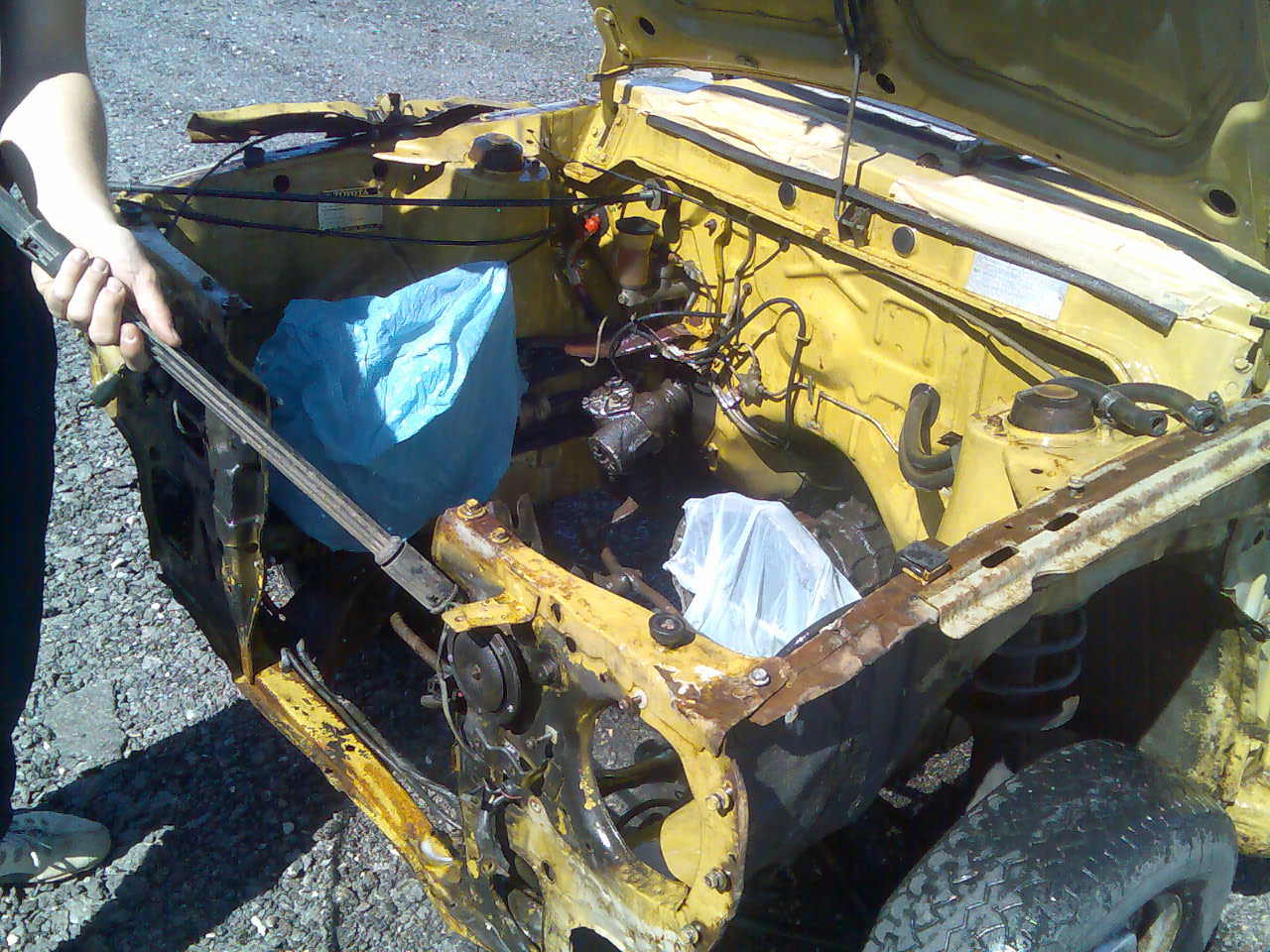

  16. Fender Mirrors = tick!, Rims = tick! Got em already, just need to wait till the engine bay is all done and then ill put all my good stuff on when its back together ;) Well got down and dirty today. Got engine out, high pressure cleaned the engine bay, waited for it to dry and spent the rest of the day using a wire brush and an electric wire drill to scrape off all the surface rust that had accumulated on all the steering components. Still need another full days work to get most off. Had to use the KE70 to pull the car back to pressure clean it. We pushed it onto the car ramps with ease but the brakes seized up again lol so we had to pull it off with the KE70 again... Looks like I might have to look at the brakes next.. :dance: :hmm: God I hate rust....

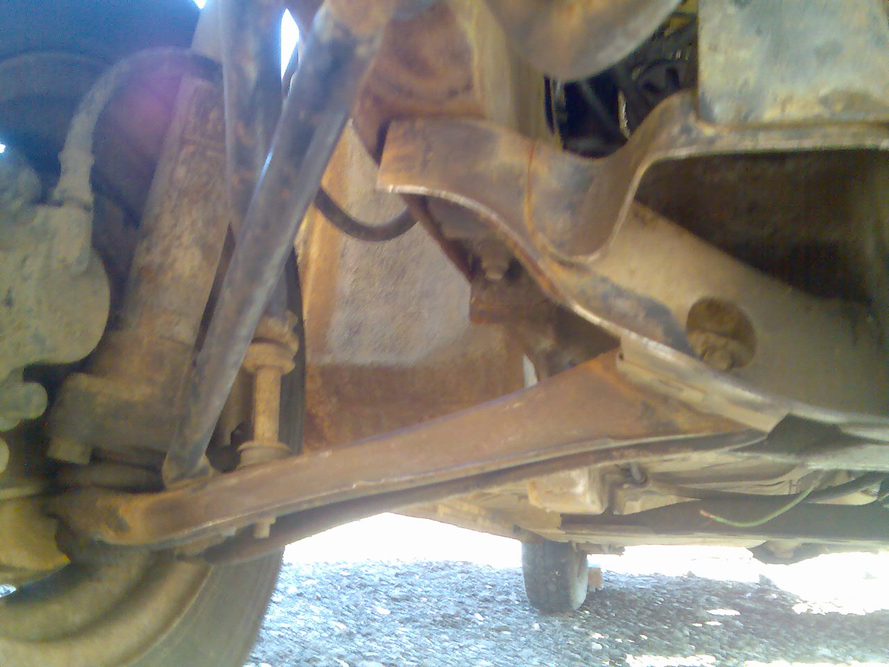

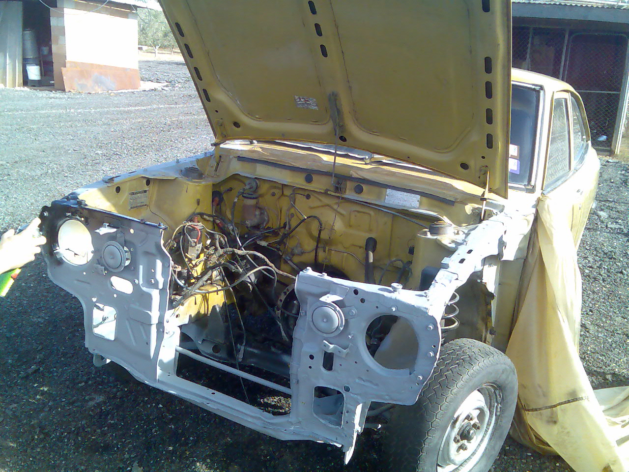

  18. Thanks guys I’m going to see what ill do with the gearbox situation. Might just leave it for the KE70. The KE25 just going to be a Sunday driver you know what I mean. Well anyway, I bought some rust converter, wd40, wax and grease remover and some acrylic primer. What I want to do is clean up the front end a bit. As you can see in the photo below it has a fair bit of surface rust on all the components. What I haven’t got my head around is if I have the right primer. The guy at SuperCheap said I should use acrylic primer as I will be painting over acrylic. But if I rust convert most of the area, wont it just be bare-metal underneath. Would I then need to etch primer it as etch primer is for bare-metal surfaces? Also can I de-grease the steering box or is it meant to be greasy? Also where can I get new bolts for the guards and front apron? I have some spares but a couple of the old ones broke so I have to get the studs out. Cheers Tally
