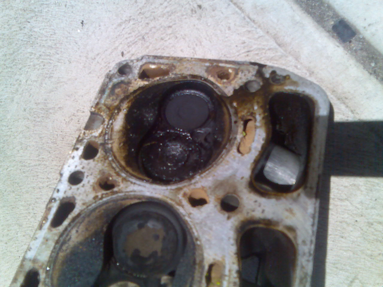

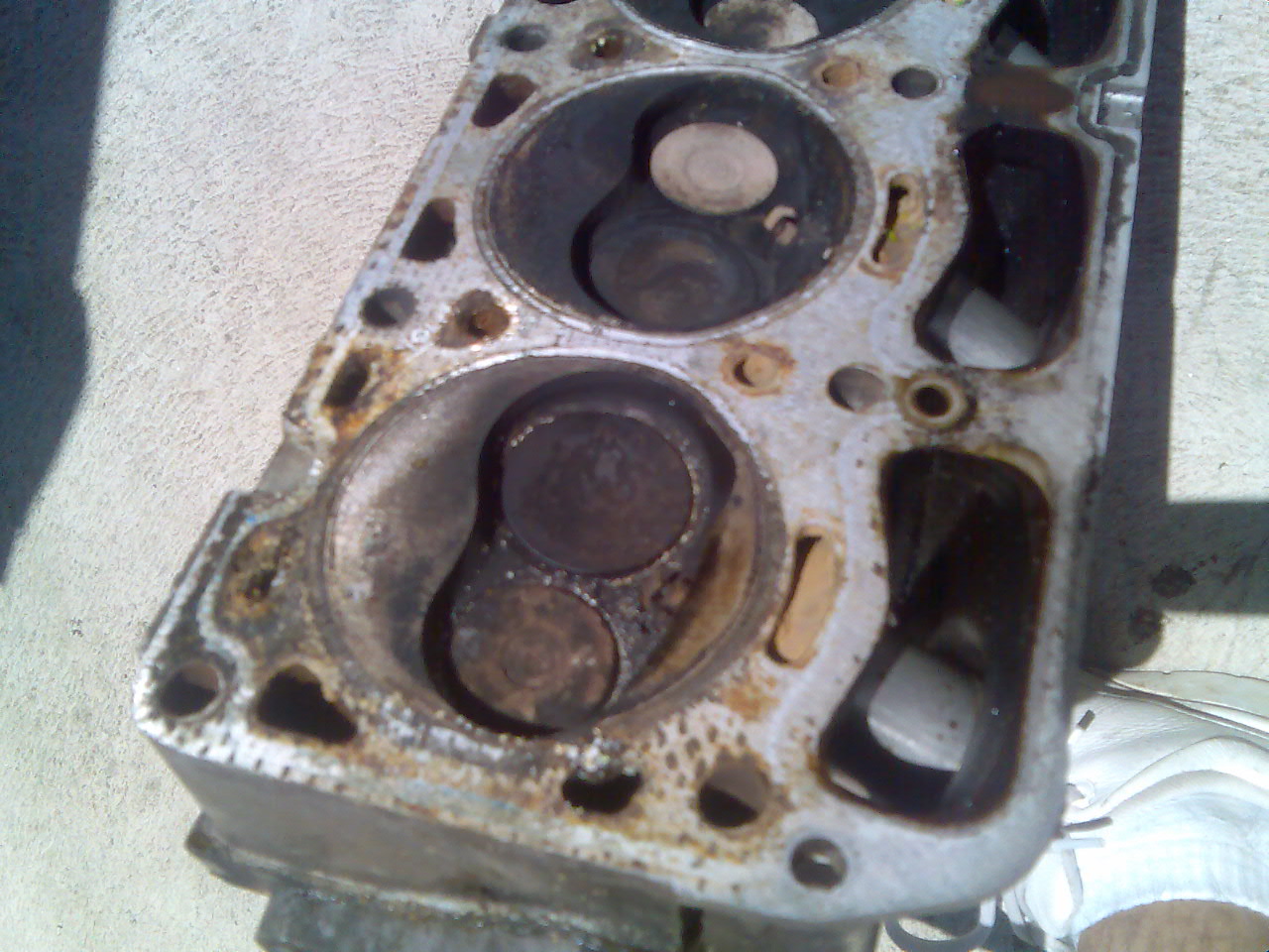

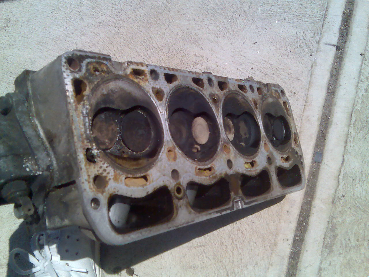

  12. Thanks guys!!! great help.. Here are some pics of the head and block... I am pretty sure the head is cracked so thats why I'm looking for another one at the moment... And the water ways have corodded a fair bit so its not usable. The oil has water in it also... And the last piston has a fair bit of oil on it...

  23. Yea I think it would be more easy and cost effective if I just found a one in good condition. to anyone that may be able to help the pics are in the last post on pg 5. Just a few questions: The block shouldnt have anything wrong with it would it? The heads are alloy and thats why they wear out? Can I use different heads on it? eg 3K-H? And how do I clean the top of the block and the pistons? How do I wipe them? Do I just use a cloth and some cleaning agent or just scrape everything? yea thats about it. EDIT: Here are some pics of my new polished hubbies and my new rims!!! Cheers Tally

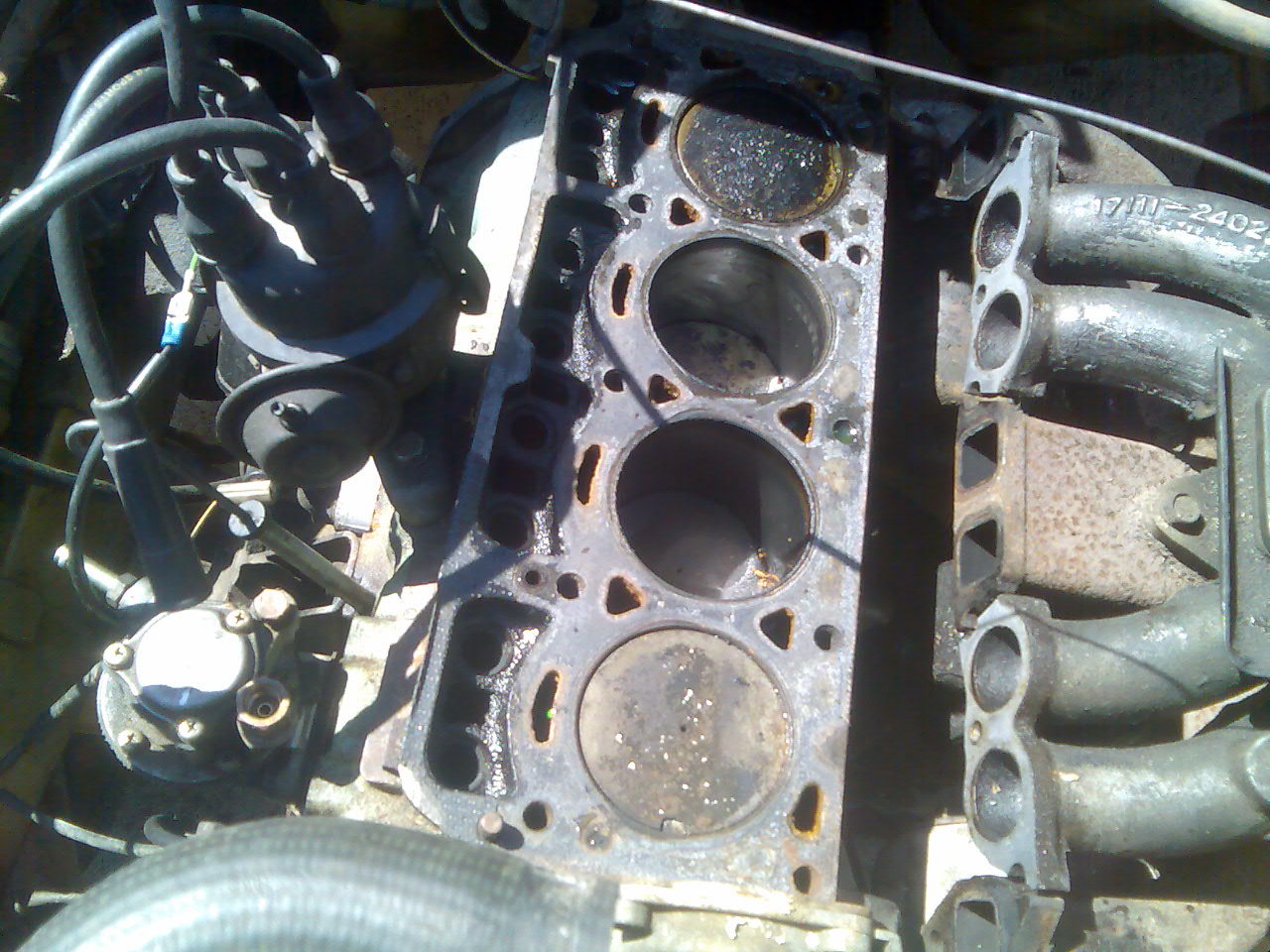

  24. well went and got a new headgasket and manifold gasket during the week. more problems.... Just going to cut a long story short and let the pics do some of the talking. Undid rocker Undid rocker arms and shaft. Took out pushrods. Undid manifold: Took off head: The gasket was rooted but the head was also. In the cylinder closest to the front, the water way had corrded right next to the cylinder. I think that was the casue. Ill let you guys decide as I have no idea if its ok or not. Look bad to me but. Took the head off the old engine but taht one was so far goneeeeeeeeeeeeeeeeeeeeeeeeeeeeeeeeeeee. 17 years of sitting sure does a lot of damage.. sorri don't have a pic but it was all rusted and corroded. and the top of the pistons were covered in ash. So looks like I'm up for a new head. Will put a ad up in the parts trader. Cheers guys :P Tally Looks like I'm up for a new head.
