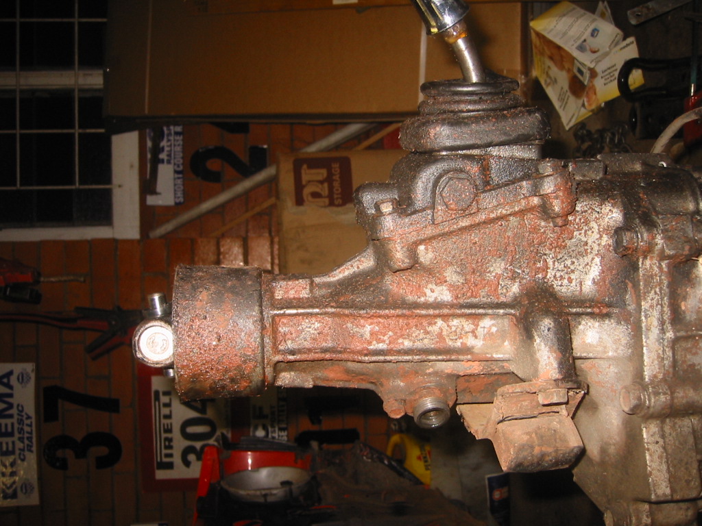

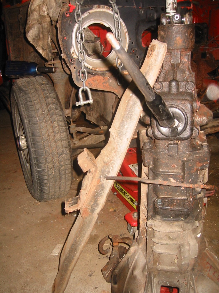

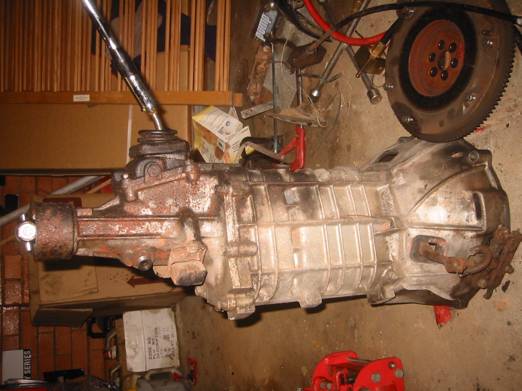

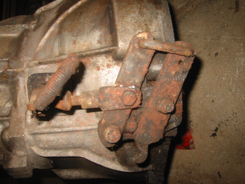

Now, calling all T50 gurus.... can anyone tell me what this box is out of? My guess is early Celica. Shifter is forward enough to fit through a normal 20 shifter hole. I've also included a pic of the clutch mechanism thingy, so that the cable clutch can operate it.
A nice bit of work has been done to the gearbox crossmember to allow the exhaust past, too.

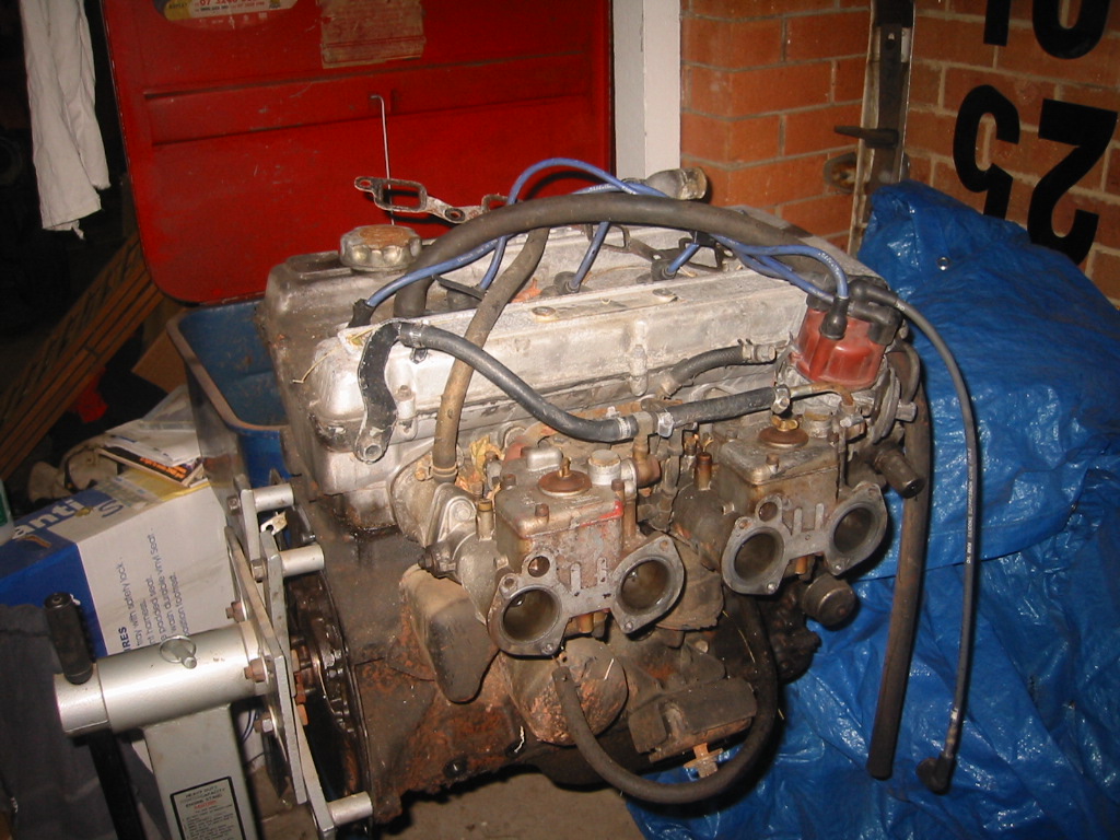

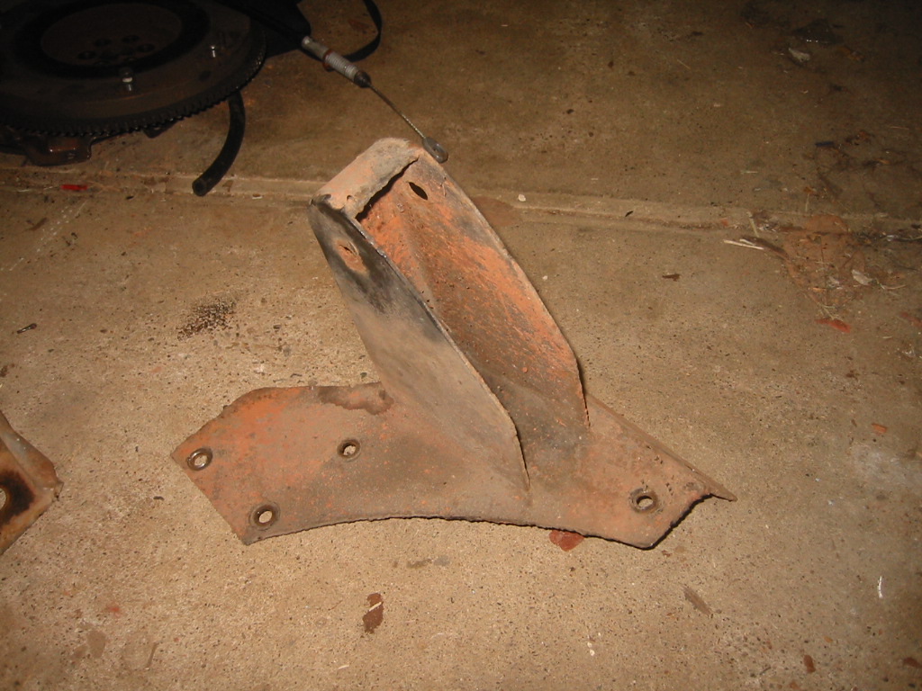

Pics too of the 2tg and the panhard rod mount.

I would've suspected a TA22 Celica owned that box for sure

Iknow for sure its a Ta22 one but i just have never seen one with cable one it it looks really weird i've only see hydrolic ones
but this for sure is an awsome car will be watching this one
