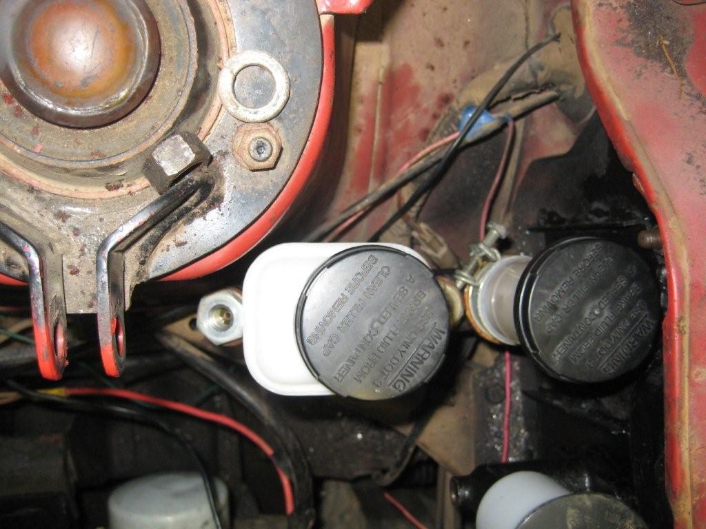

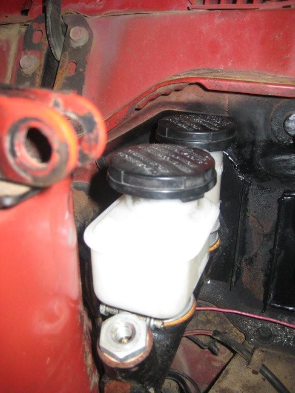

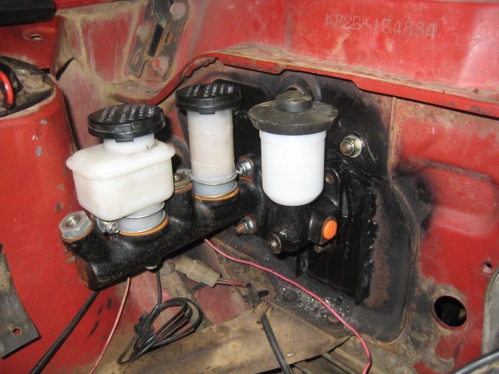

The brake master cylinder has been giving me grief.
I had RWD 323 master in there that looked the goods until I realized it had two front brake ports, with one exitting vertically downwards, right where the intake for throat 4 on the Weber goes. Which was a real pisser, as I'd already pretty much made the new brake lines to suit. Meteor master, which fits normal 20's, is no good as I have moved the master from its original position, outboard towards the strut tower. Meteor MC's port to the right. ie: directly into the strut tower. Scrub that one, too.
Of to Kelly's I went, and procured a GD Gallant 13/16 jobbie. The GD master has a banjo fitting with a double outlet for the front brakes. The guys at BHSS sorted me with a single outlet. Good to go. Piccies below, it's a snug fit, but I have good clearances for everything. :P
