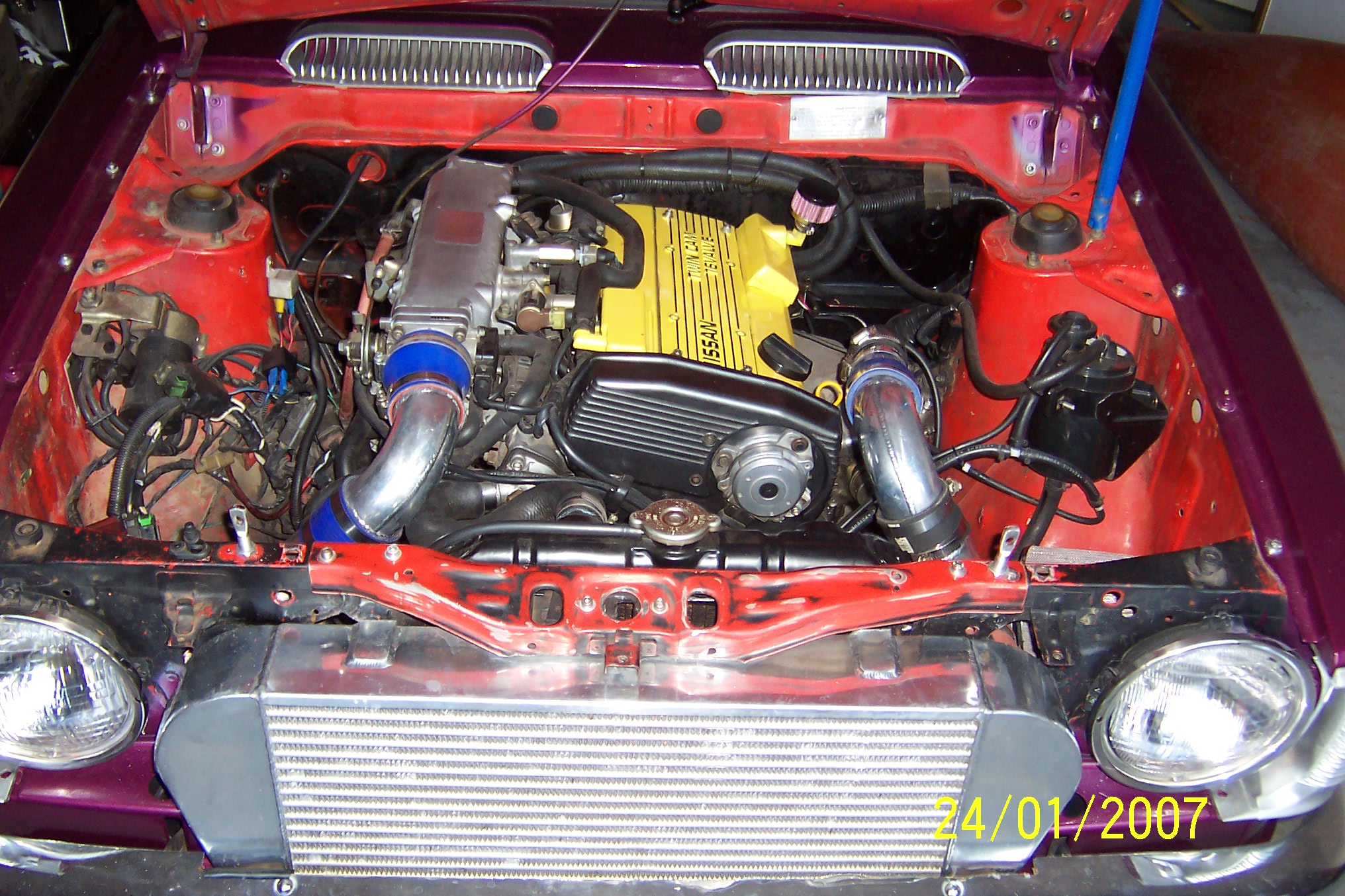

  5. tell me about it mini spools are 100% fun. the car isnt laggy at all, hits boost about 3000rpm the inlet path is fairly direct and not very long compared to say a silvia or skyline and with the bigger cooler piping it makes up for the cooler.

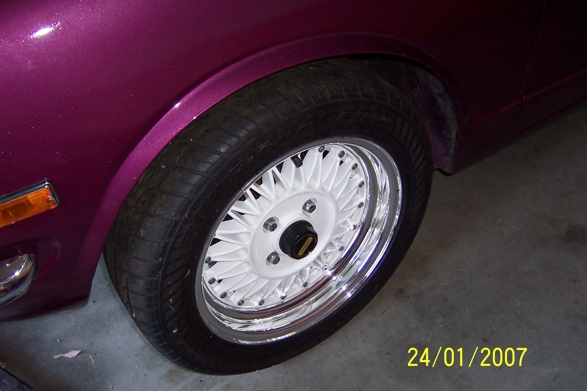

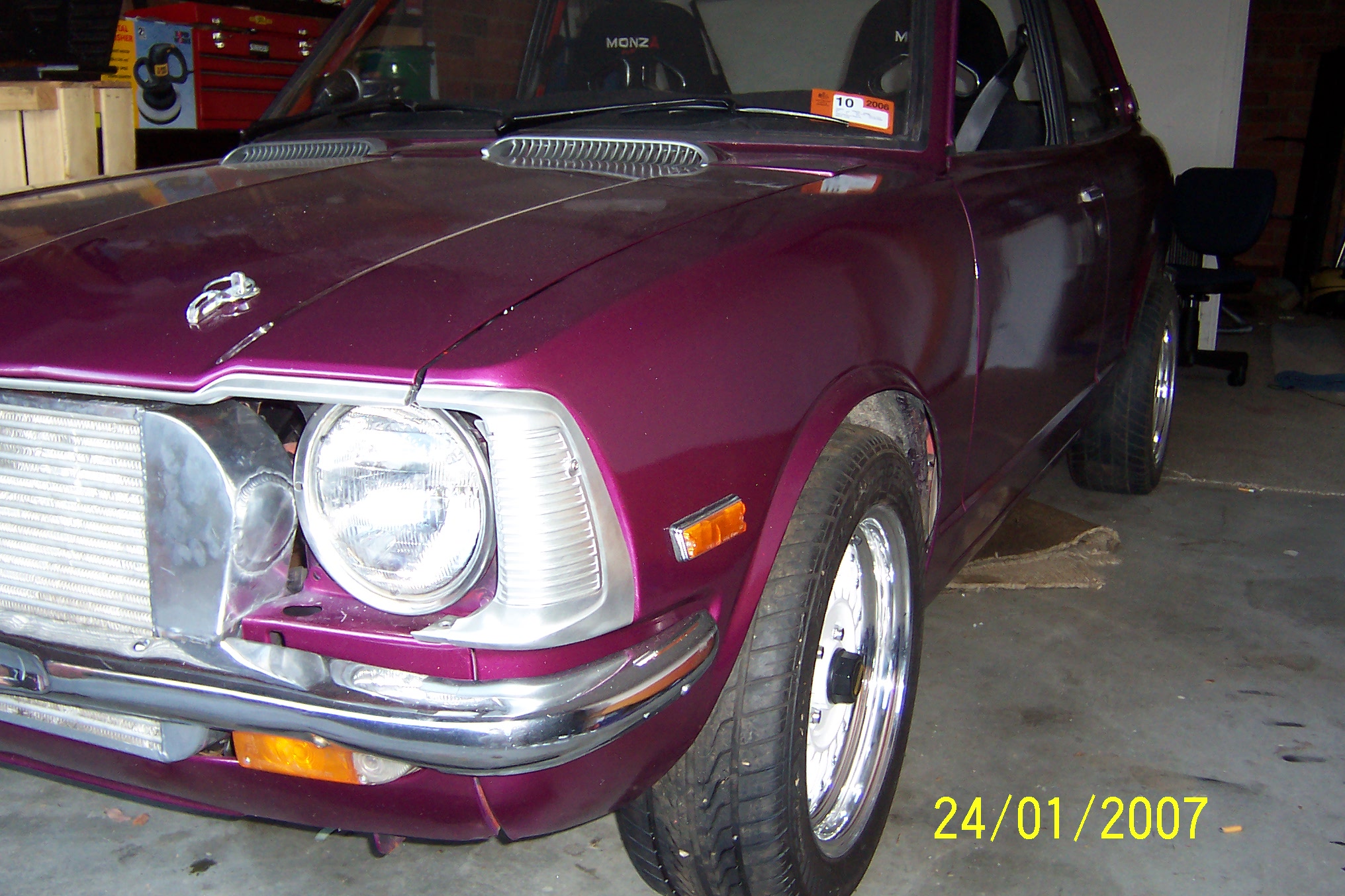

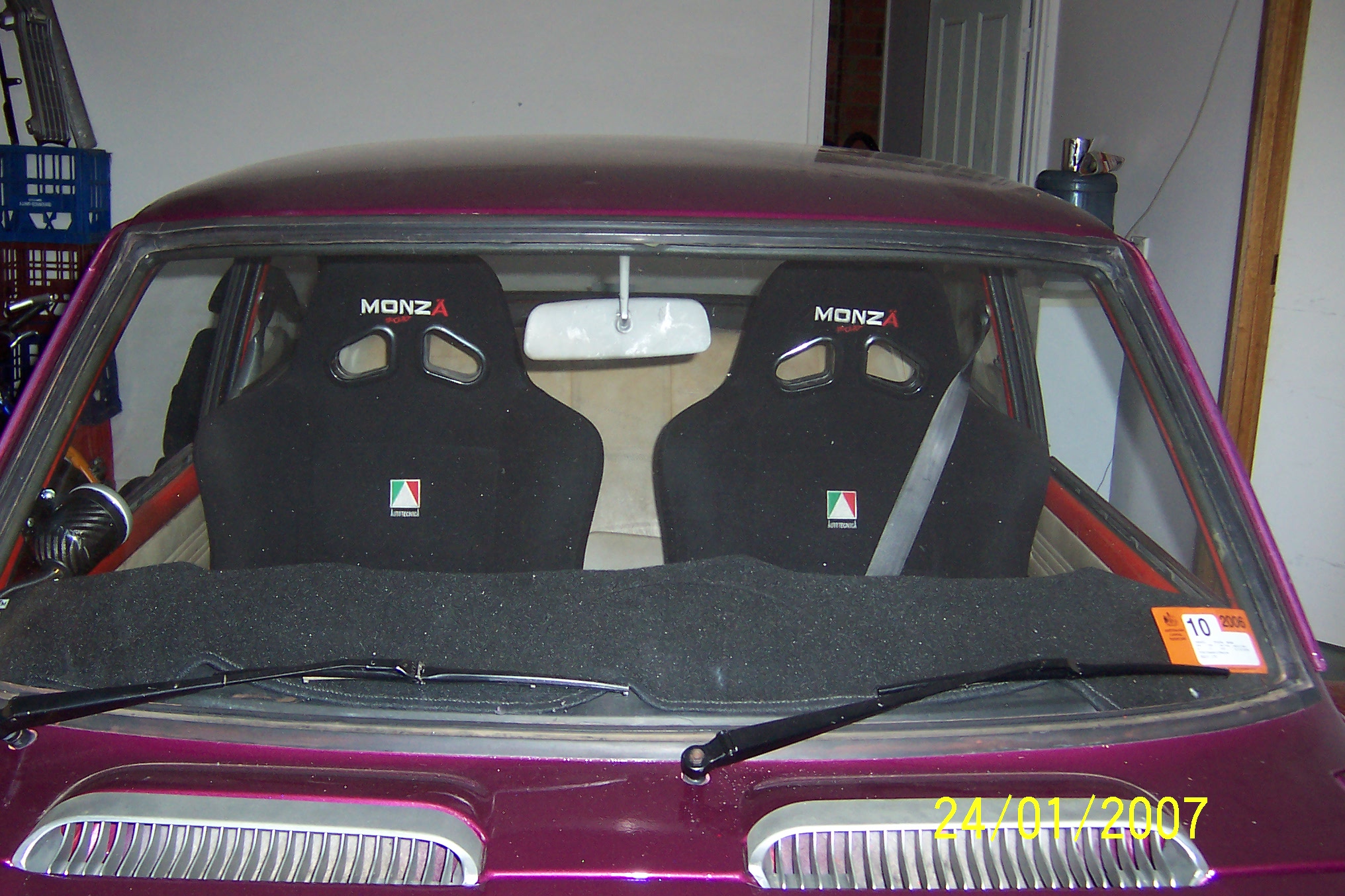

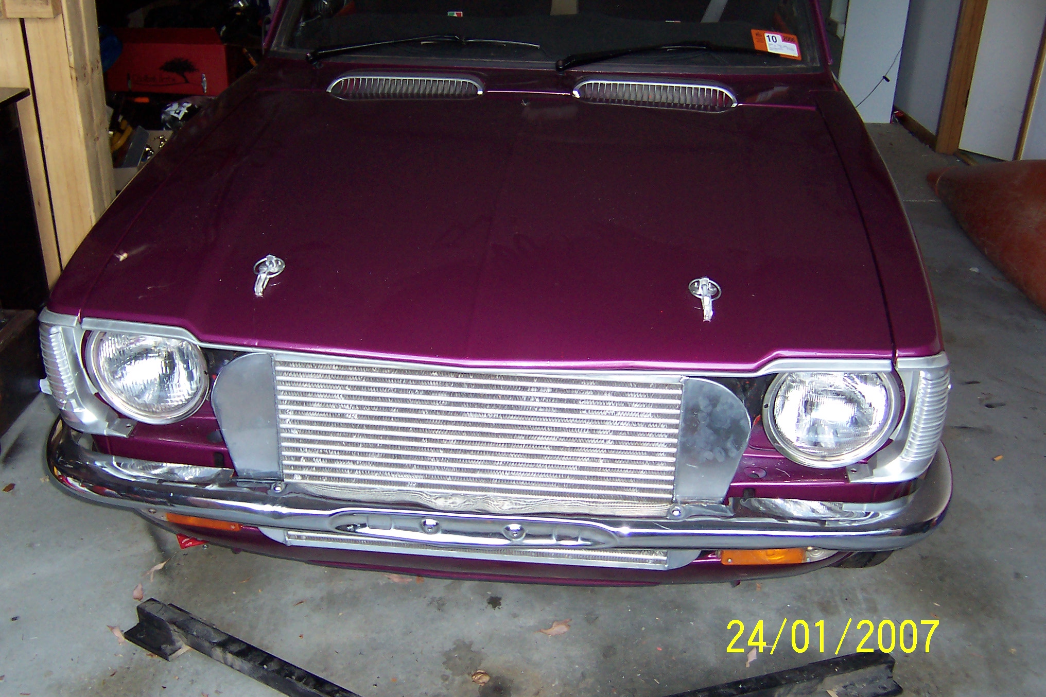

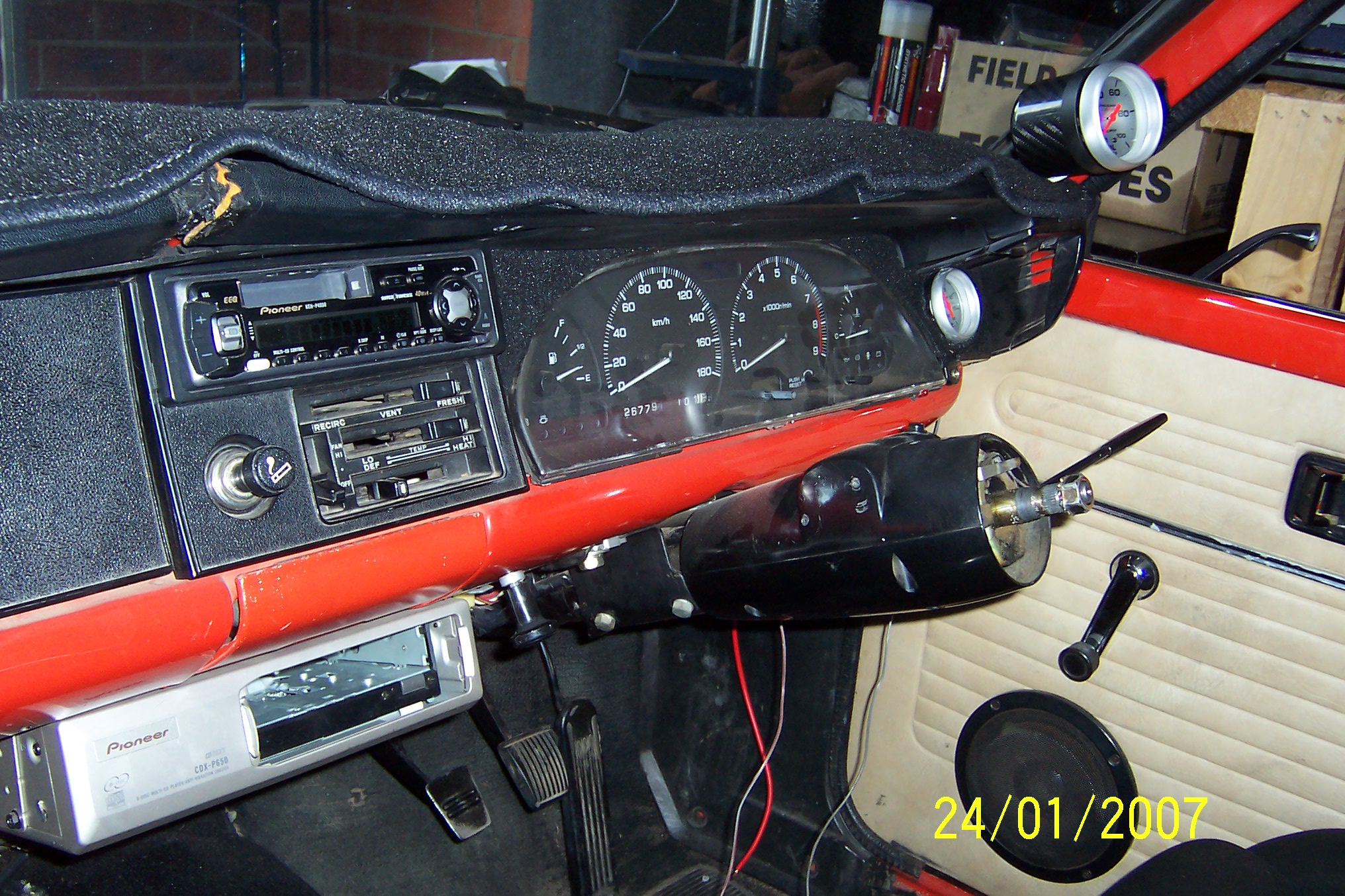

  8. Hey all this is my puple baby. ca18 det powered ke20 coupe. the car is running at the moment was driving but is just about to go off the road for a r31 skyline brogwarner diff conversion, going to run 3.9 gears and a mini spool. the car has race seats, 15inch simmons usues the 180sx dash with lots of autometer gauges. big pwr cooler still uses the ke20 radiator with the 180 thermo fan, going to uprgrade but works well at the moment. saving money and looking into brake upgrades. will keep you posted on further devolpoments.

  10. very valid point it would be cheaper and easier to use r31 struts. i am running a set of 15 inch simmons on the car atm so i guess they will have to go as the pcd will change and propbably need 16`s to fit the brakes, bit of a shame there nice wheels. i would most likely use 280mm disc and gtst 4 spots with s12 hubs and the datsport 280mm discs. thanks for that i will get in touch in the next few days and get u some pics of the engine, engine bay ,mounts for motor gearbox, and anything else.
