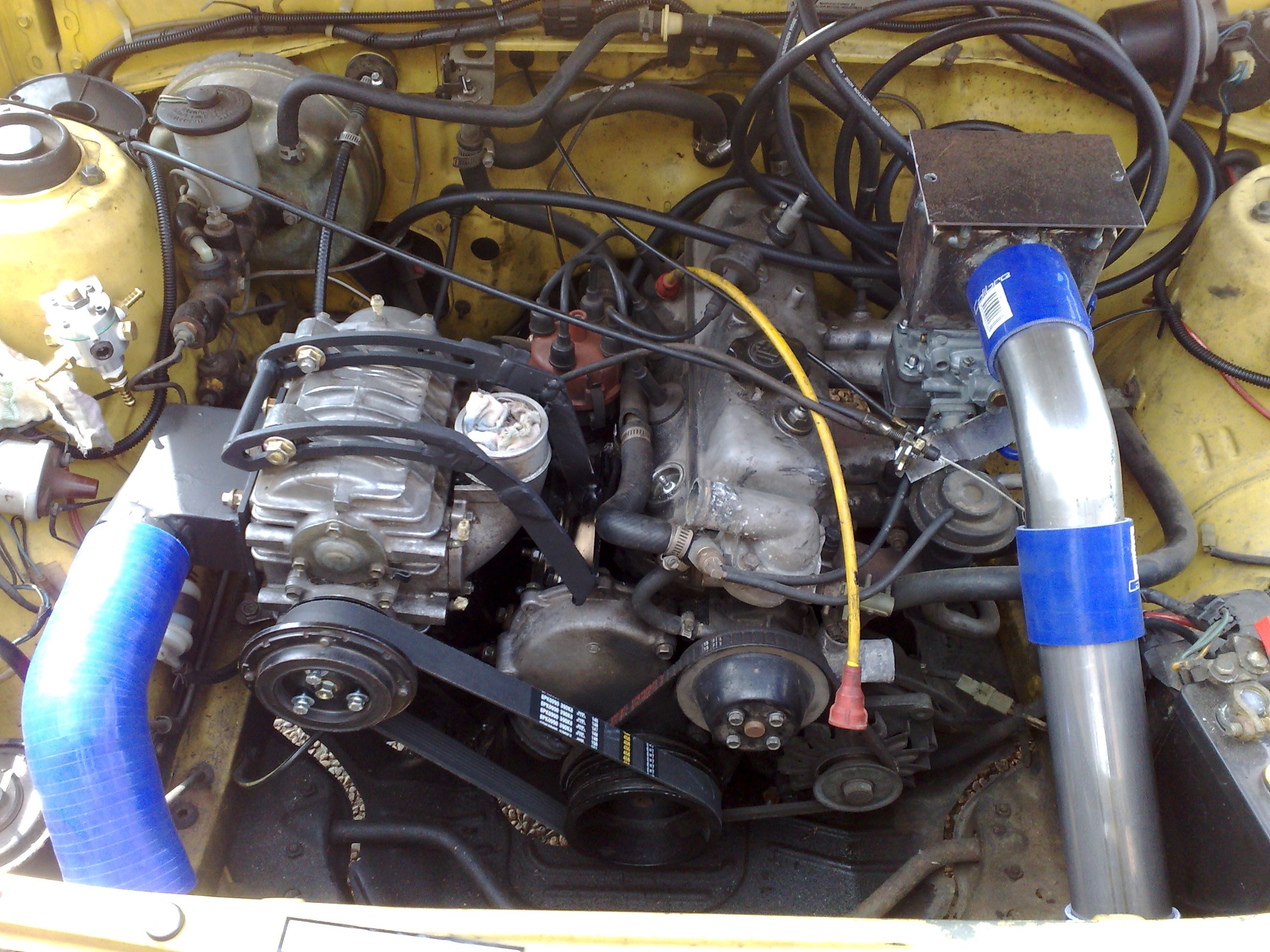

  5. hi everyone. what i would like to know is was there ever a cable clutch celica 5spd. i think the celica 5spds were t50's but i'm not sure. the reason i ask is i've been busy helping a friend build his sc14 powered 4k ke70. we've finished the install bar drilling the lid for the carburetter box and hooking up the fuel pump. its got the 77mmm pulley on the front and we are expecting some stoopid amounts of air to get pumped. anyway when it gets tuned and back on the road in the next few weeks i don't expect the gearbox to last long under the power or his shifting technique. was hoping there may have been a cable clutch celica 5spd we could adapt using a k 2 tseries bellhousing. if not how hard is it to convert the 70 pedal box so that it will use a clutch master cylinder. any info would be appreciated here's a pic i'me sure my mate wil post more as i think he has a thread running.

  7. for the 4kz i'm helping my freind build for his ke70 we have gone down the path of making custom mounts for the charger and a custom outlet for the supercharger. we decided to go with a blow through set up using an xf carby and a small intercooler behind the grill. i've machined up a custom 8pk crank pulley to suit the 77mm 8pk snout pulley. were looking at making around 16psi at 6500rpm. we will see how long the stock 4k lasts but we have allready started building a hard 4k to drop in after our hour of fun. good luck with your project and i'll keep you posted. go the 4kz!!
