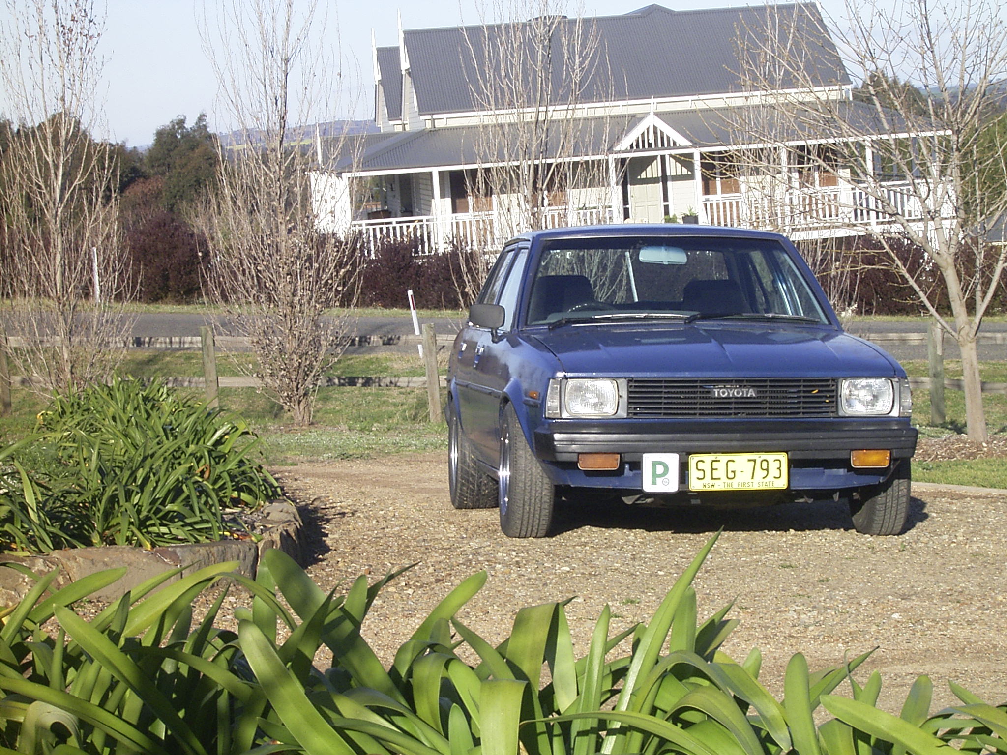

  15. Front: Corona struts 7kg/mm coilovers with AE86 KYB Excel G inserts. (Unsure of free height sorry) Rear: 230mm free height 5kg/mm spja springs with KYB VN Commodore short stroke shocks (343113 part number) Pretty much the only picture I have of it with the new suspension. May or may not help.
