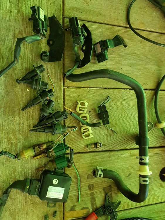

  13. I have the following bits on order. New Aisin waterpump with rear housing. New WT sensor. New inlet and exhaust manifold gaskets. New Throttle body gasket. New rear water fitting gasket. New Bottom radiator hose. I need Teddy to help with the ignition stuff, its impossible otherwise, since it all has to come from Toyota Japan. I would love a map sensor part number 89420-20170 if anyone has one lying around. Thats from the st170 fwd corona with 4sfe that the ecu is from.

  19. Following on from the earlier post. The sx80 coil is the same in the st170. So is the fuel injector and the throttle body gasket, which is common to all xSFE engines. Put IAT sensor from the sprinter in, didn't change much, maybe even ran better with out it. Might need time to learn. Or it might be slightly different. Pressure washed the back seat, boot, and underneath it, plus the engine bay. Will fit intake, throttle body and exhaust manifold gaskets soon and see how that improves things. I suspect a faint vac leak. After de-greasing I've run it for a fair while and it doesn't seem to be leaking oil in any area. Found ae92 sx spoiler at a house Im renovating that had to be cleaned out. Baby keeps growing.
  20. Interesting playing with this today. Its ecu is from an st170 corona front wheel drive 4sfe car. According to EPC it should have a different Map sensor. Since it runs with this map sensor plugged in from the 4sfe sx80 I'm not too concerned at this point to change that until the ignition is fresh It has the correct TPS, and water temp sender for this ecu. It should, however have an IAT sensor connected and there is the plug there but no sensor, that likely settles what that mystery 2 wire plug dangling from the loom is by the tps and idle controller at least, and provides another avenue for improved running. Its the generic black plastic one IAT, I will throw one in and hopefully the thing runs even better. Stripped the sagged roof lining, the remaining old wiring from gauges and anything else that was broken or in the way of fixing the bits I want to fix. Garbage pile is growing. Vacuumed out the thing. I swear its been underwater by the sediment in it. Might pressure wash later today.
