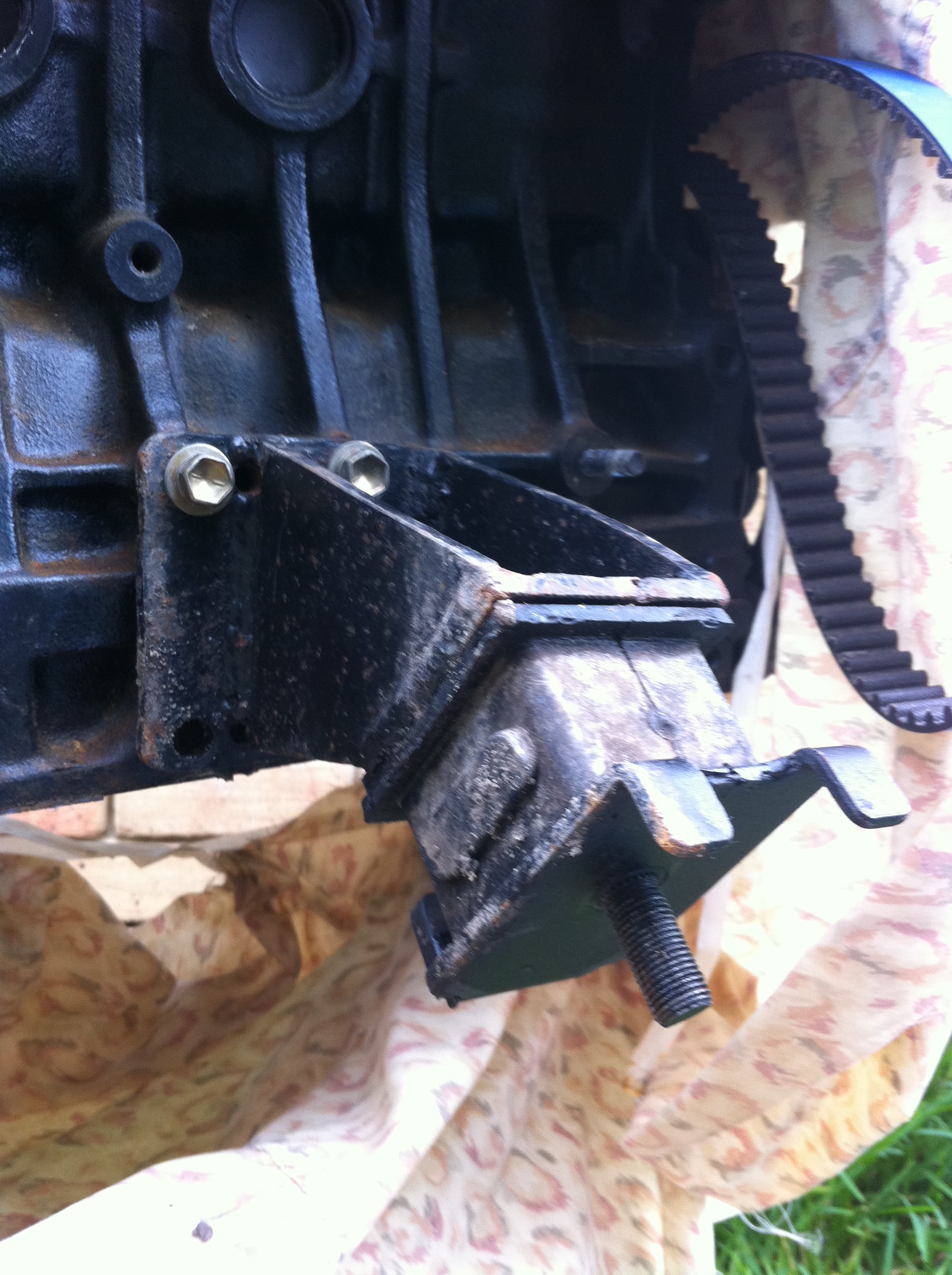

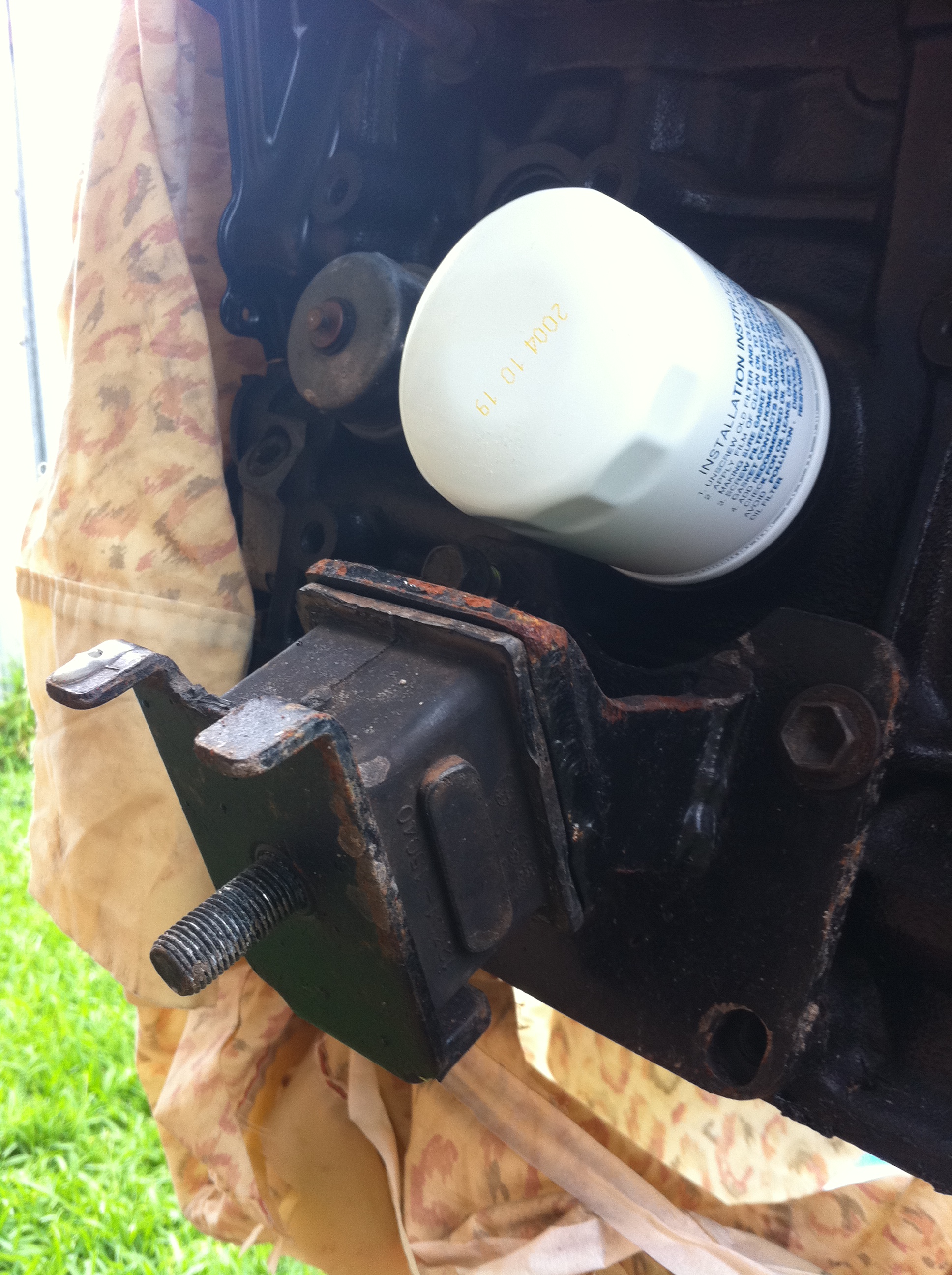

  2. Plenty of room for the sump and oil filter. My 4age ke55 engine mounts using ae86/71 rubber mounts, quickly bolted on my spare motor.
  3. as for engine mounts, cut and shortened ae86/71 mounts should work fine or custom brackets with ae86/71 rubbers. 16v and 20v have different exhaust flanges.

  19. the oil filter didnt foul the stud, sat just aboove, id put a pic up if i could find the usb cord for my camera.
  20. Mine are custom ones with ae86 rubber, currently doing engineering drawings of them seeing ive got the motor out. Cheers, Keelan
