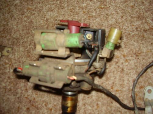

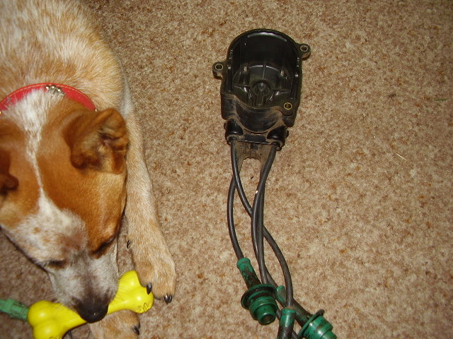

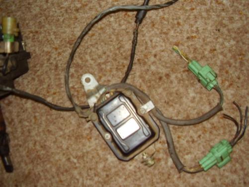

Someone gave me these bits. I've never had a chance to play around with more than one Y series engine. Pics are attached. the cable joining the igniter and the distributor has two wires in it. seven other wires come out of the igniter. the other pieces i have no idea what it is... Robert.
not quite sure i understand. I have three items sitting here, a distributor/coil assembly, a box that has 9 wires going in/out of it, two of which are hooked to the signal part of the distributor, one of which is a case earth, and another box that has three wires going into/out of it, with nothing intelligible written on it... i need positive power to the coil when ignition switch is on/start position, and i need switching earth to the negative side of the coil from the ignition module, and a pulse signal going into the ignition module. the rest of the wires i have no idea at all...
hey not quite a corolla, but pretty close, i've got a 4y toyota engine with a points ignition in it, and i've got a electronic ignition system out of a hilux, and talk about wires everywhere!!! i've got the distributor which has the coil inside it, which has a two wire plug coming out of it, and another two wires going to the igniter module (it says this on the box) now the igniter module has 9 wires all up going in/out of it, including the two that connect to the distributor. i've also got another box which appears to be an igniter module with three wires coming out of it... now i thought that signal from distributor goes to ignition module, then switching goes to coil, coil fires spark.... where does an igniter fit into this?? Robert.
