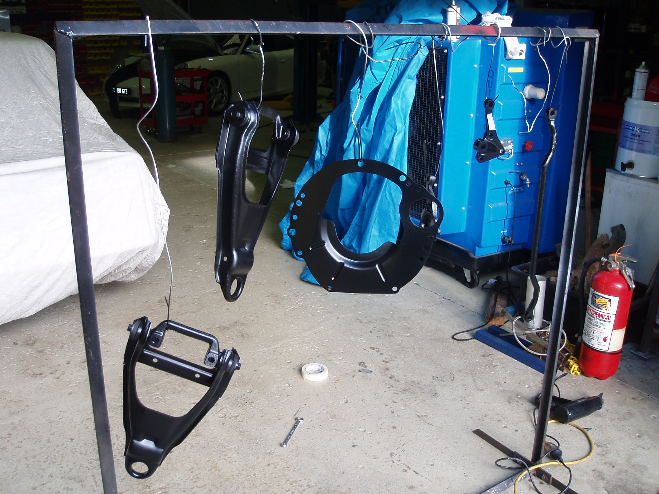

Spent half a day cleaning the engine bay and blasting and paint some suspension bits. Hopefully by the end of the week the engine will be in. They still haven't started on the extractors. Will be having it on the dyno when finnished. My 4K in the Kahanacross car has 75hp at the wheels hope to get a bit more out of this one and a heap more torque.
