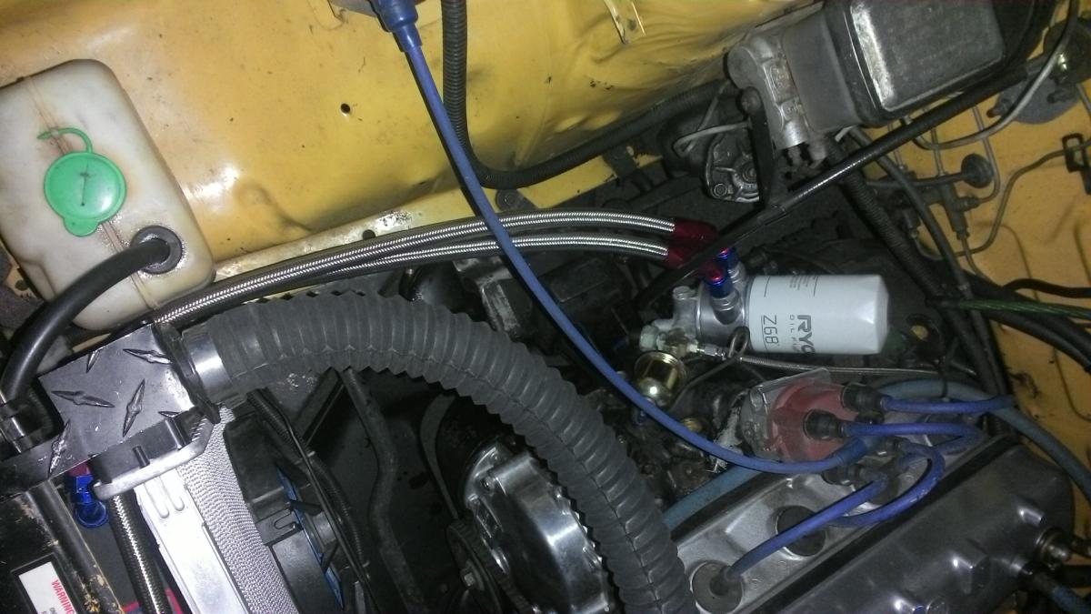

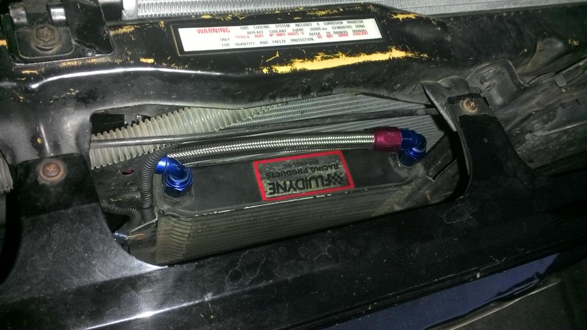

Did an oil change last week so took the opportunity to finally get some -8 braided hose (already had all the fitting) and hook up my oil cooler.....
Haven't driven it super hard yet but 80* is the highest oil temp I've seen so far.... same as the normal water temp.
Looking good mate.
