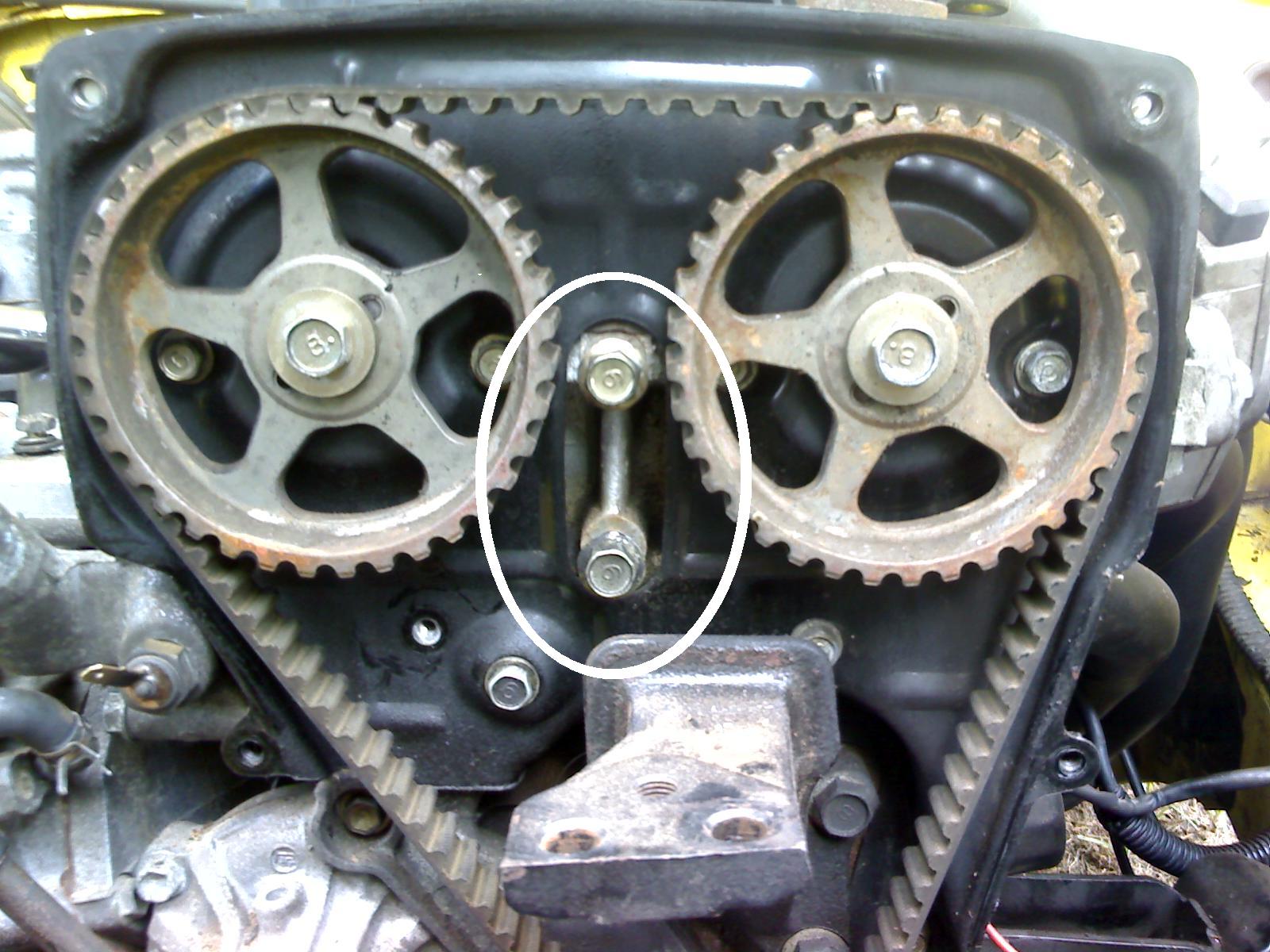

Just something i learnt today, The front engine mount bolts on a 4agze are the same size and thread as the Ke70 and Ae71 radiator bolts.
Pfft, that's nothing. Did you know that the intercooler mounting bolts on a 4A-GZE are the same thread as the front quarter panel bolts on a KE55? It's just the KE55 bolts are a lot longer - nothing that can't be fixed (and has been done multiple times on my car) with a saw.
There are so many bolts that are simarlar/the same its not funny, almost the entire motor uses an 8.8 thread bolt at differant lenghths. Had to replace/find bolts for my motor as about 1/2 were missing when i got it.
