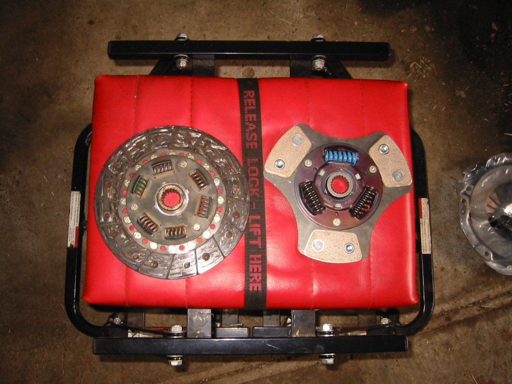

I had a three puck, ceramic, sprung centred clutch made for the 3K rally engine. It was a very happy medium as the sprung centre gave it a slight amount of slippage and not the real on-off that you get with a full solid button.

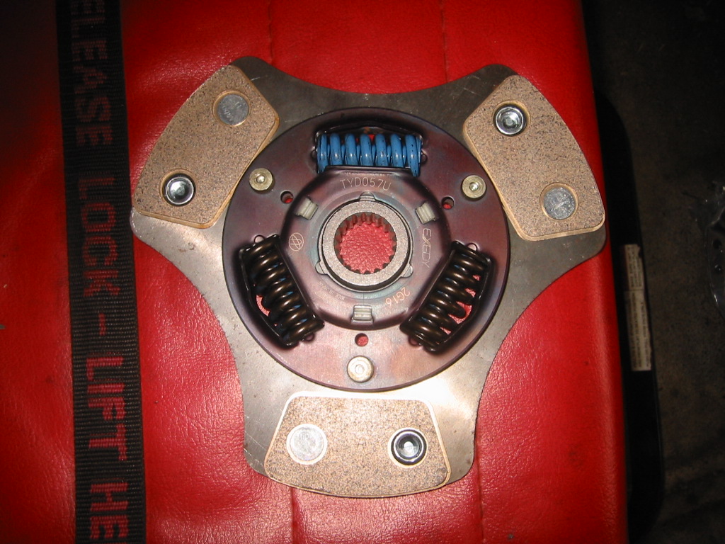

We run a button ceramic / organic combo similar to the picture. Made by Extreme ctutches in adelaide. The one shown is from my 3T engine but the 5K looks the same but smaller.
Also have the K-T bell housing and use the T50 box in the car. Great match for the 5K and the low ratio gear set we run.

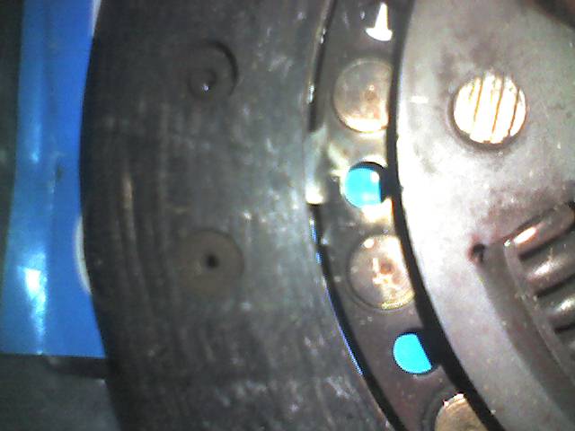

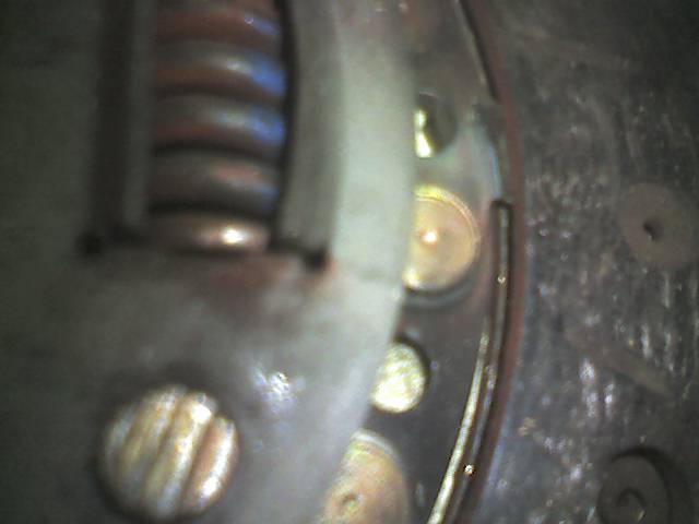

P.S. Not to hijack a thread but look what my 3K did matt and Si. And just to think the 3K was stock..lol But mm it was my spare an old clutch to cover for a week till I got my new one in so mmm should of been expected to slip but not this..lol Oh just if you can't see it in the picture the center metal section let go of the fiber parts so the fiber parts jammed on the flywheel and they center didn't grip so it spun and the car didn't move :) Happened at a major intersection to not cool ;)
