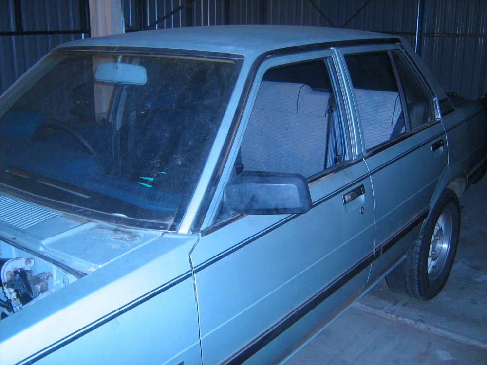

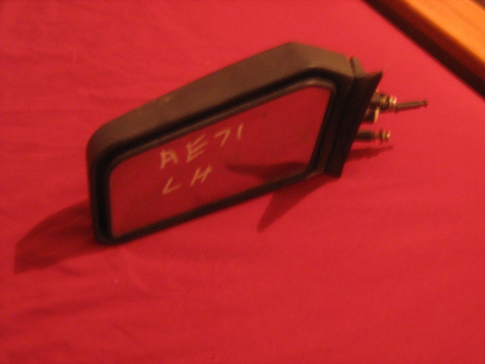

Only a minor update, I recieved the left hand side mirror today, Some pics are shit as i forgot the flash but took em anyway.
(don't say "Its just a mirror, Whats with all the pics" :wink:)
