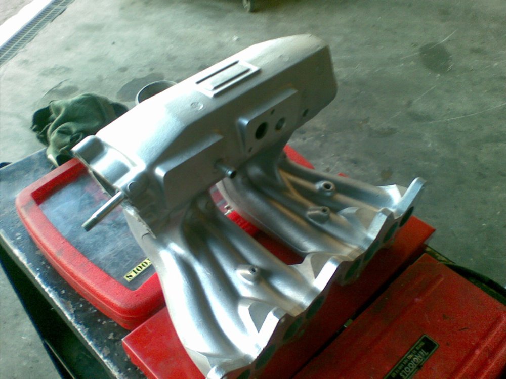

RWD manifold looks like new now as i took it to work and put it in the washing machine, I'm going to take a few parts in and bead blast them so i can paint them.

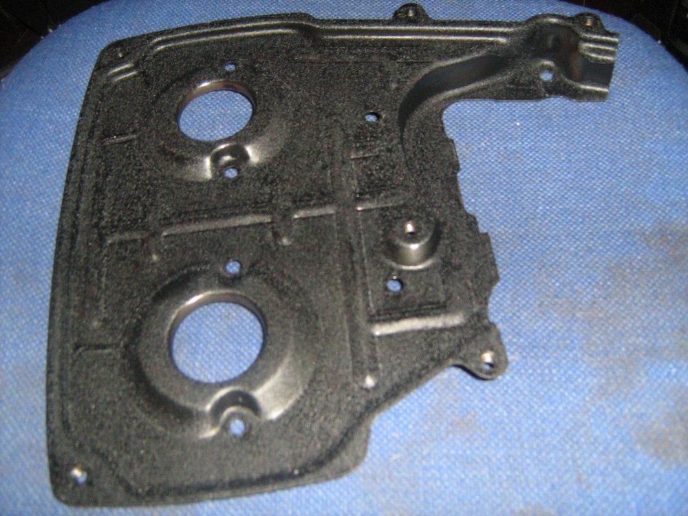

I took the cam cover backing plate to work and blasted it off so i can paint it, It will be done in black crinkle coat to match the cam covers and should look good with the hks gears and a clear cover.

A quick pic of the inlet manifold since it had a good wash and i blasted it today, The throttle body will be getting a good clean tomorrow. (sorry bout the quality but the pic was taken with my phone as i didnt take my camera to work)

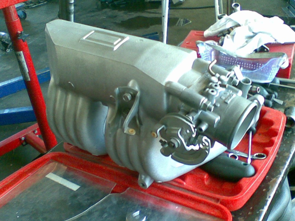

Throttle body is all cleaned up:

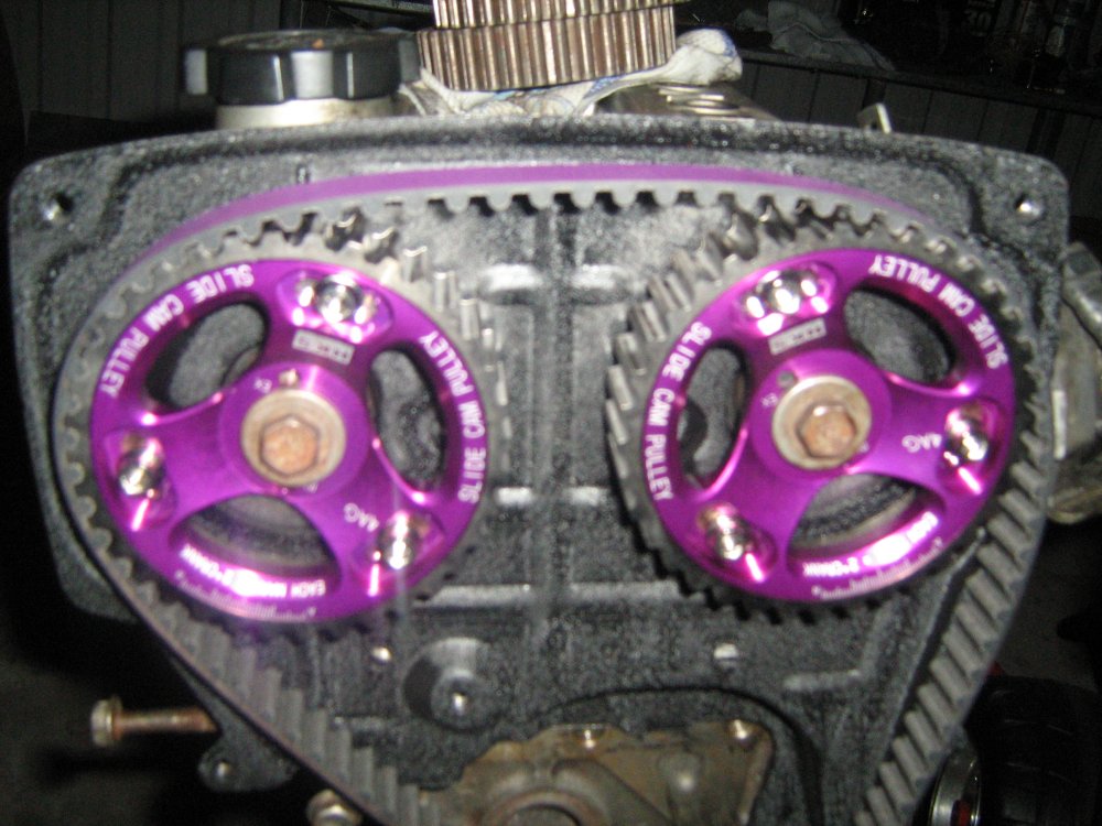

I did the cam backing plate in heat proof wrinkle coat today, Pics just don't show the quality of it, I also included a pic of it temporarily mounted with the hks gear.

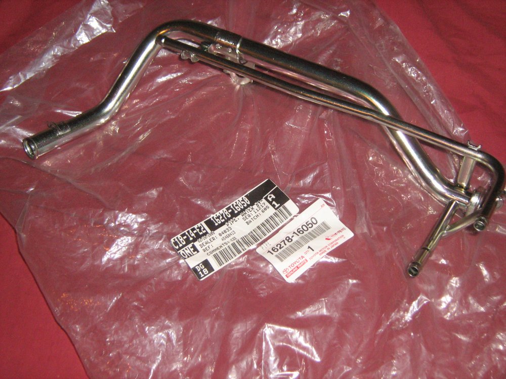

The last of the cooling system has been purchased, I finally got the bypass pipe coming from the US, Those of you that don't know what one is it is the pipe that goes along the side of the block from the front to rear.

Thanks to Cabe toyota in California i now have a brand new water bypass pipe to suit a rwd 4age, Thats the final cooling system component i needed apart from hoses, Now to get cams and a harmonic balancer and i will take it into work and start with the build up.
Thats interesting, the LHD drive version is slightly different to the JDM RHD version. The pipe which goes to heater core doesn't come out that far on the JDM ones, otherwise its the same. Presumably its just got to do with the position of heater core in the US ones.
They are identicle apart from the heater core pipe lenght, It has about 5cm extra on it which does not matter as it still fits, I have a JDM 2nd hand one here off the boss's ae86 racecar at the moment that I'm going to take pics of just to compare the 2.
I've got 2 of the rear outlet pipes myself, interestingly though it looks like one was a LHD version but it has been cut down to the same length as my RHD one because it doesn't have the notch part to stop the hose from slipping off.
