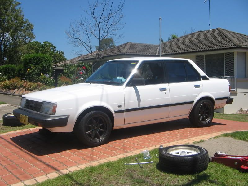

Among the first mods were do something about crappy 90's looking alloys which had great rubber but bugger all traction in the wet.
Take one average looking ae71:
And throw some D's on that bitch:
Another great eBay find it was! I managed a complete set of 15" Watanbes measuring 7.5" wide at the front and 8.5" wide at the rears. The wheels actually came off a DR30 Skyline so the bald tread that was on there was stripped and replaced with some decent 195/50's

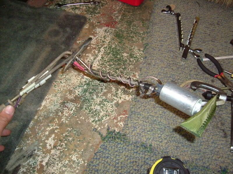

Shortly after the dyno day i began to get sick of the fuel surge going around left handers caused by the crappy fuel pump setup. I redid the whole lot and fitted a surge tank with lo and high pressure pumps.
The modified intank pick up with pre-pump attached:
and the surge tank setup in the boot:
with stock fuel regulator..???
yeah i reckon it looked uber neat once you cleaned it up with the csa's on it, watanabes are off tap though, awsoem find man
Edited by jamesrolla
front lips apron and duck-tail spoiler... to match with those street lethal watanabe wheels.. not rubbing the fenders arch?
All standard fellas everything original out of the donor ae86 which it would have previously came out of.
